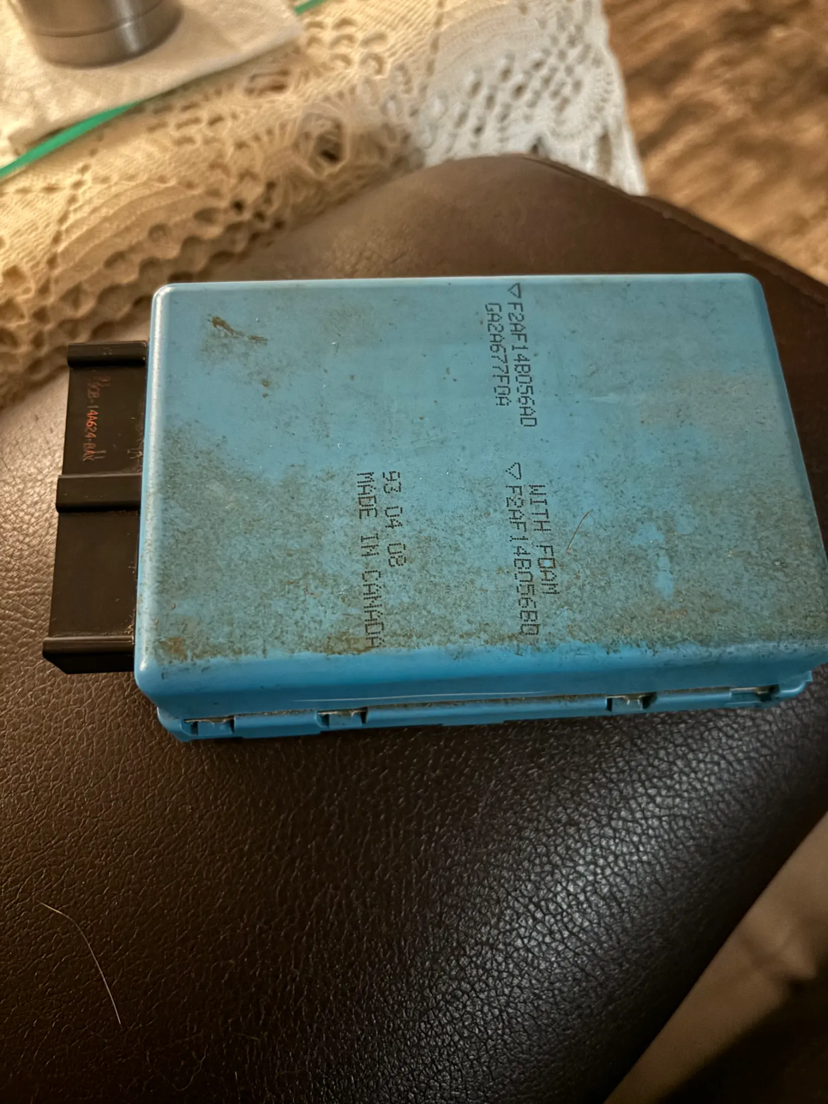

It’s a 1993 Cobra. Just need one to turn the light off so I can pass the state inspection in GA so I can get it titled. The picture is the box I pulled out that is not working.
