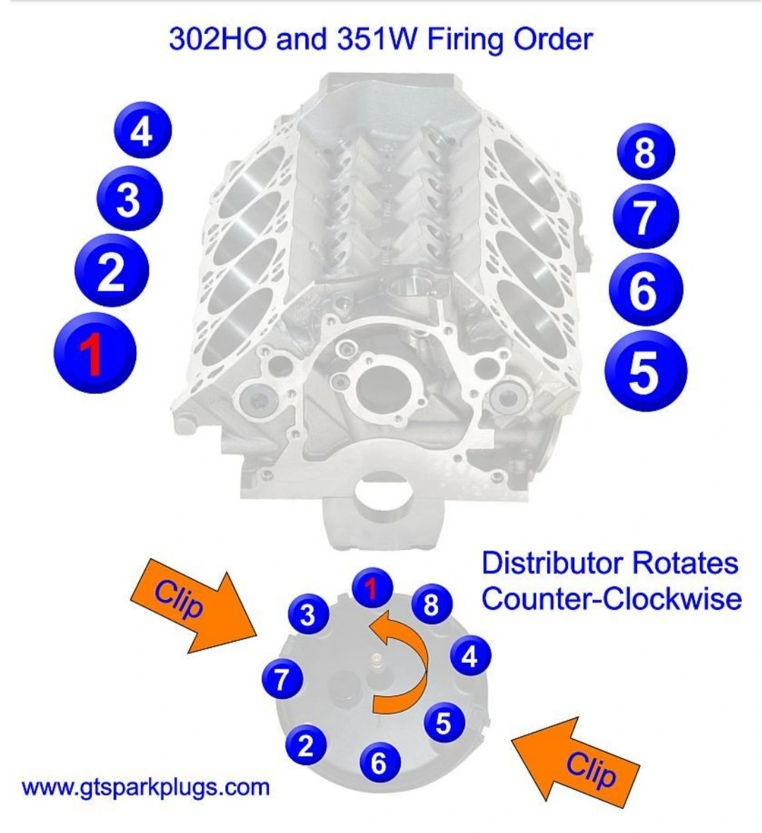

I'd start with the basics. Remove number 1 spark plug. Use a screwdriver lightly placed in the spark plug hole. ( a plastic straw is a safer tool for this ). Rotate the engine with a ratchet until you feel the piston come up to the very top. Since the timing cover is off look at the dots. They should be pointing at each other. If they aren't at each other, and the cam dot is up top, it's not top dead center. Rotate came till dots line up and check for piston at its highest point. Remove the cap and the rotor should be pointing at the number 1 spark plug wire location. It does matter where the plugs are on the cap. There is only one correct spot for the number 1 plug wire. Rotor spins counter clockwise. Check HO firing order counter clockwise from the number one position.
