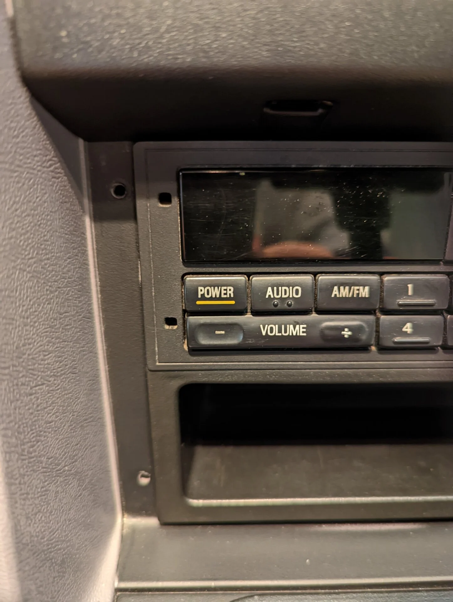

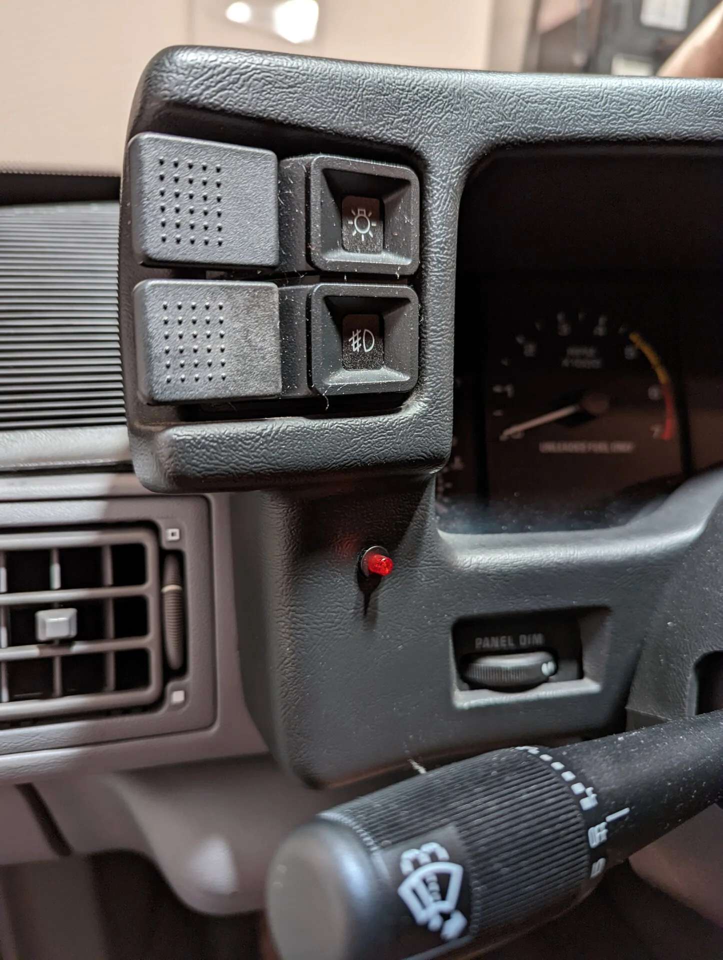

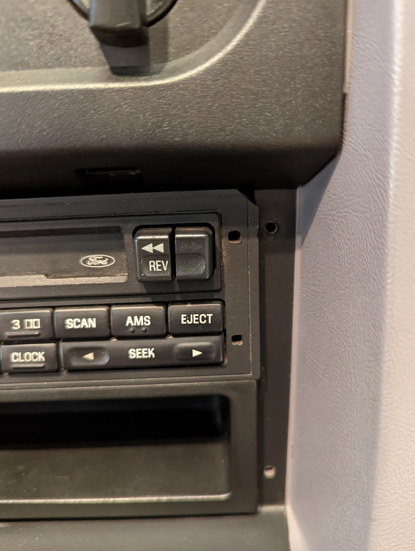

I'm looking for the radio trim bezel without the 4 holes they usually make when the replace the original radio for an aftermarket. Is part of the center console but I believe is interchangeable as it has 4 screws in the back of it. I'm also looking for the gauge bezel, it seems at some point they installed an aftermarket alarm and they drilled a hole near the light dimmer. Thank you.
So you guys see what I am referring to. Thanks a million.

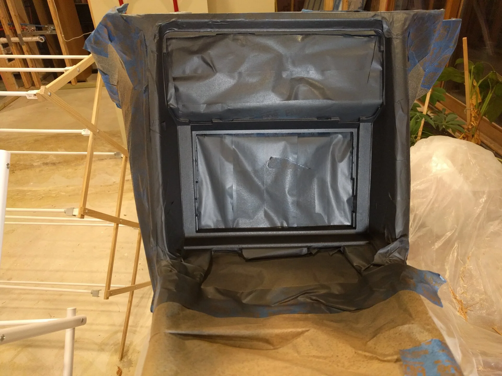

Couple years back I fixed the holes in my center console like @Mustang5L5 described.
Repaired the holes with plastic filler. I used LMR black interior paint (I think there are cheaper options now) and the SEM texture paint to match the factory texture as best I could. The console trim has the Ford wavy texture which the SEM wont do.
I tried the stamp method on another trim piece with no luck
View: https://www.youtube.com/watch?v=85FYd9TjLSI
Filler: Amazon product ASIN B0076LAVFKView: https://www.amazon.com/gp/product/B0076LAVFK/
SEM Texture: Amazon product ASIN B000PL074SView: https://www.amazon.com/SEM-39853-Texture-Coating-Aerosol/dp/B000PL074S
Black paint: https://lmr.com/item/MET-FV33/90-95-Mustang-Black-Vinyl-Interior-Paint
I am pleased with the results.
