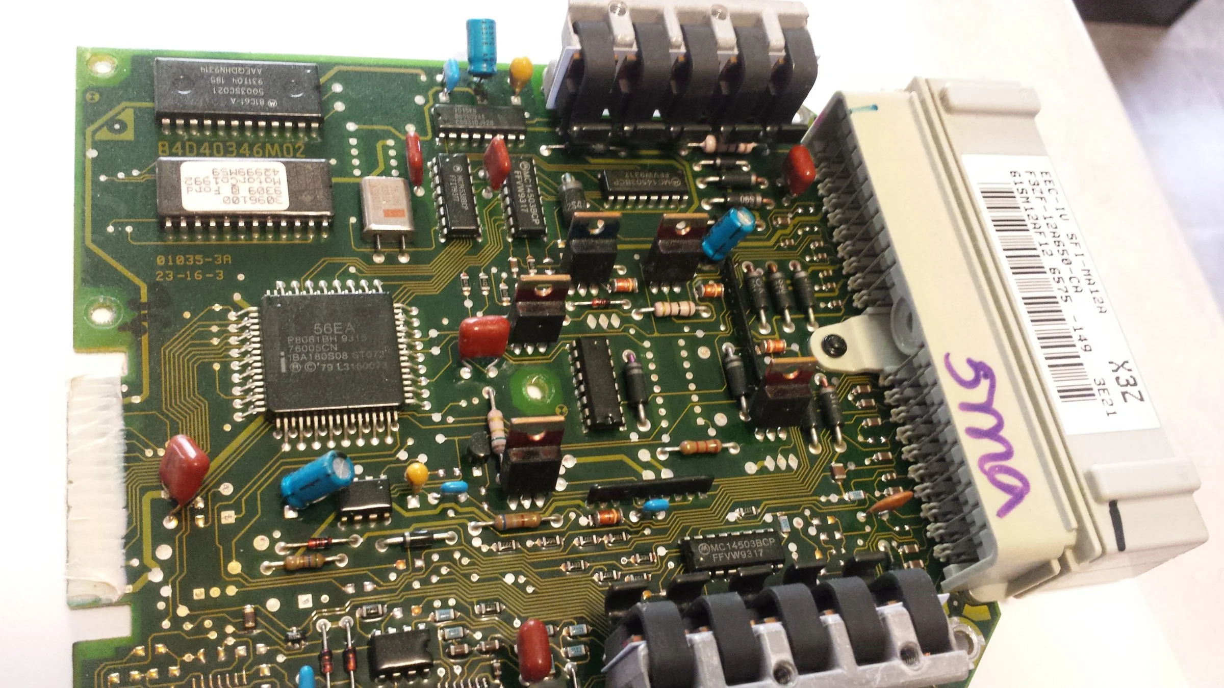

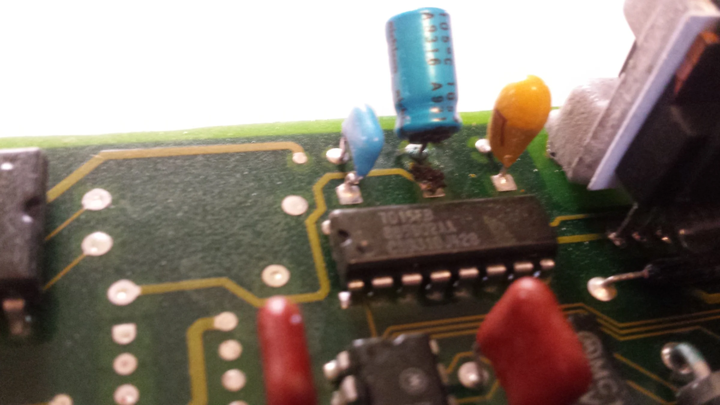

I wanted to give an up date on the situation with the car. I hate when people figure out what was wrong but never update the thread with the answer. So just to recap. I Turn the key on and the fuel pump does not prime. I use the jumper wire at the test port and the fuel pump kicks on but does not turn off. I run through all the test as described in the above thread by jrichker. I pull the ECM (COMPUTER) and once I get down to the board (which is the first picture) I see that two of the blue barrel looking things (capacitors) are burned up. (second picture has a close up of one of the capacitors) I buy three of them off ebay (two of them are 47uF 16V capacitors and one is a 10 uF 35V capacitor) I solder them on to the board and now my dads 93 runs again. Just want to say thanks again to everyone who continues to contribute to these forums.
