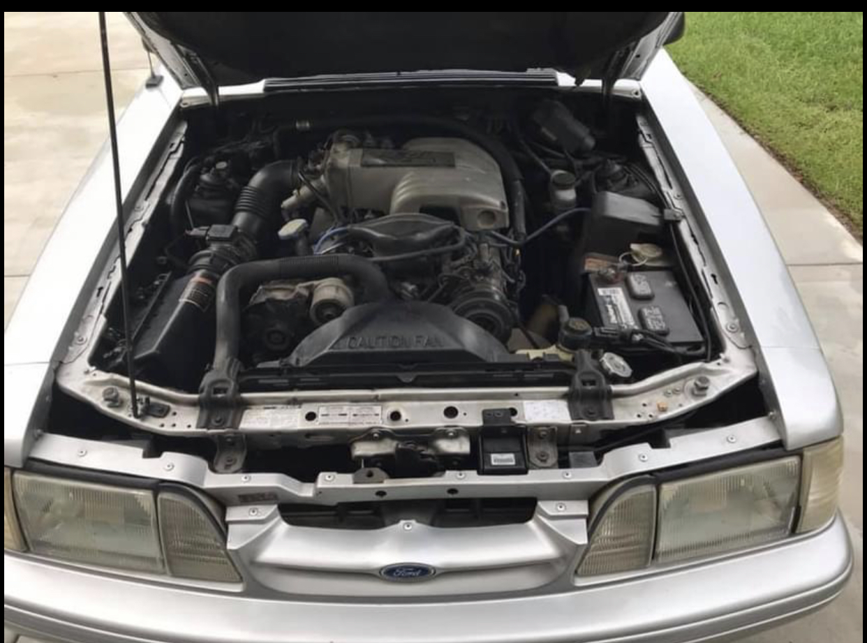

So, I sold my 1993 coupe and bought what “is” supposed to a 97k original mile hatch.
It’s has a few dings and paint chips but drove okay until a recent grocery trip has plagued it with problems that I’ll try to collate in here.
Plans was to keep it stock, but the car gods keep throwing wrenches and codes at me.

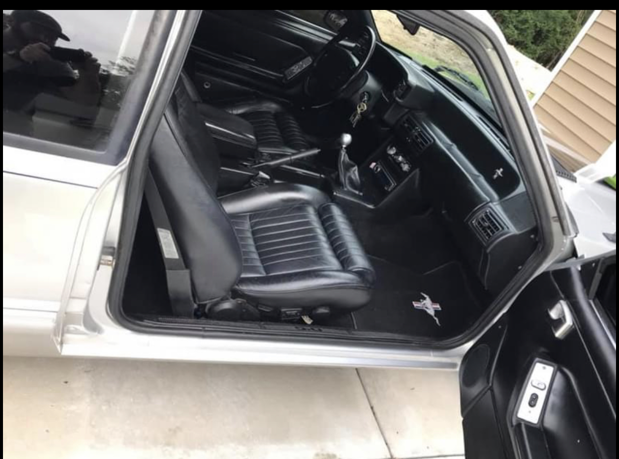

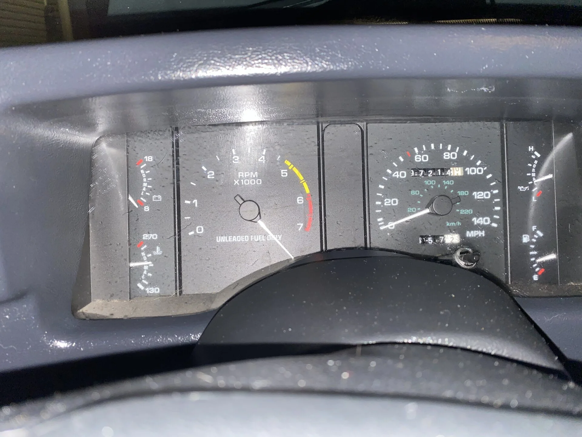

1. Tachometer has decided to go full send and no return. @General karthief is providing me hope on the matter. I’ll also try to see if it’s possible to repair depending on sequence of events if not.
2. Seats do not lock and @Mustang5L5 has provided direction to fix
3. As of tonight, verify the clutch cable is functioning correctly and/or plan on a clutch replacement. ***More to this story***
4. Airbag light blinks 3 then 4 times. Have to look into that on the search function. Also now the low coolant light(coolant is burped and topped off)....which may be Tach related.

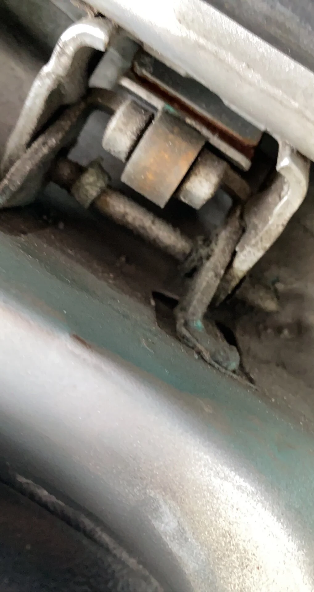

5. Low priority, Door pins. Any lesson learned here tips welcomed.....also someone repainted over the orignal Calypso Green color

I have the same problem with the exact same floor mats my plan is to take it into a upholstery shop and have it shortened. Also add some clips on the floor to keep it secure

I'd swap the tach out for one from another cluster.. It's an airbag car so you'll need to find one from a 90-93 cluster to use. Also don't use one from a four cylinder cluster (6k red line) although it would fit and function it'll be inaccurate and add about two thousand rpm to the actual readings.
That door pin is toast.. you can see the bushing hanging down in the pic. They suck to replace. Put a jack and jack stand under the door and you'll have to cut the pin. I used a Dremel and quality blades. You'll have to then slide the door back enough so you can pull the old bushings out and tap new ones in. Move door back together and drop new pins in.. it's simple but tough do to area size to work with. Second set of hands to steady the door is a must or use your engine hoist if you have one.

Looking to source the tachometer and/or cluster
And the door pin is going to be a weekend thing once I get the clutch sorted out

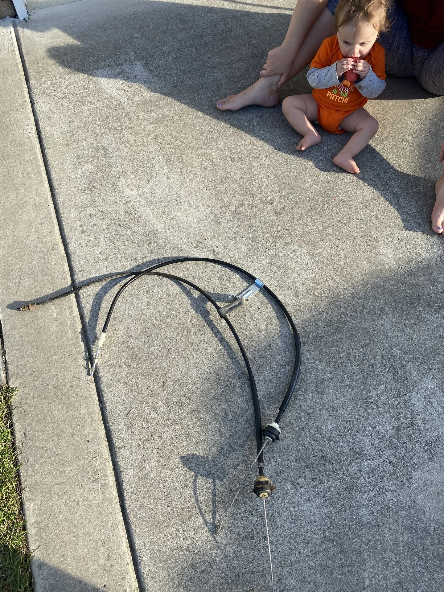

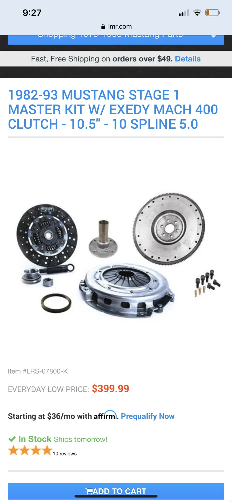

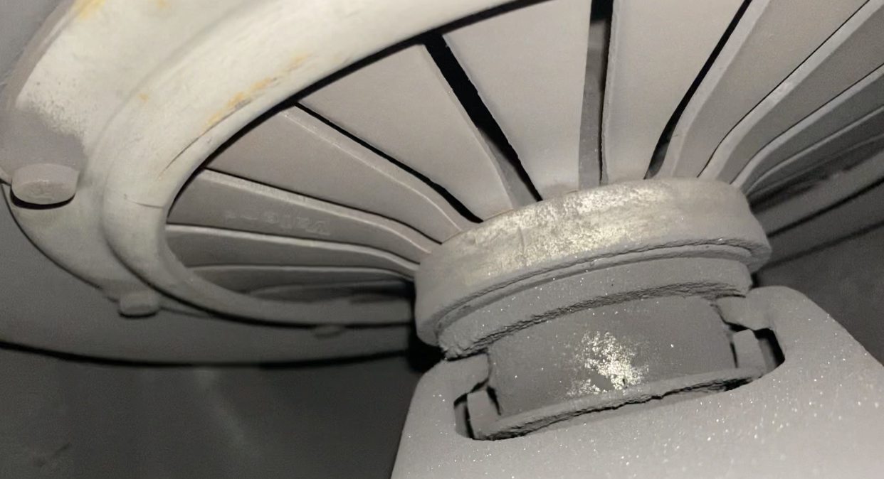

Well when I took the car out last. It was not accelerating in any gear but first.
Got it home and thought maybe the clutch cable was stretched out based how high the disengagement was.
Swapped it and it even worse now.
Went with a Steeda cable but seems to be the same Taiwanese company that makes all the rest except for the MM.
So ordering a clutch and flywheel soon.

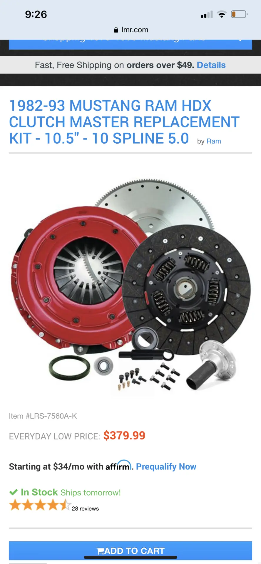

Any recommendations?

If the car is going to stay mostly stock a regular parts store clutch will work fine....but buy a Motorcraft throw out bearing. I know for a fact the ones from Advance Auto ( LUK ) are good until you start modding. Spec Clutches are good and have different stages for different power levels. I'm kinda partial to McLeod but they cost a bit. I've seen them stand up to crazy abuse in a few different makes and models.
I have used the advance auto brand before and had good luck. The problem is their flywheels are heavyyyy.
I can get the clutch and flywheel for about $150 from local shop, but the piece parts add up to within $80-50 to these kits.
Looks like everything is stock.
So adding in the parts
Motorcraft pilot bearing and throw out bearing
steel retainer
Possible fork and pivot replacement
Everything gets close in price. Seems the complaints of most kits are the flywheel and throw out bearing

I don't like the steel pressed in aluminum bearing retainers. I've had a couple customers that actually had the steel sleeve come out. I got the steel one from Hanlon years ago. Also, I recently installed one for a customer that was rough machined...it caused a zipper like noise when pressing the clutch. The one from Hanlon was smooth and works flawlessly still.
Call Hanlon Motorsports and they can put a kit together for you. They know everything that works for what you need. Seems like you'd save over buying thing seperate.
Flywheel weight can help with engagement due to rotating mass. This is why aluminum flywheels usually don't work well in street cars.
I’ll look into. Seems their retainer manufacturer is the same Motivo at first glance.
Also looks like my wife Bedazzled my input shaft
