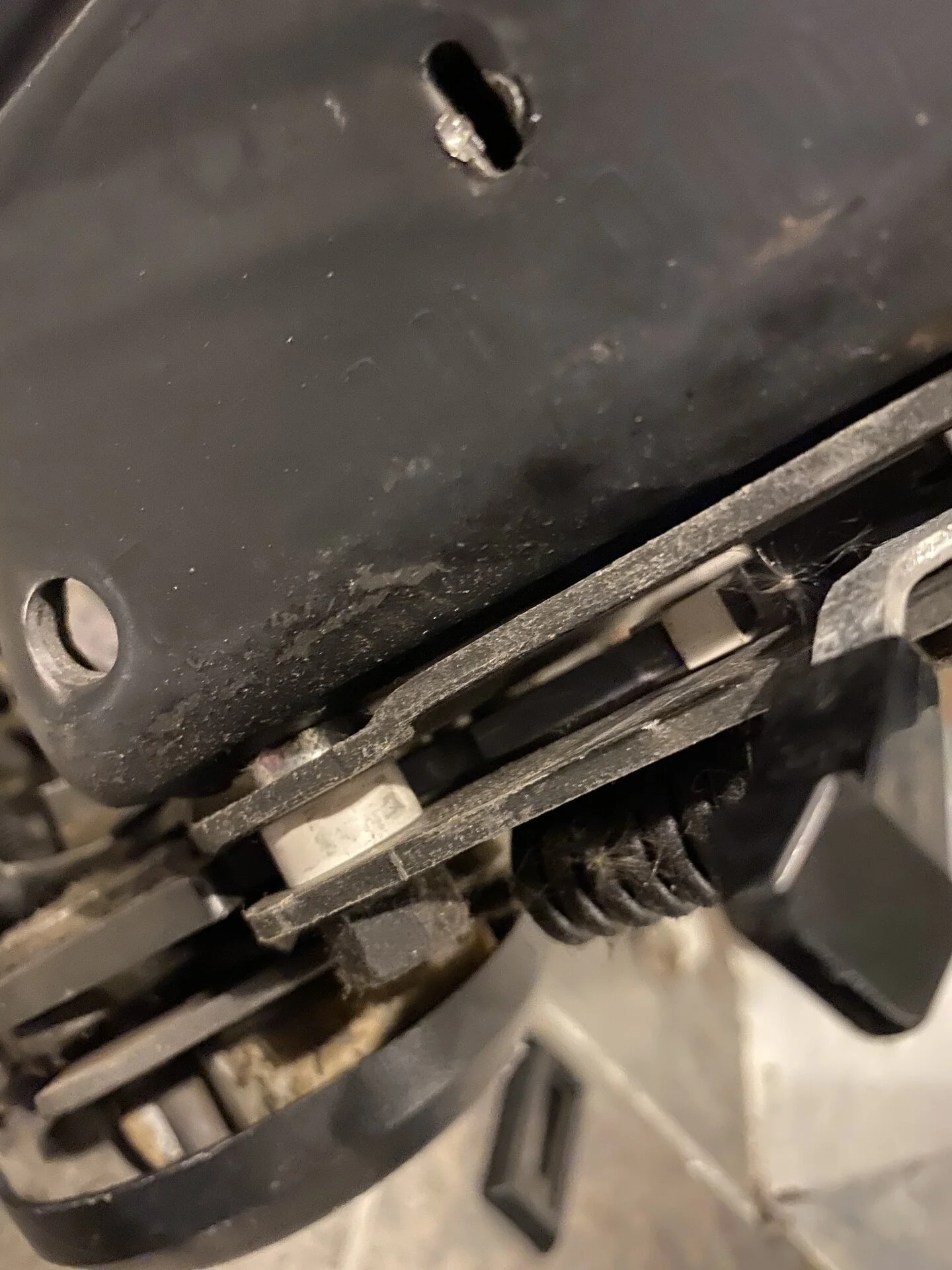

So if you pull the trim off and look inside, there’s a little lever that rocks back and forth. Push it forward and secure it (a fat zip tie will wedge it) and it prevents the seat from flipping forward. It still moves somewhat though. Not a rigid lock

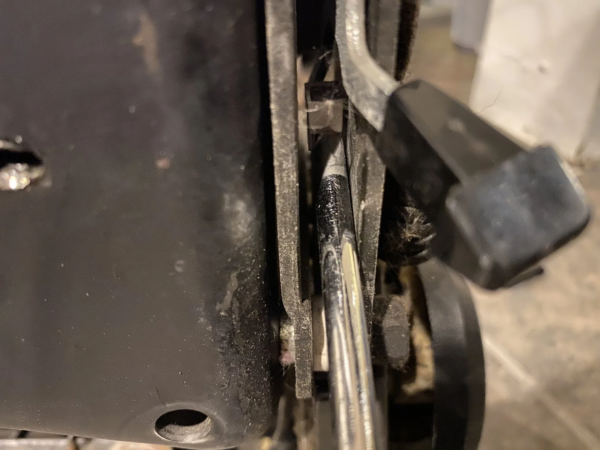

where my screwdriver touches the white part
