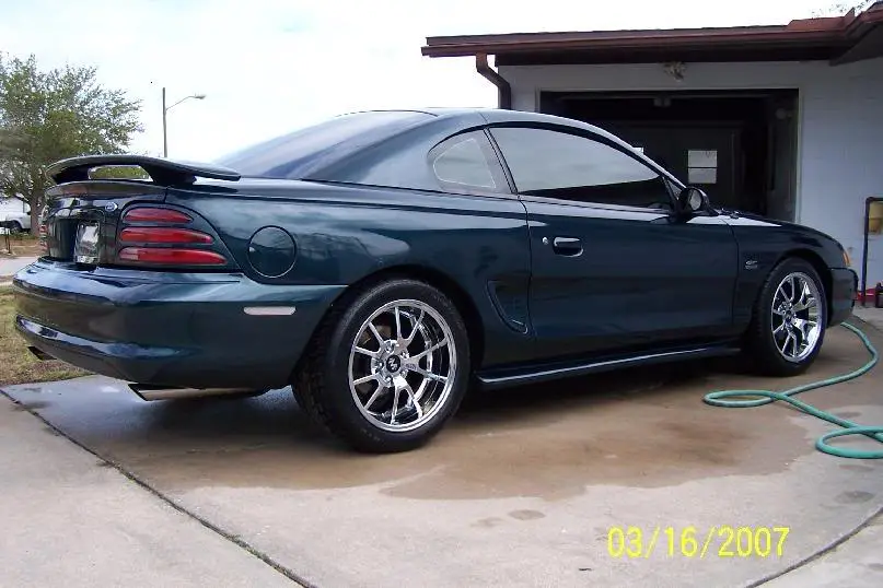

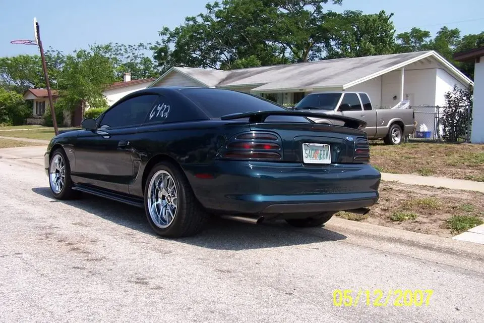

I was trying to find a picture of Eric's (The Green GT) car that shows it, but right now I can't find any. Maybe he'll come post up a pic or two for you.

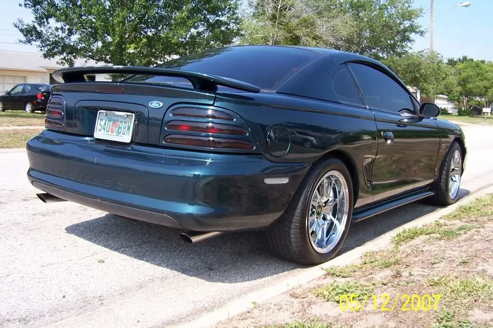

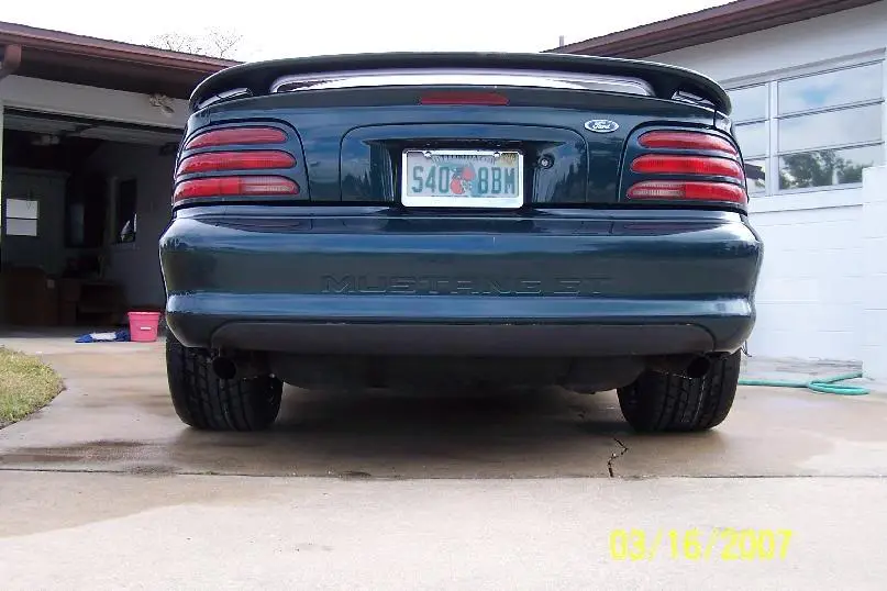

i cant really find a good picture of mine... but i have about 8 or 9 coats on mine and they look great... the clearity through the lense looks even better, still very clear especially at nite which is crucial... take your time, especially with prep if your doing it yourself.. you wont regret it

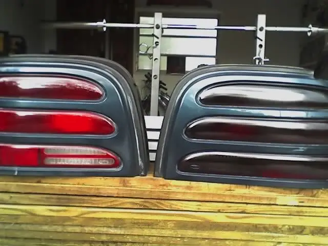

yeah yeah, I know...it's the same thing I posted in your other thread lol. I figured i'd post for people who aren't on that board.

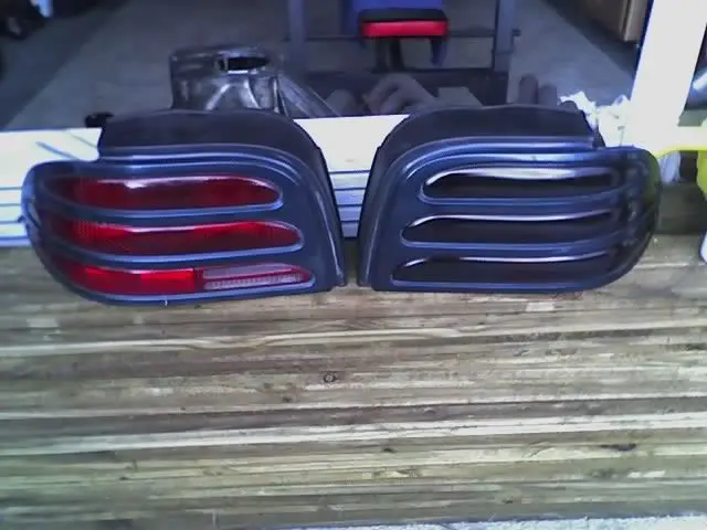

Before
after

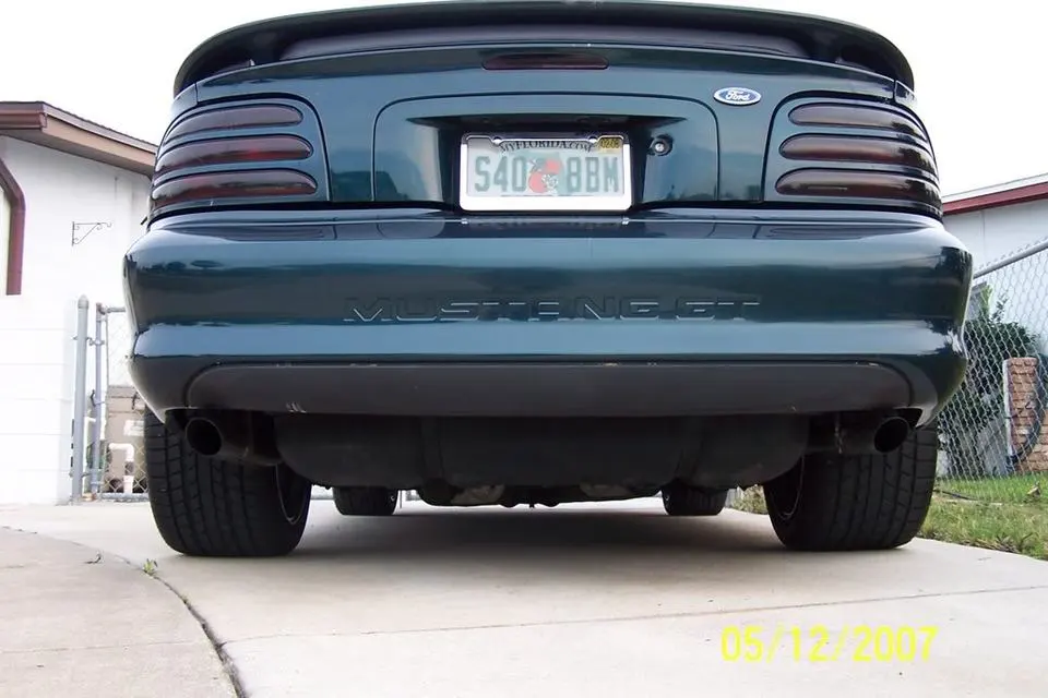

I used vht night shades, wet sanded it after a couple coats...went to discount and used their clearcoat in a can then wetsanded it...suprisingly it turned out decent IMO and it's still holding up find after almost 3 years.
