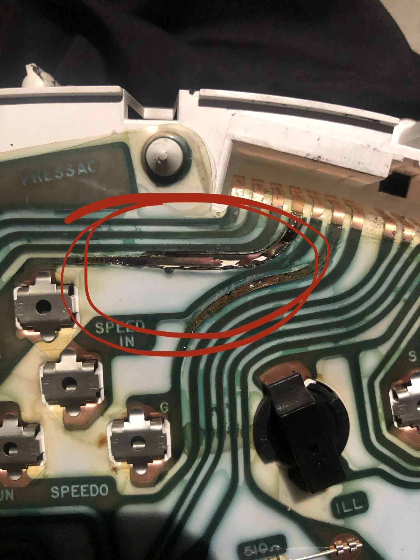

I pulled the instrument cluster off and looked at the circuits on the back. You’ll notice where the wires clip in, on the right side of the back of the panel, the circuits run down toward the speedometer. If the circuit is broken you need to replace that housing. I’ve circled it in red. Once I swapped out housing speedometer worked.
