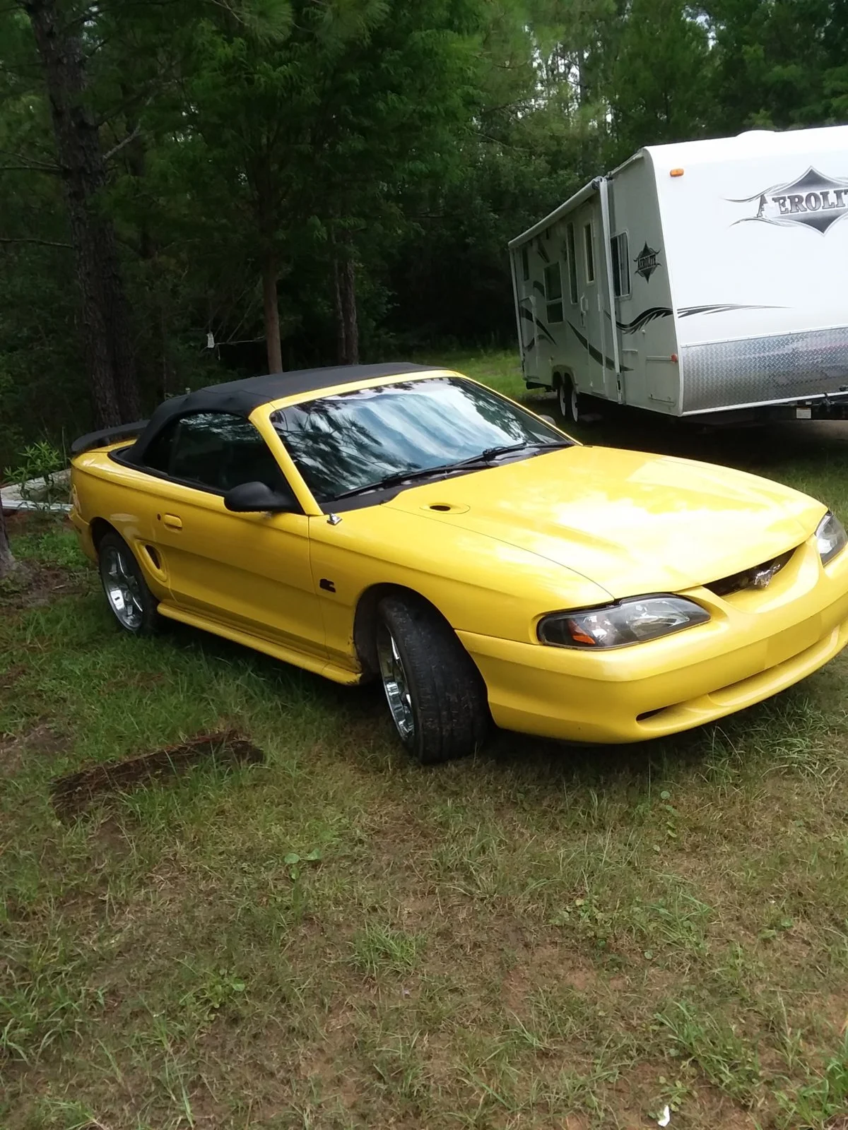

The speedometer is not working on my 1994 mustang gt. I just got the car and wanting to sort things out. Also the radiator fan does not come on.
Thanks
