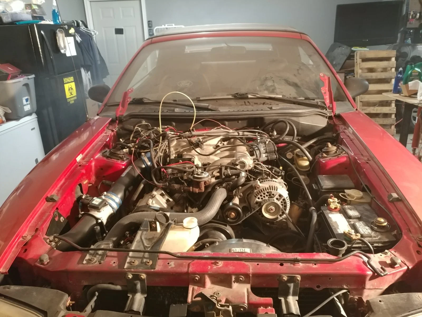

Turned the key and NOTHING!!!!!! All I could think of was me posting the word "Nothing" and then the multitude of replies directing me to the "No Crank" Checklist.
I was not happy. I took a breath and decided to get out and see if any fuel was dumping out of the lines before I went any further. No fuel smell on the drivers side, none on the passenger side. No fuel on my fingers when I touched everything. That is when my eyes went to the battery and my "Battery Cut Off" switch. Which was in the damn OFF position. Turned it to on, fuel pump engaged, I jumped inside and gave her a try.
30 seconds of "I think I can, I think I can, I think I can" and ROAR....... No Backfire!!!! WOOOOT
NOW, you can see the dust on my windshield? That is when a MORON don't clean up the kitty litter that was used to soak up the fluids that ended up on the floor during the removal of the 95 engine. I had to stop because the dust and some exhaust quickly took the garage over and its damn 30 degrees outside here.
Tomorrow I will burp her and get her outside to breathe.
After I ensure that I am good, I will then take her apart and make the wire harness look pretty, right now, wires are everywhere as you can see.

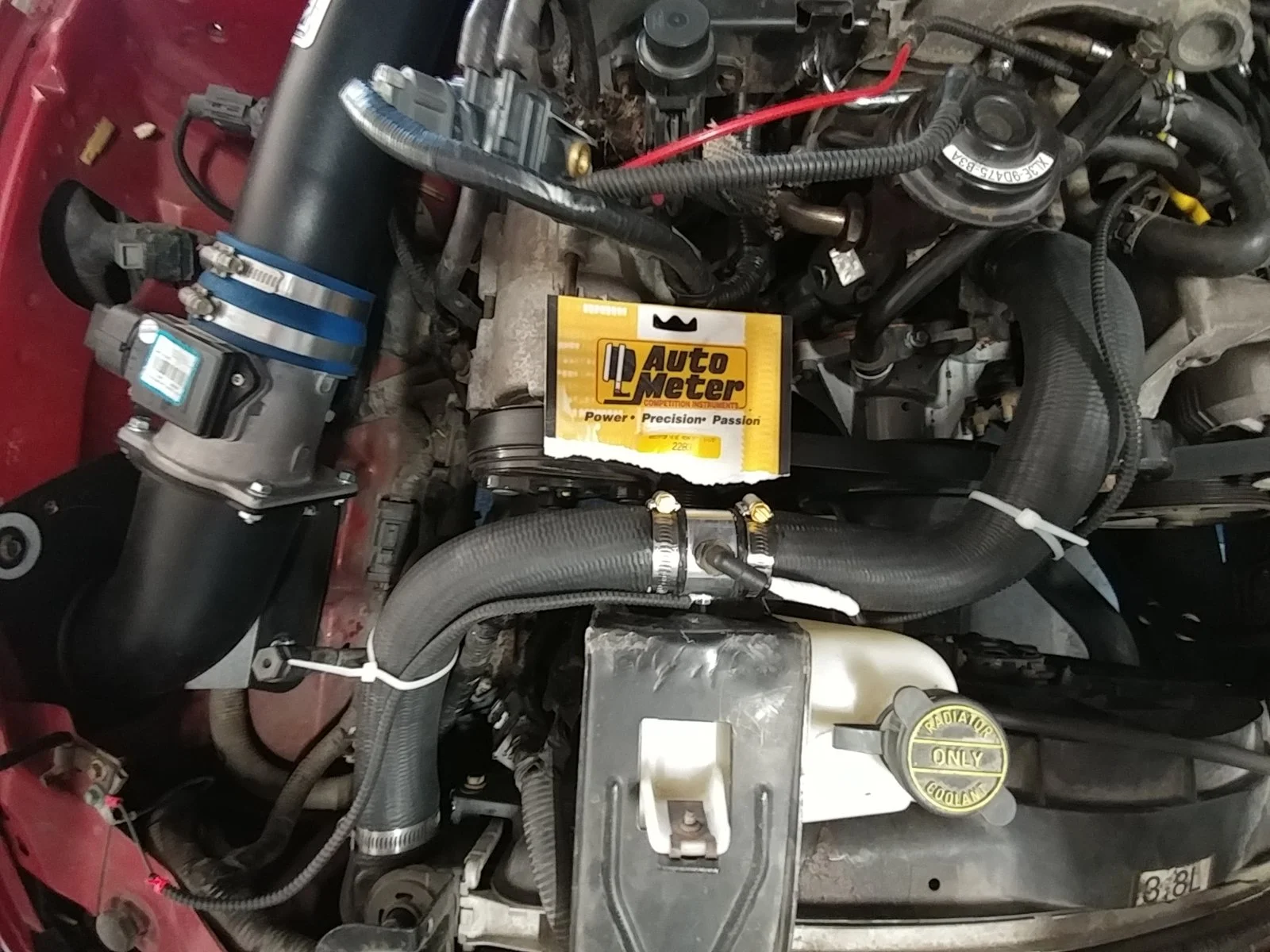

OK, I will edit this post later but I believe that I have found the solution that many people doing this swap from single port to dual port run into.
LINK AutoMeter Radiator Hose Adapters 2283 (trying to find it cheaper)
OK the above link is to the location where I have found the answer to the issue that many people have been having. I was googling random thoughts on how to resolve this and ended up working with pitch rate and thread count on tapping the hole after drilling it out and WONDROUS things happened. The Old Googler popped up a "Related" item and I began exploring the world of Water Temperature Sensor Radiator Hose Adapters.
Once I realized "Universal" is not accurate I went to my parts house and got the specs for the ID of the upper radiator hose and the Temperature Sensor Switch so I could look closer to see if this is going to fit my application.
ID of hose is 1.5 inch. 3/8 - 18 NPTF is the temperature switch.
I believe that if I mount this close as I can to the water pump I can use the factory sensor by extending the wire connected to it. I will update this later to let everyone know if it works

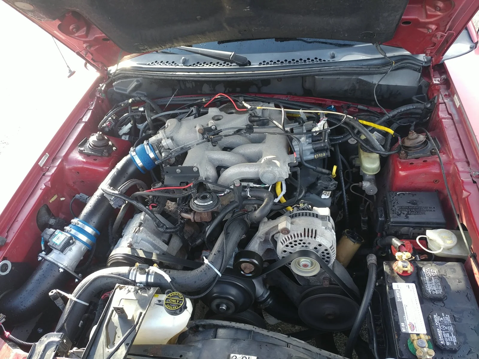

Today I installed this Auto Meter part on the upper radiator hose to make the dash gauge work for the Temp. I was skeptical about it and after burping the car and swapping in the new clutch we took her out for a test. I had my Craftsman Code Reader running the whole time so we could monitor the live data as we were rolling. It never went over 216 per the reader and the gauge never went past the "O" in Normal. So far it is the answer that I have been looking for with this build.
Louise is now acting right, shifting smooth, and purring like never before. I am now calling this swap a success and will be felling her out for a few months to get use to the new shift points and the HP Gain which is very noticable. In town I am not even seeing 5th gear anymore and on the expressway, well I was pleasantly surprised when I looked at the speedo after merging. I had to back out of it to set the cruise control (which I was told the 95 cable and controller wont work with the 02 engine, B.S. It works great)
Still need to work out a Vacuum line issue and then I can clean the rest of the lines up, but some Scrubbing Bubbles and a Car Wash did some wonders to the overall look. It almost looks like I actually took the time and cleaned the parts before assembling the car. NOPE, Peckerwood is in Full Effect.

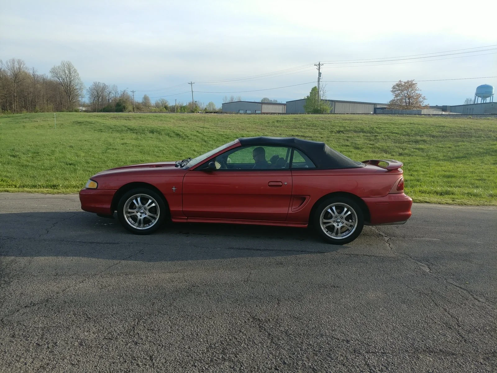

Decided to get an Updated Picture of my girl after a good cleaning. Eventually I will care enough to color match things and pull the dents out of the rear quarter. That is my son in there wondering why the hell I am taking pictures.

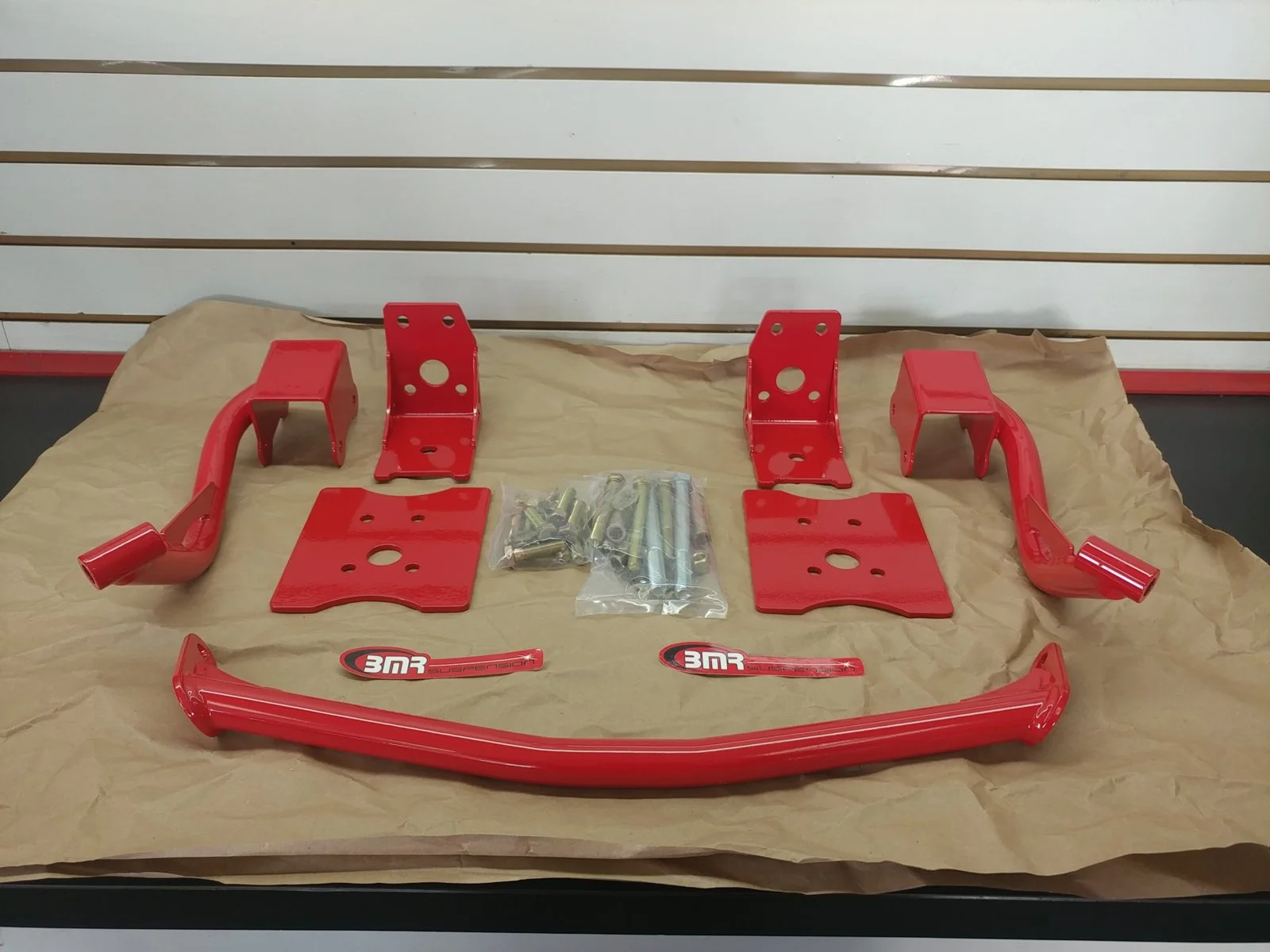

UPS Just Delivered Some Sexy to my shop
BMR-TBR004R
Torque Box Reinforcement Plates, Upper/Lower, Steel, Red Powdercoated
Will have to complete a few projects at the house before I can get these in. Directions say 4 hours. We will see on the reality of that time frame.

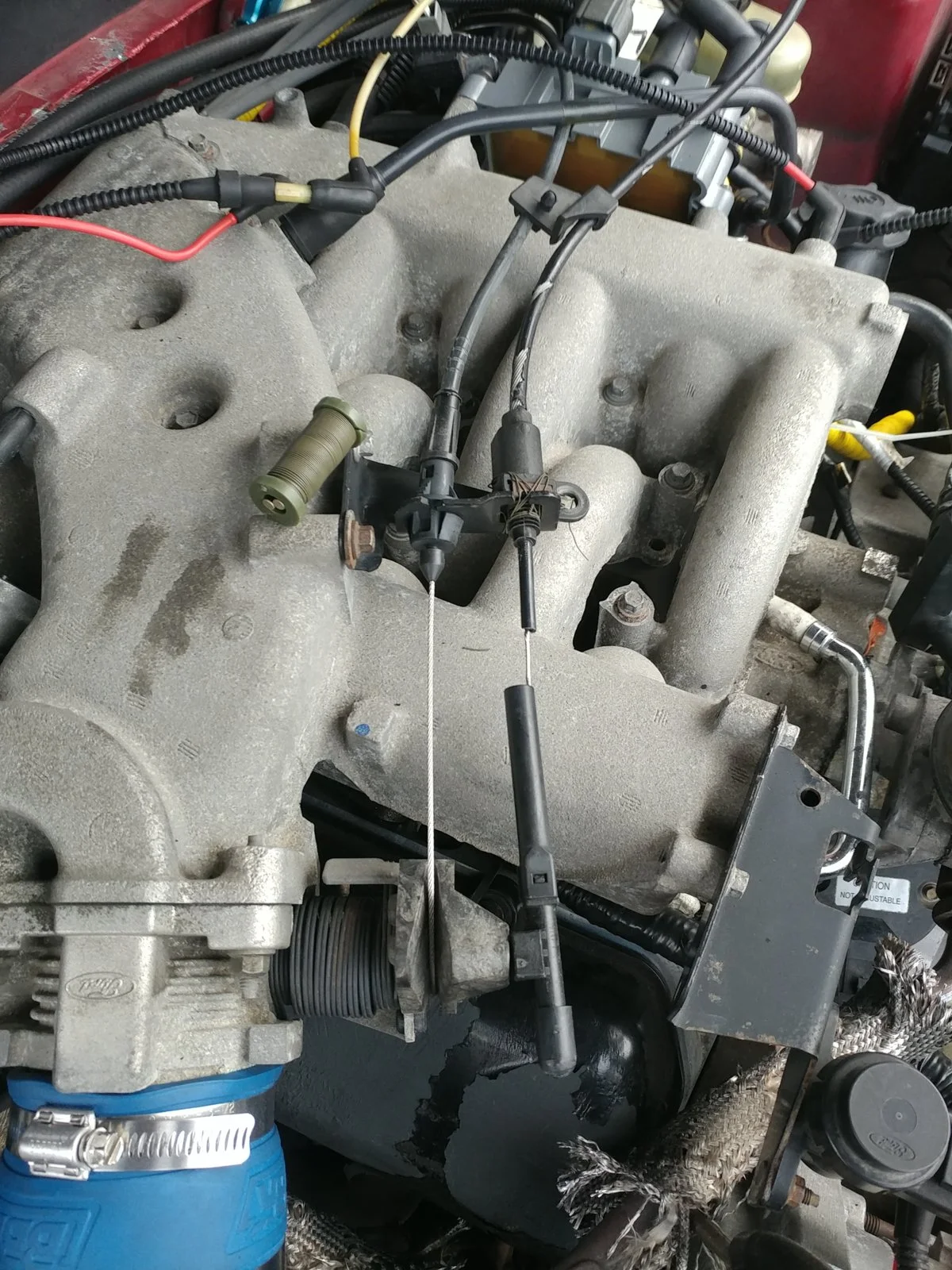

Here is a picture of how I ended up fixing the throttle issue. As you can see the accelerator cable here is stock 2002 on the stock 2002 bracket on the stock 2002 upper intake. The Cruise Control is stock 1995 because the 2002 cruise module is NOT compatible with the 1995 computer.
FIX: For those of you who do not recognize that green spool of wire. It is out of a Claymore Mine from my Army days. It is used for "Trip Wire" to pull a pin and well YUP create a bad day for the bad guys. I happen to have a few items laying around from that period in my life and well re-purposing is always a fun thing to do. As you can see here, I wired that cruse cable into place where it is not going anywhere anymore. I drove it around to test and it seems to have solved the issue without removing the plastic from the cable like I believed I would.

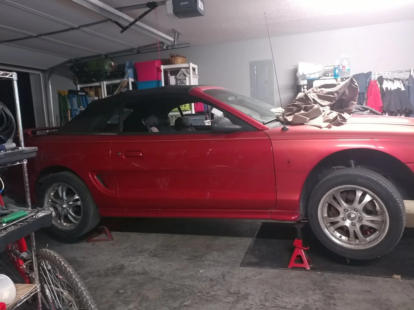

Back In the Garage and on NEW JACK STANDS (No More Cinderblocks) Really, there are 4 jack stands under there, the front 2 are the bran new ones and are on the X member that all Verts are cursed with. It is Level and ready for the Torque Box to begin getting installed.

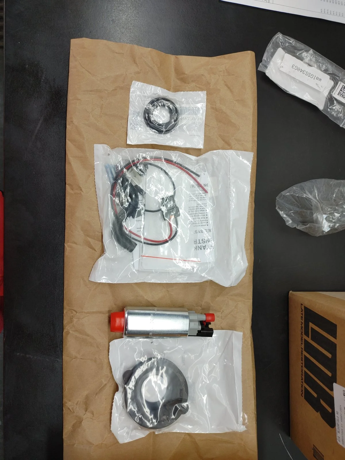

While I have it in the air this time. I will also be installing my new Fuel Pump. Taking out the 155LPH and replacing with a 255LPH Walbro
