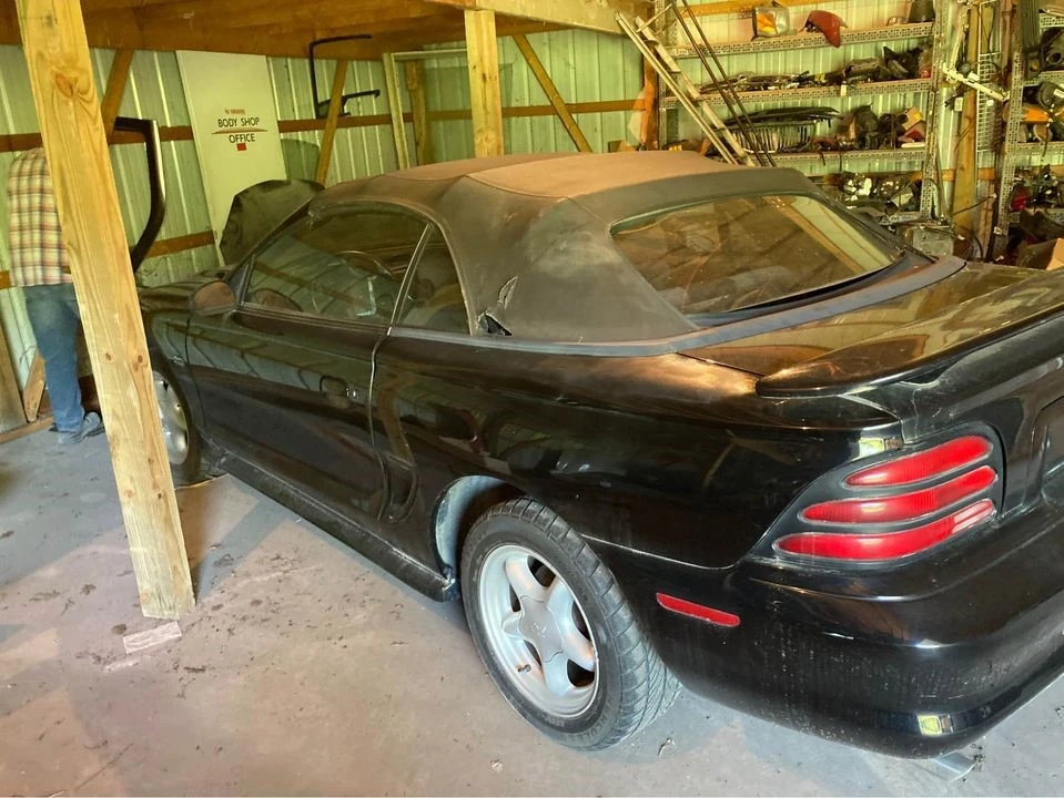

New member guys. Thanks for having me. Bear with me on this...as I am having some serious regret.
Backstory - I have owned a 1994 manual V6 since May of 1995. I bought this car with 15,007 miles on it as a high school graduation present. Spent my life savings on it at that point. lol. It's been in my brother's barn since 2003. I couldn't afford a 5.0 but always told myself I would eventually do an engine swap.

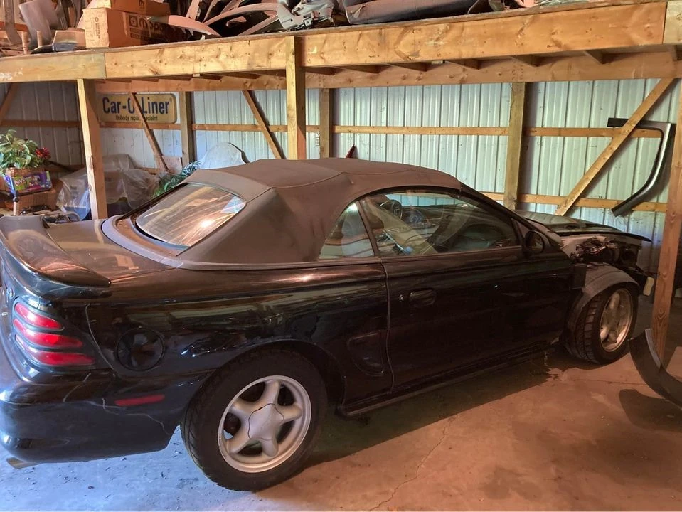

Fast forward to present day - a couple months ago my brother bought a boat and my car needed to go. So....I have to get it next weekend. I was rushing to buy a running 5.0 so I could take both cars to someone who would do the job. Still taking reccomendations...near Flint MI btw. So tonight I go look at a 1995 GT convertible with 92,000 original miles. It was in a fender bender and the front quarter is messed up. It purrs like a kitten though. Sounds great. untouched - and no mods. It's an automatic though! I let myself get talked into an automatic!!! WHAT WAS I THINKING! ??????????
I am having some serious regret about 5 hours after paying the guy $2500 for this car. Someone please tell me it'll be ok and I should enjoy the benefits of an automatic ha ha

Yes, buyer's remorse for sure. I wanted to keep my original mustang a manual. I just saw how nice the 5.0 was and running. I guess it's a $2500 mistake. lol. Maybe I can resell it and get my money.

Buyers remorse isn't really needed in this case. Swapping a 5 speed in isn't a really hard task. The v6 and 5.0 share the t5. The difference is the bell housing and peddle assembly. The 94- 95 peddle assemblies are still around and will work from a v6 or 5.0.
The parts from the donor car are valuable. The front brakes and spindles sell for about 200 dirty...and 400 cleaned up and painted nice with new rotors. The 8.8 disc brake rear from a 94-95 is worth about 400...a little more cleaned up. If you sell them with the wheels it'll get more money. Cleaned up we're talking about around $1200 for front spindles / brakes, rear / brakes, e brake handle / and brake cables, and wheels with rollable tires. If you have time to wait for the right buyer you might be able to squeak a couple more hundred out of them. Cheap pads and rotors from flea Bay go a long way for resale.
Interior parts have also seen a big jump in used prices but I'm not up to date on non- foxbody prices. Everyone that's going 5 lug needs the spindle and rear though and they are getting harder to find.
A good running 5.0 is worth between 600 and 1000 bucks. Not to mention all the other swap parts you acquired. Without the parts car you easily could've spent 4+ grand sourcing parts.
If you can find a mustang specific shop they might do the work for the donor / swap left over parts and a little cash.

90sickfox thanks for making me feel better. Do ya know of any shops in the Flint MI area?
That gt will give you everything you need cept flywheel/clutch stuff.
But that gt would be worth more running and driving than the V6 car, and the cost to have a shop swap what's needed would be a lot.
Will PCM need to be tuned? One shop is telling me to go with a stronger trans....and to go with a Tremec....that the T-5 is junk. And that AODE trans is a slushbox. I moved to Michigan recently and don't know anyone here....wish I could find someone locally who I could trust.

Since your V6 is already a manual, you don't need to find or swap pedals, clutch cable, etc. You will need a 5.0 bellhousing from a 94/95 GT and flywheel/clutch. Your T5 is essentially the same as the 85-89 5.0 T5, not the strongest but definitely not garbage. I would swap the 8.8 from the GT as well. Your donor will have all the wiring and exhaust you need.
I would part out whats left and enjoy your ride.

Kruisr - Thanks for the input. It certainly makes me feel better. I'm torn right now. A friend of mine was quick to say he would buy the $2500 convertible and fix it for his wife/daughter to drive. With only 92,000 I feel like that motor has another solid 60-70K miles before it would need any major attention. I would hate to buy another donor with say 150-170K on the motor and drop it in my car and feel good about it. Still on the fence....decision decisions....
The other way you could swap would be use your V6 as the donor for whatever parts are need to make the GT a manual and get it complete again. Then sell whats left of the V6.
