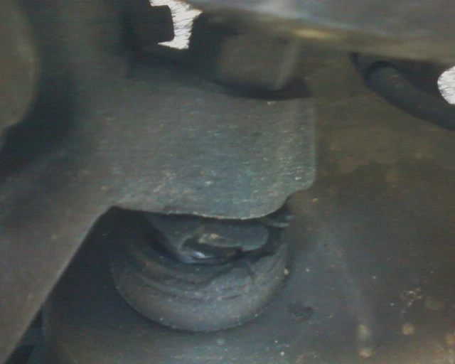

ok up date. got my big phat azz under the car and checked the motor mounts they looked good wouldlnt move under load. drive shaft doesnt vibrate or appears to be fine u-joints good tranny mounts seem good. but when I looked at the front end I noticed the lower ball joints where real bad rubber seal gone metal showing. im gonna post a picture if i can for some reason this site isnt picture friendly for me. cant post photo buckets pics. ok would bad lower shot to heck ball joints cause the car to vibrate and make noise. poping noises?:jaw:
photo of the balls joints.

when I crank the car it feels like something is gonna come through the floor board at the exact moment I started like someone hit floor board with sledge hammer. then after it does that i dont feel anything but slight vibration.
Thats exactly what my car felt like before I replaced the motor mounts. My money is on the mounts. You can always see the engine move when they are bad, I would go ahead and replace them then go from there. Good Luck.
