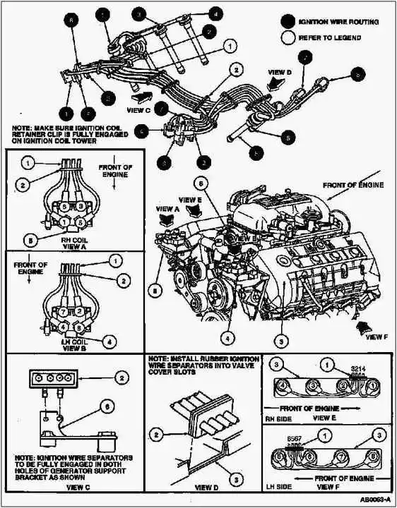

1997 Cobra firing order and coil packs
Same firing order as the good ol' 5.0: 13726548
Passenger side pack:
6 3
1 5
Driver side pack:
7 2
4 8
Cylinder order:
4 8
3 7
2 6
1 5
All views are from the front of the car as if you were standing in front of the radiator, so the passenger side is on your left. Cylinder #1 is the closest one to you on the passenger side.
