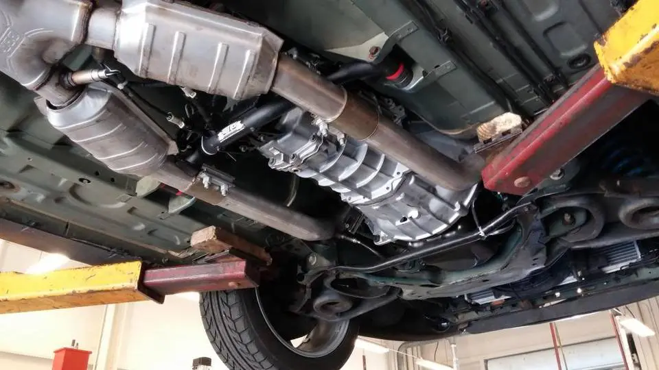

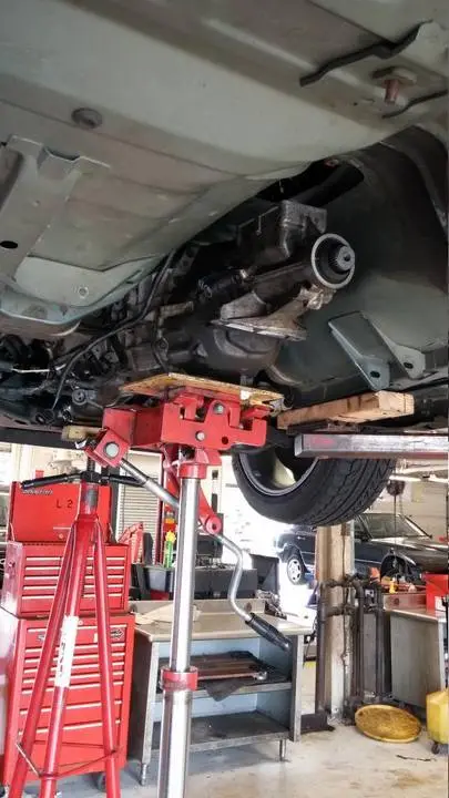

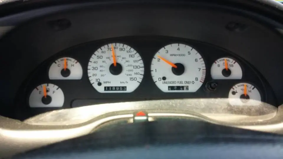

I already had a speedcal and the shifter was cost neutral after selling my tri-ax and picking up a used 3650 version. I am into my 3650 for appx $1250 and I still have my T45 core it replaced. Shifts great up to 6k no problem and the .62 overdrive is great with 3.73s on the highway while retaining the 3.37 1st gear in the t45/3650 to get the 2V off the line.
Pics
Old
New (prior to replacing a cheap parts store rubber 79-95 mount with the poly one)
Cruising with 3.73s
