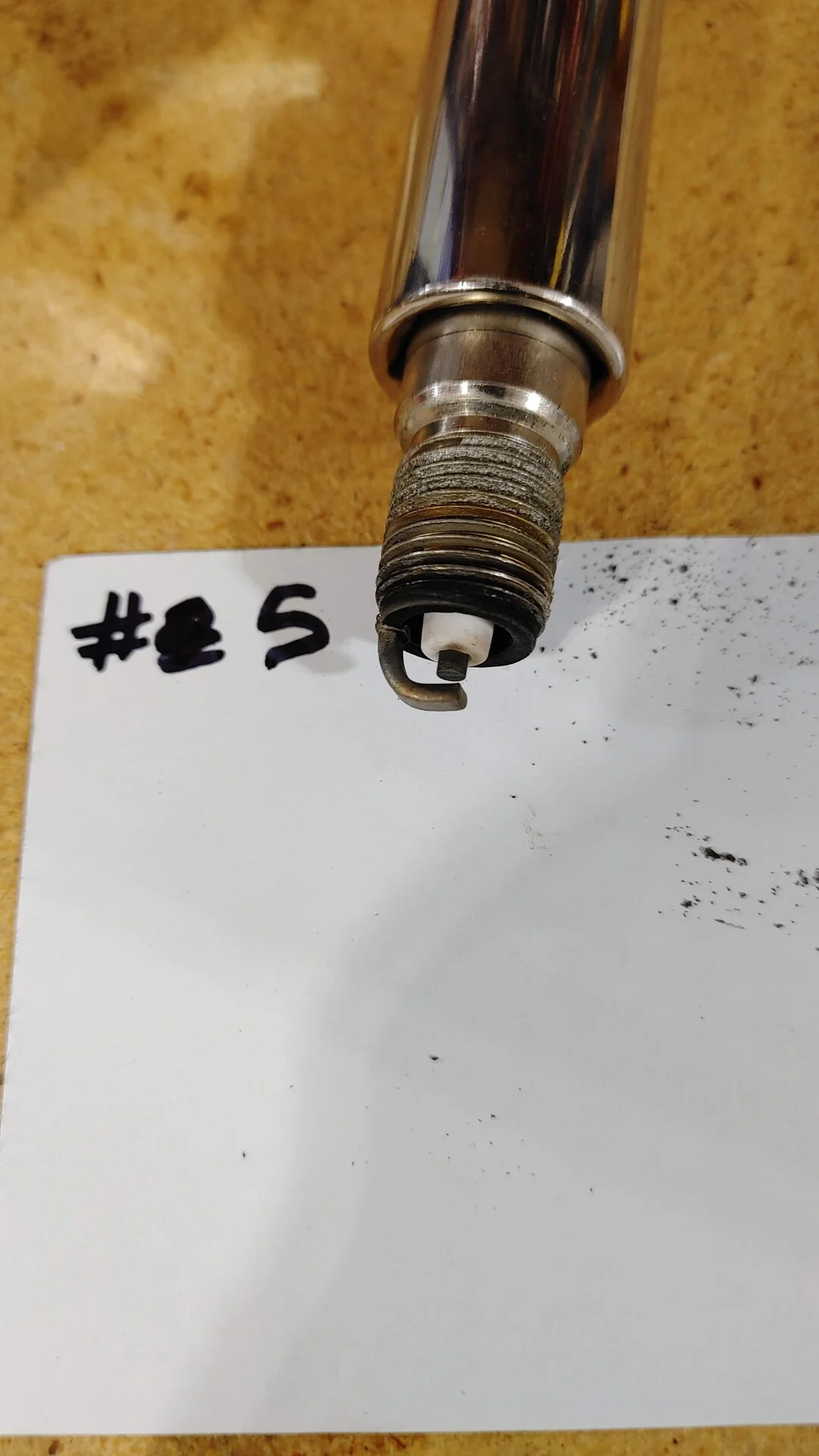

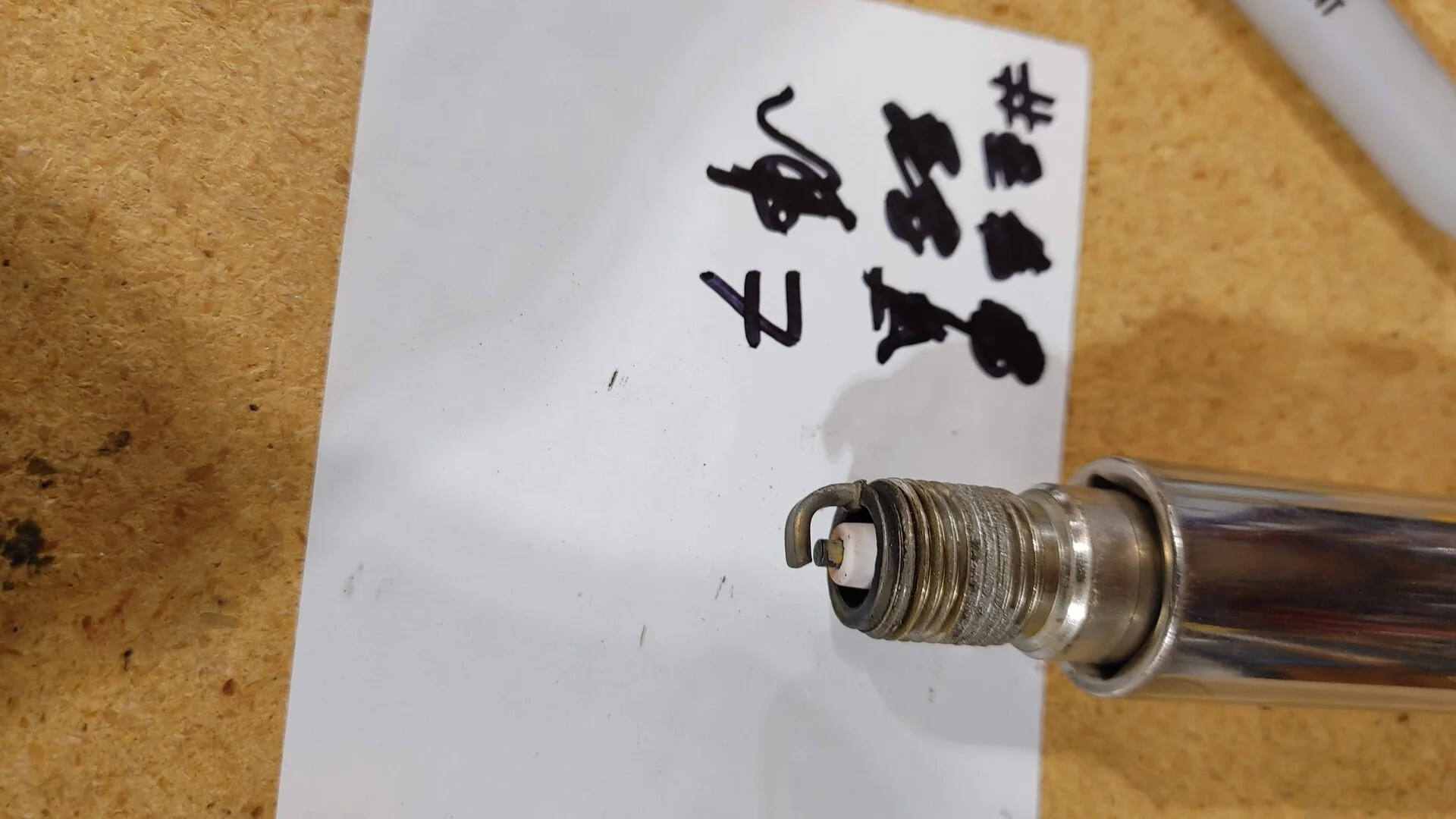

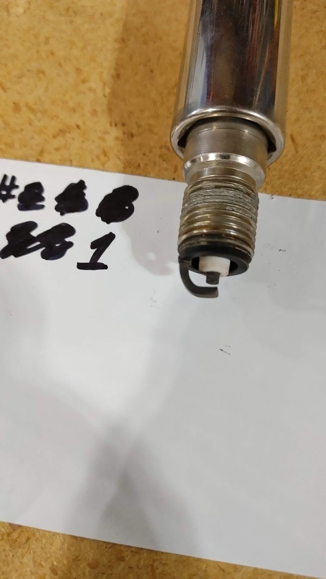

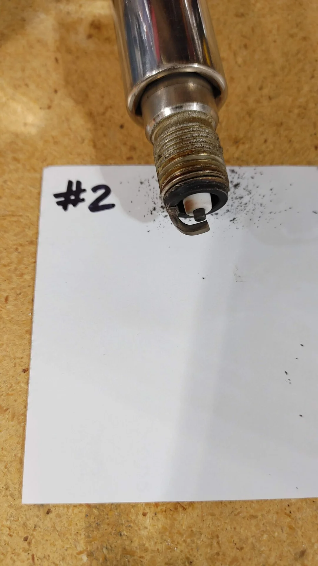

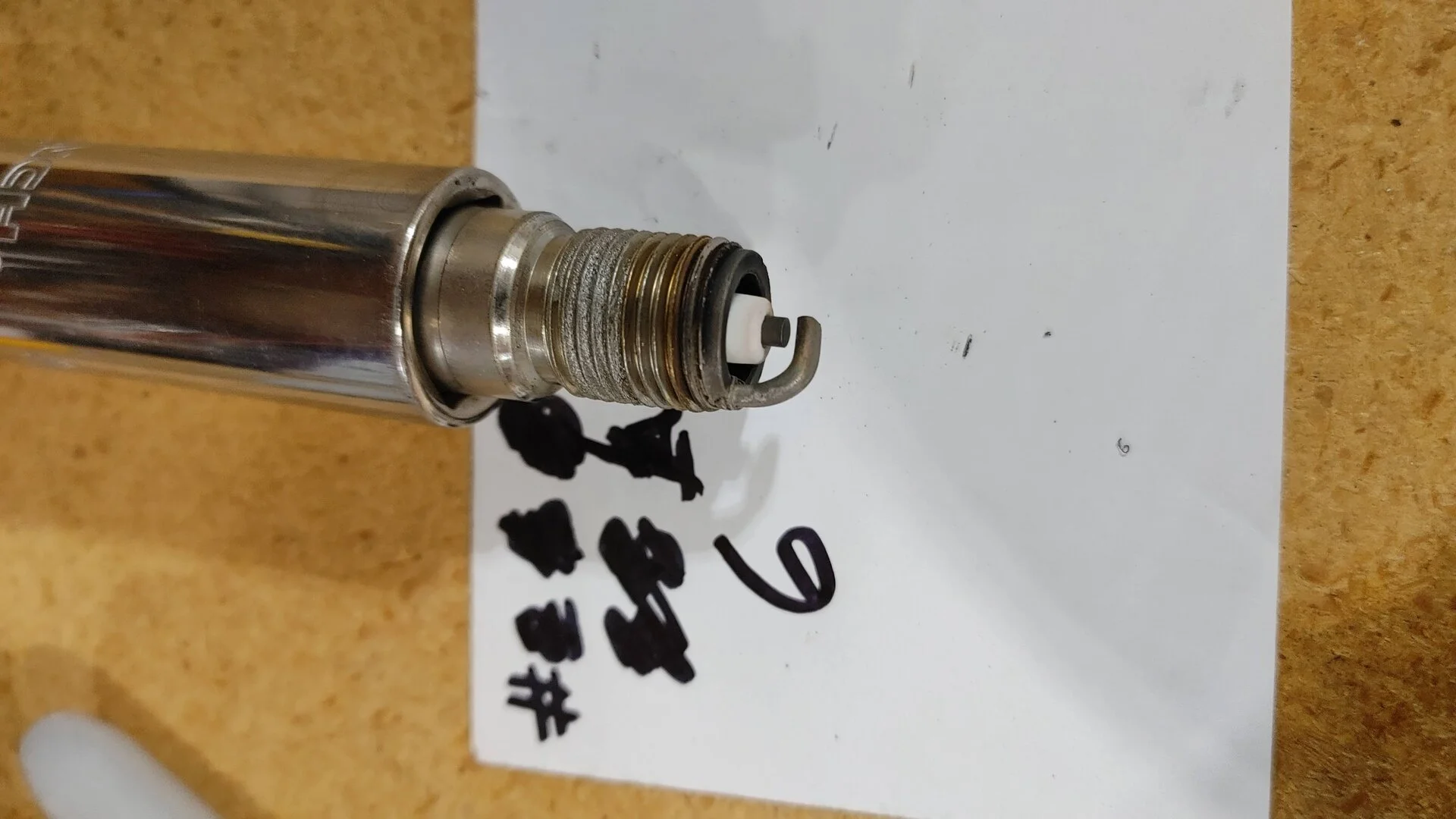

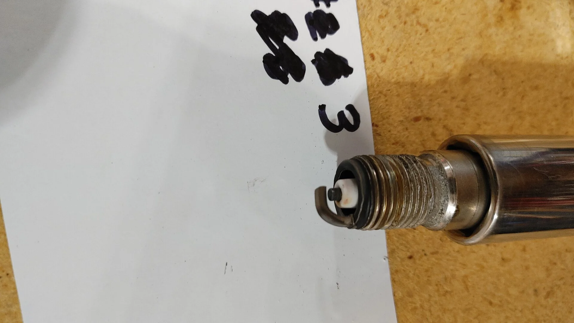

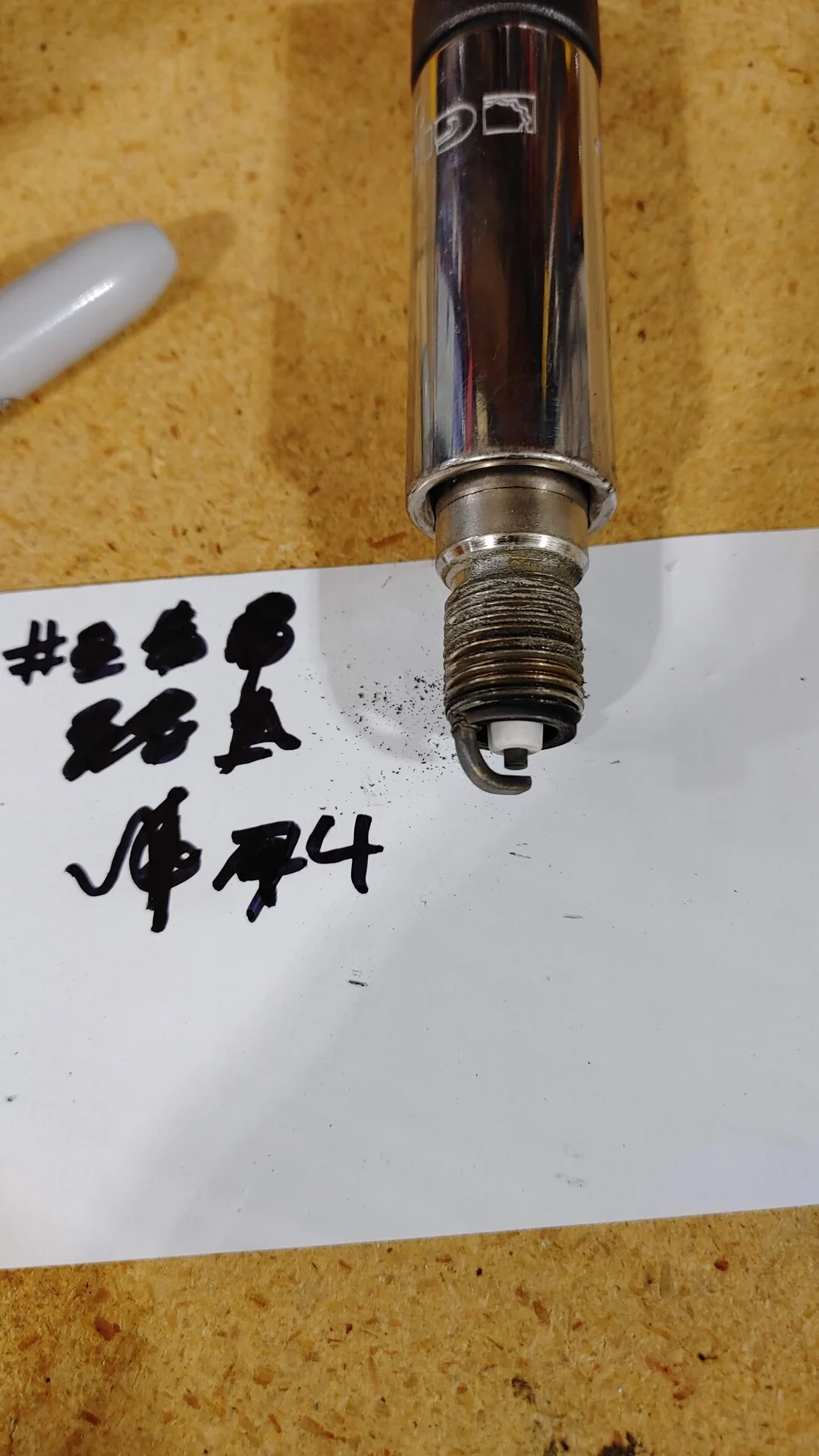

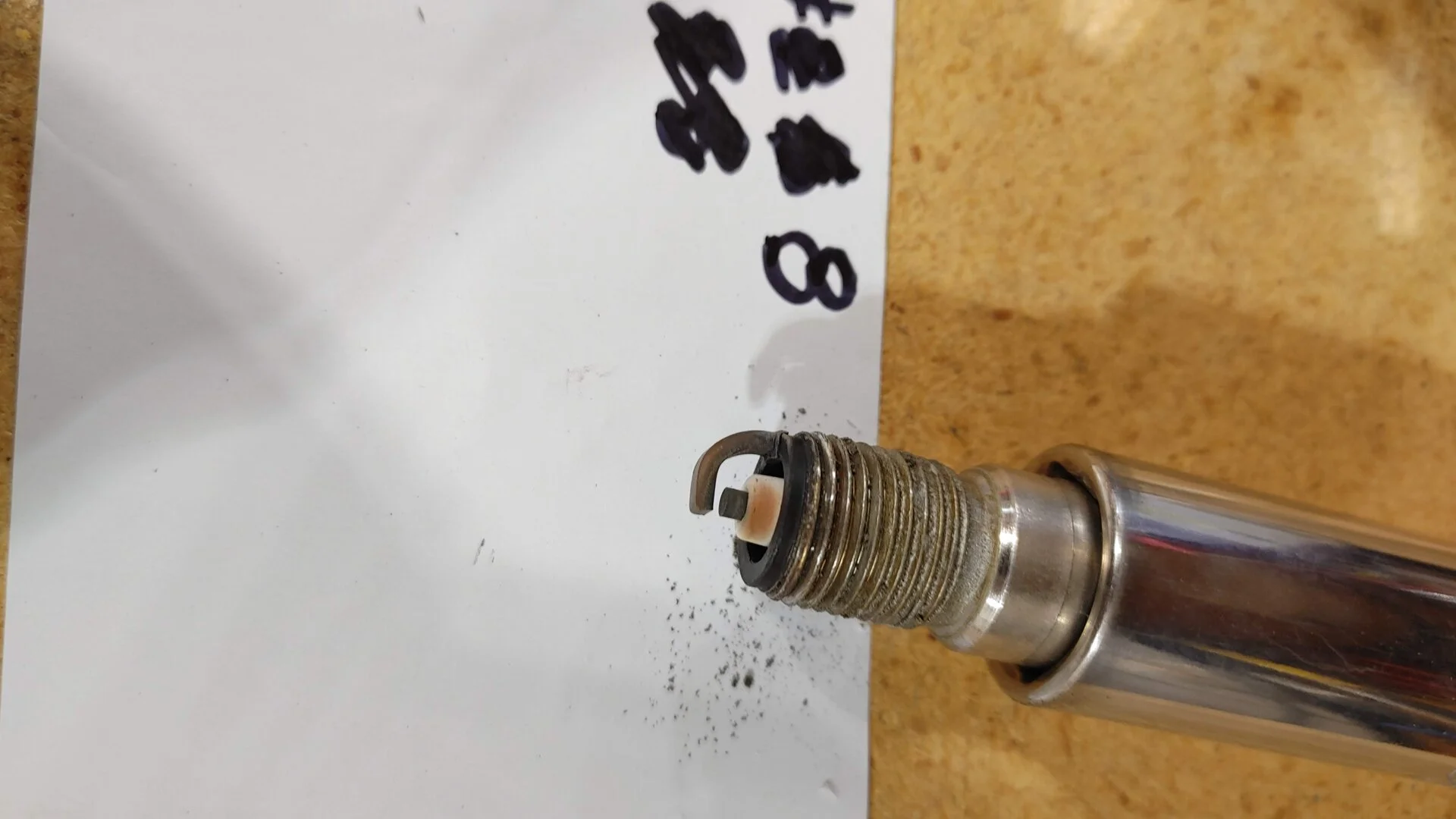

Then, this month it started with a random string of misfiring. Would drive fine and then randomly drag a cylinder/lose power. It would randomly "fix" itself and run fine, then randomly start missing again. I have checked the wires for crossing/arcing in the dark in my garage (sprayed mist of water too). Nothing showing. I tested the coils and they tested out fine. I removed the plugs and took pictures of them (attached). I cleaned the TB (wasnt too bad). Fuel pressure at rails seems to stay consistent at 38ish lbs. I have checked each of the injectors by removing the connector of each while idling and each one i unplugged, made it run worse. Vacuum seems consistent on my boost gauge and I don't see any bad or damaged vac hoses. My A/F reads lean when it is misfiring and normal when it resolves.
Any ideas on what else to check? My scanner shows no codes either. I am stumped at this point. Any help would be appreciated. Thanks
