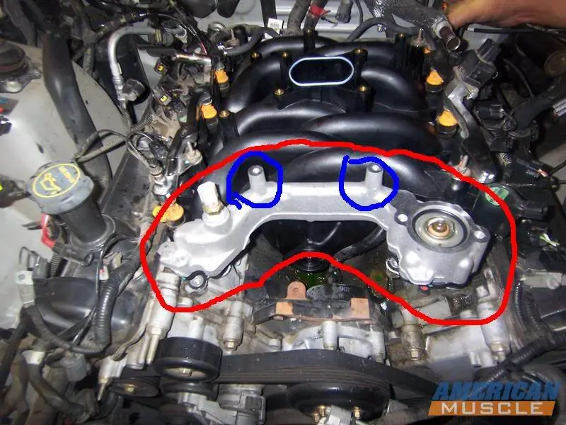

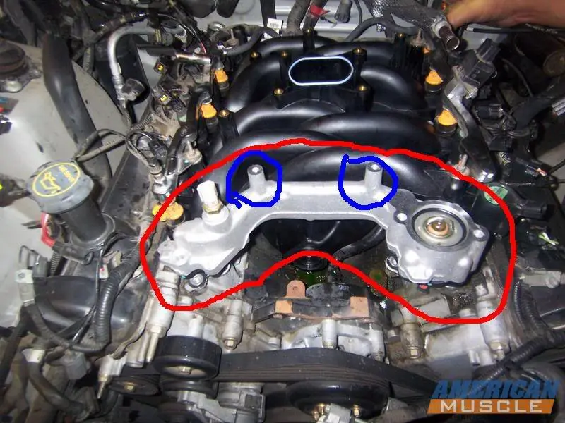

i circled the location of the aluminum crossover, if your car DOES NOT have this your manifold will probably crack. i couldn't find a pic of an intake with the plastic crossover for a direct comparison
the blue circles are where the alternator bracket bolts to and where i *think* it fails (on the plastic ones)
it's all one piece so you have to change the entire manifold, around $200 i think. hell for all you know your car might already have it:shrug:

The intake manifold cracking isn't a HUGE deal. I mean more than likely you won't suffer a catestrophic need-a-tow failure with it. You'll just notice some leaking one day.
A replacement manifold is $200 from summit
http://store.summitracing.com/partdetail.asp?autofilter=1&part=FMS-M-9424-P46&N=700+115&autoview=sku
Not a big deal to change. If you want peace of mind, wait til you have a spare $200 kicking around and buy it and swap it when you get to it. You've gone 8 years with the stocker with no probs right? You could go another 8 years with no prob...or it could crack tomorrow.

Just went outside to look at my engine. I can confirm it does NOT have an alluminum crossover, so apparently I'm driving a ticking time bomb. I think I'll cross my fingers and wait till next year to replace it. I just made a payment for school and don't have that much money in my account. I don't plan to drive the Mustang this winter, so hopefully I should be okay.
Hey Adam, Don't stress over the intake deal. If it hasn't cracked yet it probably won't for a while. I live in Davenport, Iowa and mine has held up to all the weather fluctuations. If you notice your rpm's dropping significantly when coming to a stop with the clutch in or shifter in nuetral than your culprit is the IAC(Idle air controller) It basically regulates the idle under various conditions. For some reason they are prone to failure. I have had my rpm's get so low that the car turned off, thats from the IAC going haywire. If it becomes a regular prob drop by autozone and pay $50 for a new IAC, changing it is the simplest thing you will ever do..only two bolts.
