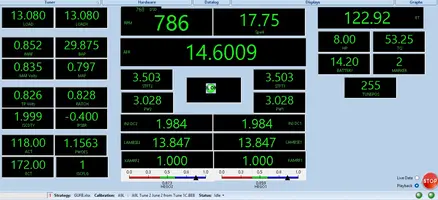

Hello everyone I need help!!
I have a 1999 mustang gt procharged, and other goodies. It idles a little rough nothing to crazy, drives amazing on the freeway, but as soon as I’m coming to a stop and push in the clutch the car dies, i will catch it sometimes and i can keep it on, but more than half of the time it will shut off and it will start up fine like if nothing happened.
I also have a SCT on it and abs is on but no other lights not even Check engine
I am the second owner, I removed the IAC and it was brand new. I adjusted the TPS to .98 and full throttle was at 4.75
I checked for vacuum leaks and can’t seem to find any.
Cleaned MAF
Has a new fuel system and tank.
I don’t know what more to do
Another thing I should mention it only dies when coming to a stop and it’s at normal operating temperature

I can even do it with my moates qh chip and works like a charm.......I rescaled my IAC settings to match my 351w and bumped the IAC down to 1.999% to get max flap control and avoid stalling on decel and also not get bucking on the lowspeed shifts as the IAC is needed for the time versing extra airflow needed between shifts for a certain amount of time...
