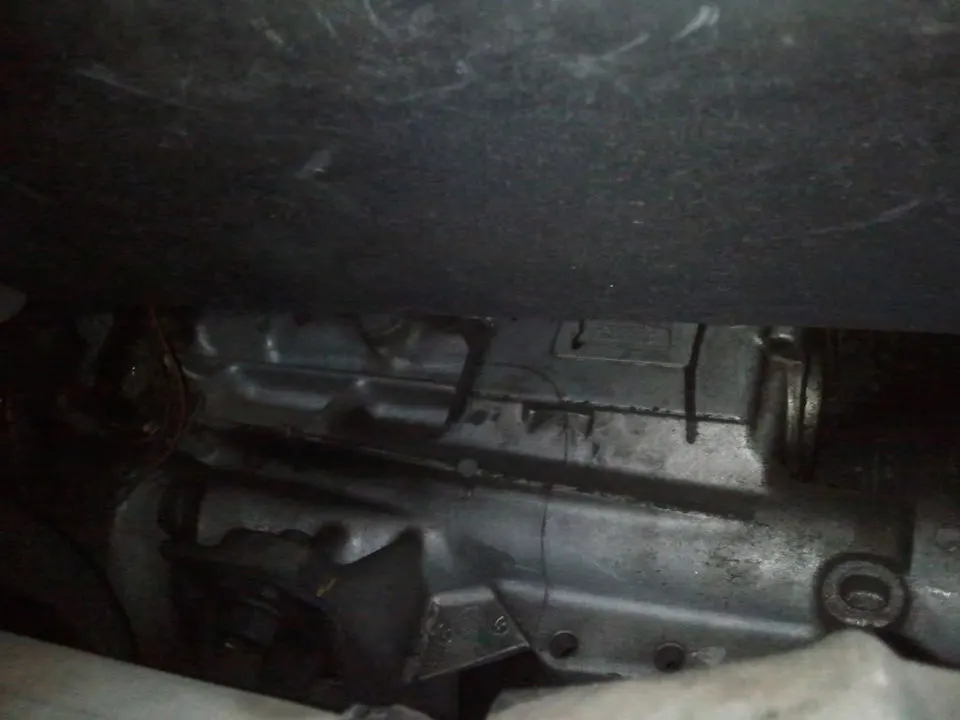

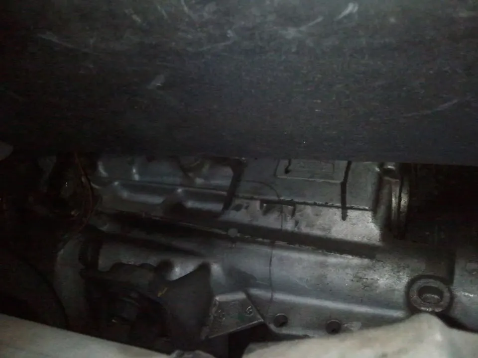

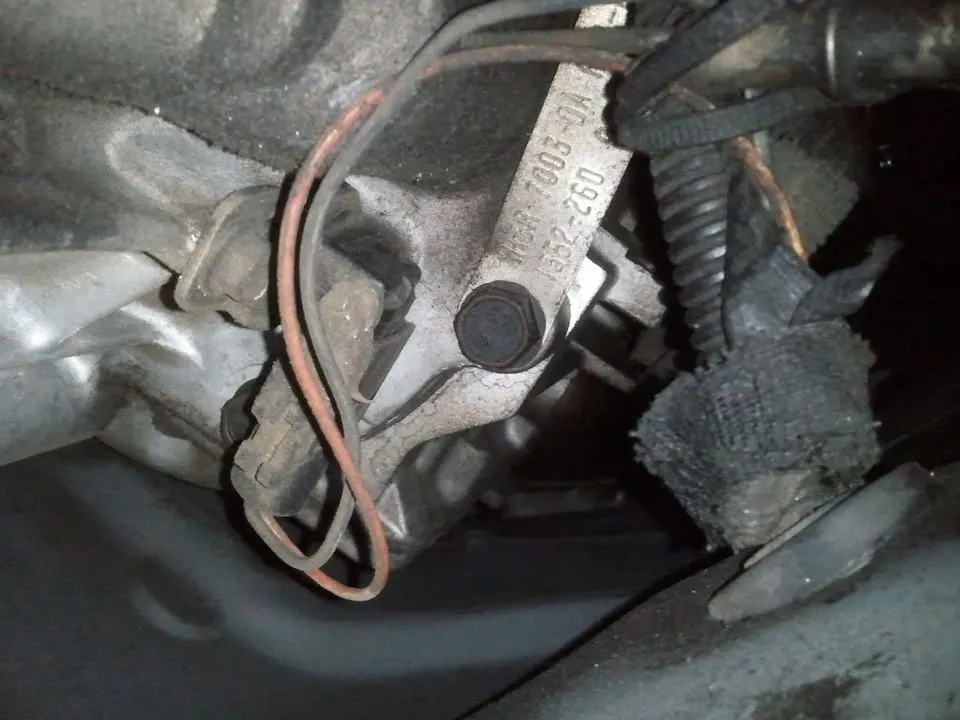

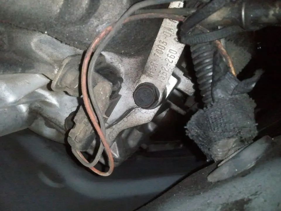

My 89 was originally an automatic. The previous owner converted it to manual and told me that the only problem was that the speedometer didn't work. The transmission works fine but now that I'm trying to fix the speedo the numbers on the ID tag on a bolt on the drivers side says it's for a 1999? is that even possible?
ID tag: 1352-60 the case has "Tremec" stamped into it.

ID tag pic:
Tremec?? pic:
any help is much appreciated.

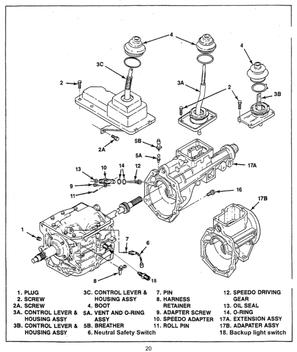

Check out the T5 drawing: the important thing is to see if the T5 you have has the same speedo drive position and type of mounting that the T5 in the drawing has. Take a real close look at item #10 on the drawing: it is the speedo drive mechanism.

WOW thanks Mustang5L5 you are right that's whats installed but mine has the wires for it just hanging. i have been researching the numbers on the tag and its apparently a tr-3650 for a 1999 V6. so now i just need to find a way to get it to work with an aftermarket speedometer. Knowing is half the battle lol.
