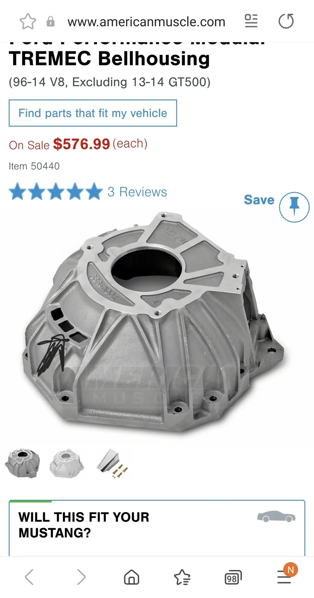

Do these 99 just bolt up to the stock bell housing or did they swap everything when they put this 99 tremec in it.
Bolt up yes, but those 3.8 bellhousing are a bit longer and index the starter in a different spot. Are you sure they are using the SN95 bellhousing? You’d have to swap the input shaft so you need to be sure
it’s in your better interest to use fox-specific parts as much as possible. Everything will just fit better.

yep 99

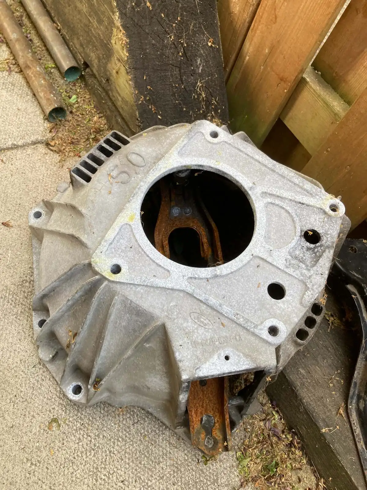

I just did an auto to t5 swap. My trans is a 13-52-238 coded from a '96. I used a 5.0 bellhousing from a '95 (so that I did not need to change input shaft). SN95 bellhousings have the engine displacement case into them. V6 bells have 3.8 cast just below the vents highlighted in the post above and V8 bells say 5.0. This clocks the starter appropriately and allows the correct flywheel (157 tooth for V8 vs 164 tooth for V6). I did need to shorten my driveshaft an inch to fit.
