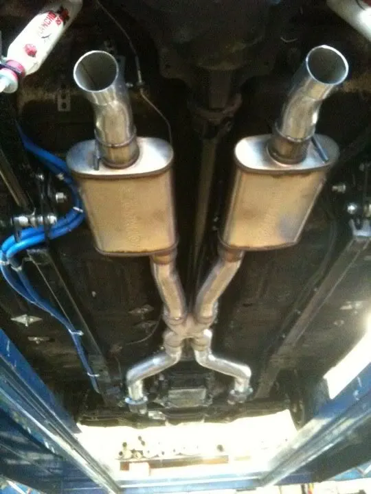

Heres my setup. Hooker super Comp Headers with 1 7/8 primarys with 3in collectors, 3in custom x with 3 in magnaflow.:nice: i have video, but id like to get a better video for public. Blown65 has heard it though.
BTW, my fuel line is moved now. That was installed long before the exhaust was during the build. 10AN to the front, 8AN return.
