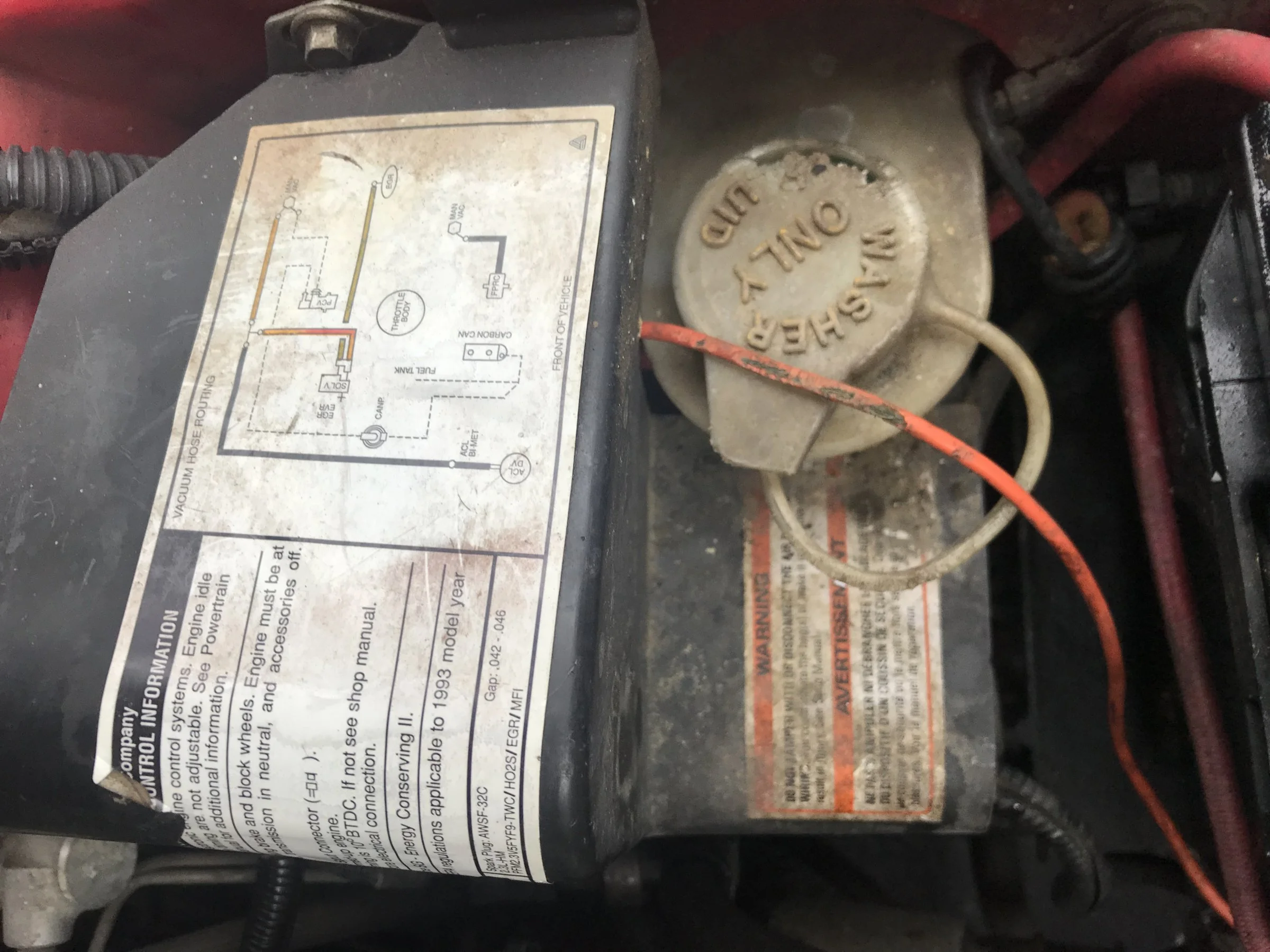

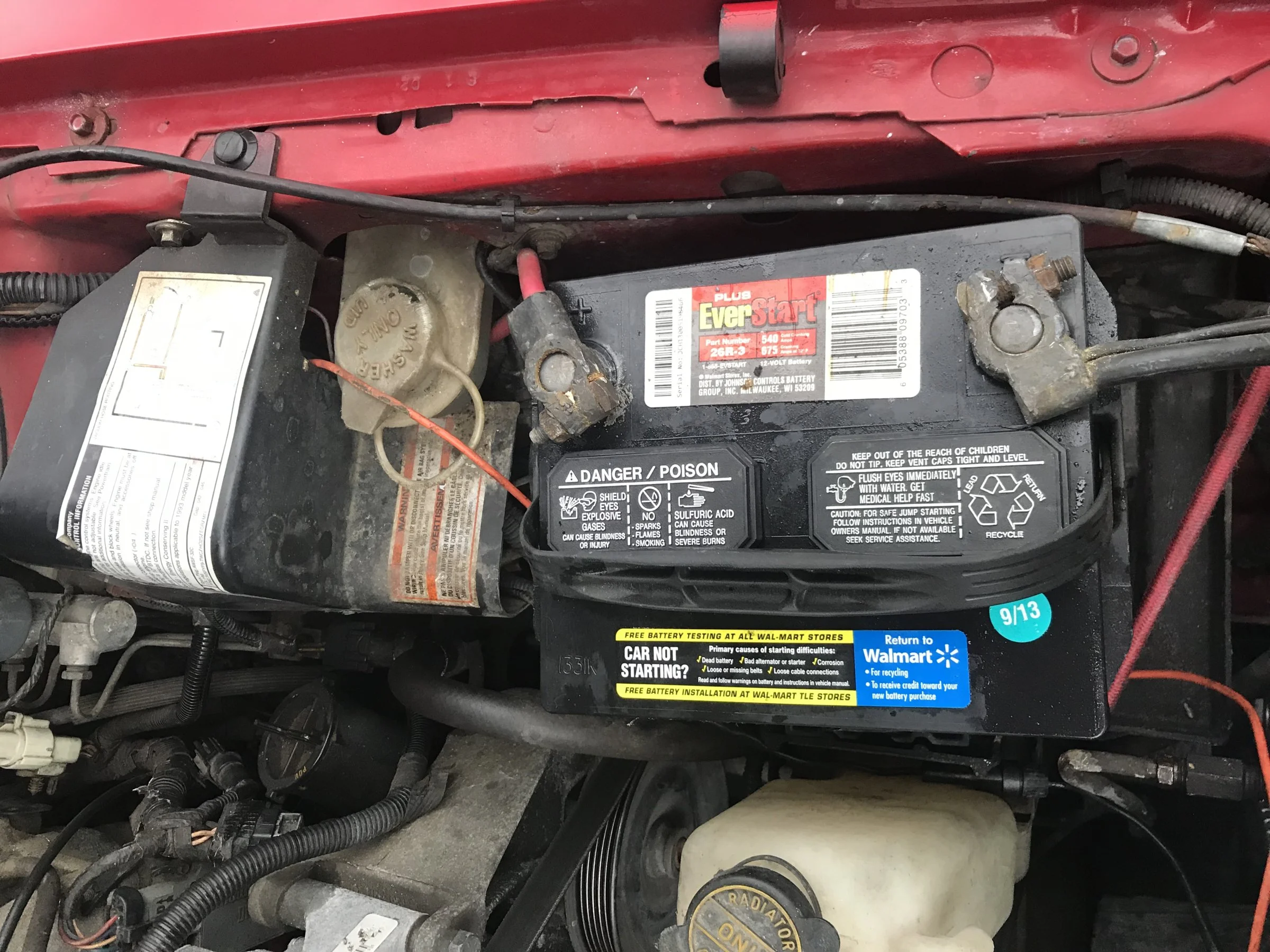

Where does the orange wire go? One end connnects to the silinoid and the other end is just tucked under the battery

Before you start buying a bunch of sensors, start with fixing the coolant temp sensor. If your car doesn’t know what temperature it is running, it will cause the exact problem you are describing.
I can’t link it here but google “93 mustang 2.3l coolant temp sensor” and go to the first allfordmustangs link and there is a picture showing the three temp sensor locations.
If the car thinks it is running too cool then it will richen up the fuel. Fix that, then see what comes back.
