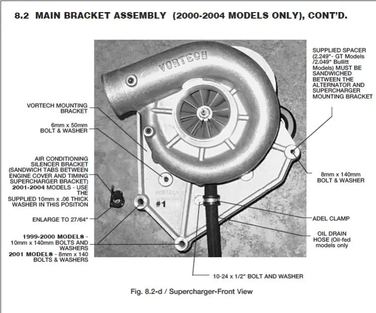

Here is what I think it may be. I think my tensioner is working alright but when it first broke I asked a friend who put these kits in a lot to clarify the instructions (shown below). Vortech clearly specifies that on 2004 models you sandwich a .06" washer in place of the air conditioner silencer bracket however below that there is another mounting hole and the instructions do not say whether to use a washer or not they only say what to do on 1999-2001 models. The first time I did not include a washer there but this last time I put a washer there since I was told there was one suppose to be there as well. Does anyone with an 2002-2004 remember what they did at this step?

To answer my original question does anyone know if a washer is sandwhiched between the bracket and engine cover in the bottom most mounting hole (see my attached picture above). The instructions from Vortech are extremely vague and I think that may be part of the problem. Also once I figure that out I want to double check that my belt is the correct size before I order one from Gates. I am currently running a 108" with a 3.25" pulley what is everyone else running? Hopefully the new belt, correct spacing, and new tensioner should solve my problem for good.

on my 2002 I do remember having to put a washer between the timing cover and bracket on the bottom farthest left hole , if you bolted the bracket up without anything there you could see a gap between the bracket and the timing cover so it was obvious it needed the washer to space it correctly

I had the same problem and found out it was becuase of alignment. The mechanic who worked on the car also put in a washer behind the tensioner belt but we found that it misaligned it. Removed the washer, no more problem.
