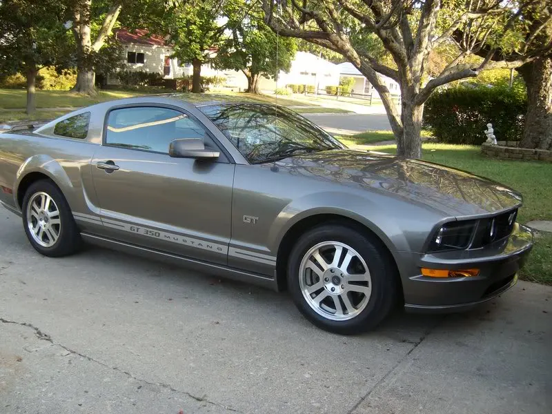

2nd question is, i keep seeing pictures of GT 350 mustangs, 05-09 body styles. might i ask what these are ? i've seen them alot but i don't know what's different about them & doesn't hurt to ask..

The second question, I am assuming you mean the Shelby GT, there is no factory car called the GT350. But the Shelby GT is a standard GT with a different grill, 15 more horsepower, a 3.73 rear end I think, an upgraded suspension, a californa special front and rear bumper. There are some other differences, but thats the basic idea.

ok. i just saw a few pictures here and there that have a GT350 sticker on the side, so i figured i'd find out what it's about.

There is no 350. It's just a custom sticker.

It may be dumb and pointless, but it does exist.......
Mine had a GT350 sticker on it when I bought it, and I've seen a few others that have them too, but not very many. As far as I can tell, it was just another one of those useless dealer packages. I don't think that there is anything special about them except the sticker, and maybe a specific trim package. Nothing performance wise, and they definately don't make 350 HP like the namesake I'll probably end up taking the stickers off when I do my chrome badging in black nickel plating...but it is funny to see peoples reactions to it. The average Joe doesn't know that it doesn't make 350 HP.....LOL

Well there are 2 different types of GT350 stickers. There are the small GT350 stickers that go between the door and the wheel well. These are aftermarket sticker sold by different places to look like the original GT350 stickers. The ones that are on my car came on it new, and like I said, were most likely some special dealer package. I would never put an aftermarket GT350 sticker on my car, since there is no such thing as an S-197 GT350. But since my car came with these on it new, it makes no difference to me that it has them. I may take them off just because I prefer a more plain, clean look.

and with the GT350, i would go with taking the decals off too. only because, yes it looks better, & 2. i would hate to hear the nagging from all my other guy friends about how it does have "350 horsepower" idiot.. i know it doesn't.
