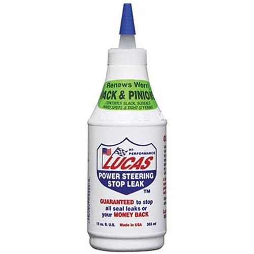

Yup, pump or Lucas time. You'll have to bleed it again.
At work I get paid again to R&R the pump again. Doing them at home for friends and family, I always use Lucas on remanufactured Ford pumps.
