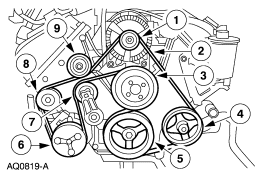

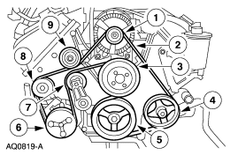

a) No, neither is left-hand thread.
b) Torque isn't critical. Just do them "goodntight." Go back and check them after a hundred miles if you're worried. It's about 18 ft-lbs so think how you'd tighten a spark plug and just do that.
c) You can use this for reference:
d) The nut holding the bracket for the dryer can be remove and the dryer bent slightly out of the way for clearance without issue.

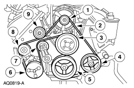

Thanks again trinity_gt for all your help! Replaced both pulleys today and the car sounds much better. Everything is working as expected.
