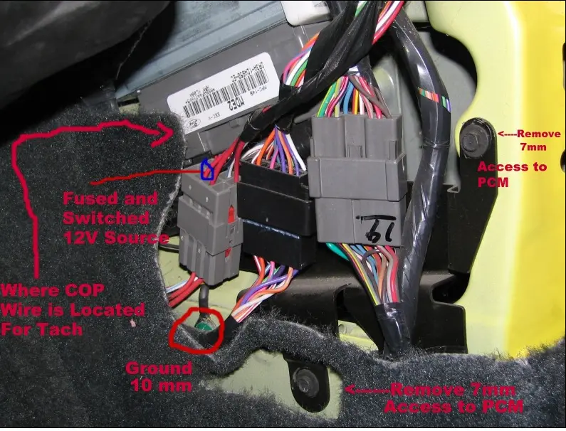

squeak93
Jun 2, 2005
2,352
418
164
Joplin, Missouri
Apr 24, 2026
  • Apr 24, 2026
Pcm should have a bracket and two bolts to hold it to some Jnuts in the body to keep it from bouncing around etc.
You can see them in this unrelated wiring pic:
