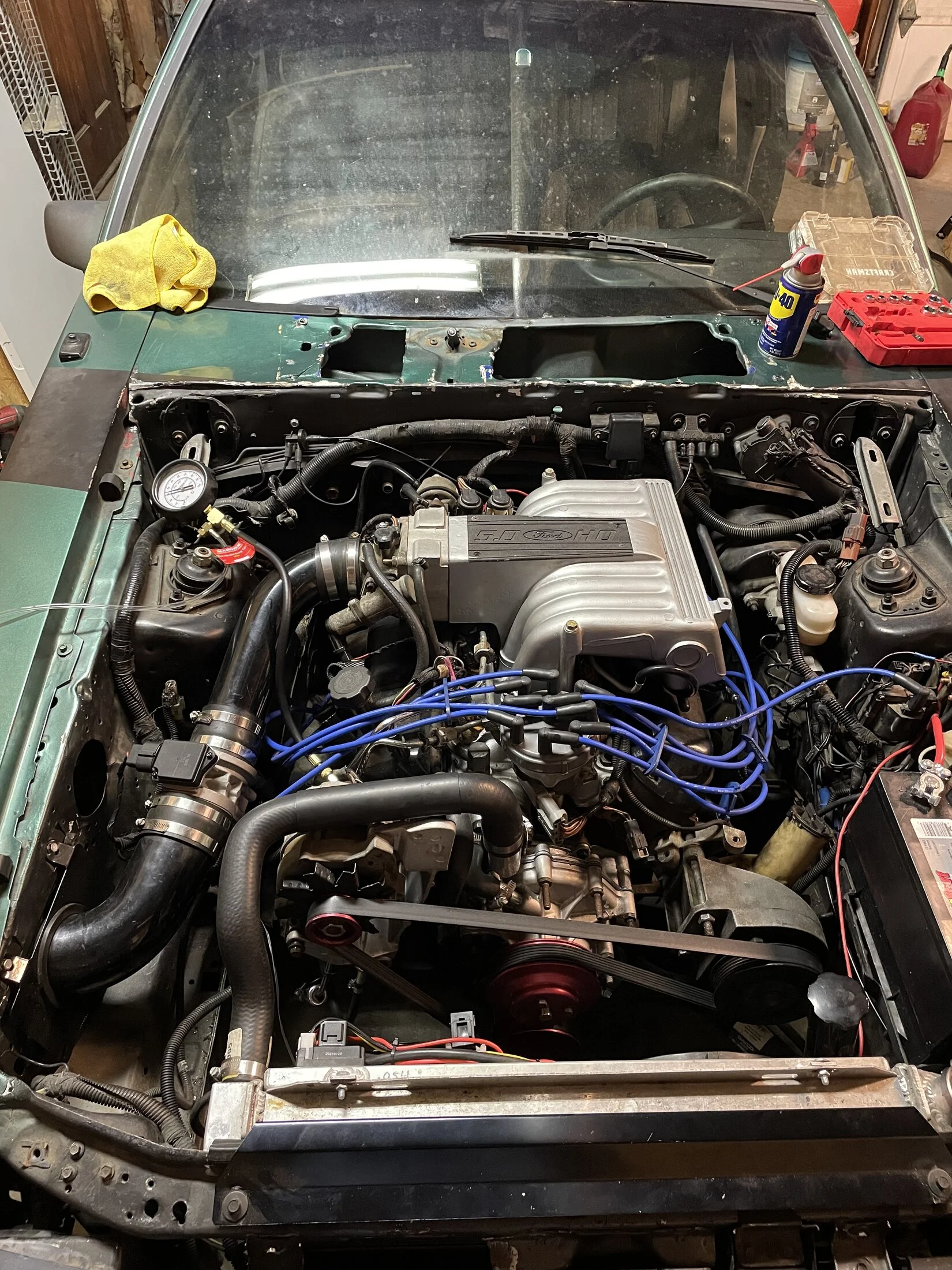

here’s a pic of the engine bay just for attention, or if there’s something obvious I’m missing!
So we checked the fuel pump at the rail, stays at a pretty solid 30 PSI and goes up to 40 when pump is first engaged. Stays at a good pressure while (shortly) running too. At least that confirms the pump is good, and that it isn’t leaking down.
