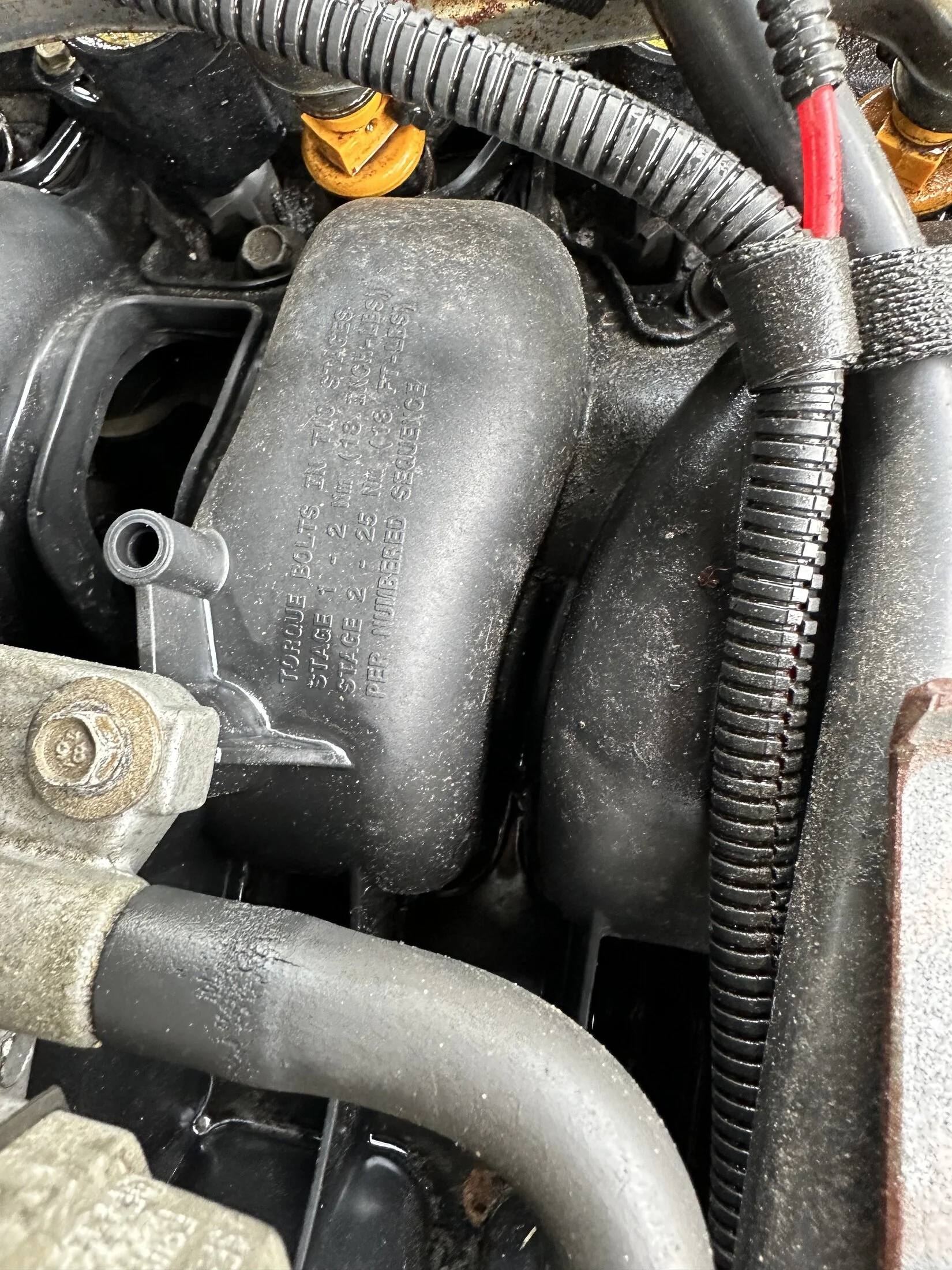

2000 GT:

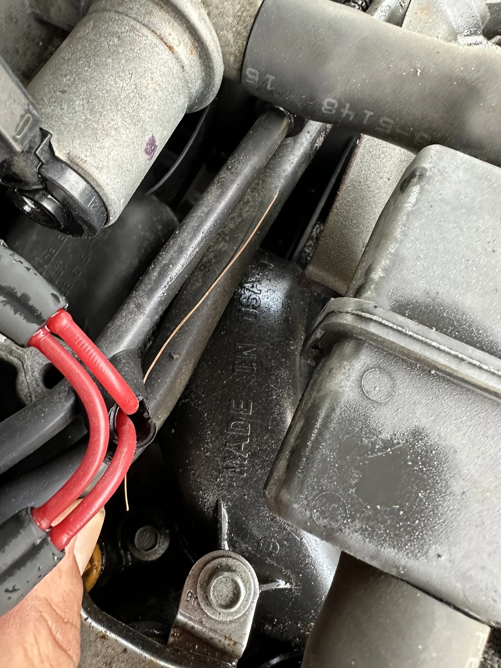

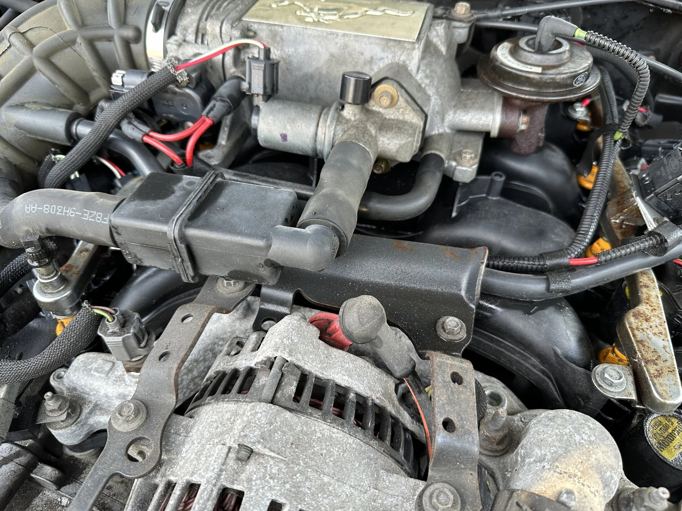

Also looks like it has a Dorman intake on it. These are known to rob a few HP and just be junk overall

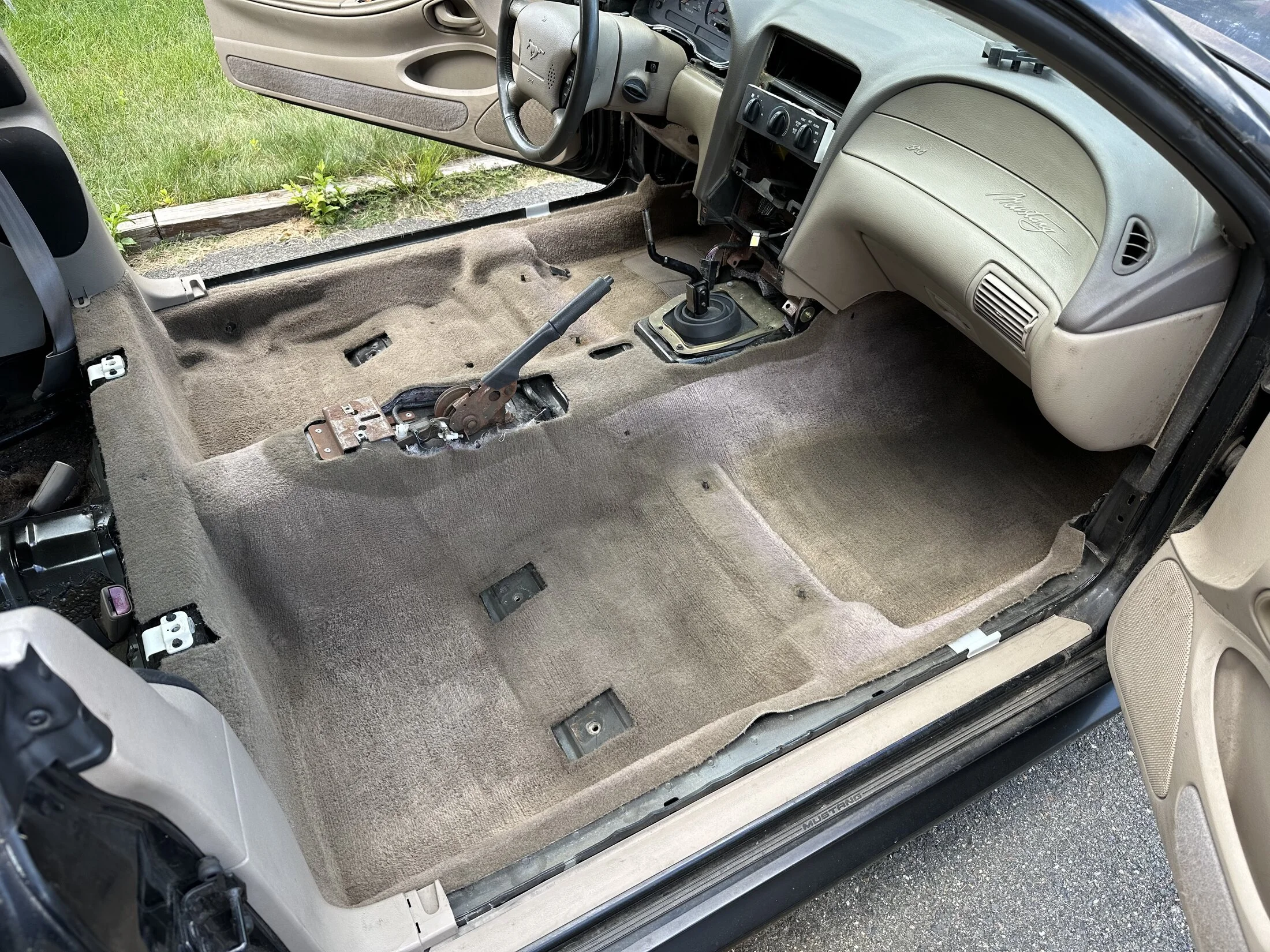

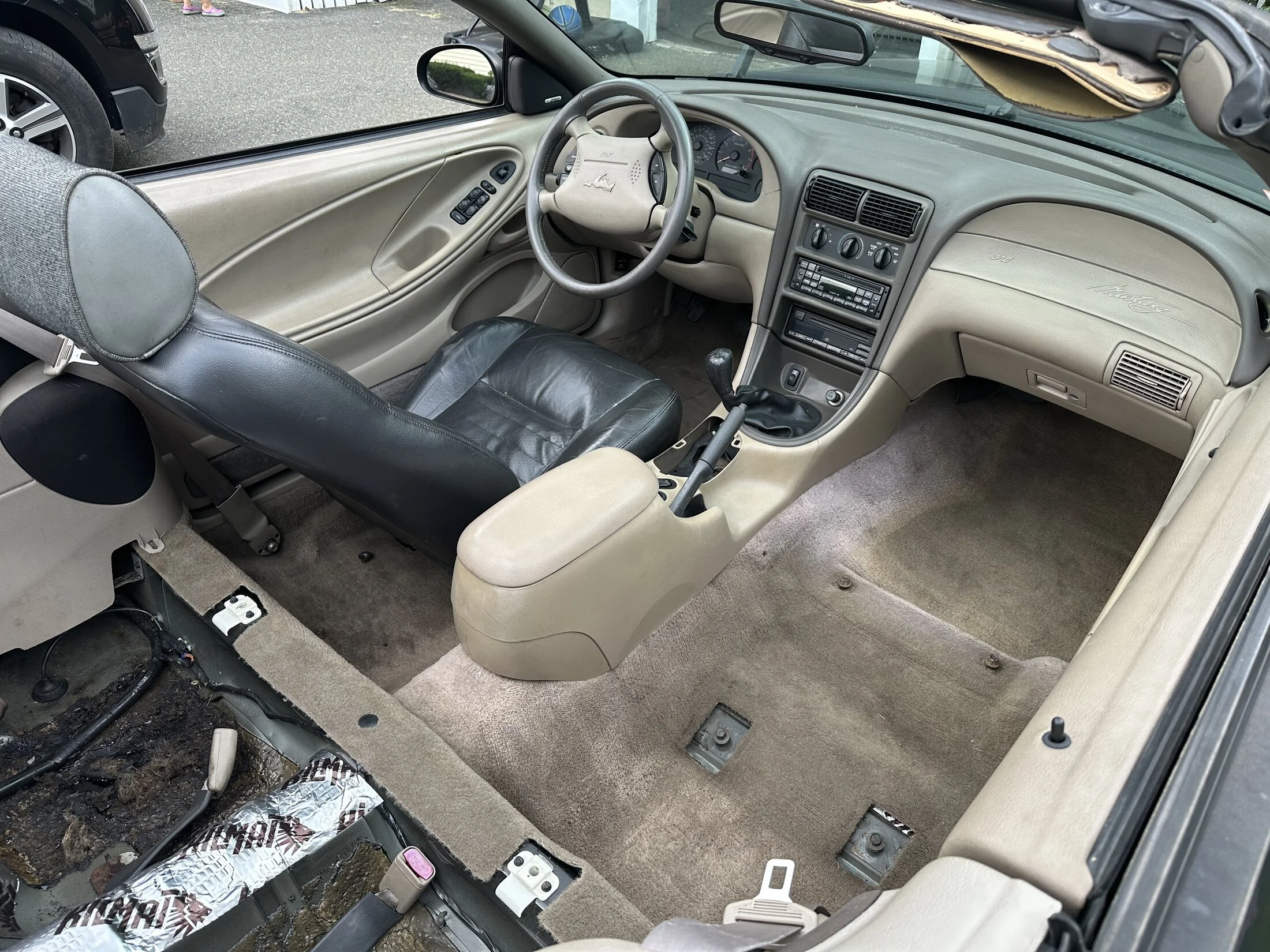

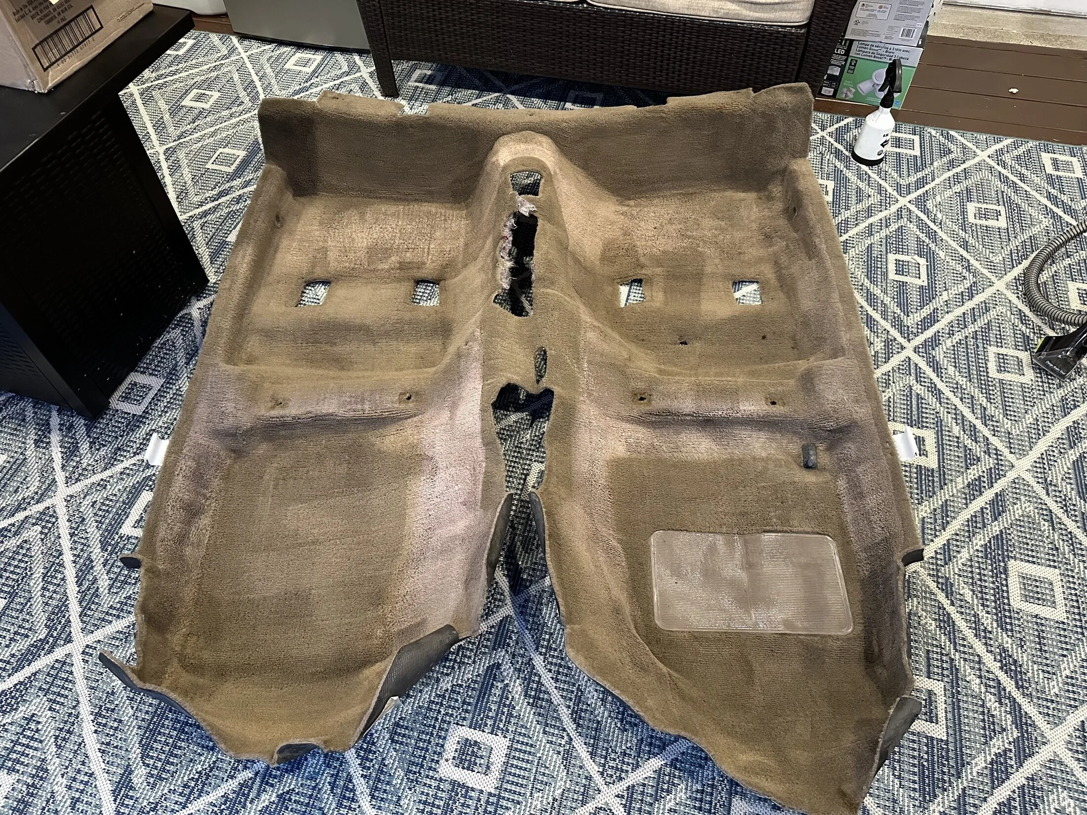

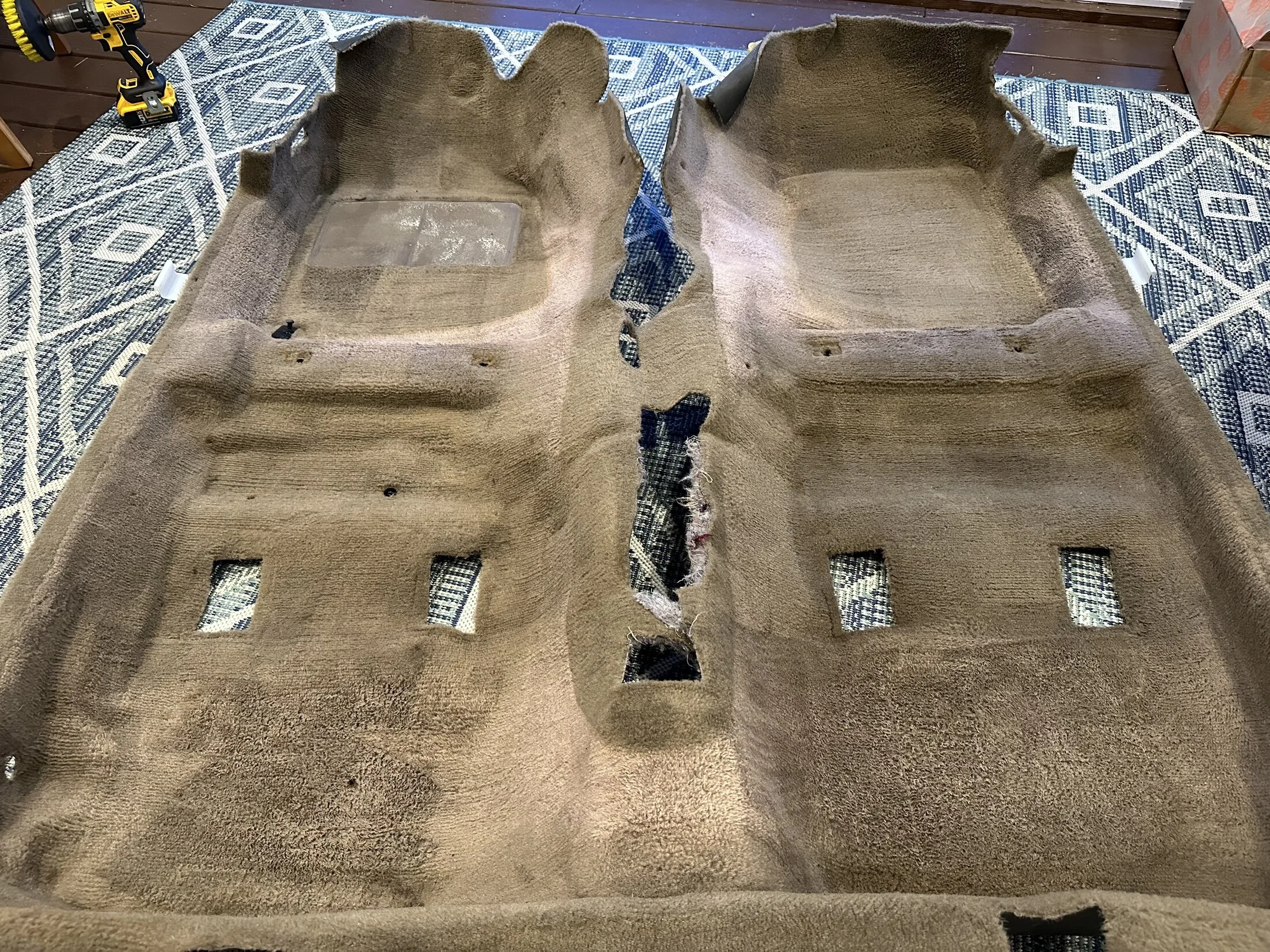

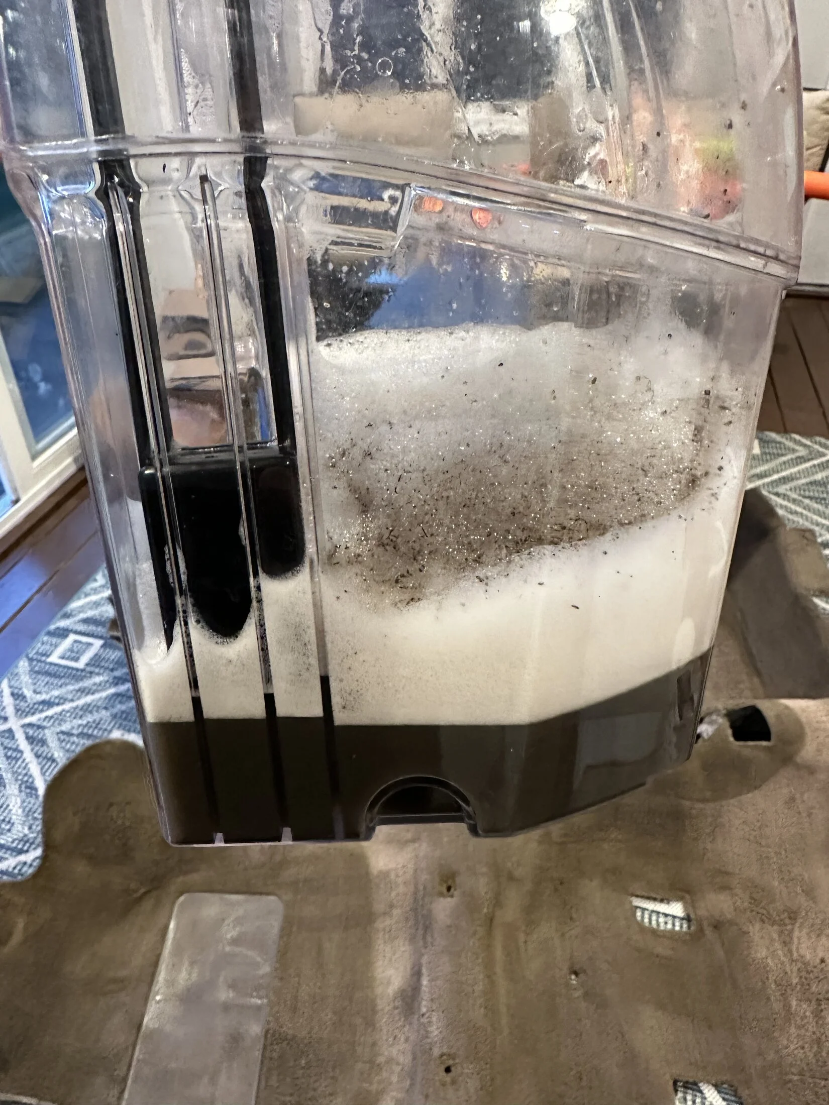

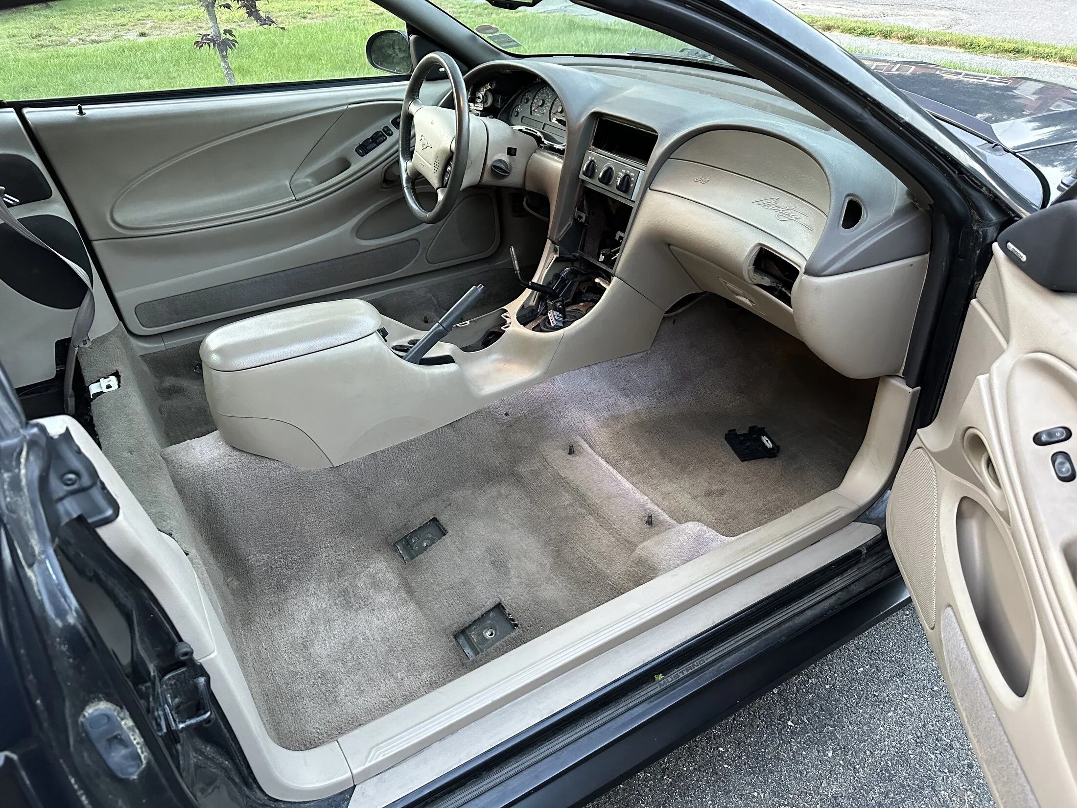

After some work with the Bissell
Need to let it dry out, and probably some touchup once I get it back out into the car. But the majority of the stains gone. Carpet is sunfaded, but it’s much cleaner. I might replace this at a later date but good for now. I figure some fresh floor mats will help. But this looks way better in person.
A few buckets of the above came out of the carpet

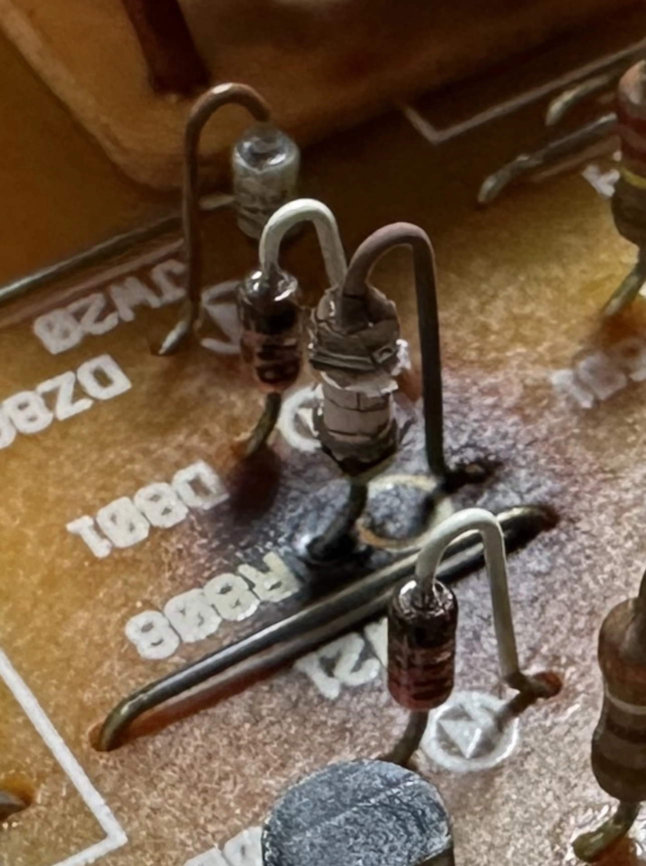

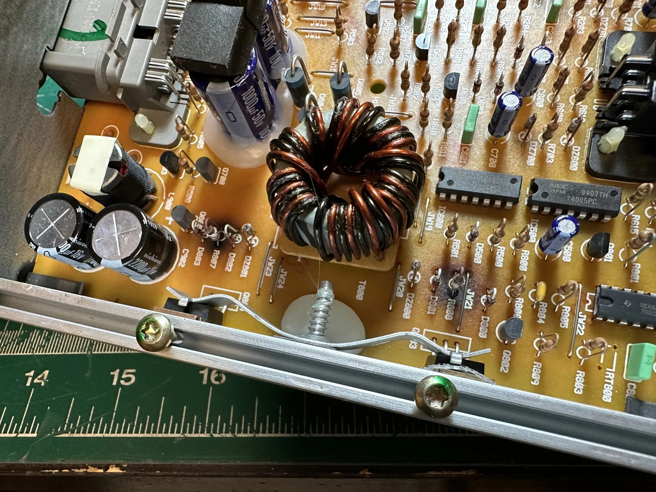

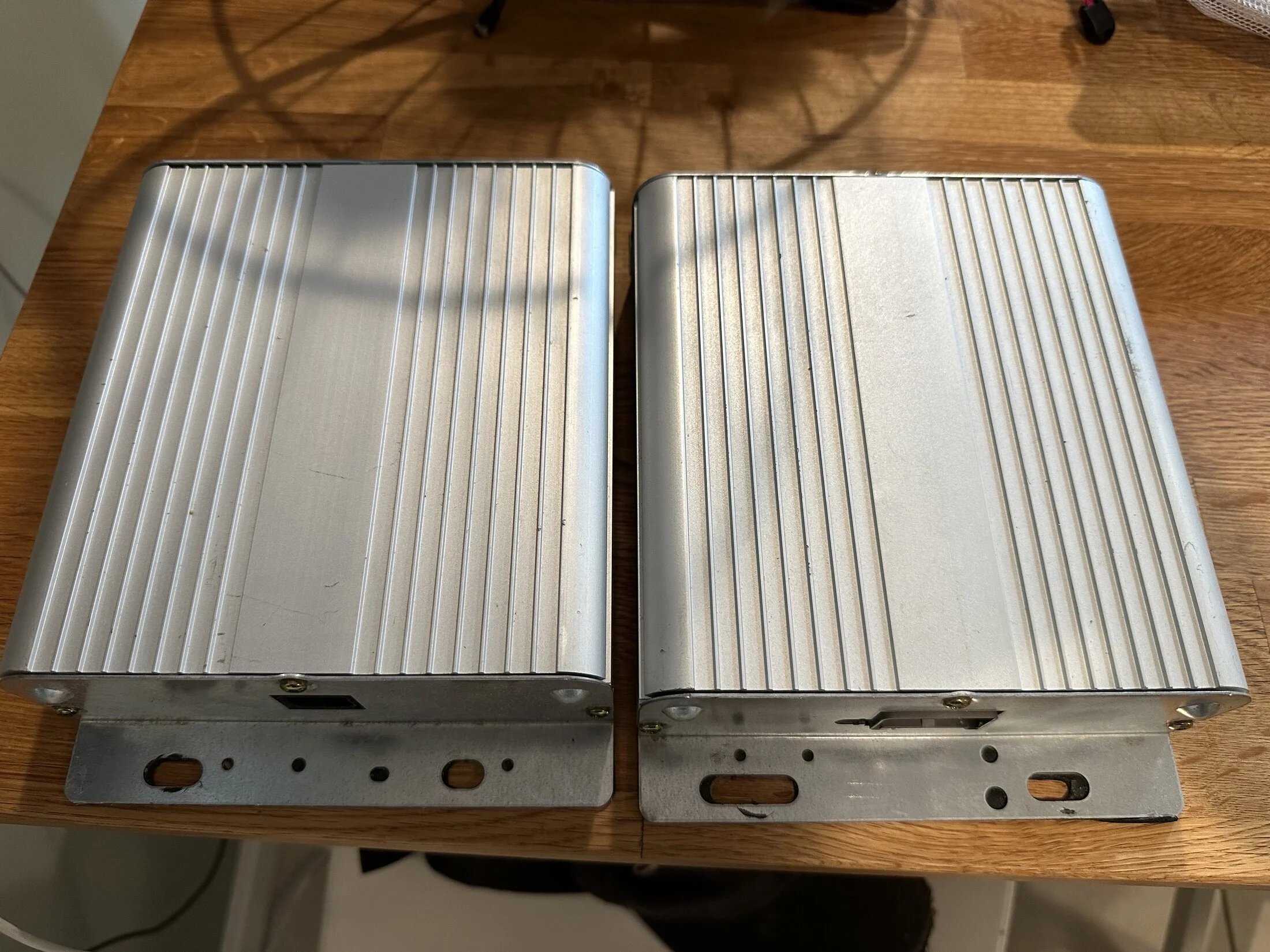

Was curious about the Mach amp so I opened it up. Immediately say the problem. Two burnt resistors
Definitely was cooking
Won a pair of amps on eBay for $40. Gonna open up the hood amp to compare now that I saw this

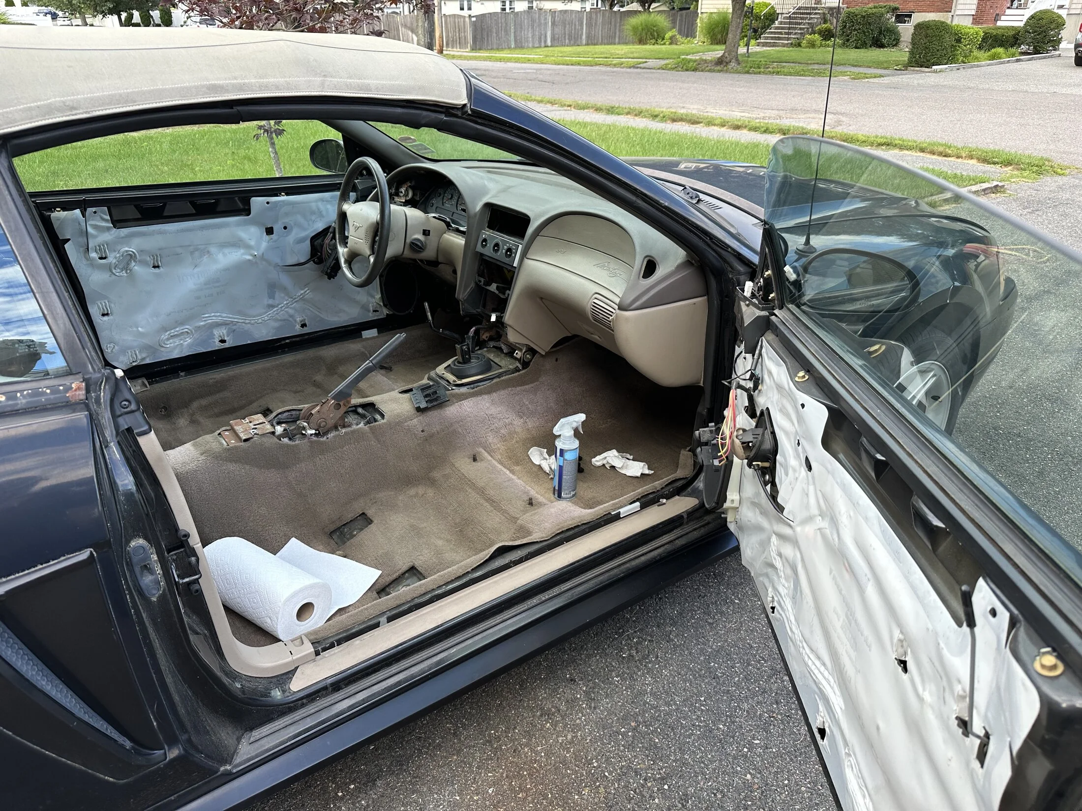

Door panels off to clean. Carpet back in. Gonna toss some Kilmat under the carpet as I have some I’d like to get rid of .
In case you are wondering why i am deep cleaning this so much. Grime like this on every panel.
This grosses me out. Previous owner must have spilled soda everywhere. It’s even in the speaker grill vents on the door panel which is why they came out to clean.

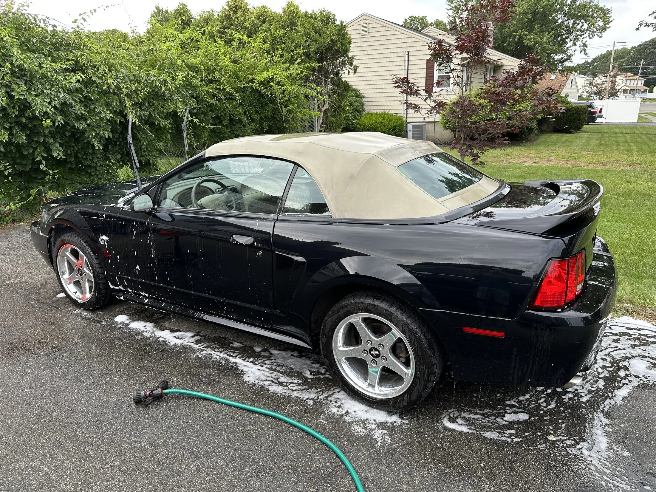

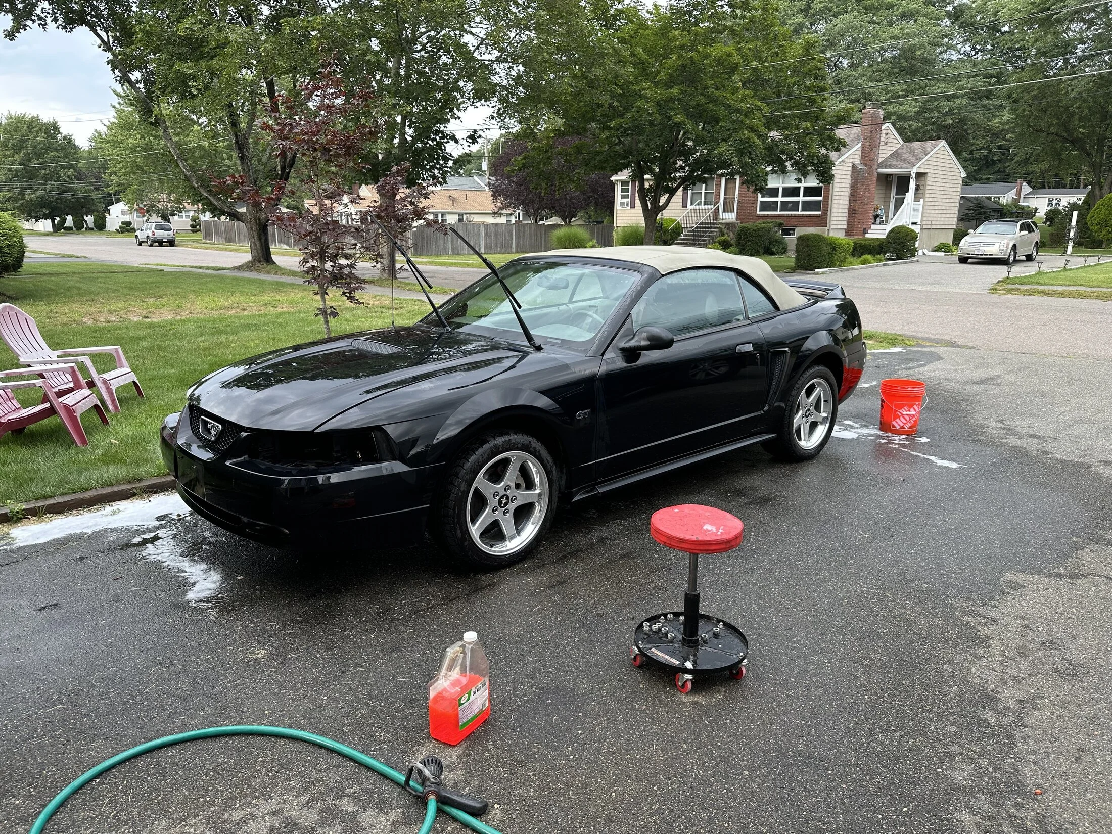

Cleans up pretty well. Put the wheels from my fox on
It’s wet in the pics. Could use some paint correction, but not as bad as I thought once I got a year of grime off
Some pics of my progress

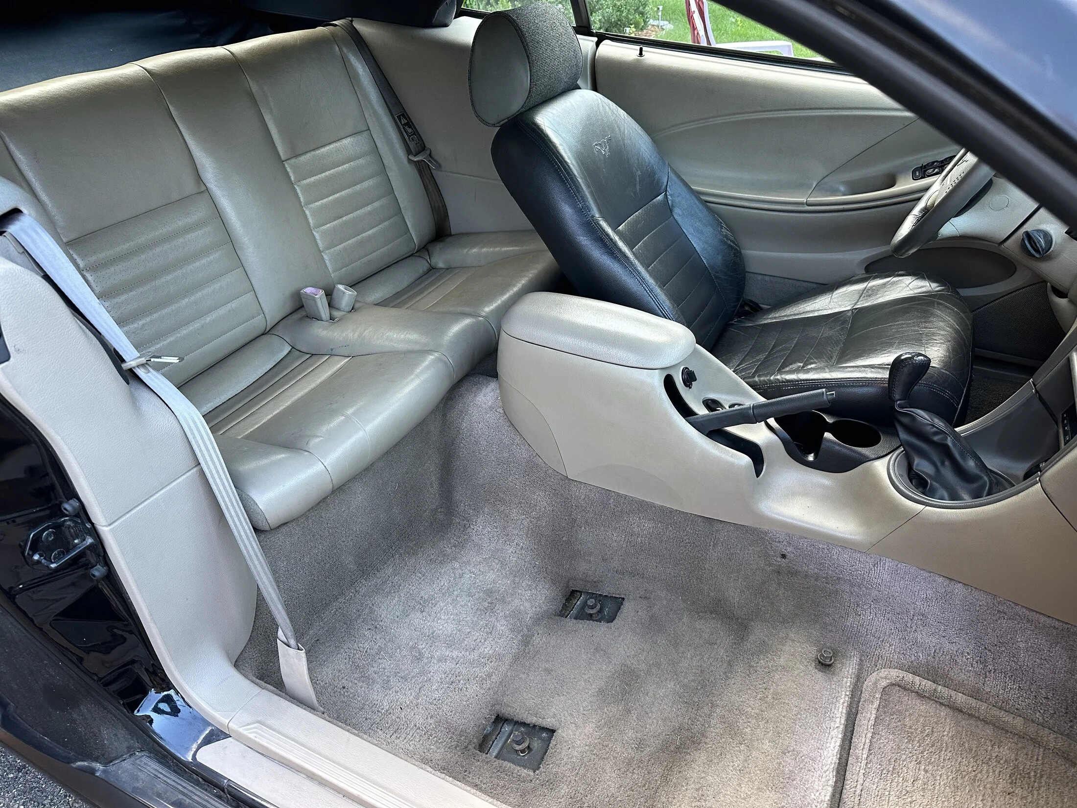

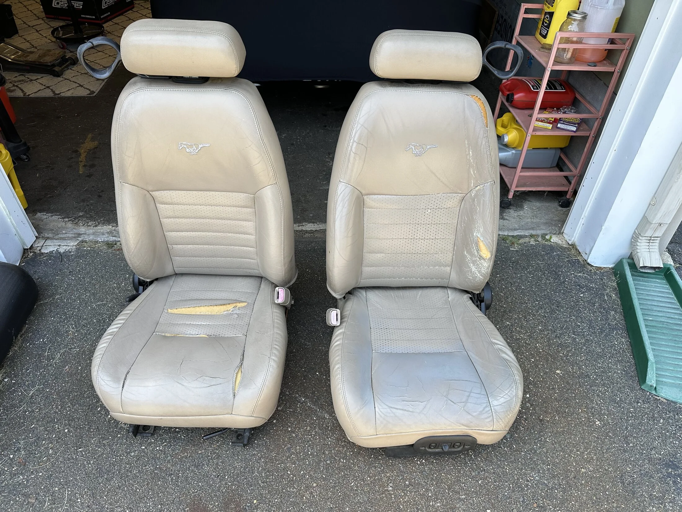

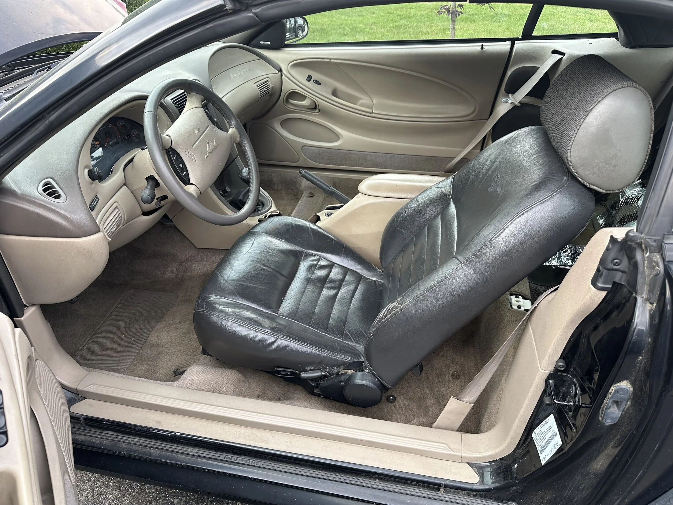

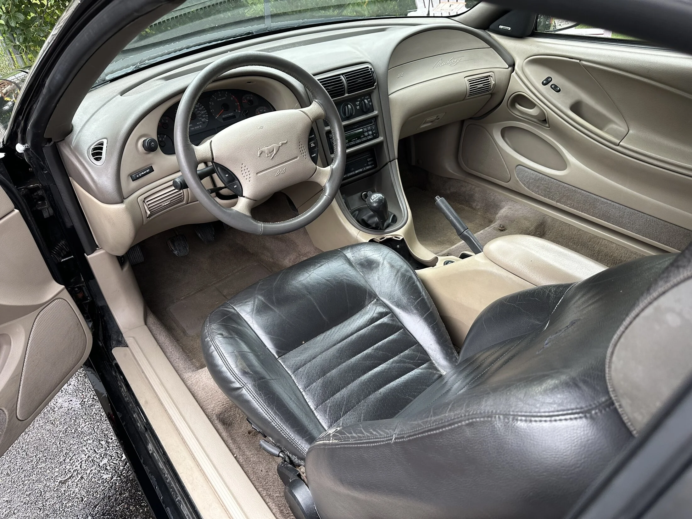

Dash and door panels back in. Threw in a spare dark charcoal seat just to see how I feel about this. I have a MINT pair in my basement but not sure they would look good in this car
Wanted to test the sound system, so threw in a spare CD player I have. System works, but since I pulled the left rear amp, the door big speakers don’t work yet. Amps should be here Monday. That’s why the back seat is not in yet.

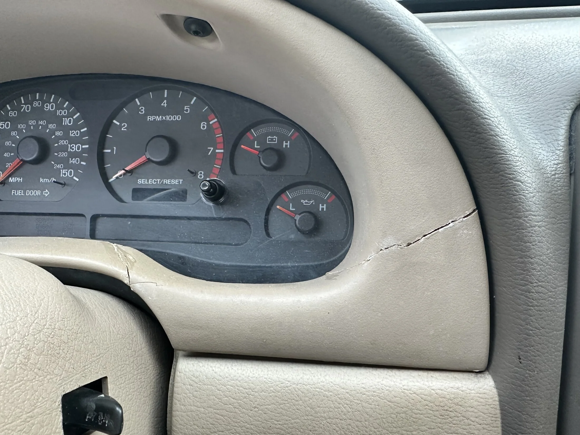

I did have a casualty.
Finding a replacement is tough. This color was 99-00 only with the rear defrost. 01+ moves defrost to center console.
Replacements I’m finding are $150+

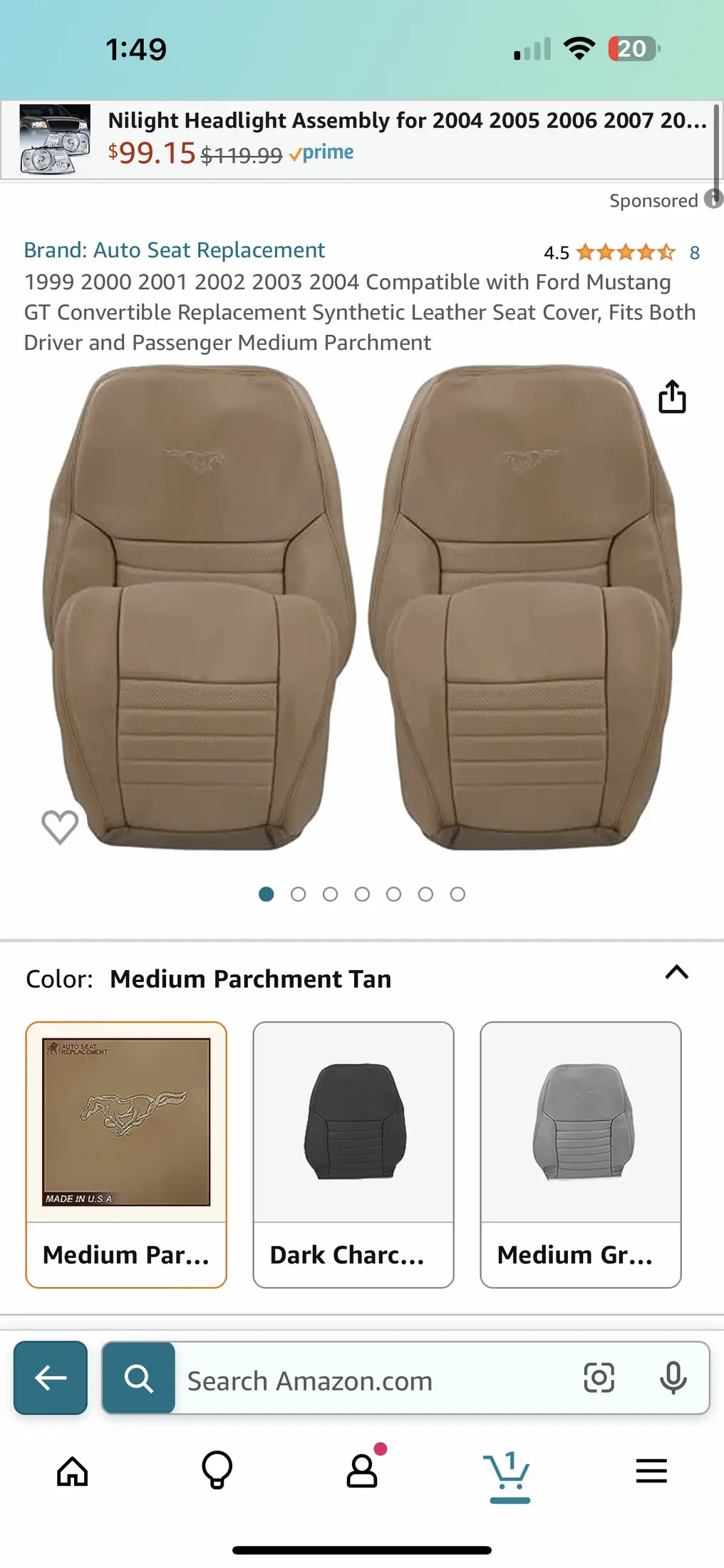

Not sure how I feel about DC seats in here. We will try it but I will likely recover the parchment seats. Likely won’t be as hot either.
But the interior is waaaay cleaner than when I bought it. I need floor mats next.

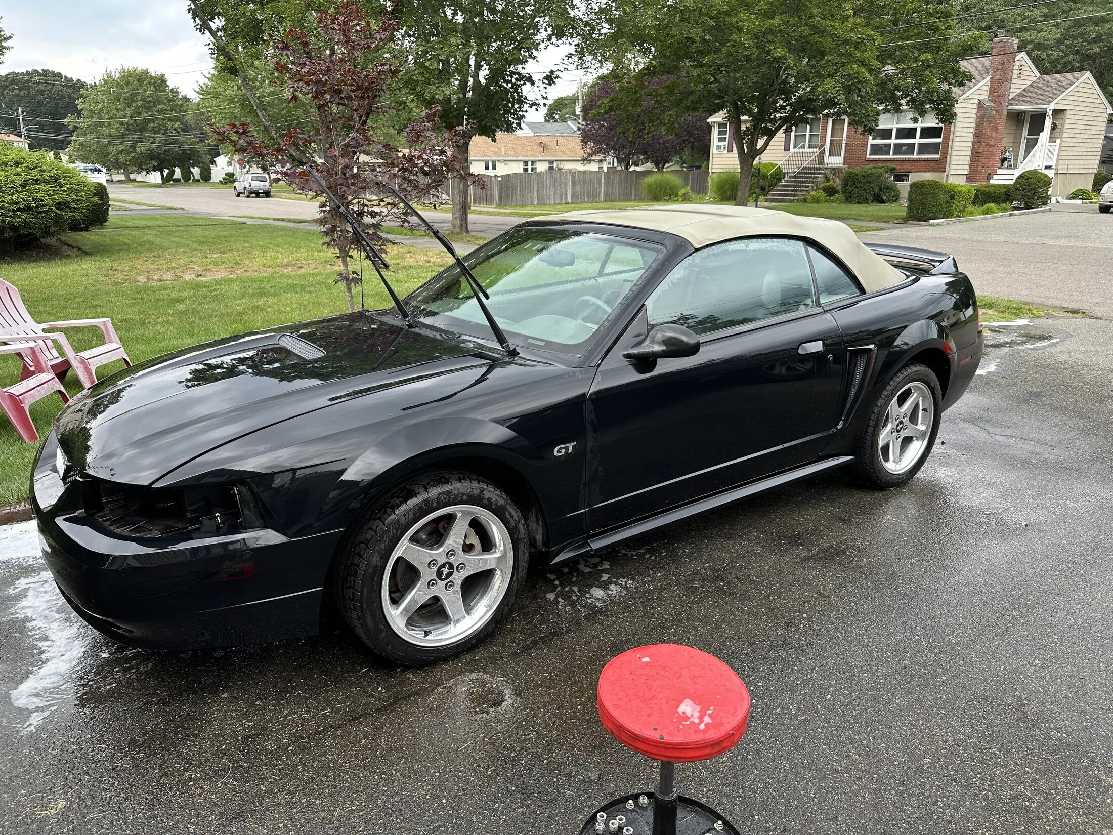

The headlights were faded and yellowing. Pulled them out and found they were Chinese aftermarket. So I ordered a set of 01+ smoked lights.
Body is in great shape overall. Could use some paint correction.
Ac clutch tomorrow, and might change oil and mount my Mach 1 chin spoiler. At some point I’ll do the grill delete, and a friend has offered me up an 01+ hood scoop. It’s flat black however.

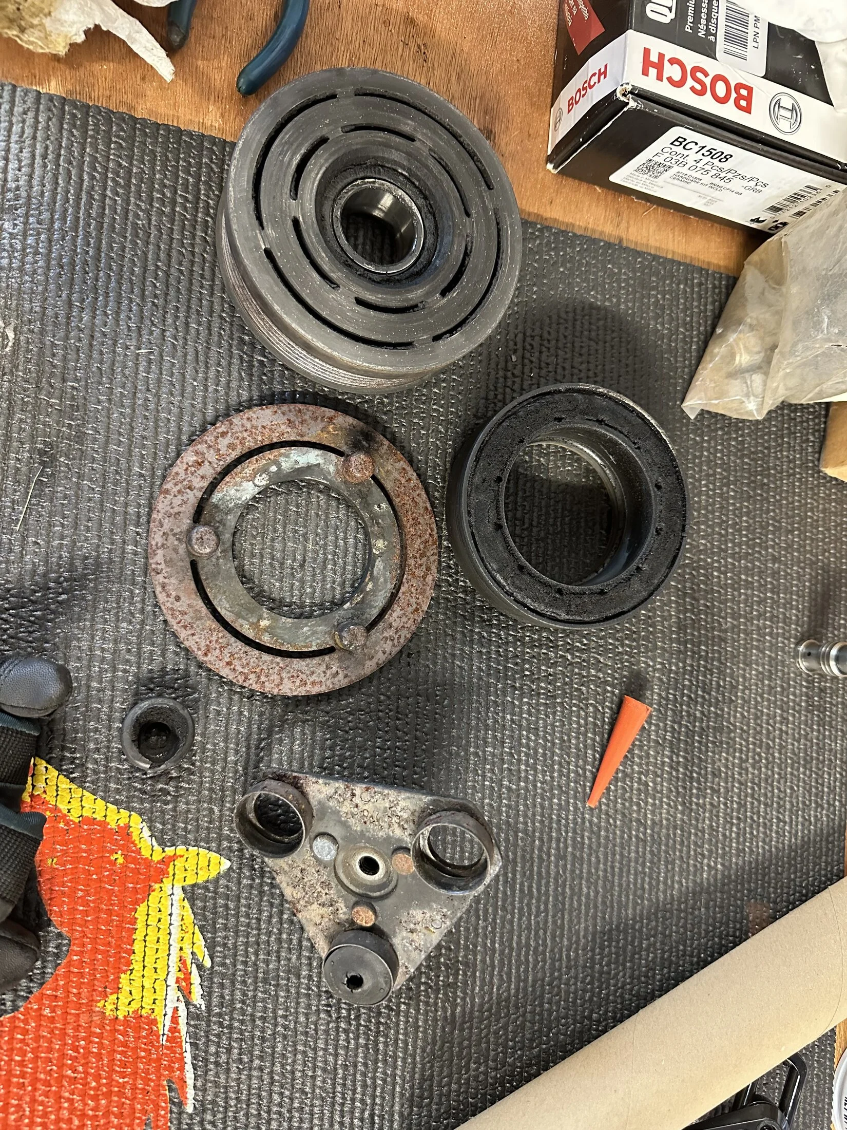

Ac clutch changed out. Notice the old one is in more pieces than it should be.
Upon trying the ac, discovered it would click for a second and then go out. So needs a charge. Given the end of season, I’ll just add some r-134a and then find the leak and fix later.

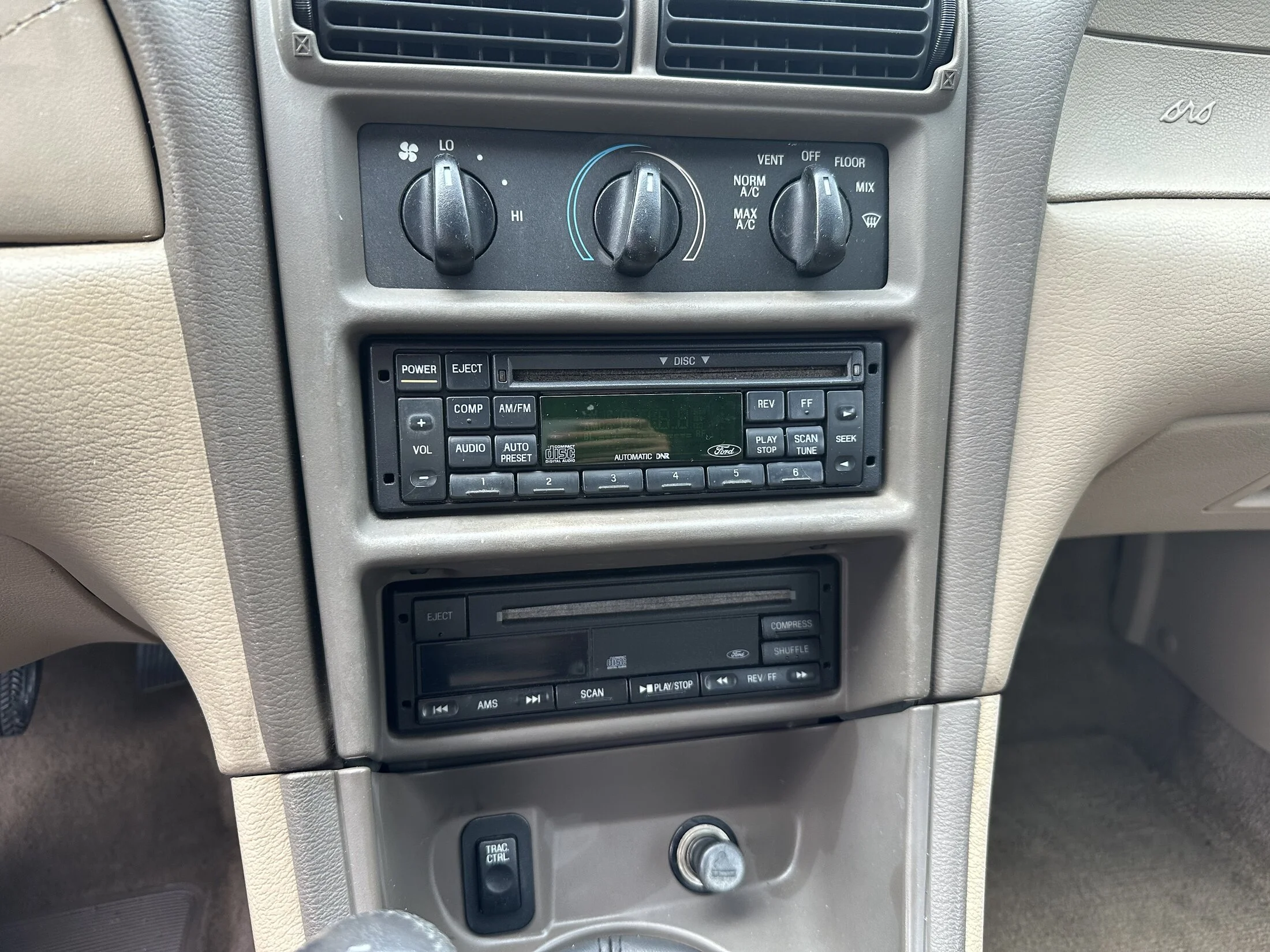

After debating this over and over in my mind, i think i've come to a decision.
Since i'll be using this car for work commute and other daily driving type of activities, i think I'll need to address the radio. As much as I wanted to leave the Mach 460 in, I don't think it will work well for my needs. I think i'm going to need to do a double din radio with Apple Carplay or at least bluetooth capability to make my commute easier in terms of navigation/traffic info, phone calls and maybe add a backup camera.
At the same time, i'll probably swap to an 01-04 console. The layout is better with the cupholders and such, which will also be a big need for me as I enjoy my AM large coffee on my commute.
I'll probably tackle this over the winter when i'm driving the SUV around and the vert stays parked.

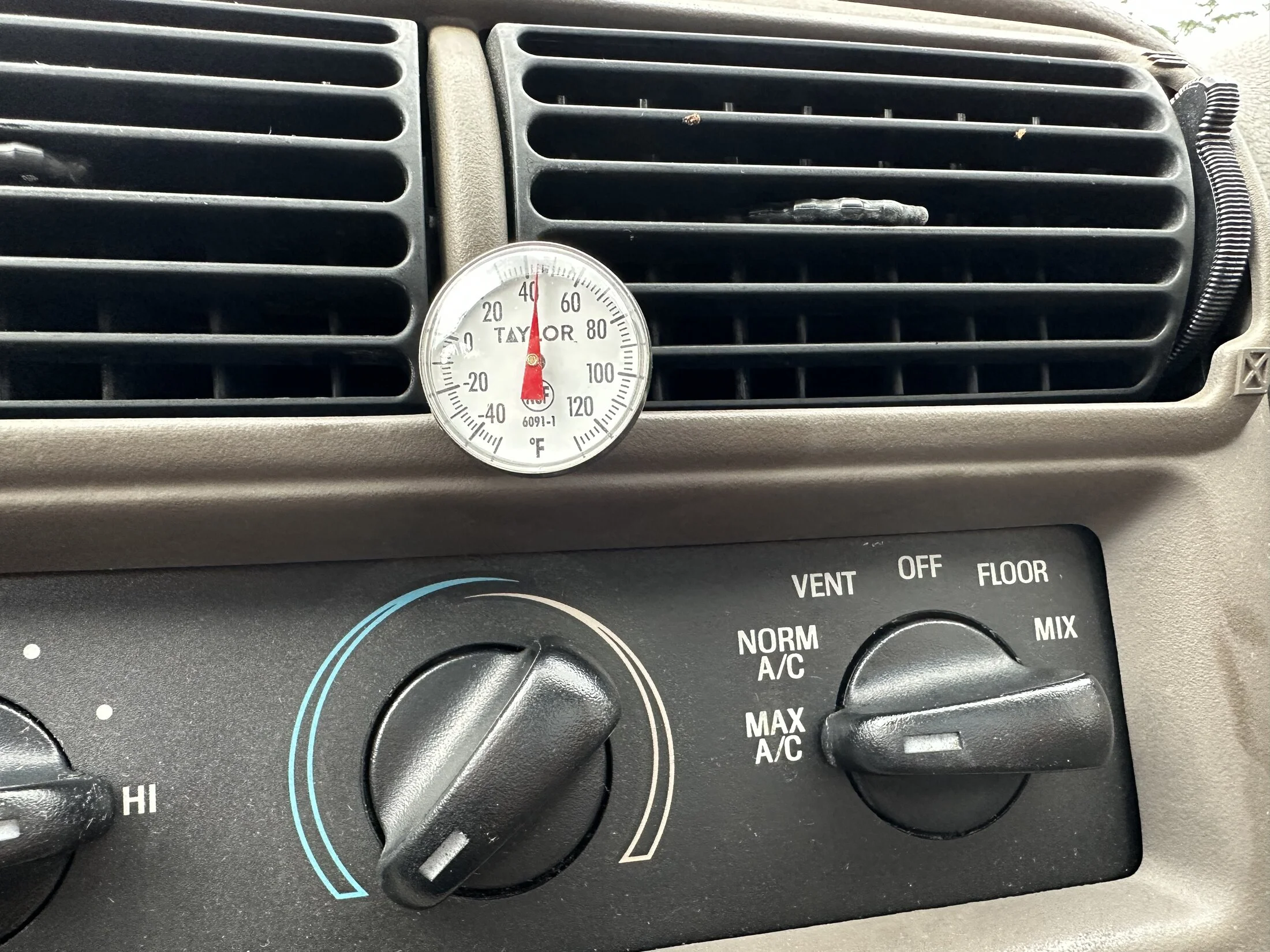

Took two cans of r134a, but I have AC again. The guage set I purchased on Amazon sucked. All the fittings leaked. Definitely spend the money on a good set. My R12 set is quite nice, but this cheapo set sucked.
But I have AC.
This was just idling. Having had a chance to drive and see it it hits 40 degrees even. I expect it to.
Found the system does have green dye, so someone was trying to find the leak. I’ll have to keep an eye on it. As long as it lasts me the rest of the summer I’ll be happy.
