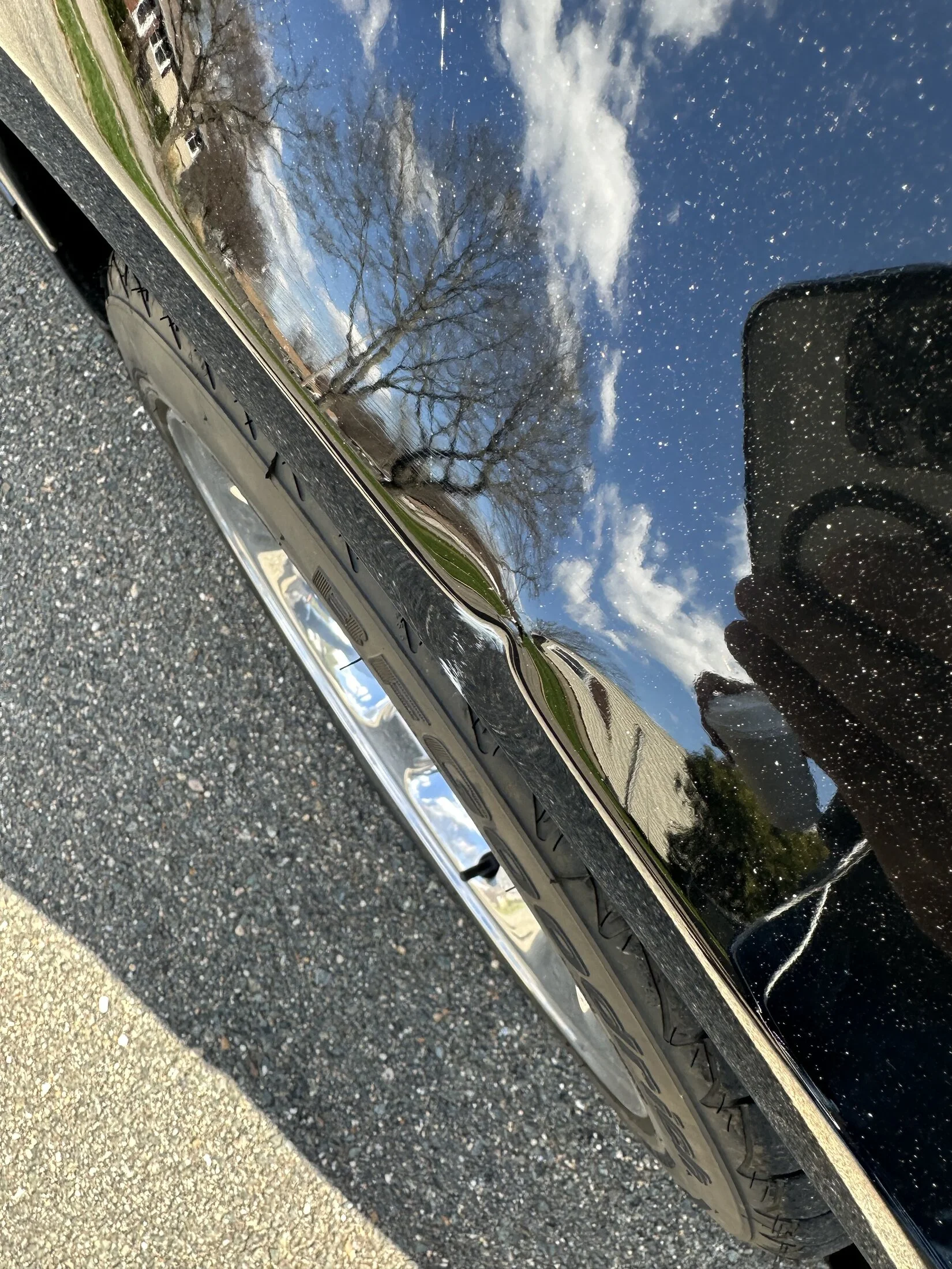

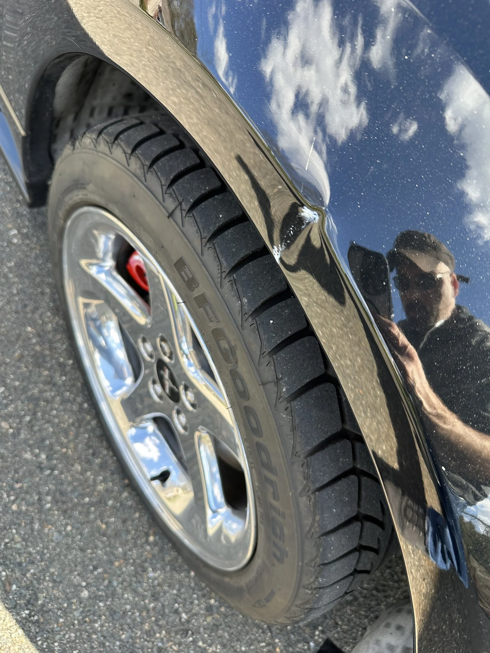

What do you think? Can this be PDR’ed?
Didn’t bother me before but now that the car is in better shape, this bugs me.

Won't hurt to ask
the crease concerns me

Short answer... yes it can be. More realistic answer though, it will be TOUGH to get it out fully but if you find a good PDR guy and tell him you just want it 85% then I think it will be a cake fix.

I'd be happy with 85%. I just want to avoid cracking the paint and hopefully i can remove the white paint transfer afterwards.
BTW that dent was pre my ownership of the vehicle.

I think it can be done to look better with PDR. Probably won’t get it all out due to that body line. Just find the best PDR company you can in your area.

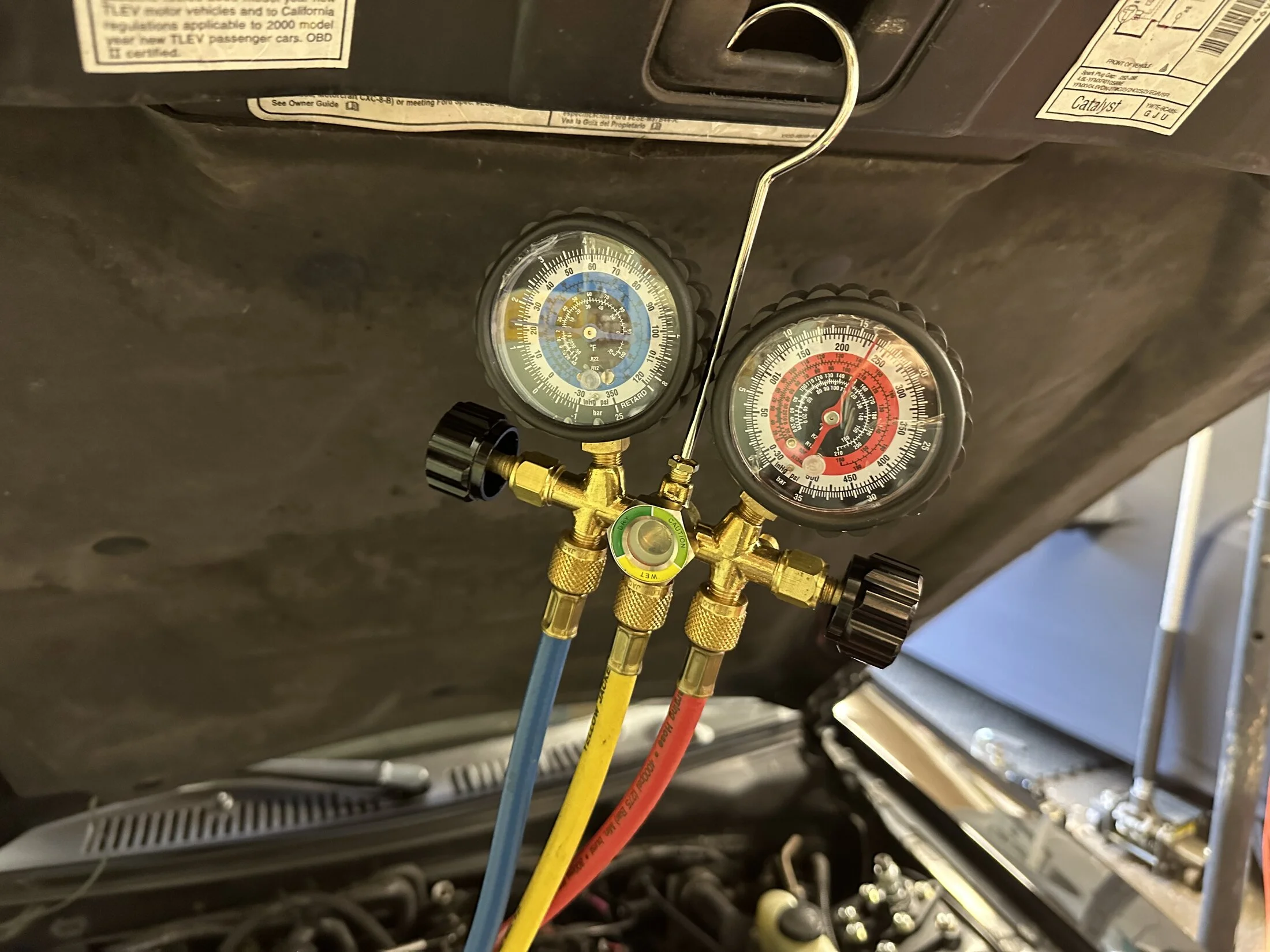

Pulled a hard vacuum. Refilled with nitrogen and then another hard vacuum and recharged the AC. Held the N2 pretty well so I think I got all the leaks.
Not much left to do. Have some issues with the convertible top motor. I’ve topped it off a few times and it struggles to lift the top at times. If I stop the top halfway and leave it it slowly returns down. It’s 50/50 on cylinders or motor and based on what I’m seeing I’m going motor firsts
Alignment, tint, done. Sell it. Buy a Cobra (just kidding…for now)

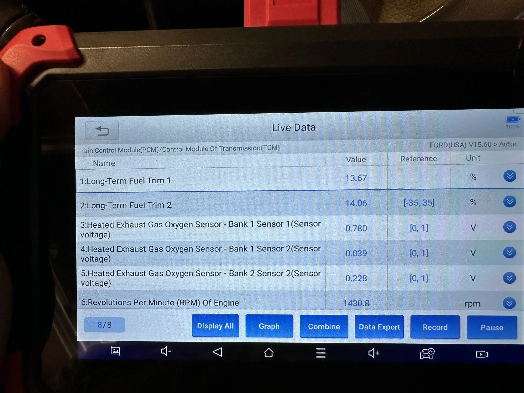

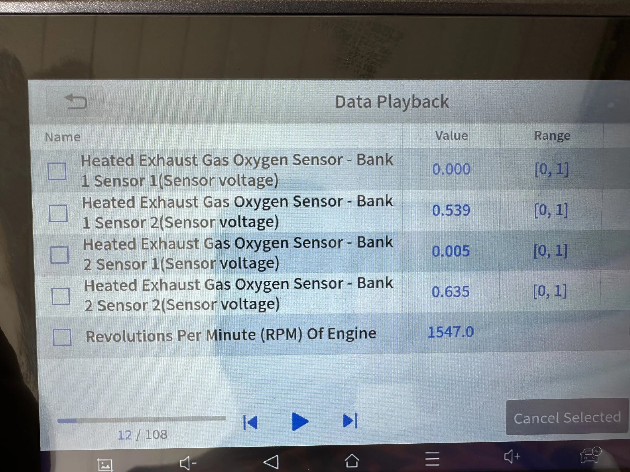

So this car has always had a stinky exhaust. Not rich, but dawned on me that it may be lean.
So I plugged in my data tool and decided to look at the O2s and sure as hell they register as lean. The voltages swing down to near 0 frequently indicating it’s trying to add fuel.
Quick Look at fuel trims and it’s definitely adding fuel.
Both banks go lean (near 0 volts) so Probably a vac leak somewhere. Of course I loaned out my smoke tester to a friend. Grr.
Also finally traces out a noise in the accessories to an aftermarket belt tensioner. Definitely has a whirr in it. Ordered up a new Motorcraft tensioner

02 281 GT said:
Fancy scan tool.
Xtool D7. Got it on sale for about $300. I love it.
The car runs great but it had a little hiccup at idle. Come to find out, it’s registering misfires, but not enough to trip the codes. If idle for 5-10 mins, the live data will show 10-20 misfires, but unfortunately the obd2 setup is too early to tell me what cylinder.
Mass air flow was reading high. Pulled sensor out and it was grimey. Cleaned that up and flow is better and car runs better. Looks like I overlooked that maintanance.
Front o2s read lean, but rear o2s read near stoich. I graphed them and they look lazy and would sometimes stick down near zero. I hraphed my DD and the sensors are much quicker in response. Fuel trims lean rich.
So I ordered one o2 sensor. I’ll install it and compare the two and see if that was the culprit.
Haven’t smoke tested yet.

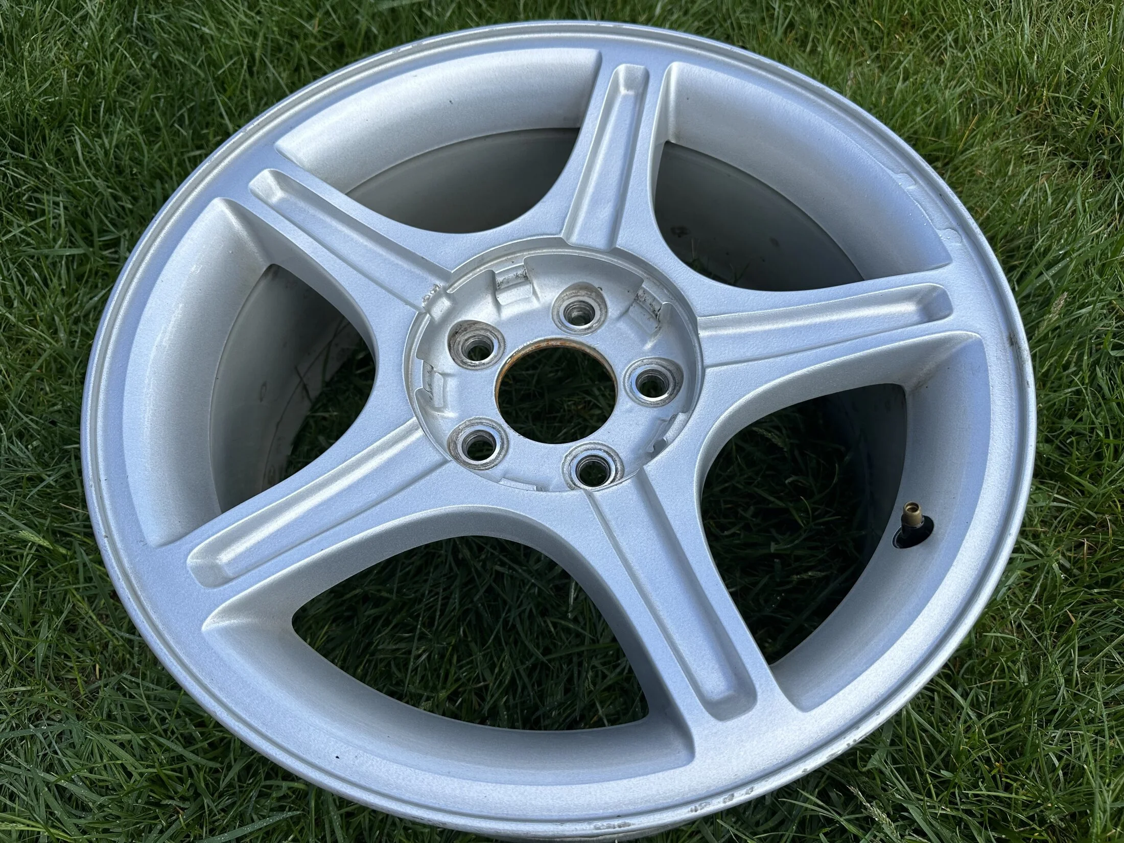

Finally got around to getting a shop to pull the old tires off the original rims. I never paid much attention to these as they were off the car within a week and I just dumped them behind my shed.
But got around to cleaning these up and they are damn clean. minimal curb marks and the argent finish still shines.
Was gonna sell them but now I might hang onto them for a bit.

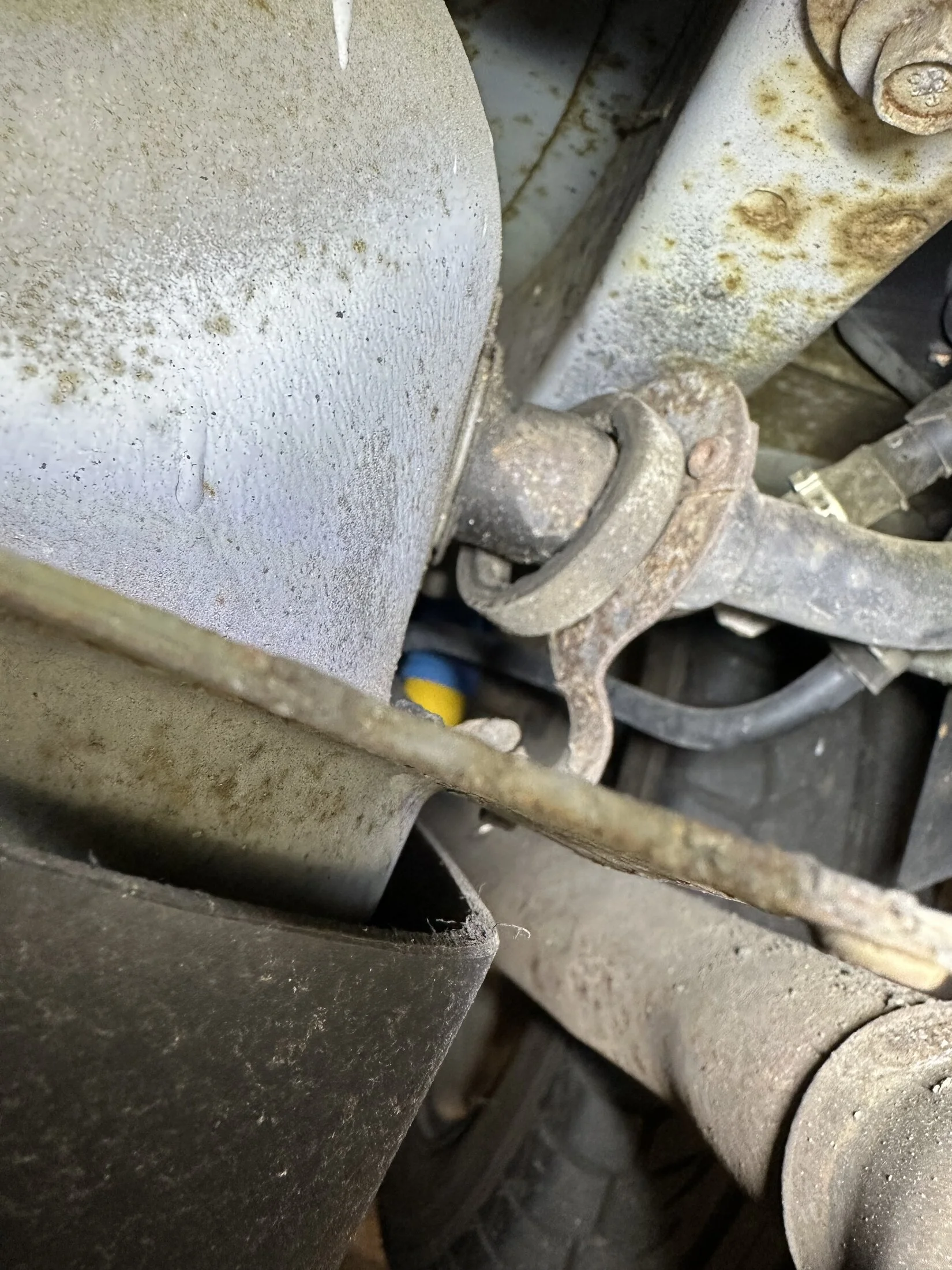

Cleaning up some small items that are left to finish.
I knew this was failing but looks like it broke free completely now. I had been keeping the gas tank under 1/4 full because of it.
The other end is in the tank. Should be ok…I hope.
