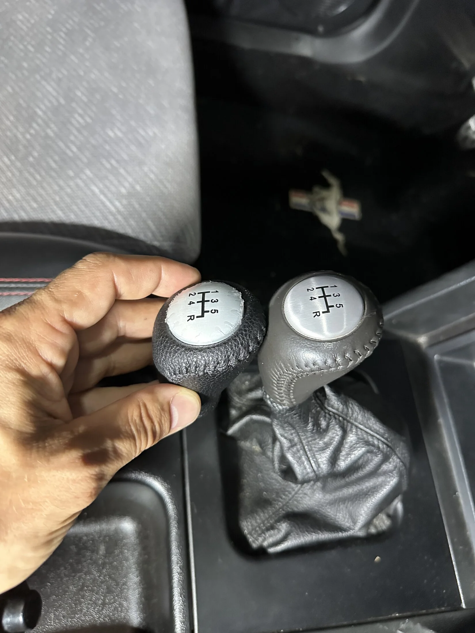

Steering rack in hand. Not going to tackle it quite yet. Still want to see if this is actually the steering shaft first.

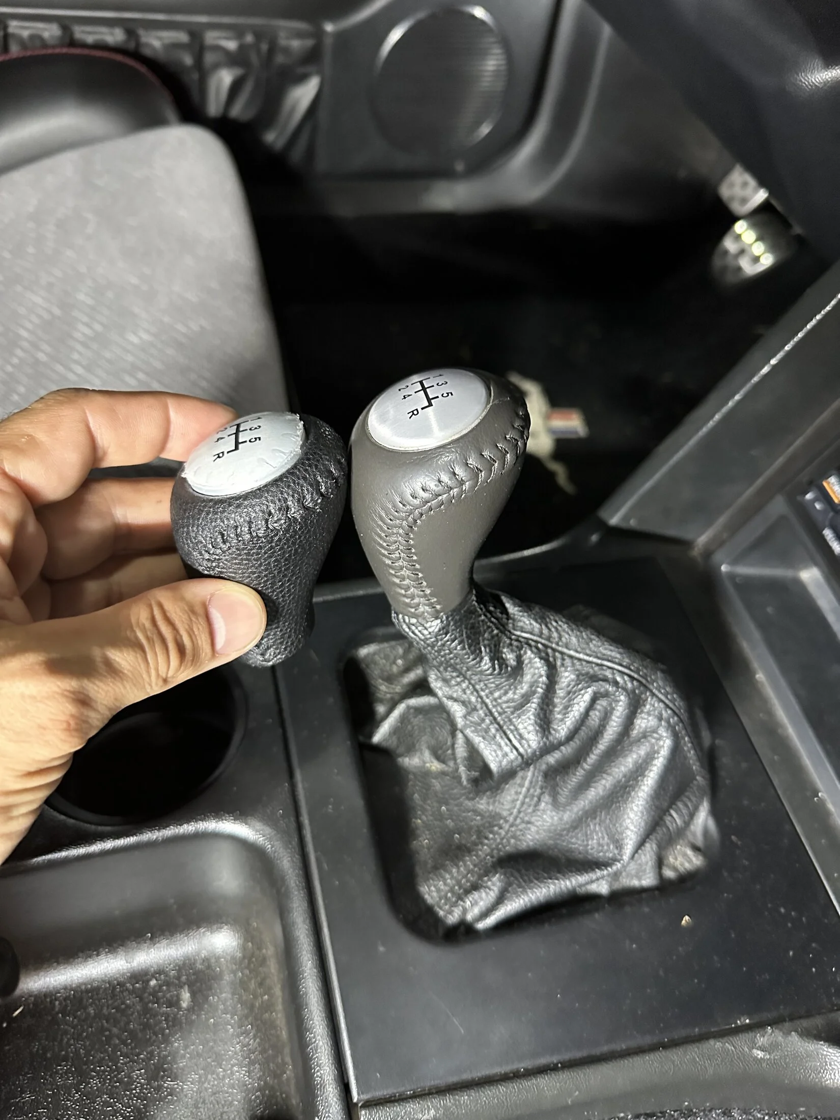

Been trying to get my hands on a Ford Racing 5-spd shift knob. Been looking for an original but decided to buy the LMR knock-off. As soon as I opened the box I was unhappy with it. Looks cheap and doesn’t even look corrects
Compared to my FR original in my Fox
Reactions: 2Blue2 and General karthief

Hmm..what's funny is the aftermarket knob seems to match the leather boot in my Foxbody a lot better than the Ford racing knob. Also, the FR knob is dark charcoal rather than Black.
Maybe i should keep it and just swap the knobs

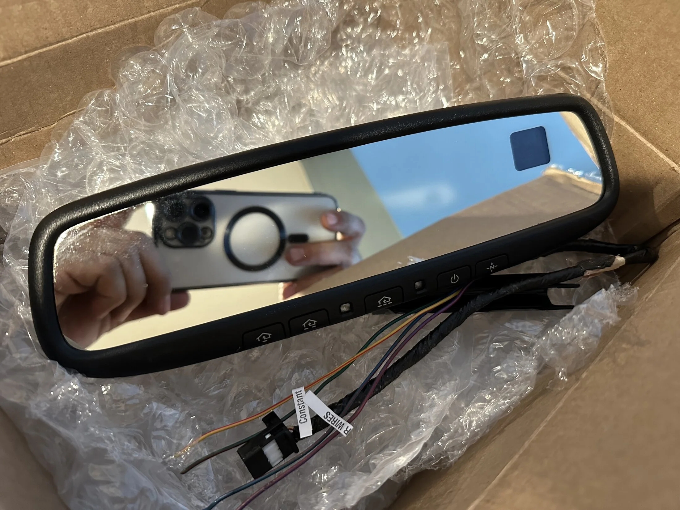

Scored another Gentex 453 mirror. Wanted it for the homelink garage door openers. This one had auto dim, compass and outside temp too. Same one as my Foxbody.
I’ll lose the interior lights on the original convertible rear view mirror, but I don’t drive at night and I can use the visors instead as I put LEDs in those

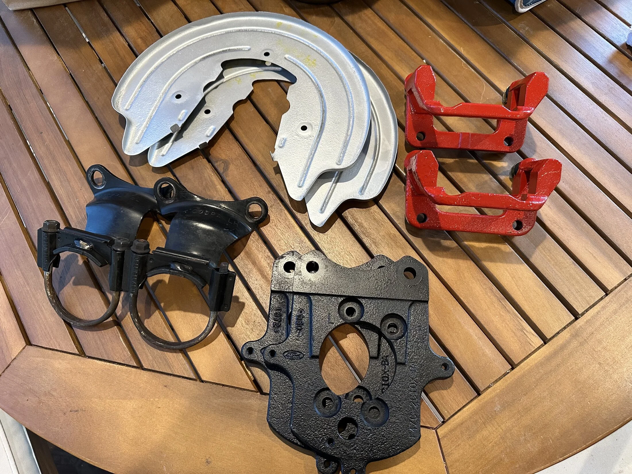

Picked up some use parts for the rear cobra disk swap. Cleaned them up and refurbed them. Got a set of rotors and pads as well along with a spare set of calipers I won’t be using.
essentially this will be my final mod to the car…..unless I convince my kids to let me do the styling bar.

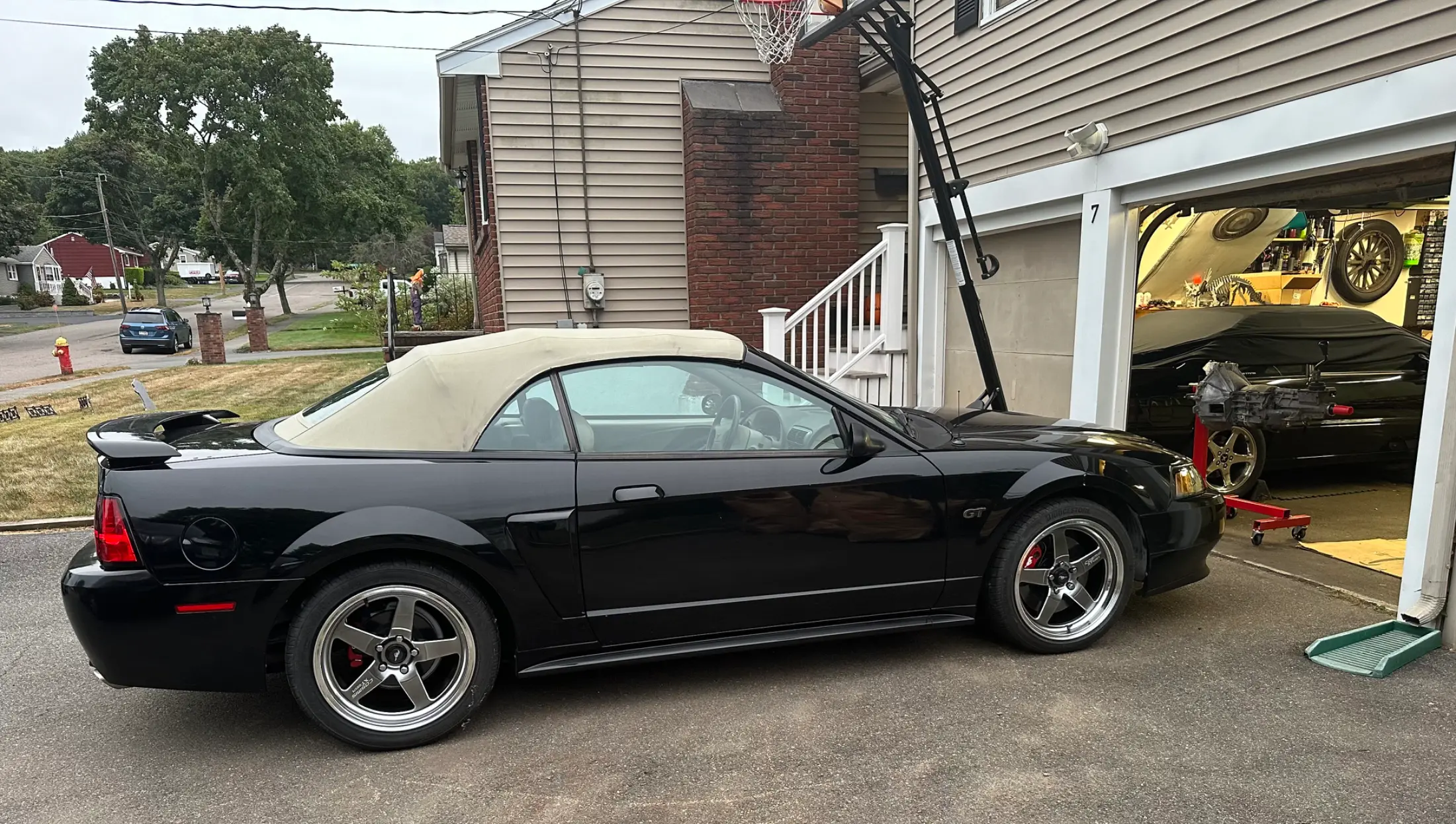

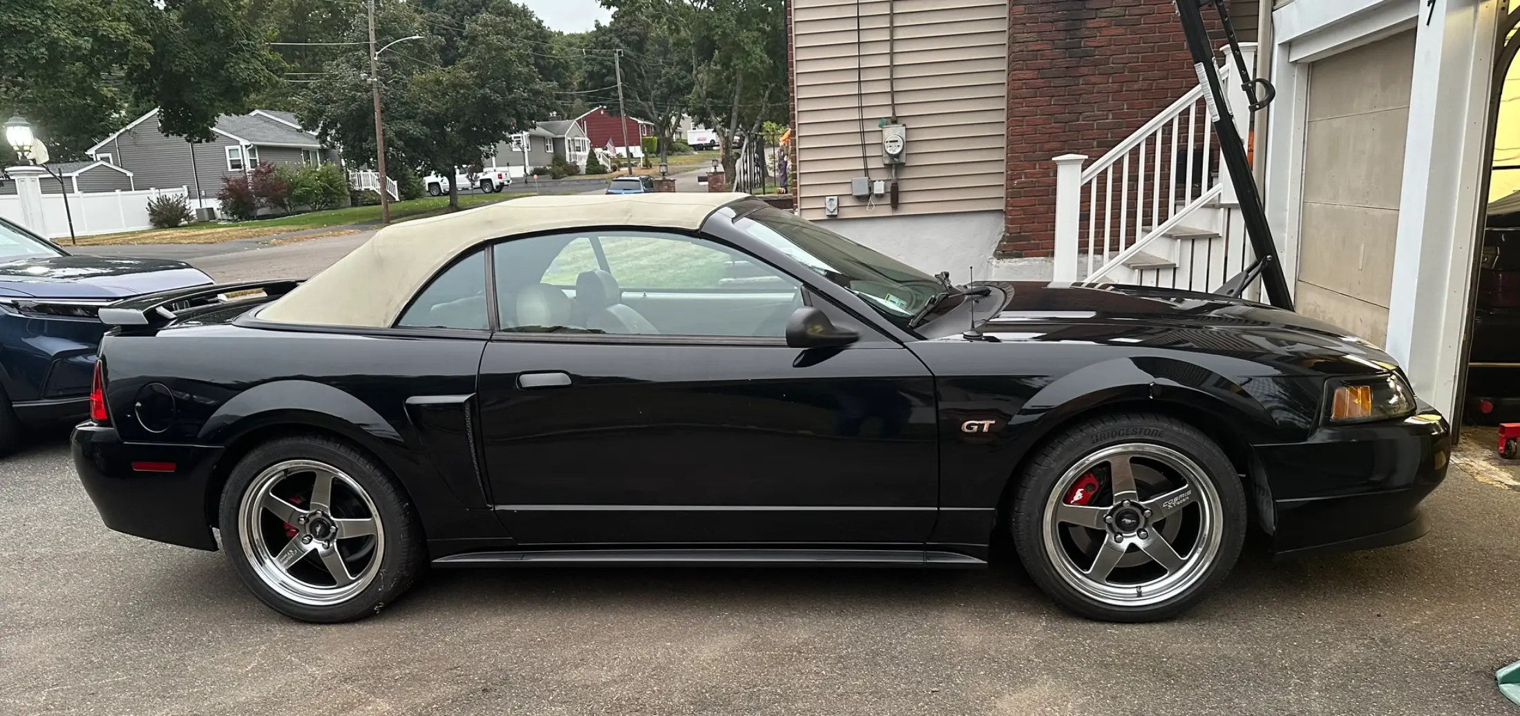

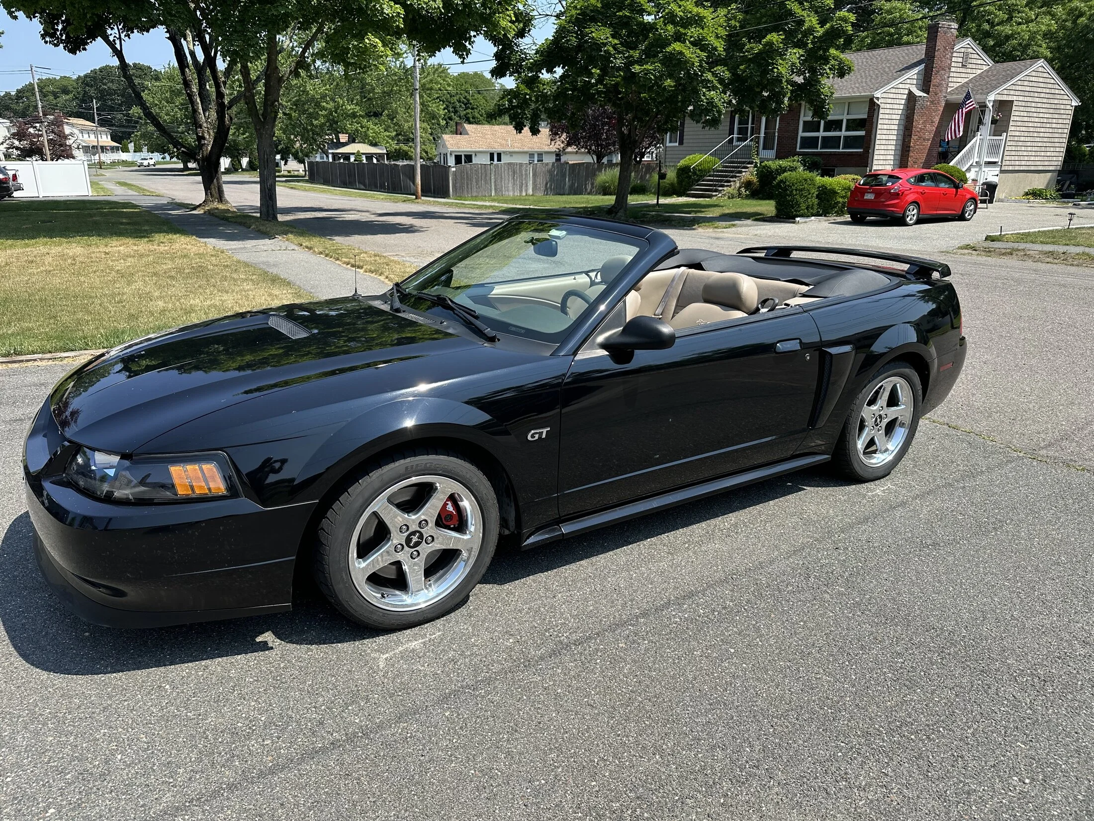

I did a thing.
Tires on the polished wheels were old, and I was driving the car more and more on the highway, so to avoid being the next Paul Walker, I swapped my wheels
I may leave these on the car. I like the 18’s and prefer tge 17” wheels on the fox

Only a few more weeks of decent weather left. After that I plan on digging in and installing the rear cobra brakes.
Now with these 18” wheels, the puny GT rear brakes stand out like a sore thumb.
