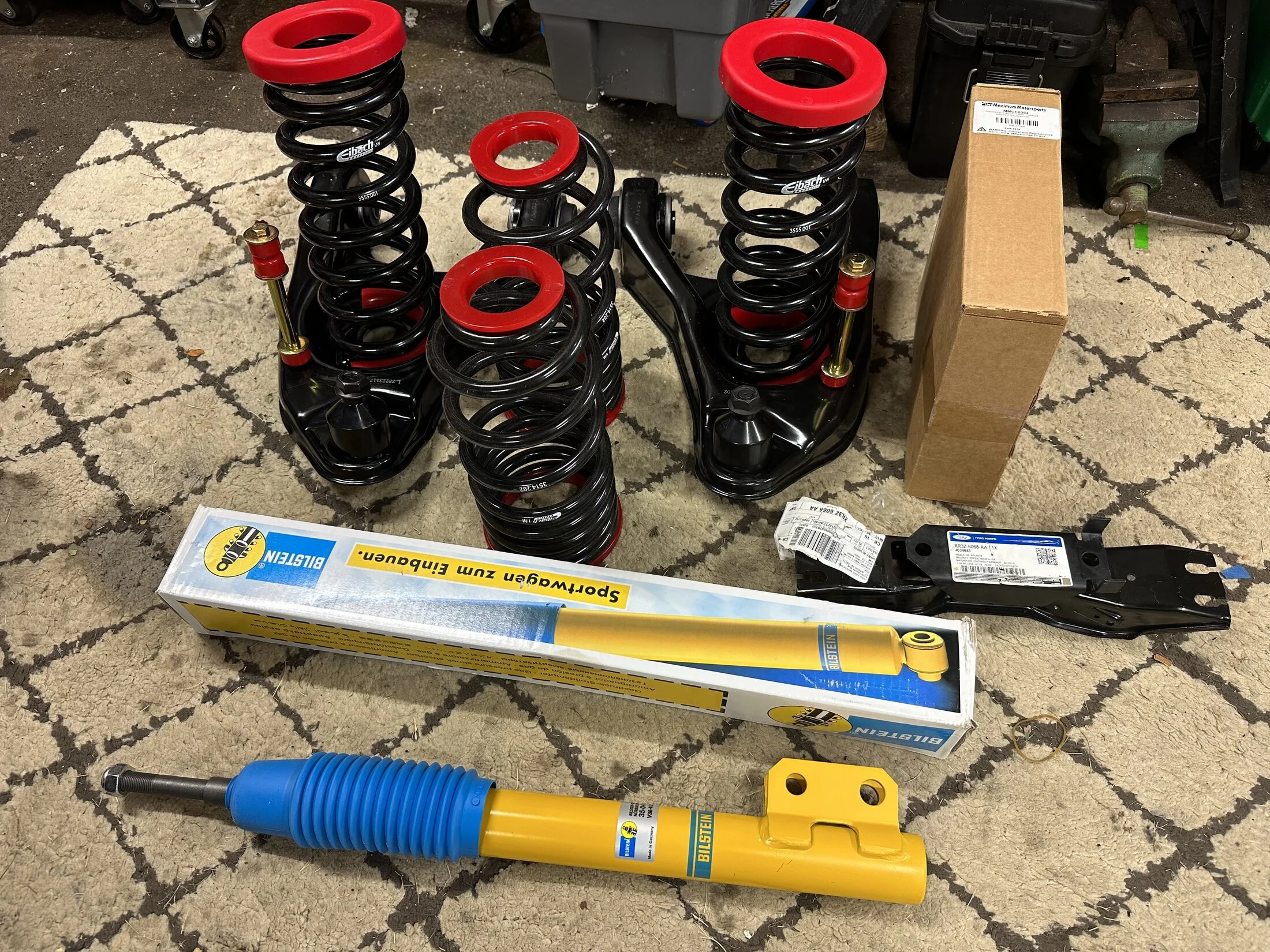

Parts pile is ready. Now to find time to get this one.
Eibach pro kit with poly isos
Bilstiens (rear already installed
New front arms
Poly sway bar end links
Trans nount
Max Motorsports caster/camber plates
Poly steering rack bushings.

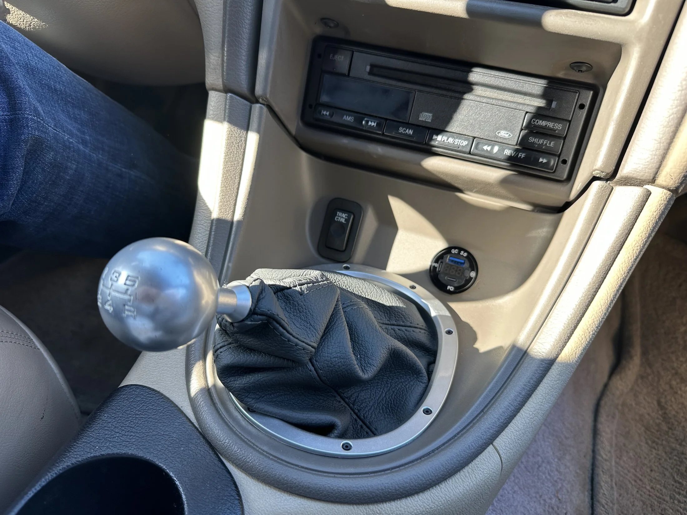

Added a shifter trim bezel

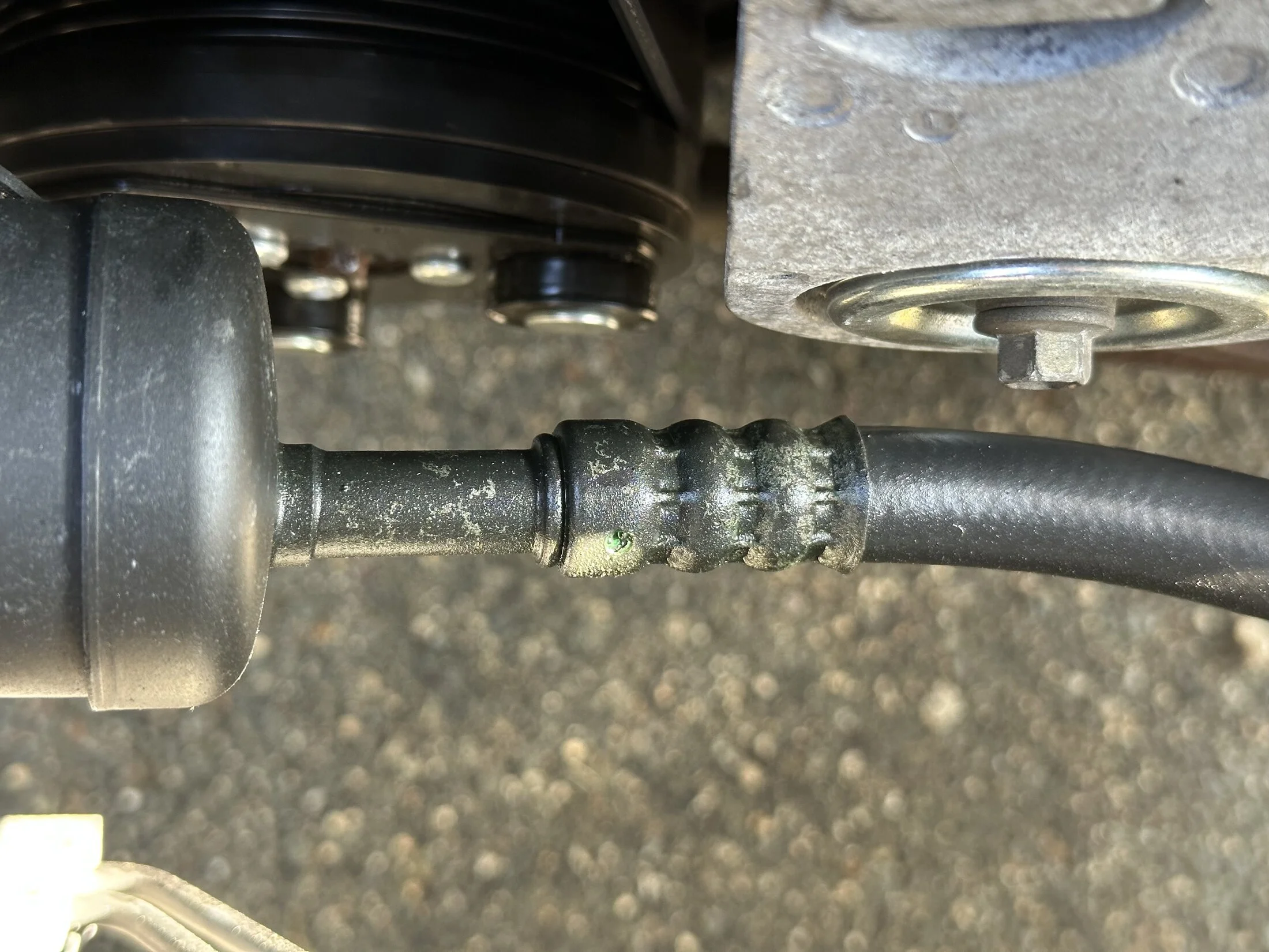

Also, found my AC leak. Discharge line. $120 for a new Motorcraft or $35 for aftermarket. Eh…I’ll deal with it in the spring. It’s October now.

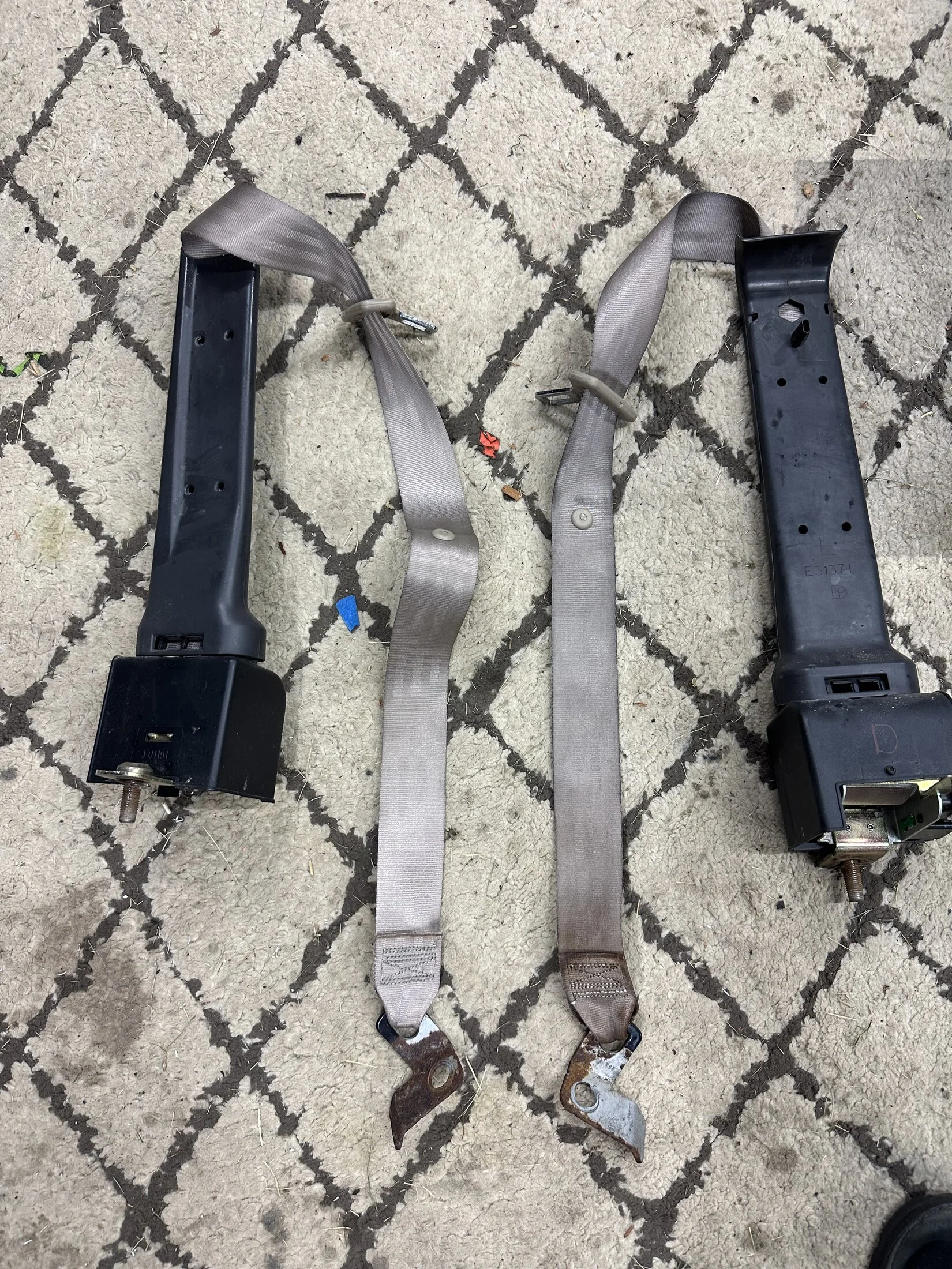

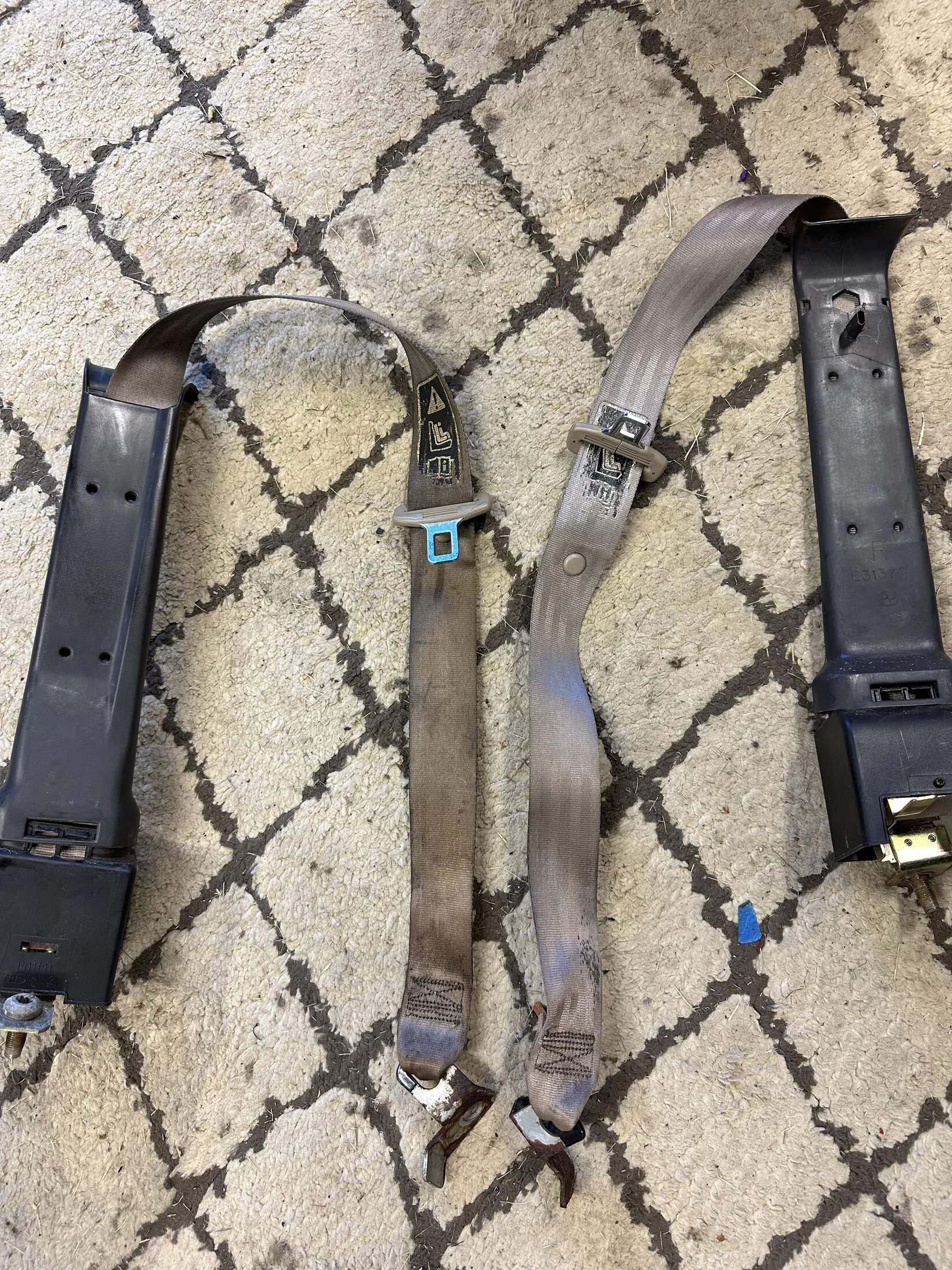

Last few drives. Getting the itch to start putting the suspension parts in. The balljoints have me worried as all over the new edge groups, balljoint failures on these cars seem to be common. So I want to get those arms out since the boots have been torn for who knows how long.
Pulled my rear seat belts out. One of them is grimey as hell so I want to try to clean it up, or replace it.

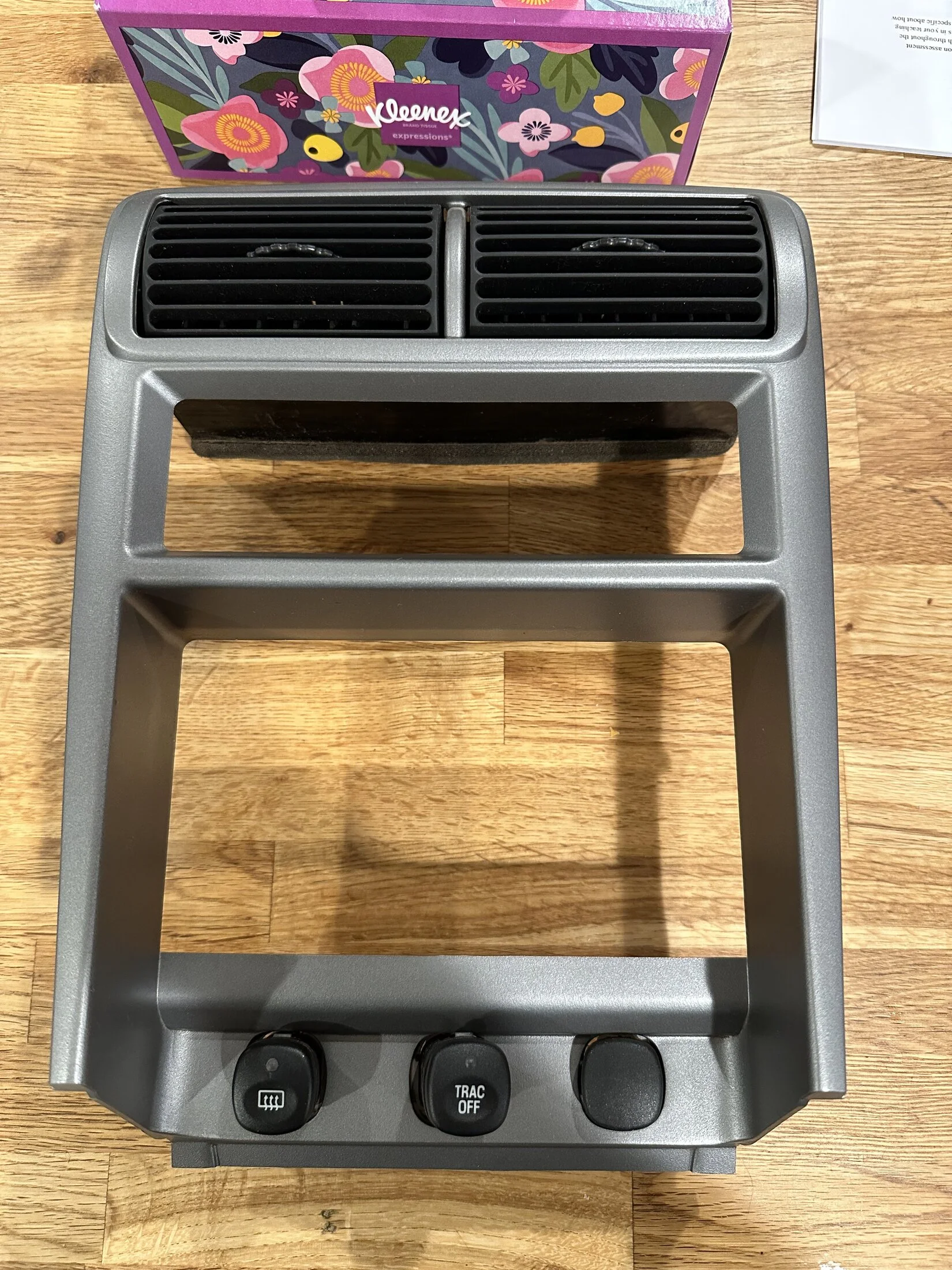

Decided to commit to the double din conversion. Starting to gather parts. I need some apple CarPlay in my life and a touchscreen. Using a Bluetooth adapter on the stock mach unit…sucks.
Picked up an 03/04 silver interior upgrade package center trim bezel.
Going to visit a junkyard next week to see if I can score a 2001-2004 center console with the upgraded cup holders and misc items like a fog light switch and see if there is a clean black trunk.

Mustang5L5 said:
Round one of cleaning. Made an improvement on that dirty belt, but it’s still not where I want it to be.
Belts are flipped from above pic. Left one is pass side and that one is prob good to go. Drivers one seems to have had the convertible top fluid leak on it at one point. Don’t ask me how that happened but my lines weee all replaced at some point and there was evidence of a spill/leak in the past.

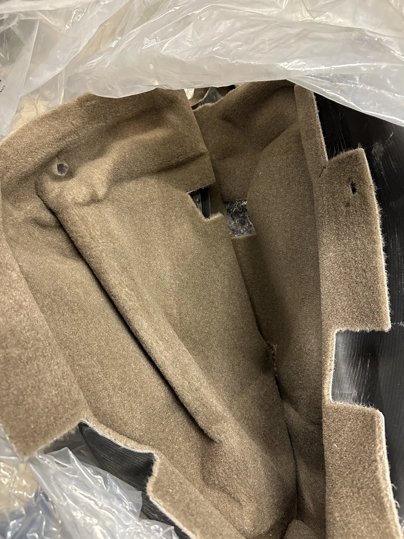

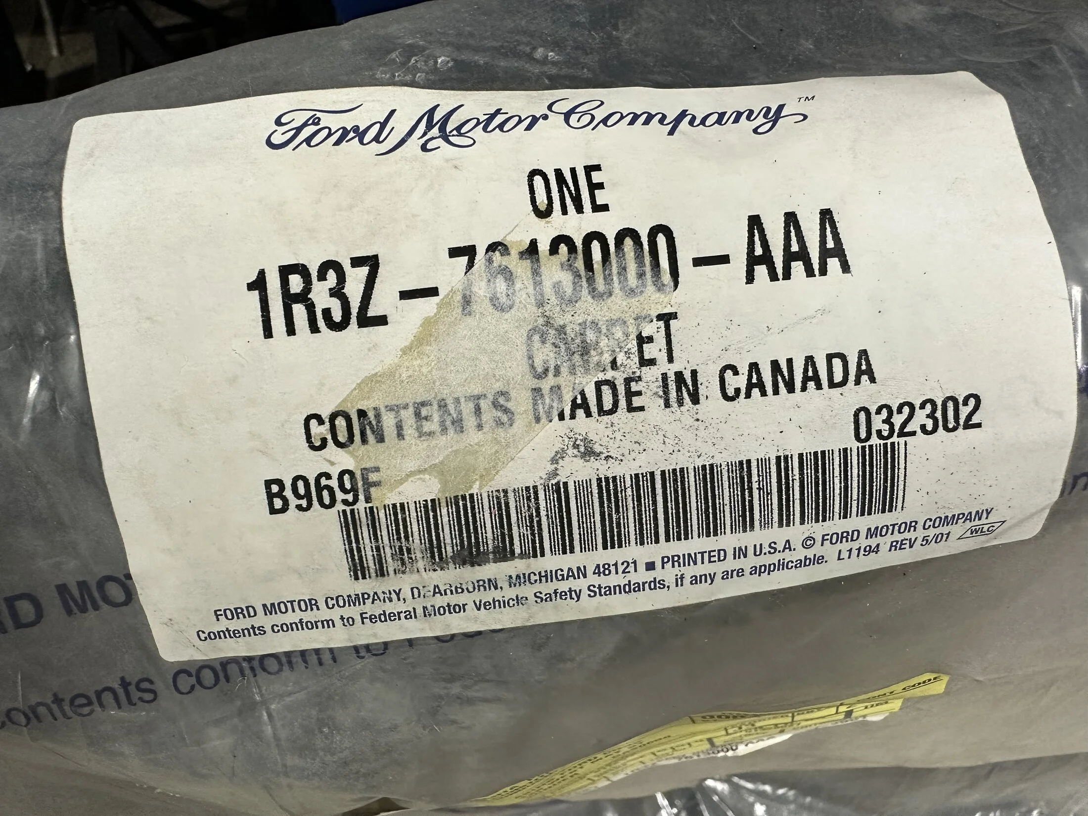

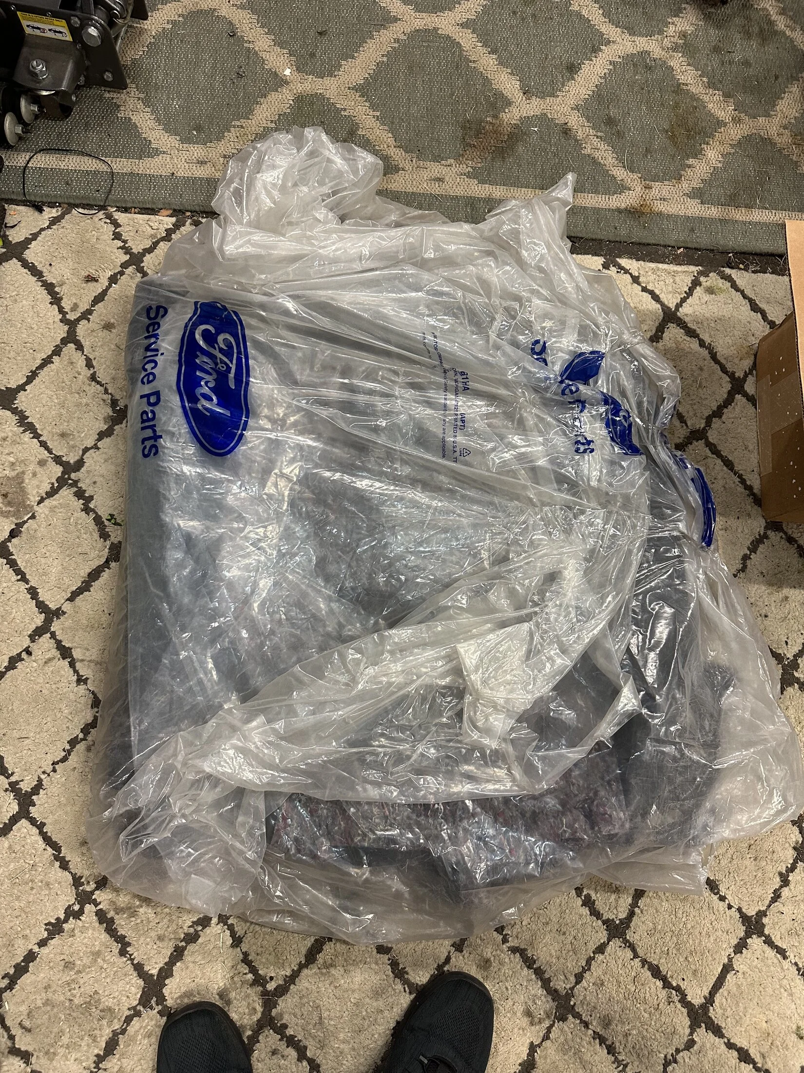

Scored some fresh, NOS carpet

Wow.... Where did you find the carpet?
Mustang5L5
Mod Dude
Feb 18, 2001
43,389
18,131
224
Massachusetts
Oct 27, 2023
#114
  • Oct 27, 2023
  • #114
NPD had it.
Only color they had in NOS was parchment.

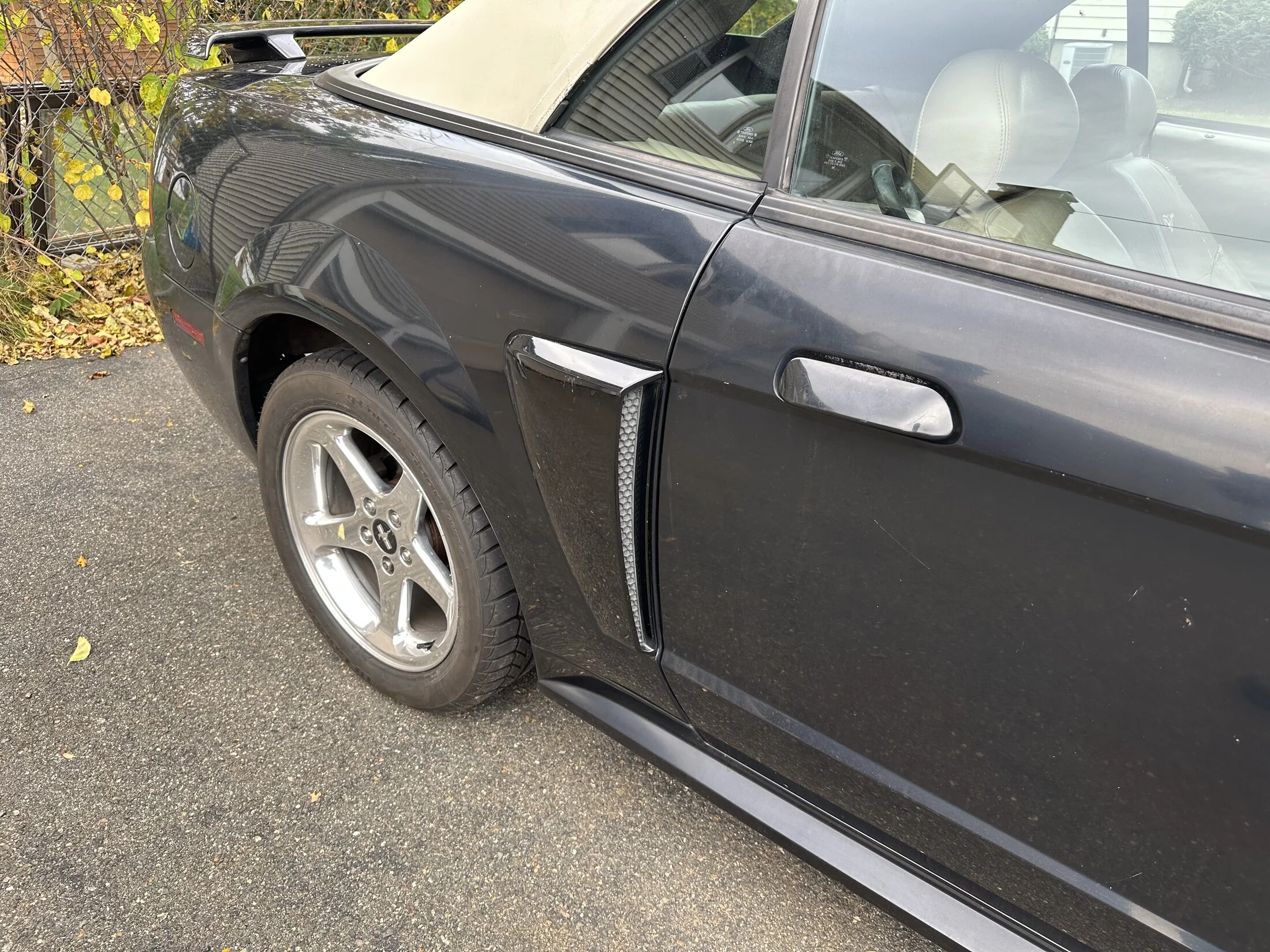

Pulled the 99-00 side scoops off and installed a set of 01-04 scoops

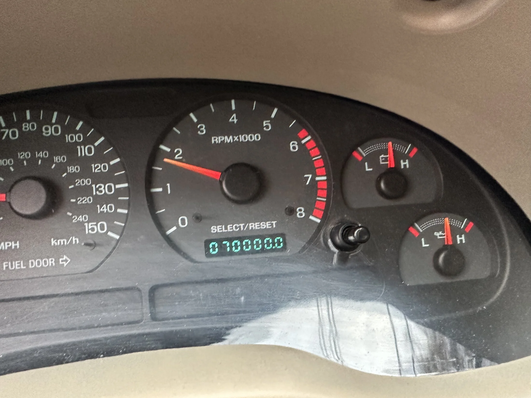

Rolled 70k today.
Think it’s time to rip the suspension apart finally.

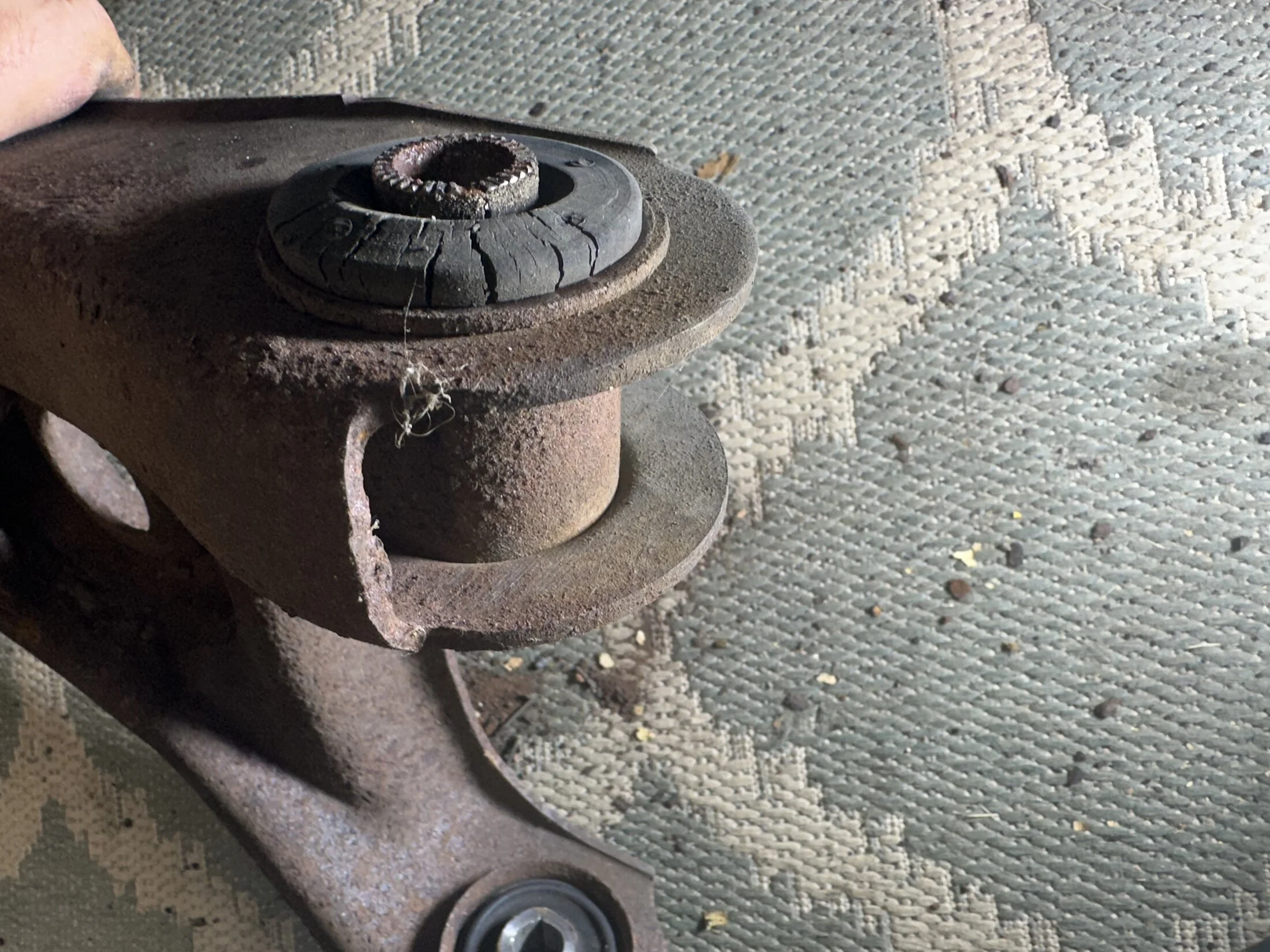

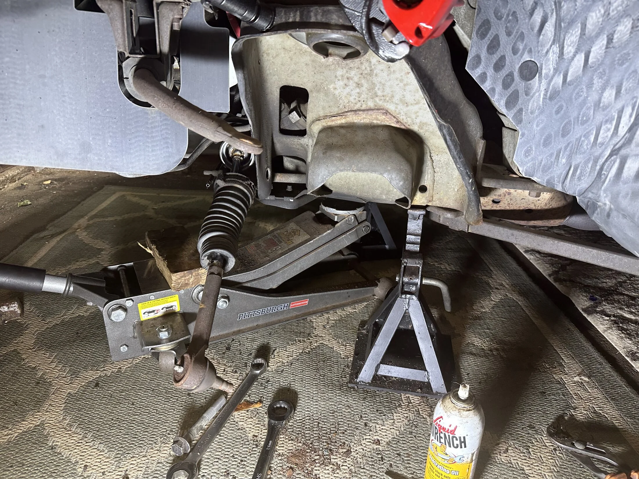

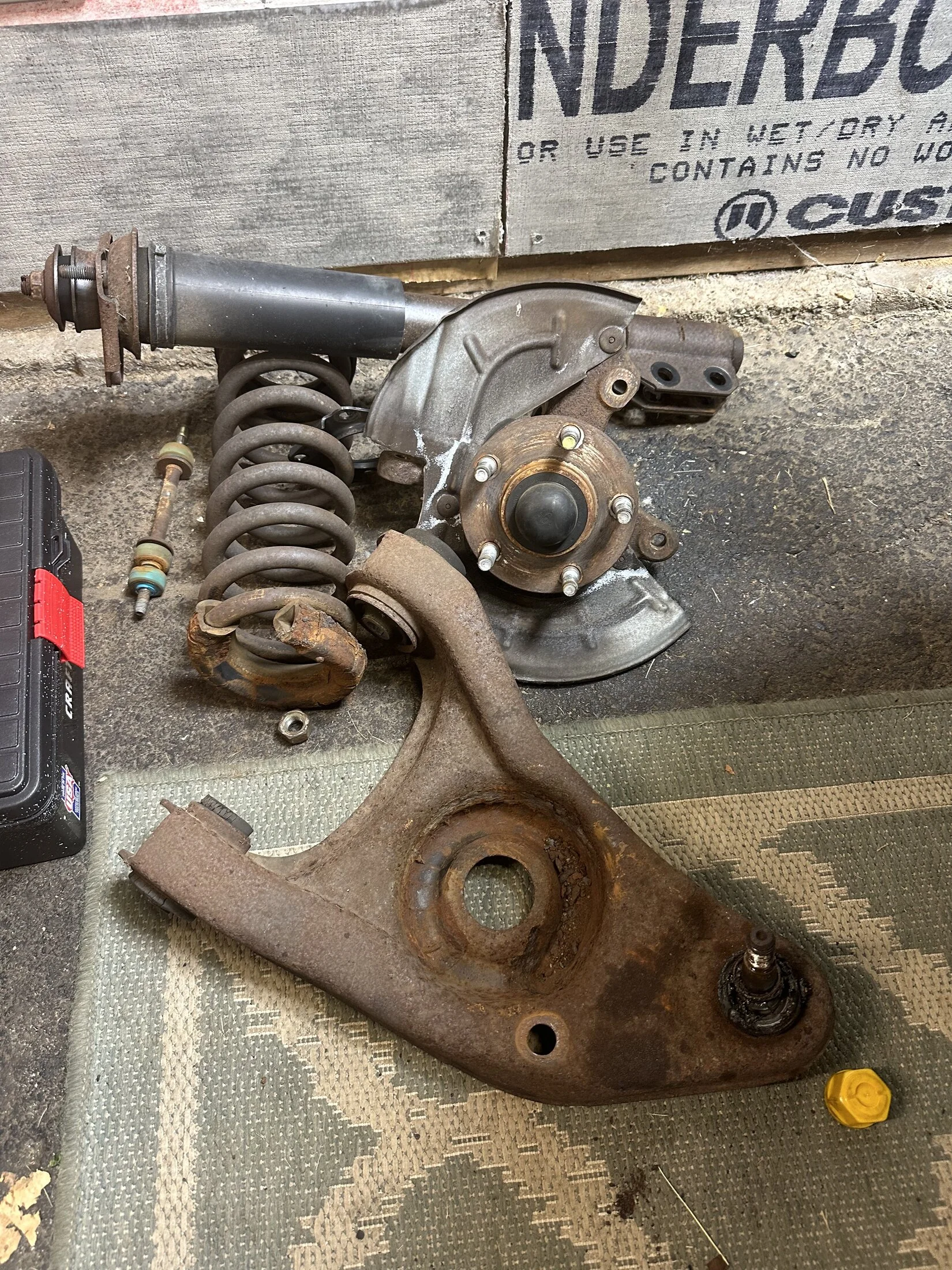

Dig into it.
Stopped here for the night. Debating if I’ll change the tie rod ends. These are nice and tight. Hate replacing parts for no reason..
All junk. Except the spindles of course.
Reactions: Noobz347

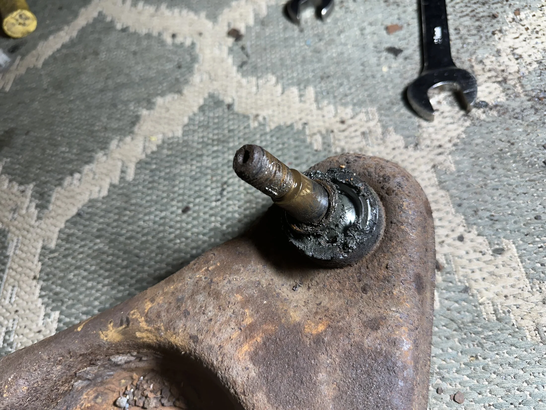

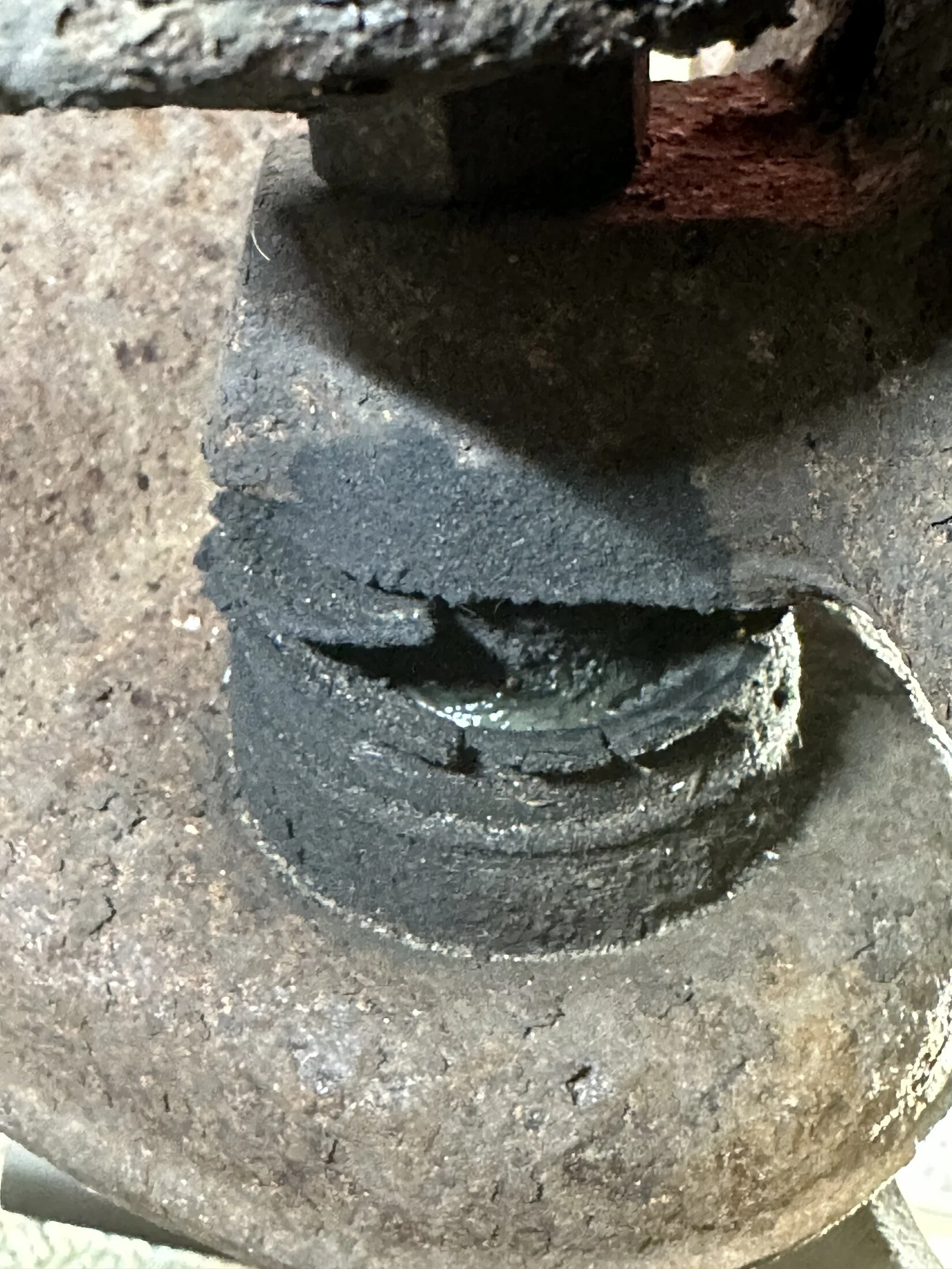

Bushing and balljoints trashed. No play on the BJ so no risk of it failing.
I see a TON of balljoint failures on the new edge forums on FB. Every week someone has one fail. Guess it’s a PSA to check your balljoints!

The bushing and ball joint are showing there age so Tie rods maybe?
I like how the new scoops are looking.
