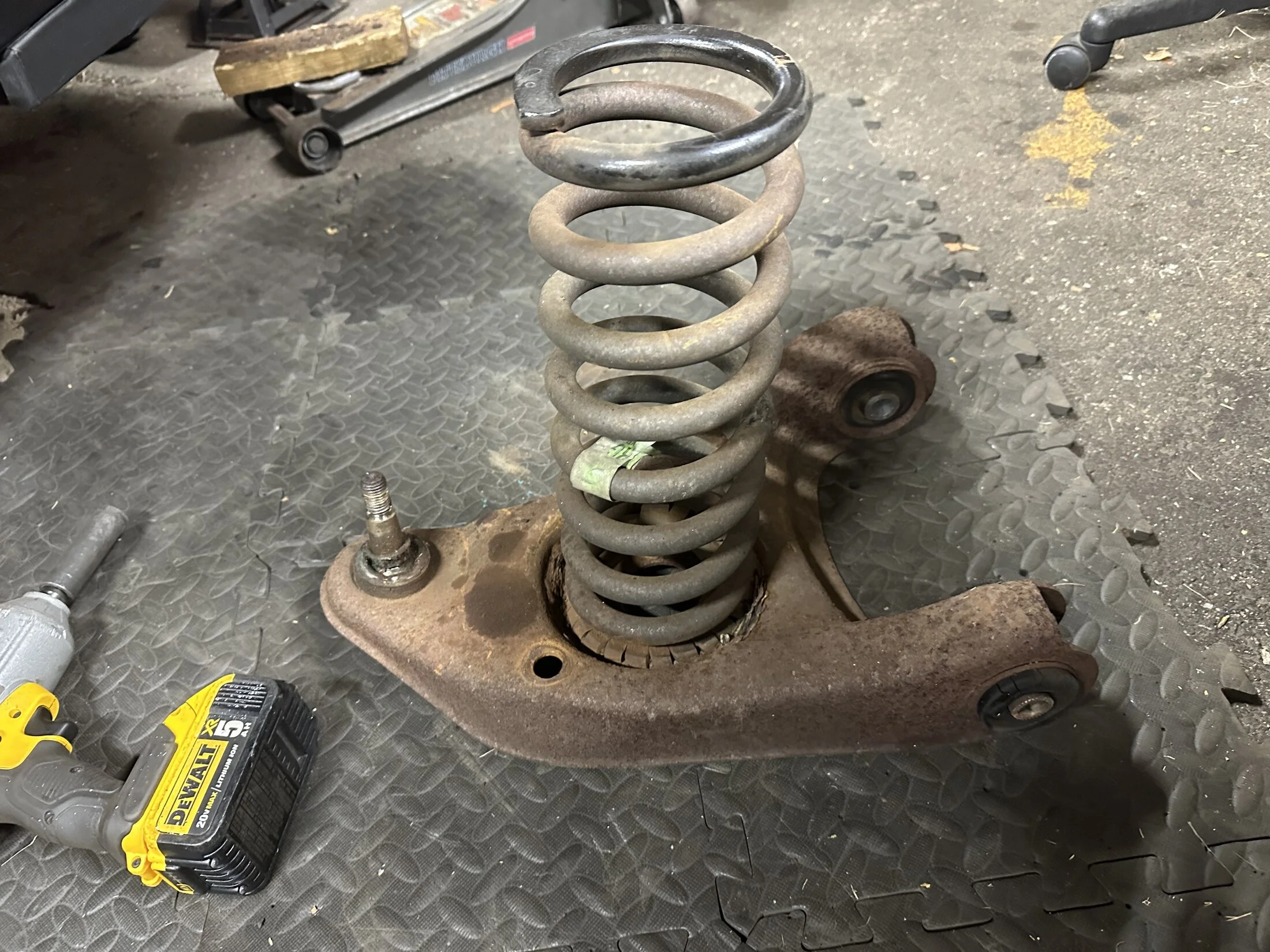

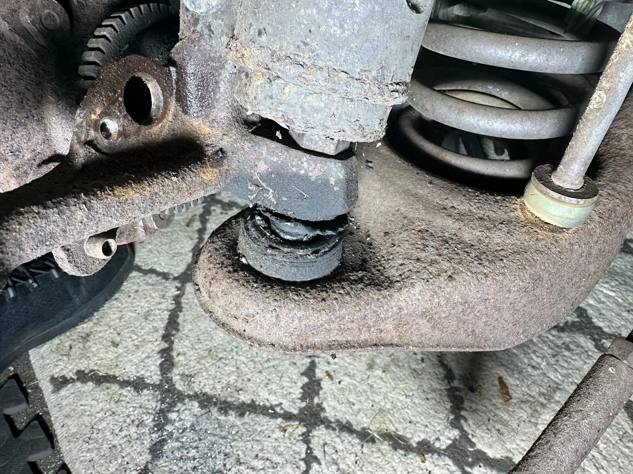

Bushing and balljoints trashed. No play on the BJ so no risk of it failing.
I see a TON of balljoint failures on the new edge forums on FB. Every week someone has one fail. Guess it’s a PSA to check your balljoints!
My PSA is to not buy cheap ball joints when you replace them. When I lowered my wifes 96 GT vert, I had to do it on the cheap. It had a bad inner tie rod and outers were squeaking because they were original and had no grease zerks. Ball joints were iffy too so since I had to order parts I ordered 2 Mevotech ball joints. Put everything together and got it aligned. Everything was good. A couple years later my wife was complaining the car did not feel right. I thought to myself, that is werid, the front end is fairly new. I drove it but I did not notice anything weird. When I did the next oil change, I took a good look under it and still no smoking gun. Well, shortly after, my wife was on her way home from the barn where she worked, with my youngest son, well the ball joint let go and came out of the socket on the pass side when she was at speed on a country back road. Luckily nothing happened to her, my son, or the car. Ball joint had about 9,000 miles on it and was 2-2.5 years old at that point. I replaced them both with Moog. Never again will I use Mevotech.
Man those control arms look rough. Hard to believe they barely have 70K on them.
The control arms really are the worst part of the car in terms of rust. Front springs too. The actual body of the car is in fine shape, I still have stock exhaust on it and it’s solid and pretty rust free. No idea why the control arms got so crusty.

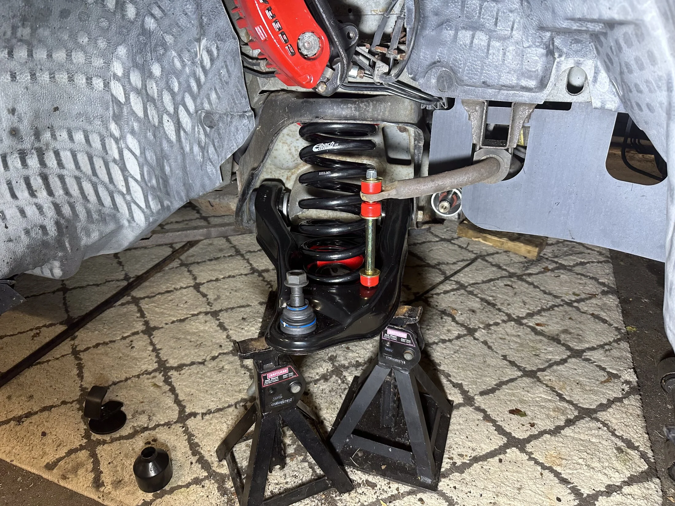

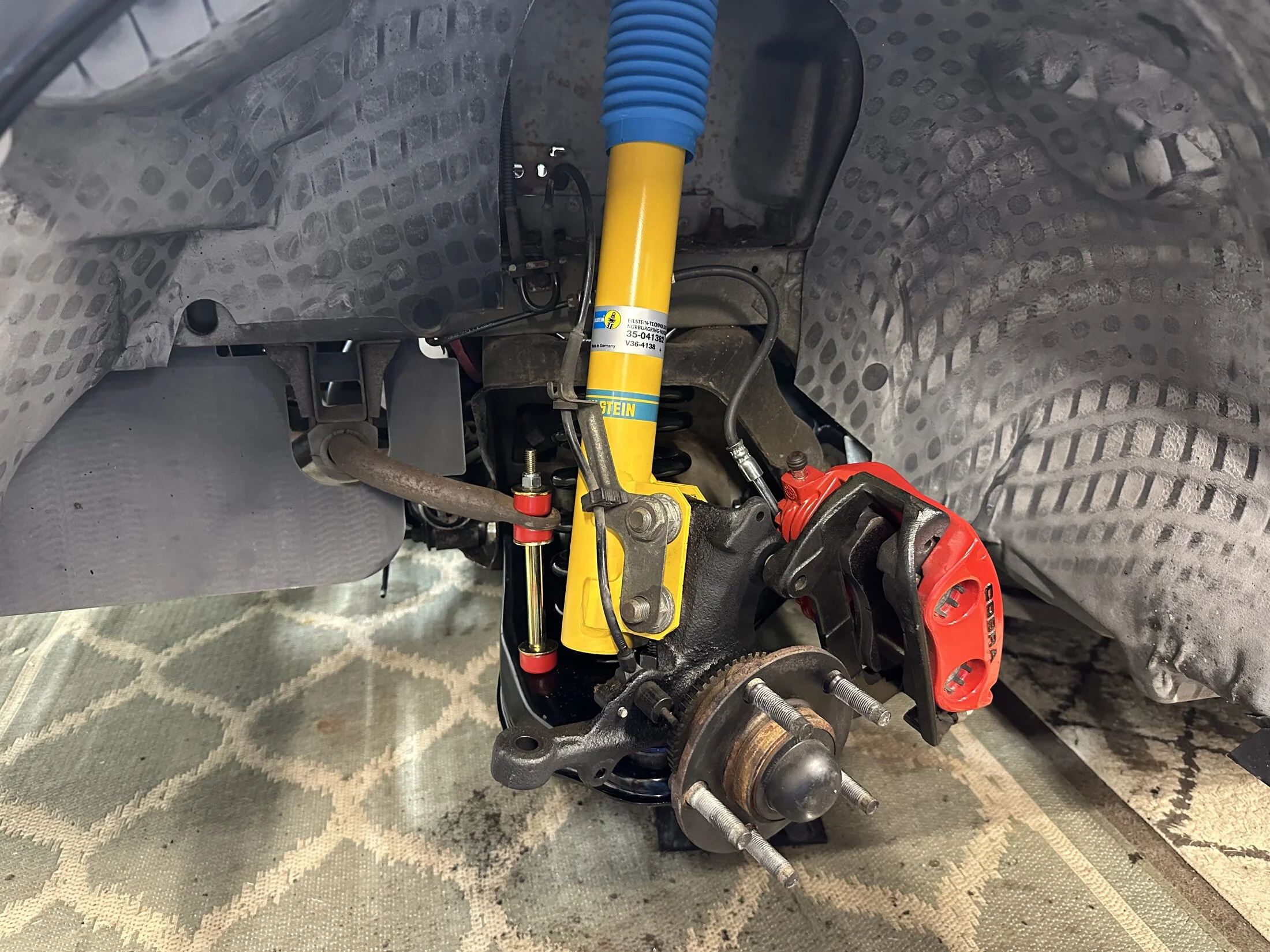

anyway…making progress. I did order new tie rods. Ford Motorcraft. I figure I was here and needed to align the car anyway. Tie rods not here yet however, so I had to stop.
New..
Control arm
Shock
Eibach pro-kit springs
Poly isolators
MM caster camper plates
Poly endlinks
Poly steering rack bushings
Inner tie rod
Outer tie rod

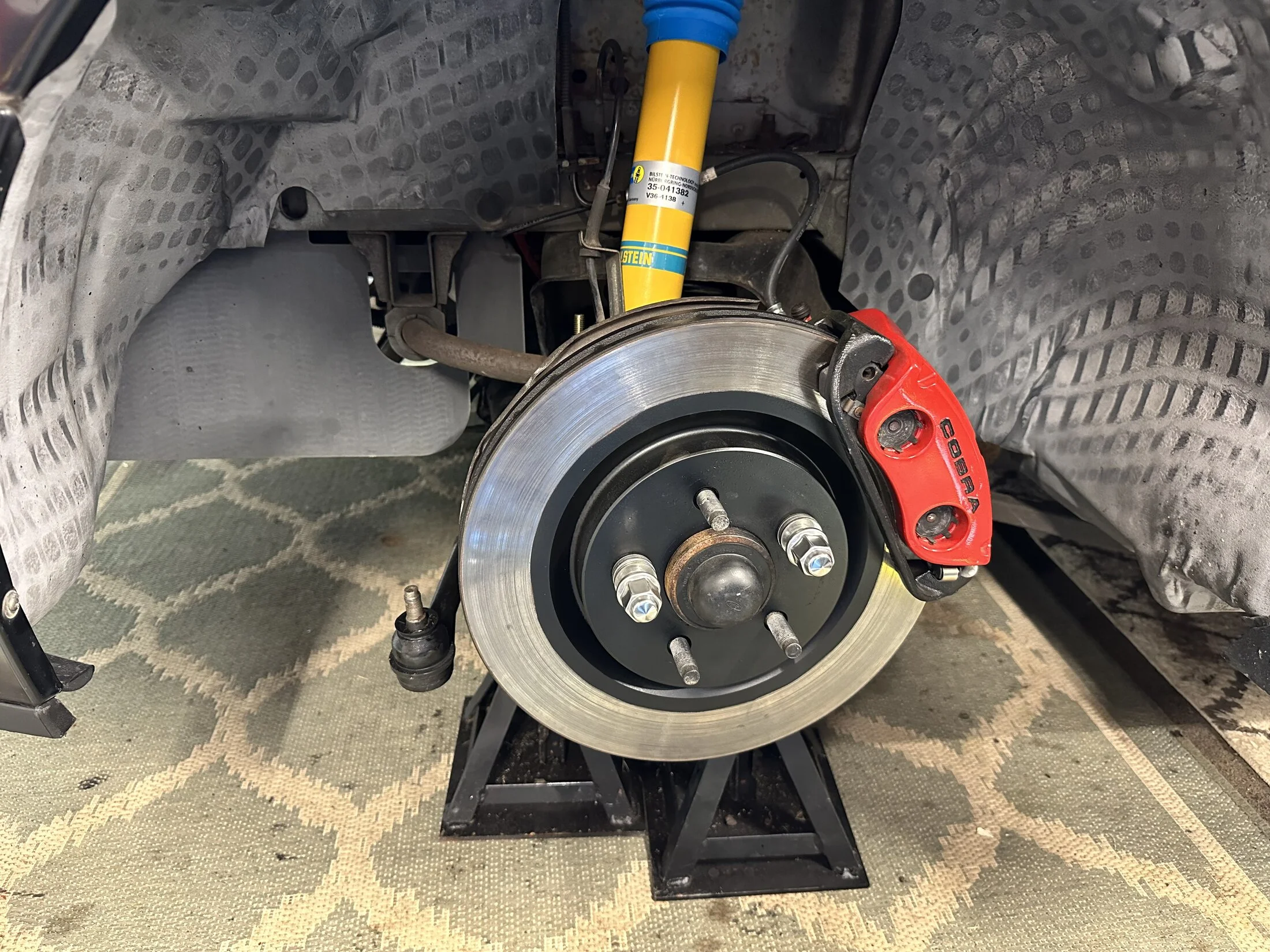

Painted the spindle.
Cobra calipers and rotors
I did mangle the dust shield a tad. Gonna bend it back best I can as I’m not paying $60 for replacements. A bent shield is fine.
I need to get some nut marking paint and mark my nuts. I’m paranoid about that sort of stuff, especially ball joints
One side done.

Helps with a quick visual. 99-04s don’t use castle nuts on the balljoints so this helps for a quick check to see if it’s spun. I torqued this sucker to 150 ft-lbs, so it shouldn’t.

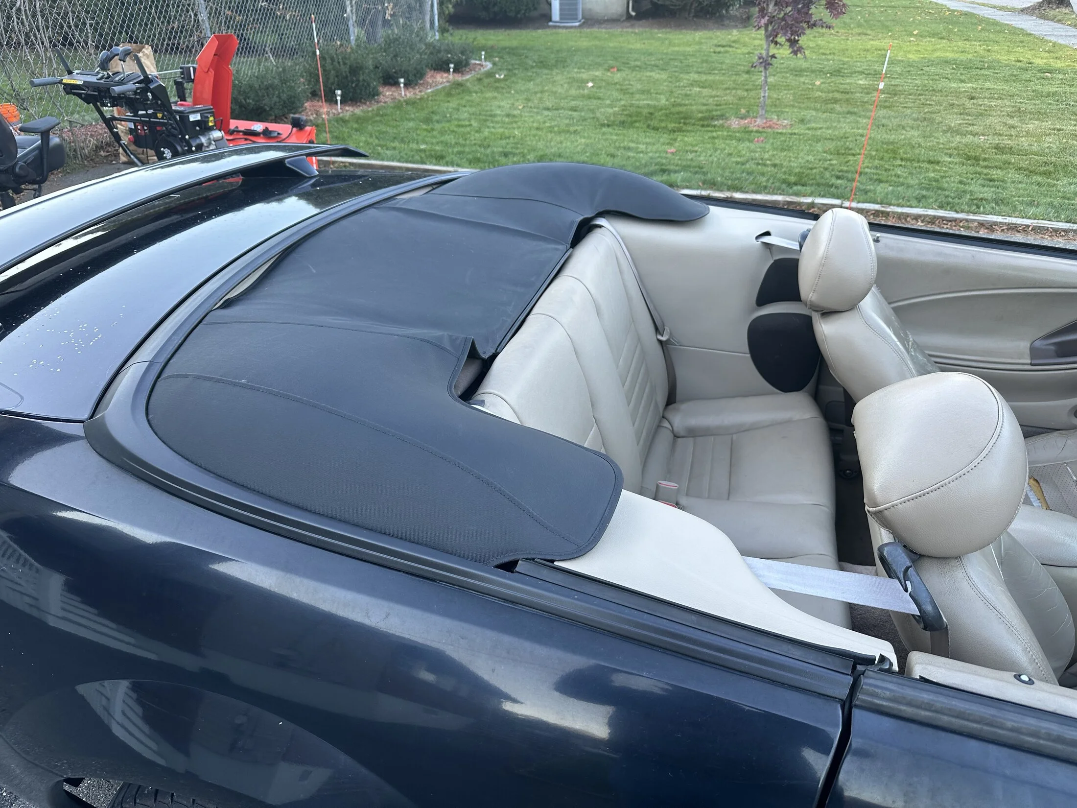

Decided to play with the new convertible boot I got. There are two styles. 99-00 and 01-04. I got the 01-04 version. Fits ok but it needs a day in the hot sun to flatten it out. Will revisit in the spring, but I like the look

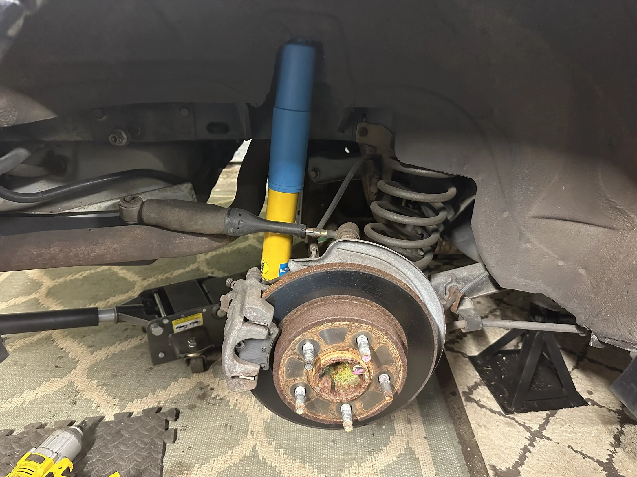

Started workin on the rear. I’ll have to inspect the control arms closely. Quads seem to be ok but maybe I should grab some Gabriel replacements. I will not be putting aftermarket control arms in.
Gonna check these calipers and slide pins, replace the brake hoses due to age, and paint up the rotors/calipers a bit.
I think I see signs the fuel filter grommet is leaking, so that’s on the list. I think the 98+ version doesn’t need the tank dropped, but correct me if I’m weong

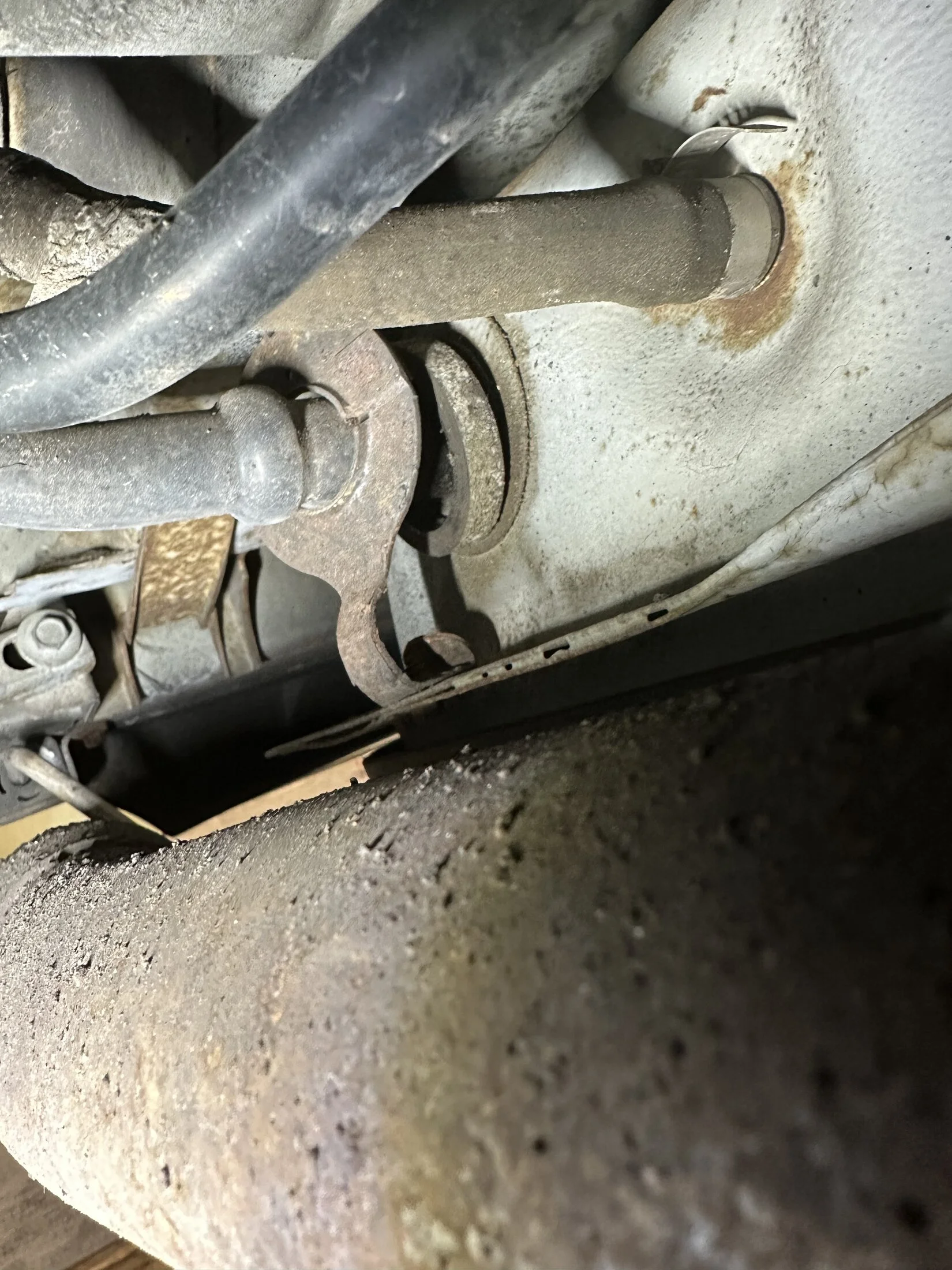

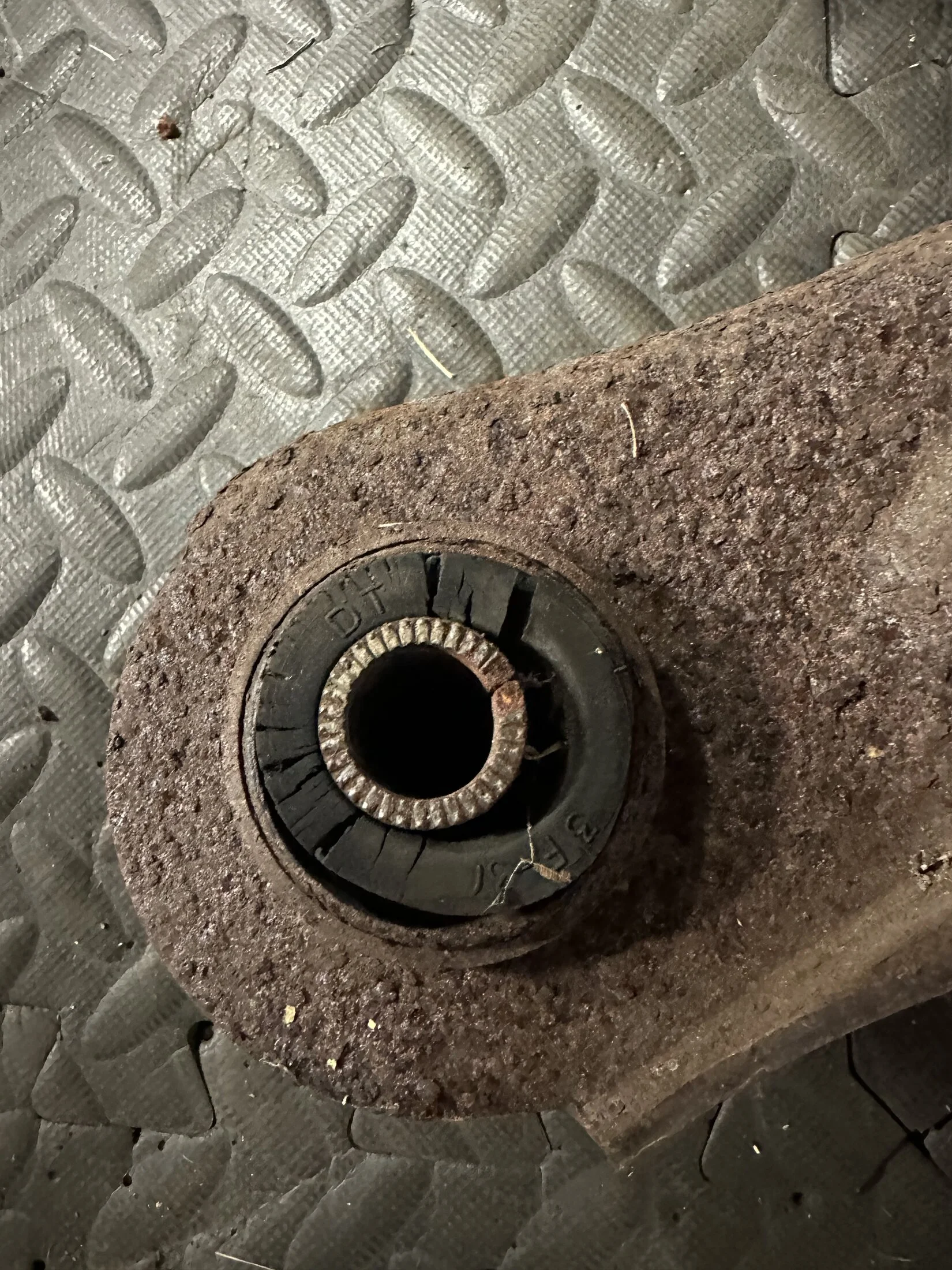

Rears are done. Lower control arms were in decent shape. Uppers look like the inner sleeve has torn away. Not destroyed yet, but I’ll put a set of uppers on the list for winter tasks
That’s the OE exhaust pipe to the right. For a New England car and 23 years….that’s pretty damn good.
Did the pass side front ball joint was in rough shape, which is what prompted this. Fortunately when I got it out, it was still tight so wasn’t close to popping out…yet.
Bushings are trashed as expected

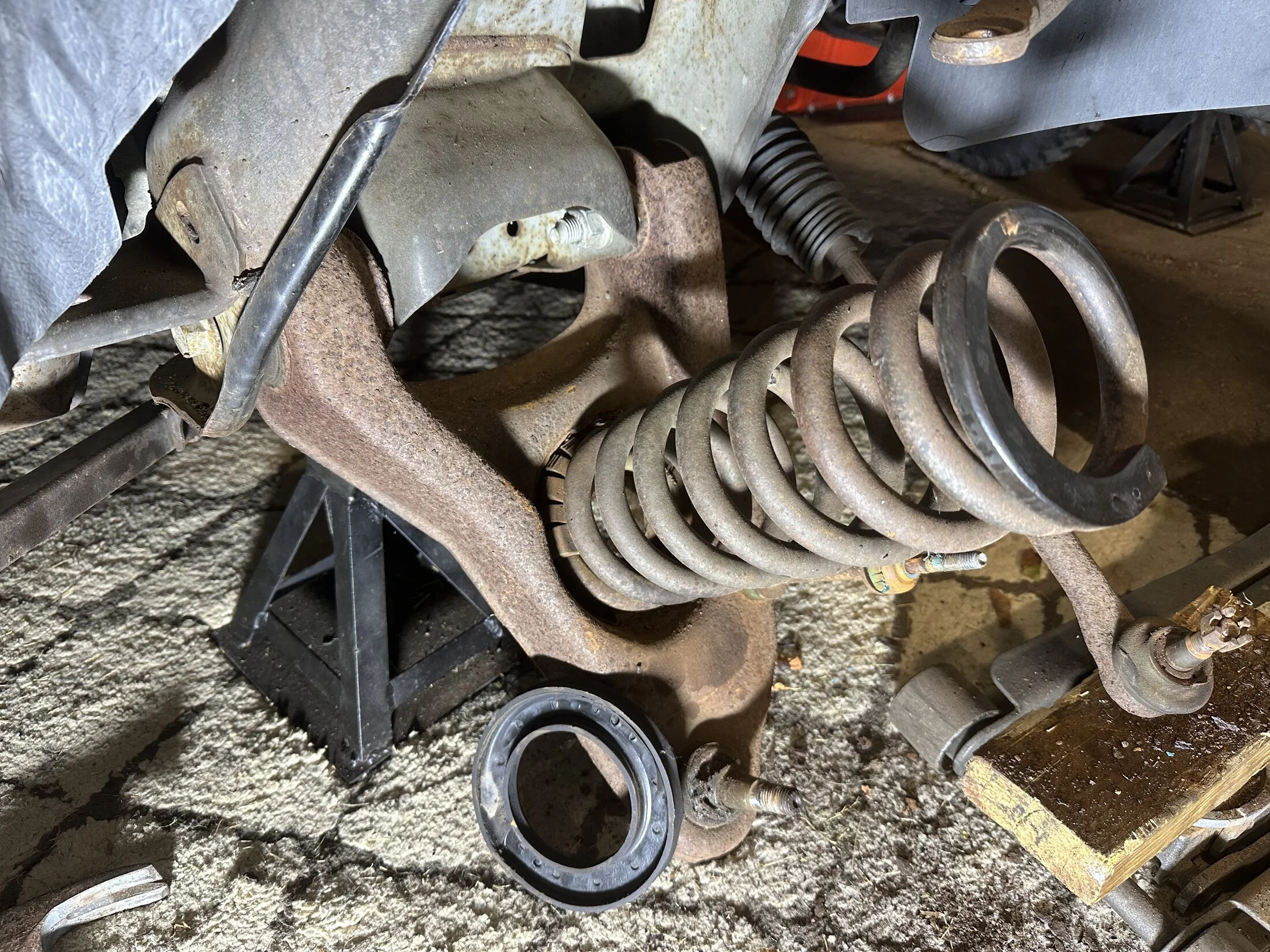

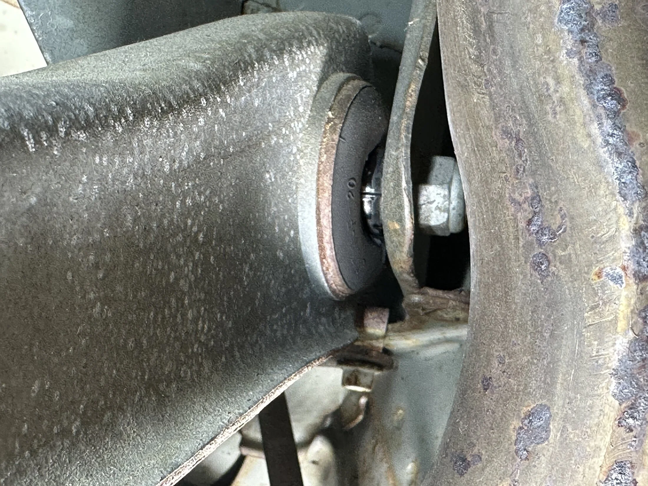

And here’s something you don’t see everyday. Spring was RUSTED into the perch. Couldn’t get it out: had to loosen the control arm bolts to swing the arm down far enough to pry from the top. Sketchy as hell
Yeah…that’s one solid peice
