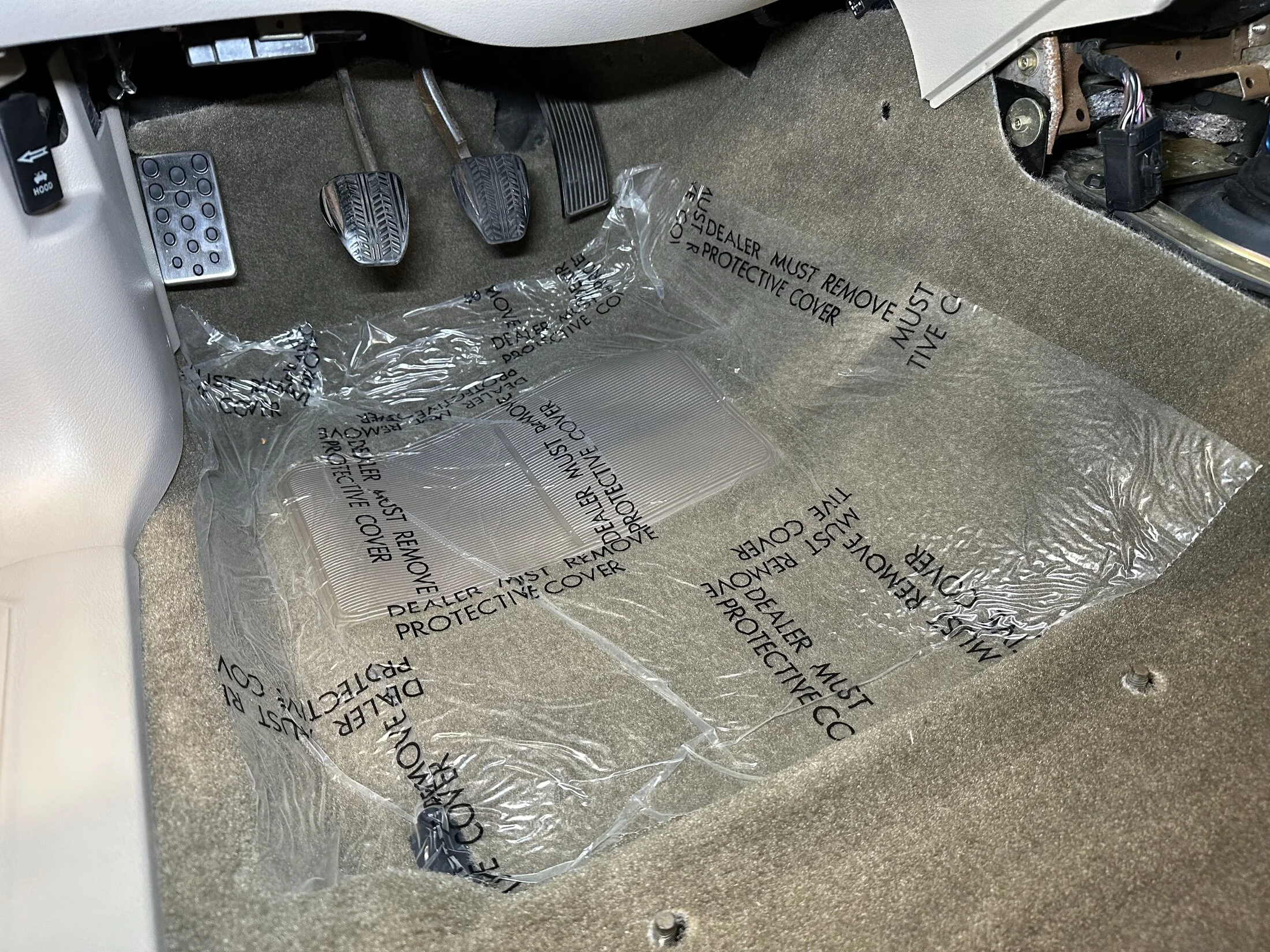

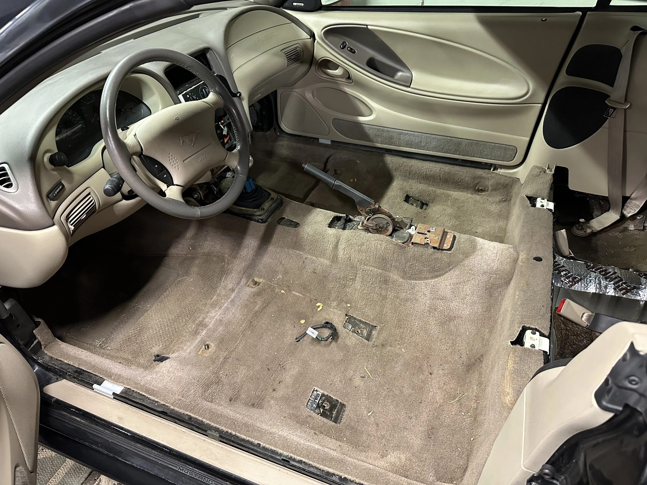

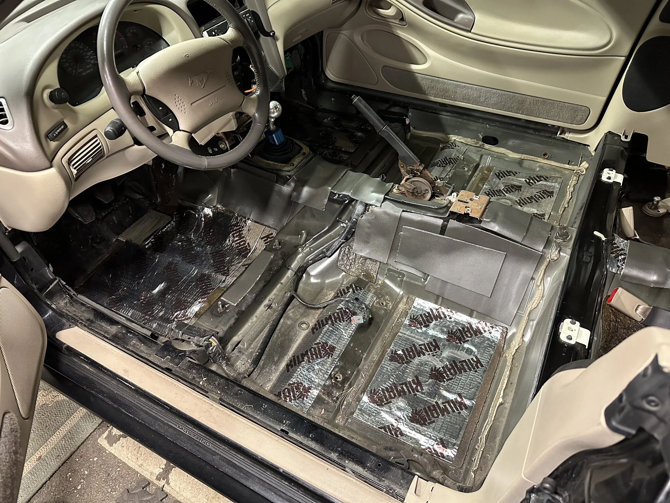

Out with the old.
You can see how faded it is
Used up some remaining kilmat and foam insulation. Figured I’d toss some in the tunnel to knock down heat intrustuon

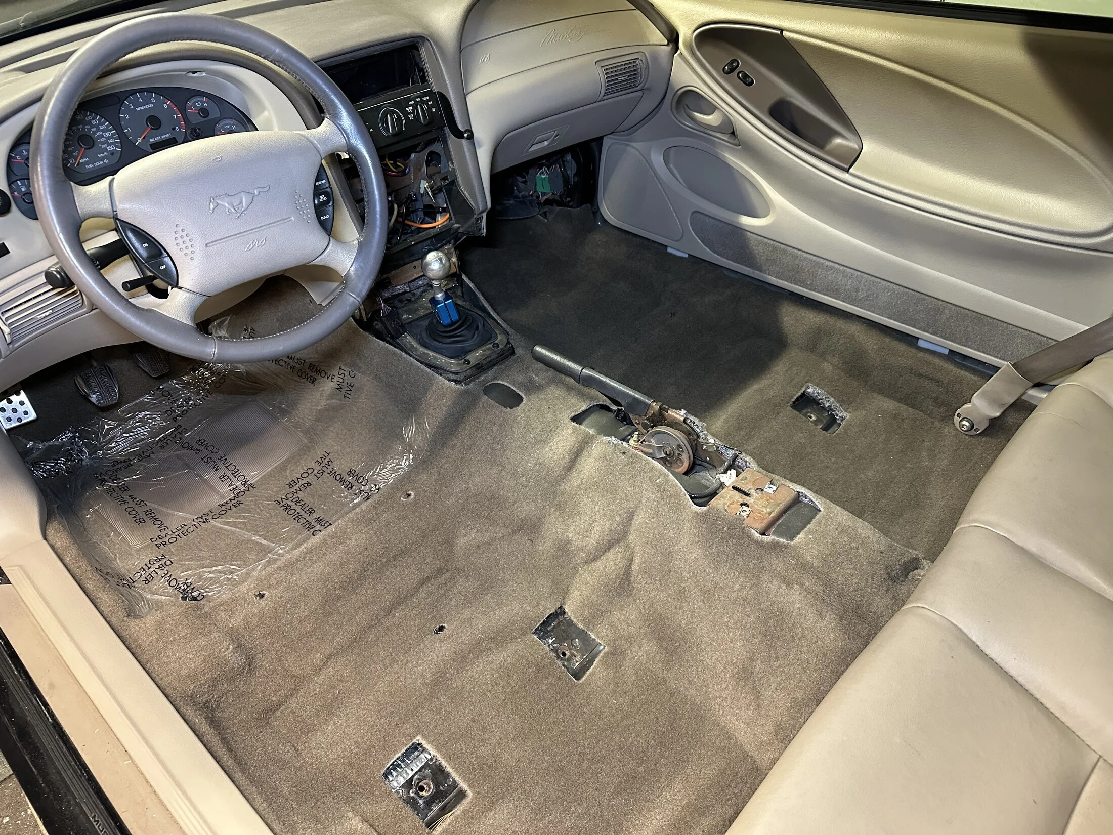

And NOS carpet in!
You can see a teaser of where I’m going with the pedals next.

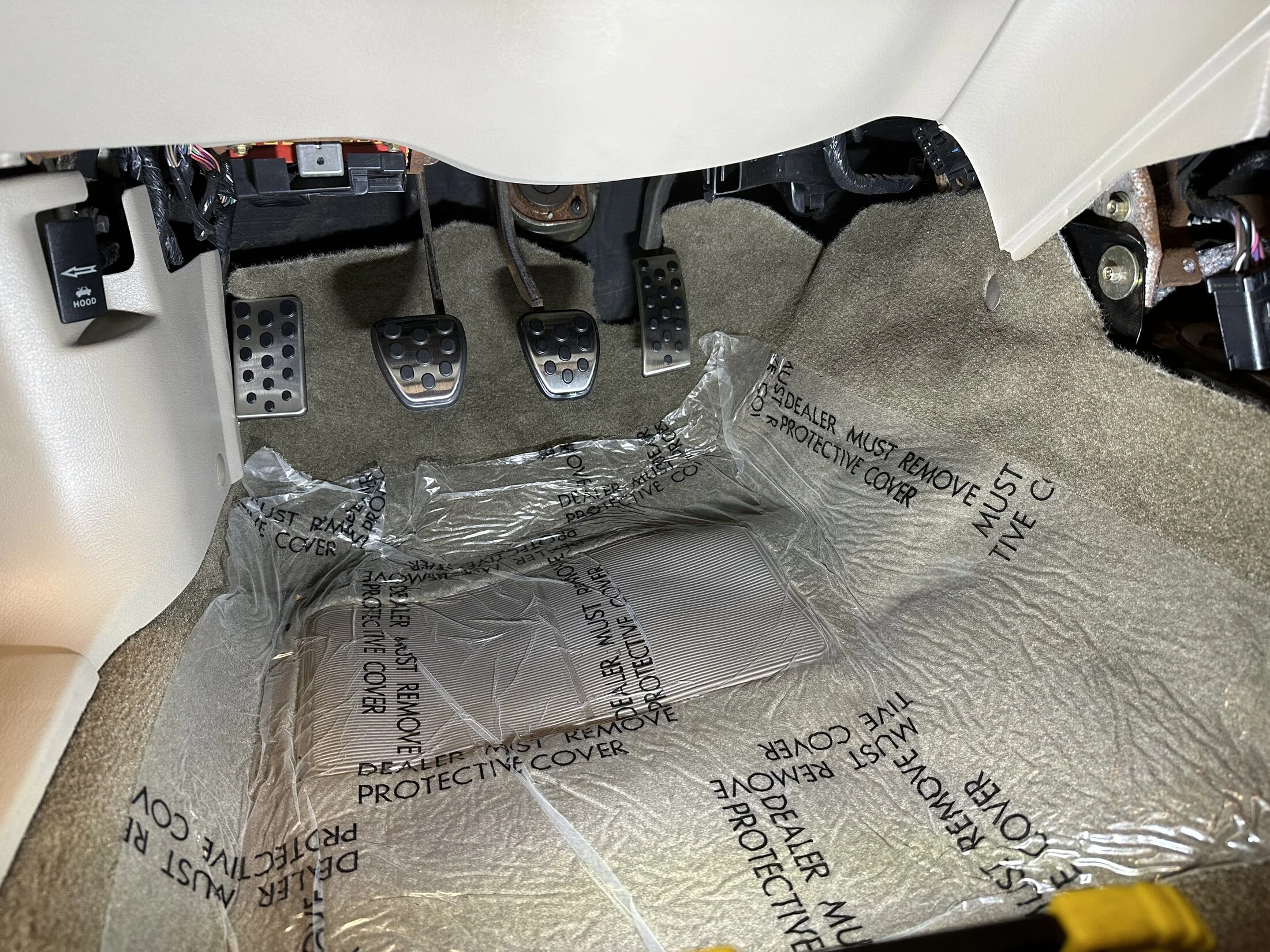

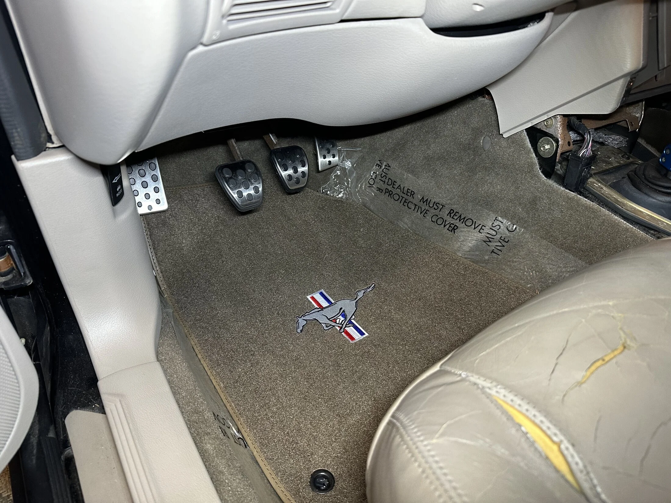

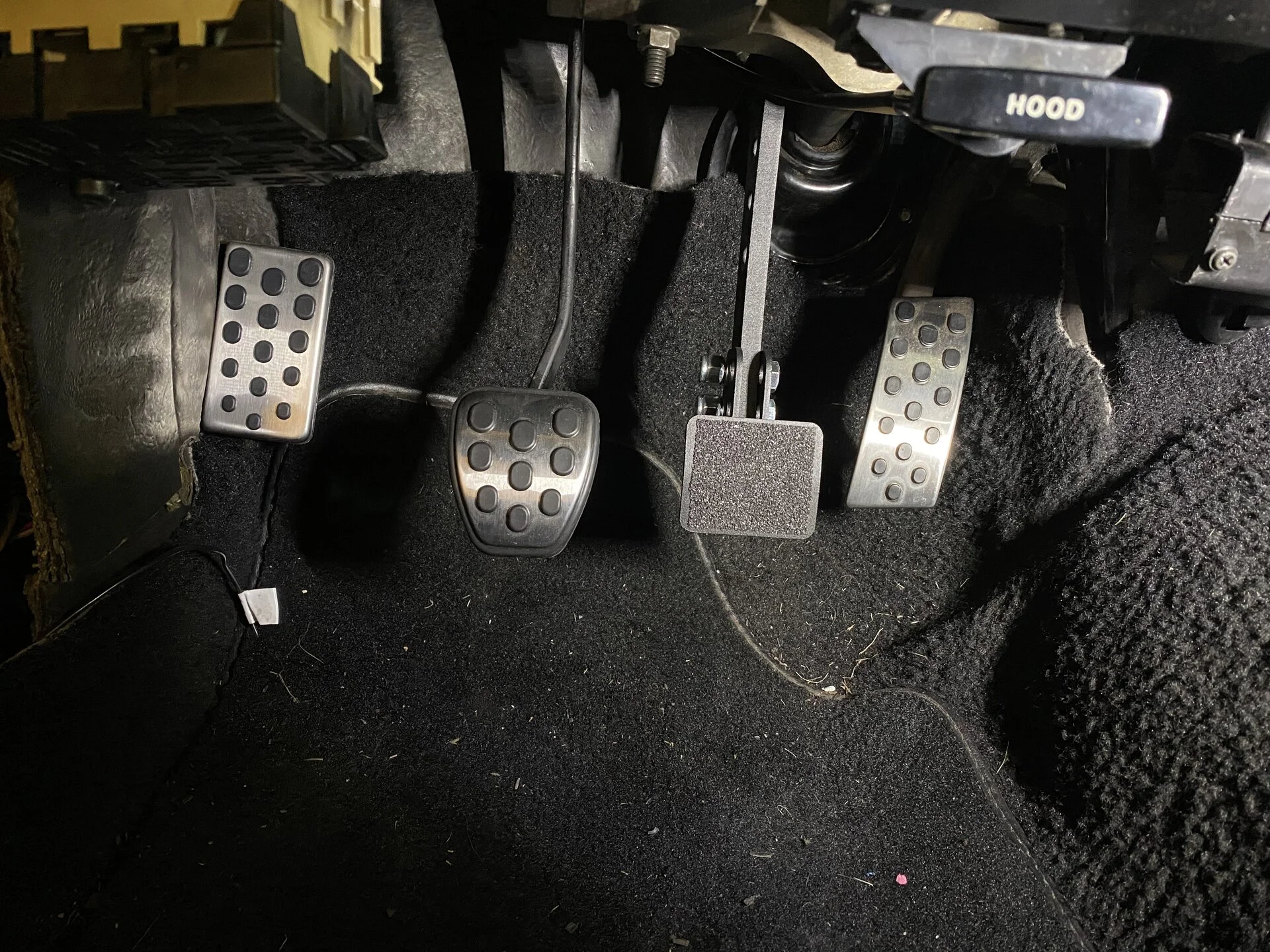

Ford racing pedals in. Forgot what a PiTA the clutch and brake were to do. Last time I did this was 15 years ago in my 2003 GT
Gonna start on the hood scoop. Need to concentrate on that since I only have one shot to drill correctly

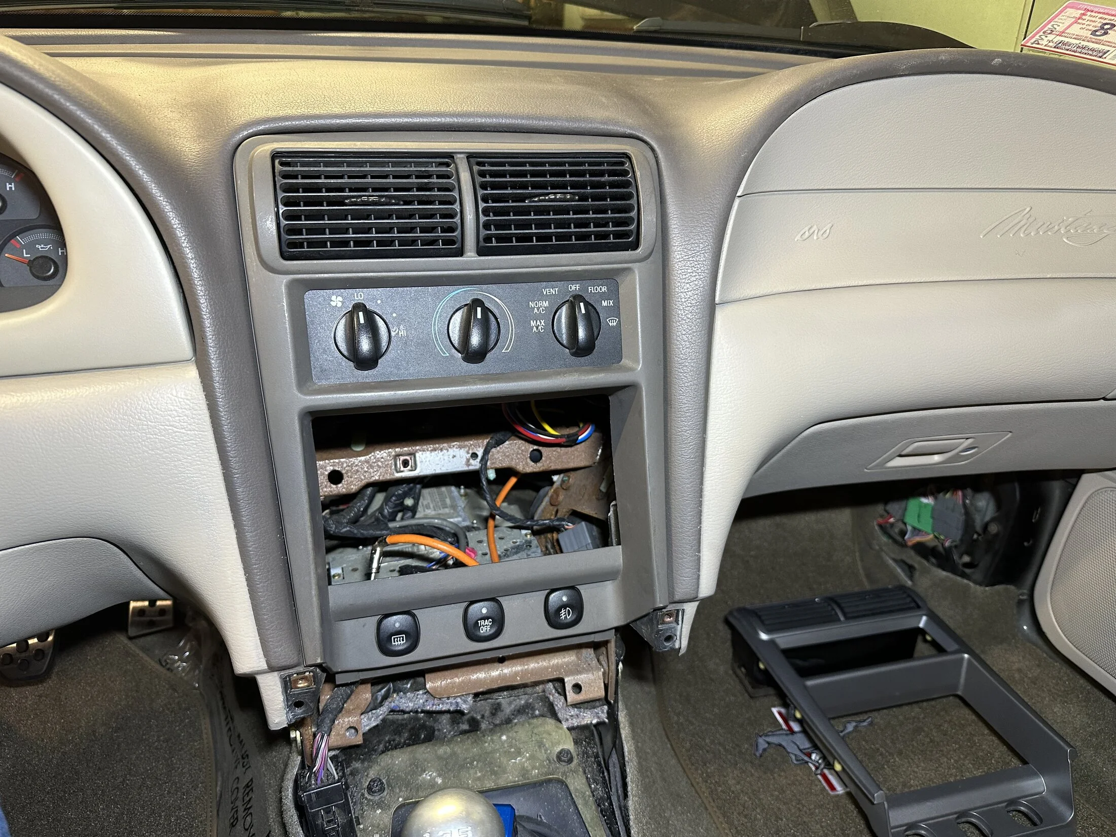

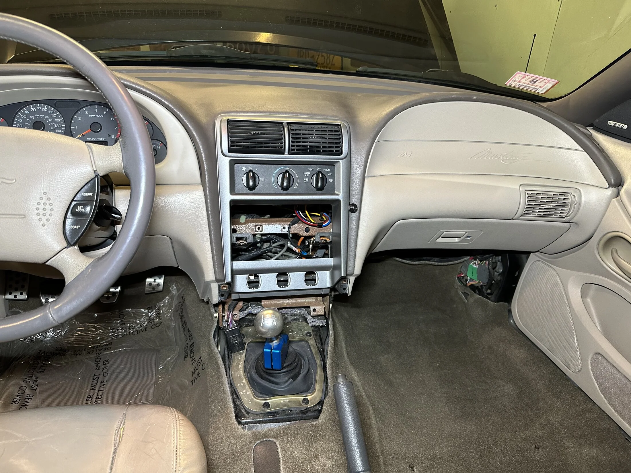

Prepping for next stage.
Gotta hack this out a tad to mount a double din setup. No going back.
Anyone want to talk me out of it?
Normally I hate such “permanent mods” but I don’t think it’s gonna matter on this car. This ain’t a collector car.

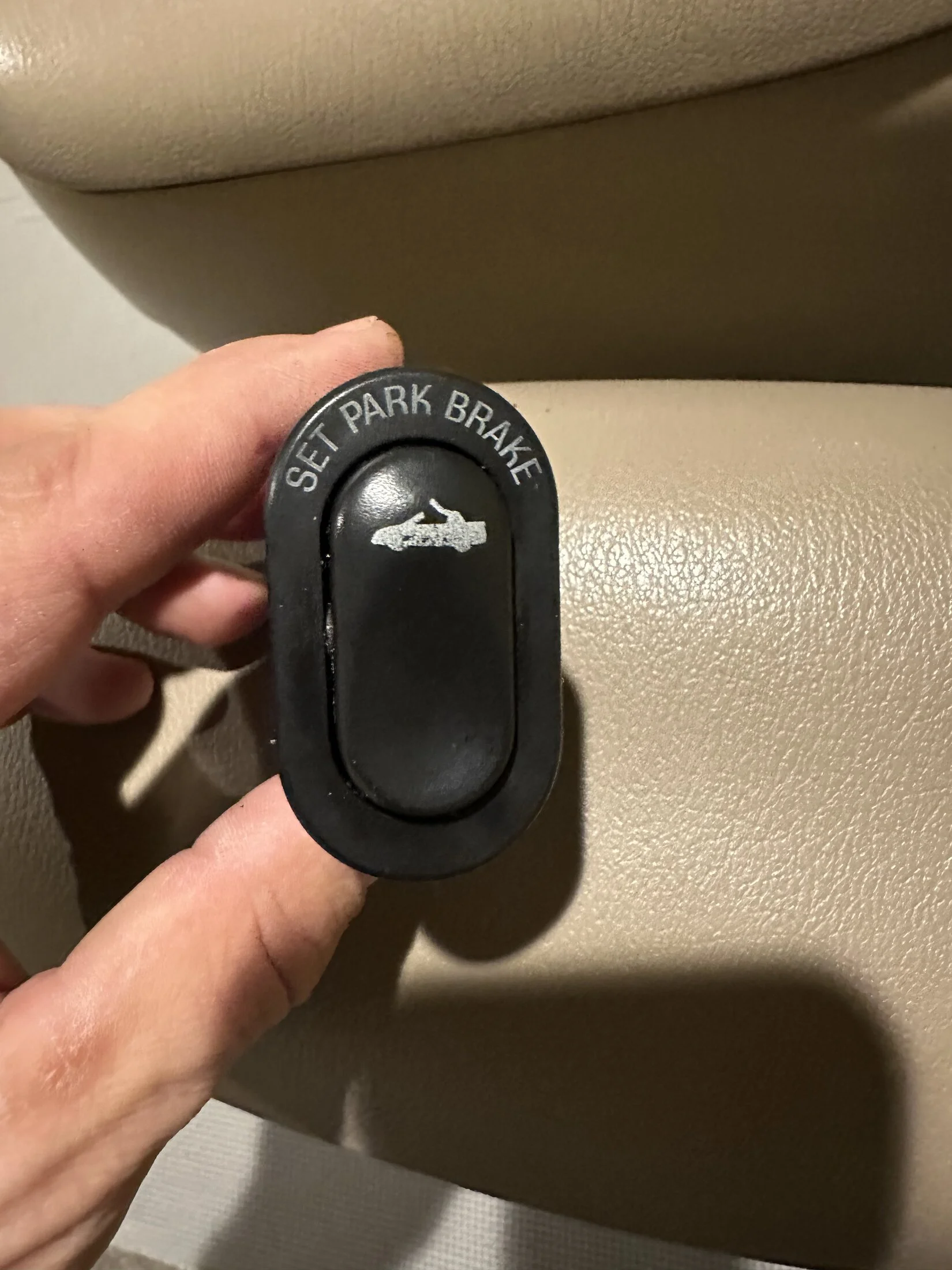

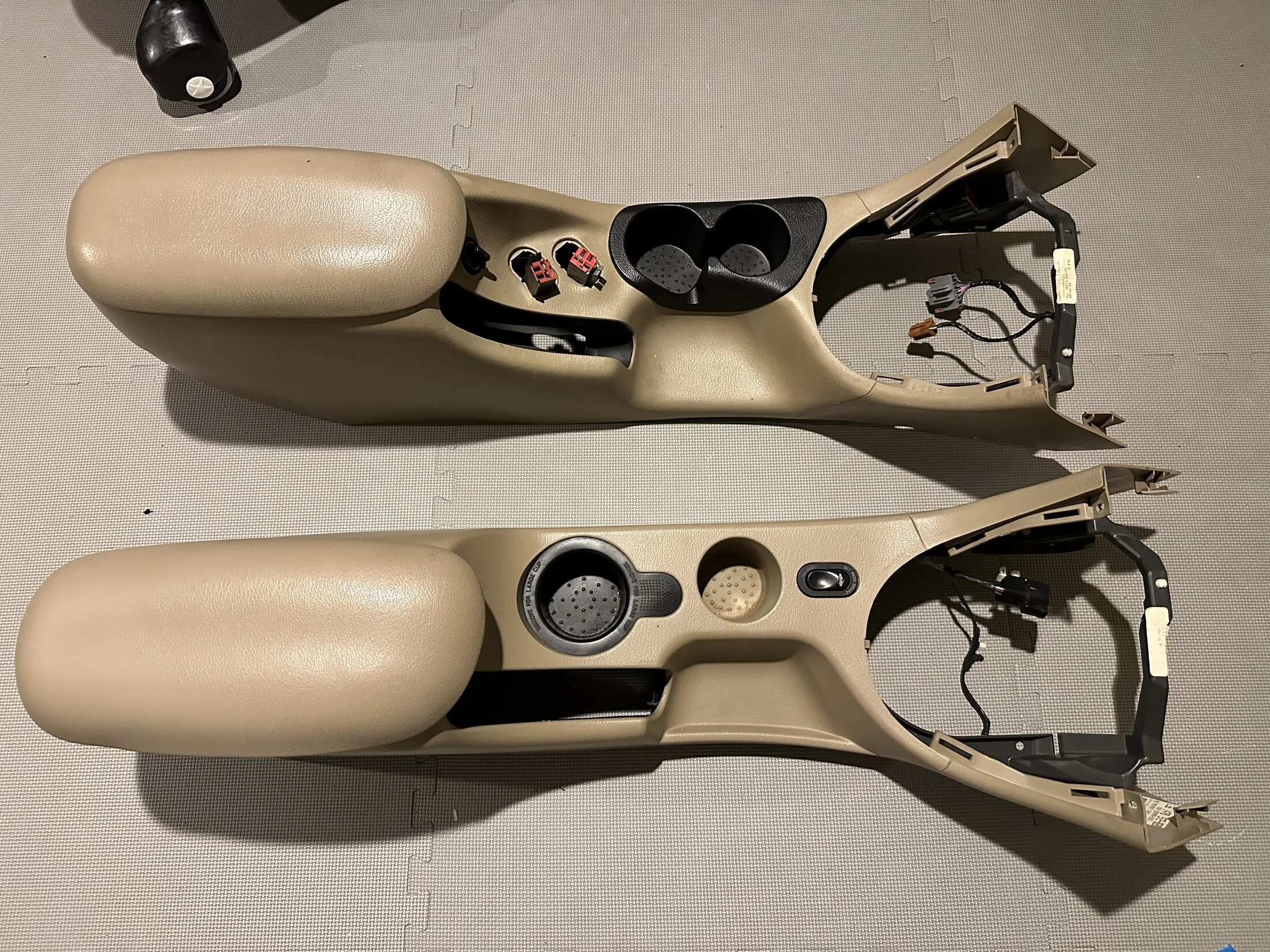

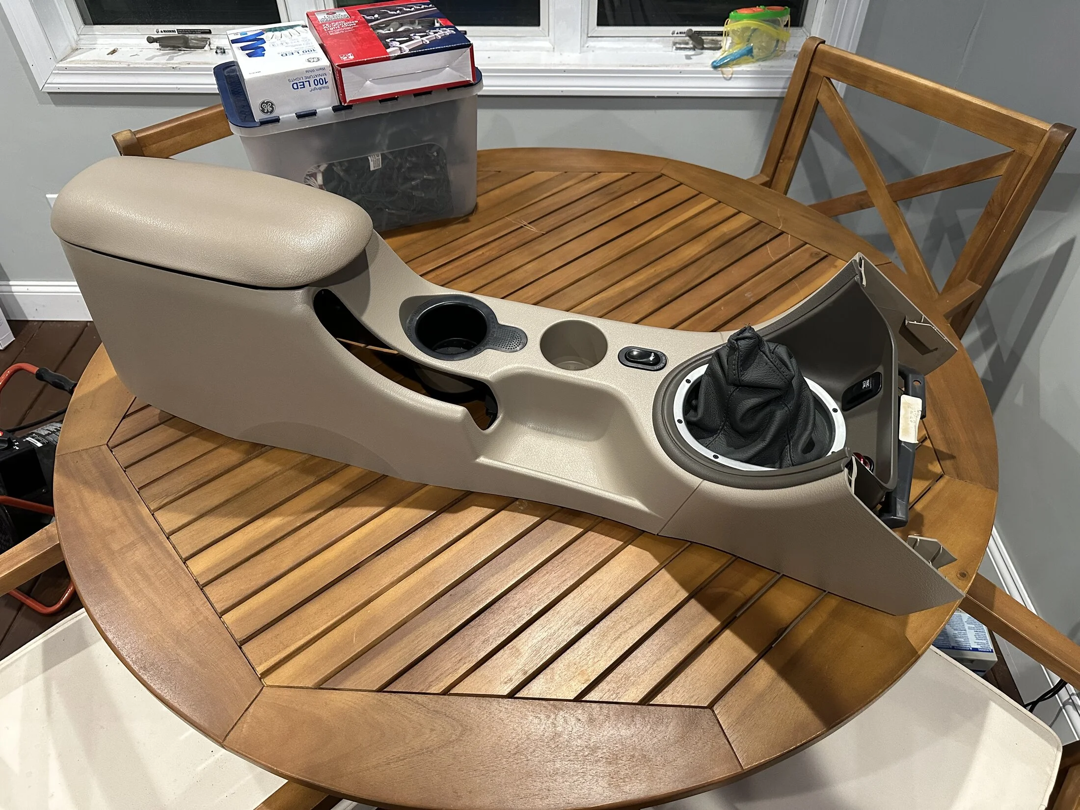

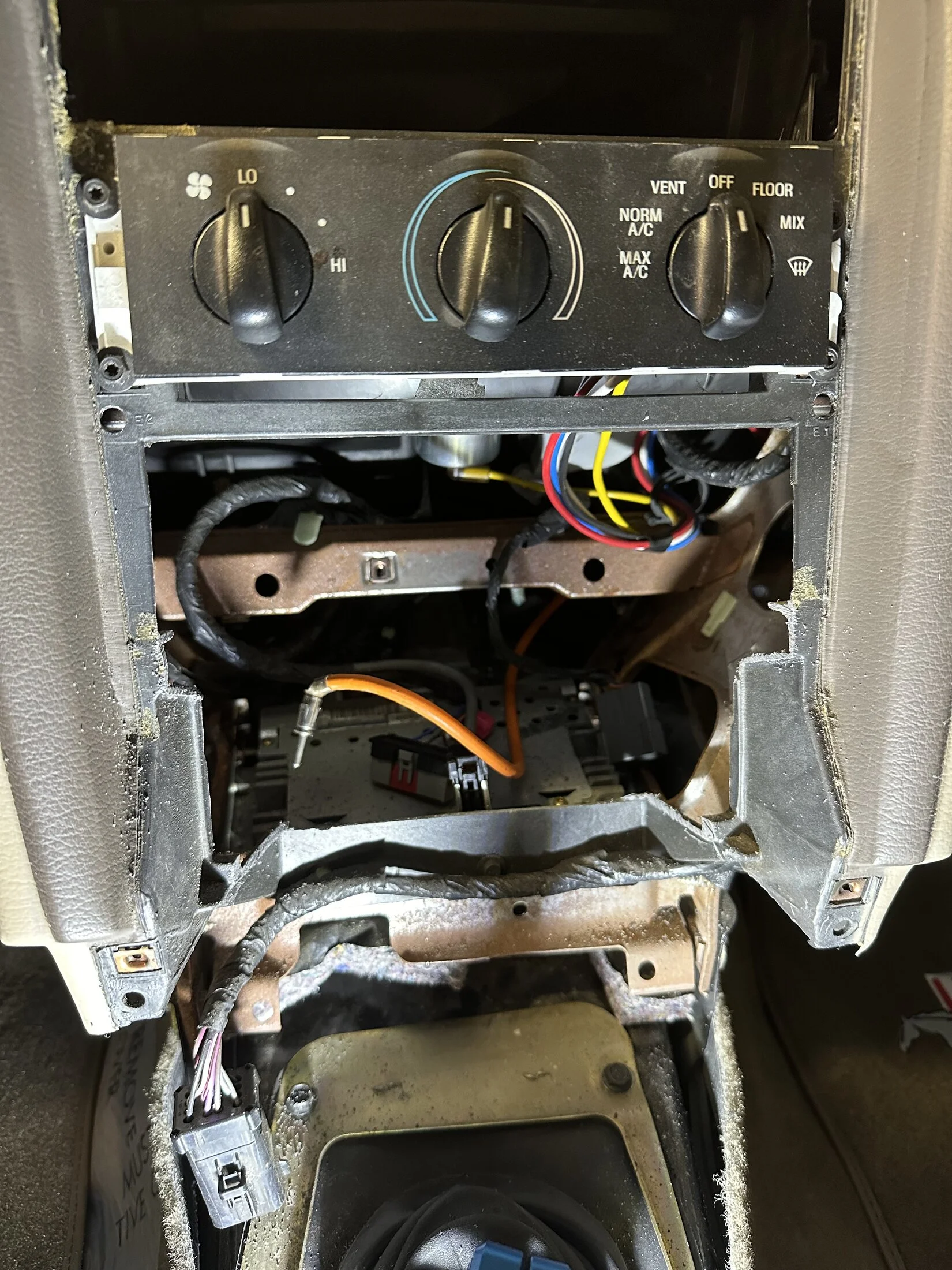

‘01 console has arrived. Not a bad one either. Only negative is the clips for the parking brake boot are busted, but I was going to run a Redlinegoods boot anyway so I’ll come up with alternative mounting
Added bonus is that it came with a Ford OE convertible top button that has the lettering on it still. These usually wear off so the button is blank.
Need to disassemble it, give it a spray with dye, install the 99-04 wiring harness in place and figure out the parking boot.
Fun project. This gives me a bit of nostalgia from when I owned my 2003 GT. I daily drive drove that car 6 years in my early 20s. I still remember plopping my cell phone in the rubber cupholder and my coffee in the front holder.
Really this whole build has been a trip down memory lane for me in terms of these cars. I think the 99-04 is more of my coming of age car even more than Fox bodies are.

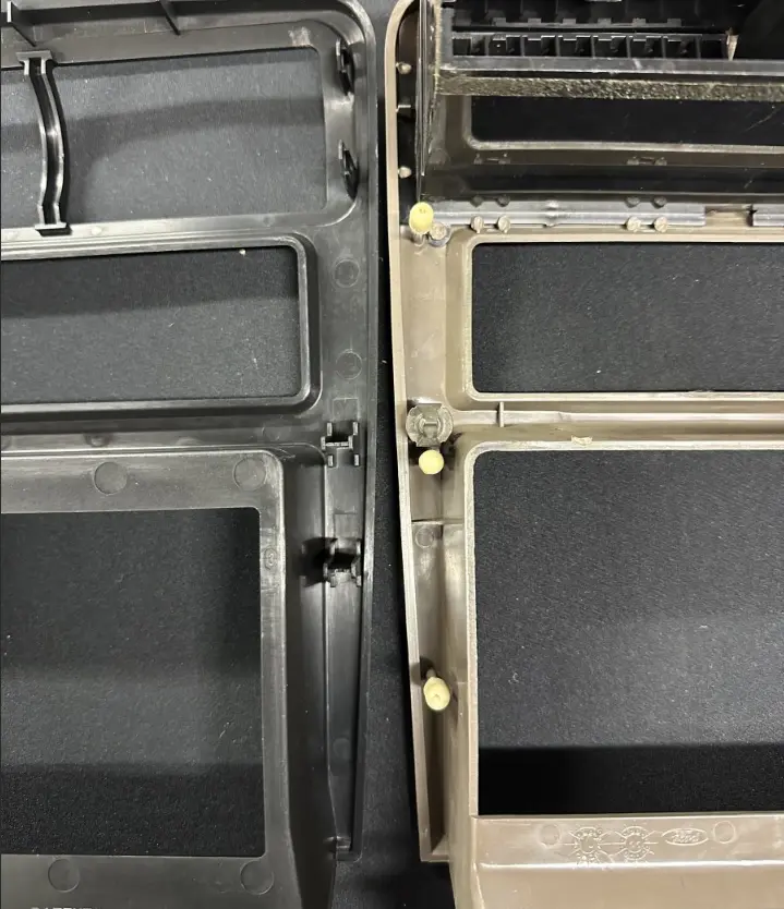

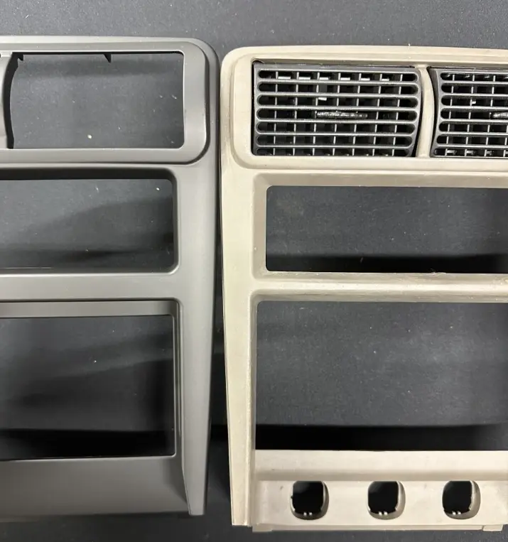

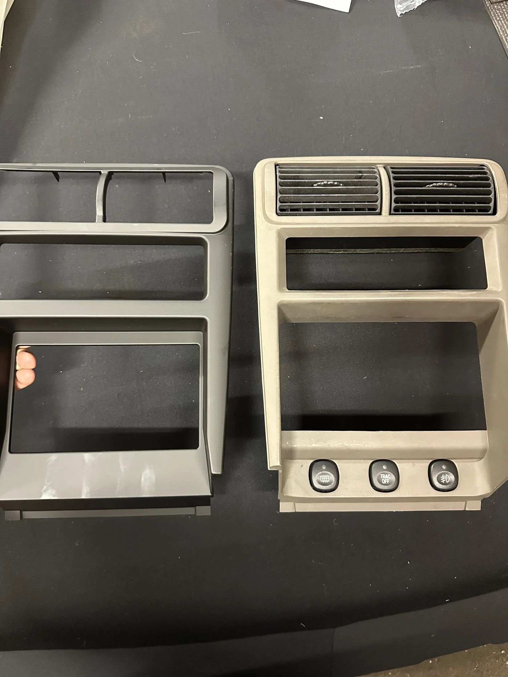

So for the DD radio install, i ended up picking up a Metra 95-5703B kit, and didn't like it. Initially I wanted to use the mounting brackets with the OE ford radio bezel, but i quickly found this was not going to work.
Metra kit on left puts radio in a slightly lower position
The unique mounting bracket only works with the metra radio bezel.
The metra kit uses two brackets which locate on existing holes in the dash to mount the radio.
So i decided to make my own. Stay tuned

No going back now.
Gotta work on my radio mounts and rewire everything for the new buttons. Easy.

That’s really the only thing I don’t like about it. Lack of buttons. Really it’s for the 94-00 cars that lack the buttons anyway. I’m just pairing it with the 01+ console swap (and defrost relocate) so I need to use the buttons.
The metra kit works well. Some matching SEM paint and It would be a good fit. The install is easy. You trim off the two ears with a small coping saw and bolt the brackets up. The trim panel clips to the bracket.
I’m just doing this as a sort of nostalgia build in tribute to my old ‘03 GT, hence the selection of specific parts. That’s why I’ve added a lot of 01+ parts to the car and stuff like Ford Racing pedals, and the silver radio trim (you can see bezel on pass floor in above post). So because of this, I need to do the OE radio bezel and not the metra kit.
What exactly is the pita part of it? And is it applicable to the 79-93 Foxes?
Any hints and/or look-out-for's? I saw one site said to immerse them in near-boiling water to ease installation.... any comments on that?
Dead pedal and gas pedal are easy, and also direct swaps onto the Fox. Takes maybe 10 min combined to install those. It's the brake and clutch pedal. I boiled them, and then it was a process to use a tool to pry the rubber folds up and over the pedals to install them. Just an awkward position to work in too. Those took maybe 15 mins each pedal to install.
You can put them in the fox, but the brake and clutch pedal are not the same shape. I got the clutch pedal to work, but my brake pedal is the MM hydroboost pedal. I actually bought a spare pedal that I was going to hit with a grinder to make it the right shape and install the pedal. I seemed to have misplaced it so i'm currently looking for it.

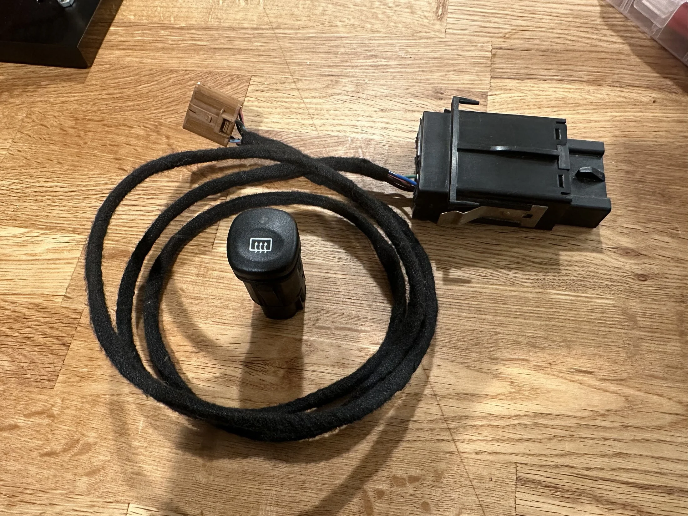

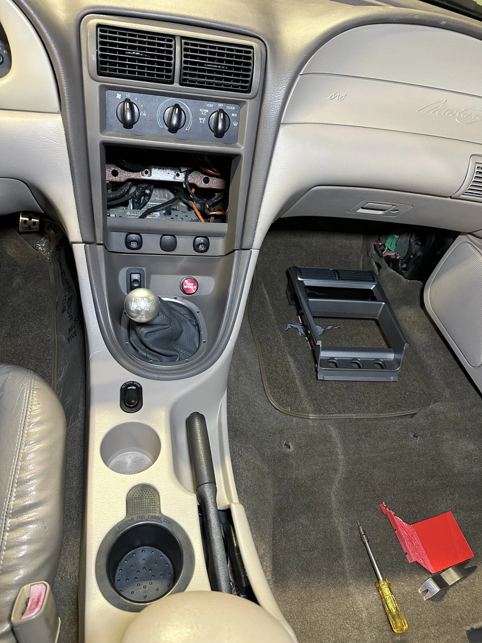

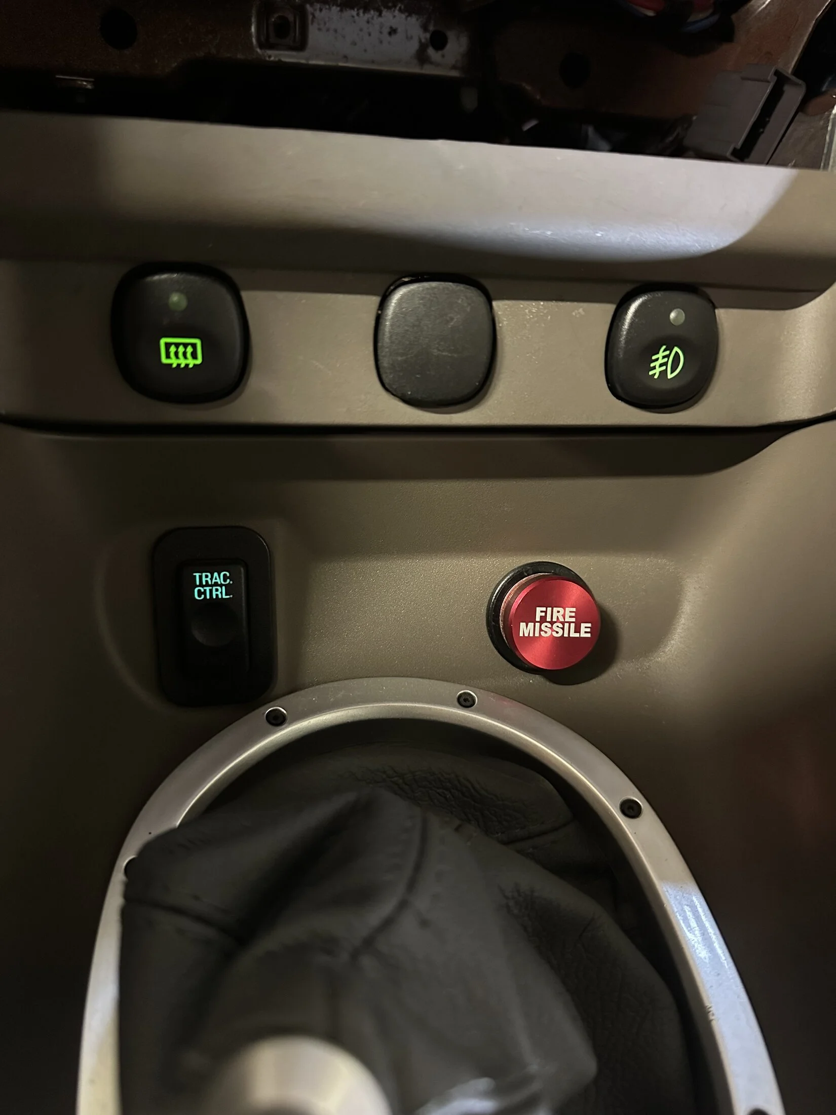

moved rhe defrost button. The 99-00 button has an internal relay, so I had to reuse that portion. I dissected the switch and soldered some wires on and extended them to the new button.
Here’s the write-up I followed
DIY: Converting 94-00 Style Defroster/Fog Switches to 01+ Style
If you have done, or are considering doing a double DIN swap from an 01+ mustang into your 94-00 mustang and want to complete the transformation, you're probably like me and dig the smooth look of the cluster bezel without the eyesore of the rectangular defrost button. Not to mention, having blan...
www.sn95source.com
Used an early SN95 defrost delete plate for now. Clean 01–04 bezels are hard to find
Reactions: 02 281 GT

Console in. Just waiting on my parking brake boot.
I’ll revisit the lighting later. 99-00 use blue lighting for guages, hvac and buttons. While 01+ use green.
Not sure I can move the T/C button over yet. The 99-00 button is a latching switch, while the 01-04 button is a momentary that triggers a module. I may have to get fancy in my wiring to move it.
Or I leave it where is and use the empty spot for something else, like a seat heater on/off
