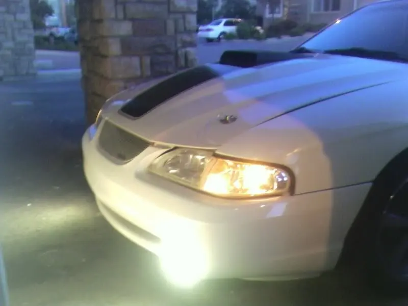

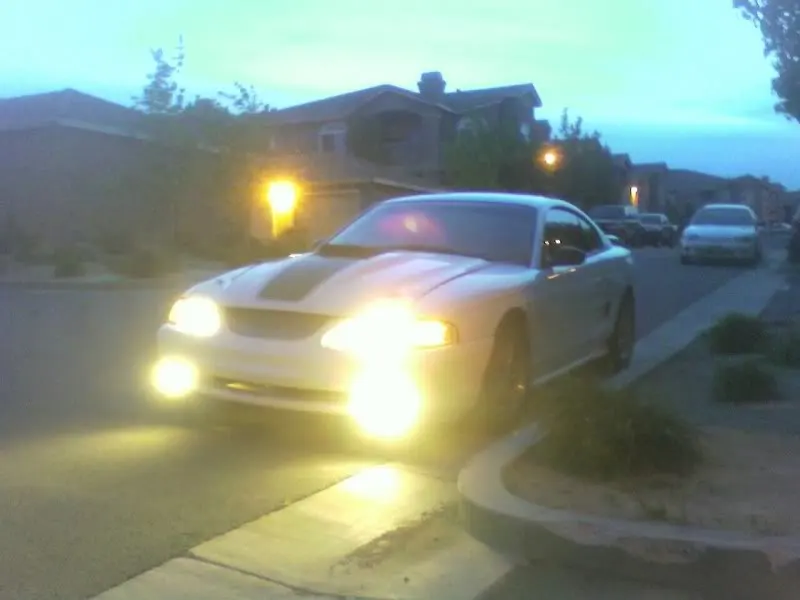

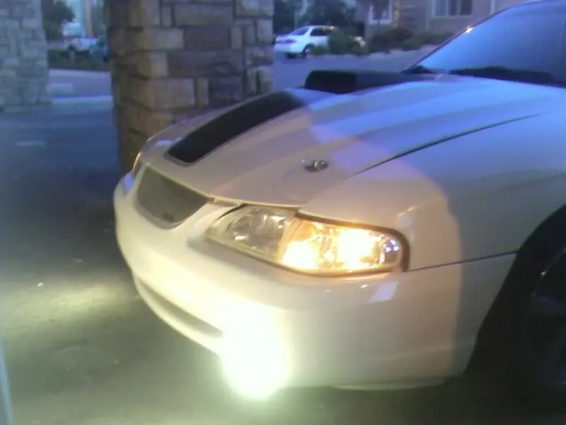

found on sn95 forums.
thats a 94, but it should give you a good enough idea.
