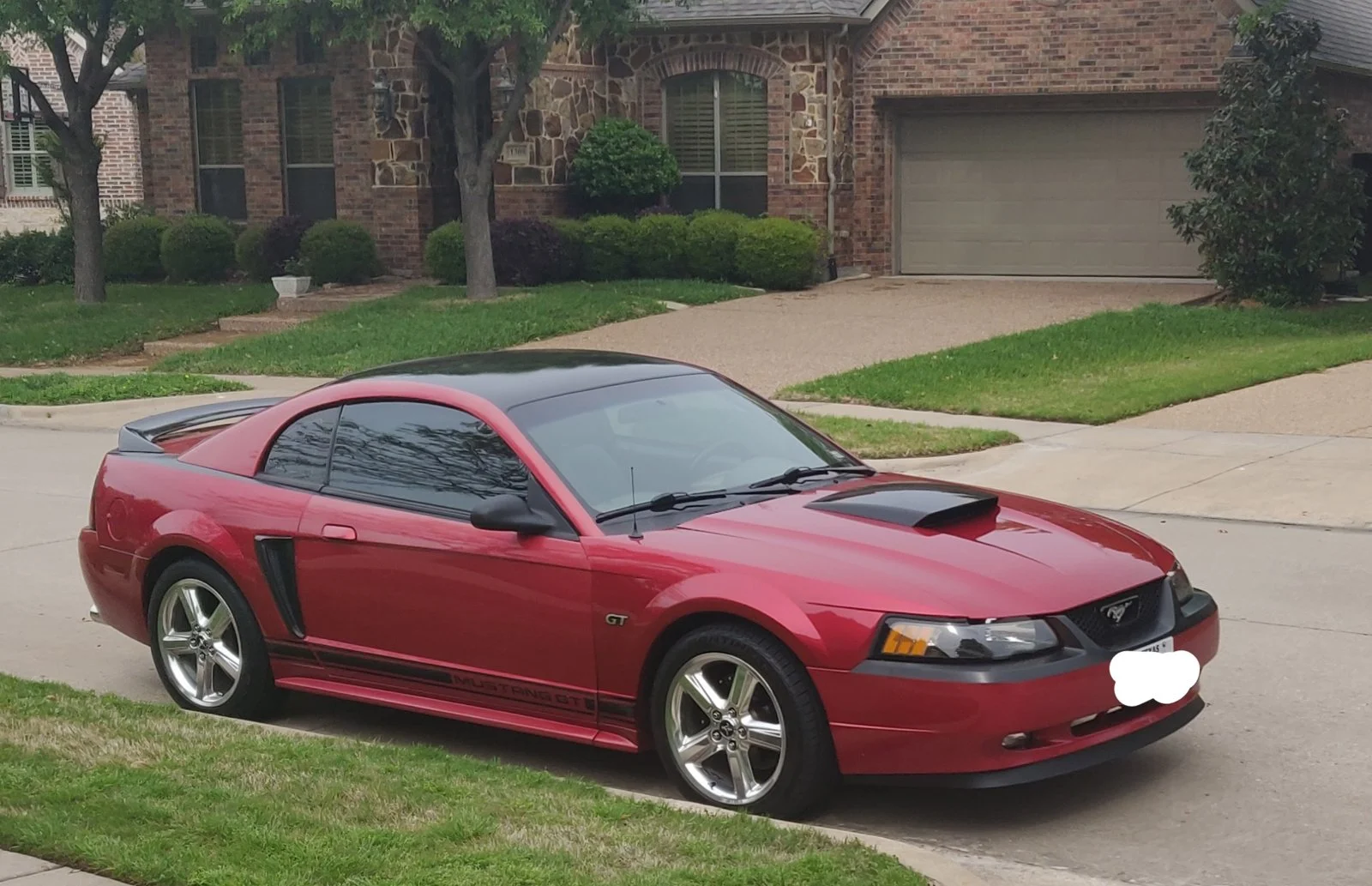

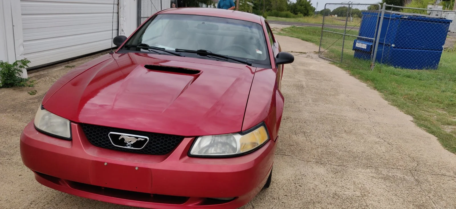

Note: The dealer told me when we bought it that the car has an aftermarket cam, i believe it is a stage 1 cam because car has a very mild lope that resembles that of a stage 1 cam. What scares me the most is the fact that the car came with zero engine mods other than the cam which leads me to believe that the car could have had other stuff on it and it was taken off because, who would put a cam in these cars and not add a CAI or a TB. In addition the car quite possibly could be tuned for parts that are missing on the car. Im not sure if this info could relate to my issues but something seems fishy about this cars history. In addition to even that information the car came with a precise hole cut where the fake intake vent should have gone. Traction control also seems to be disabled in a tune because the button doesn't function ( i replaced it too) and when the car does break lose (hardly does) it doesn't show the green wheel light meaning traction control isn't turning on. Before (when we bought it with the hole in the hood ) and after
