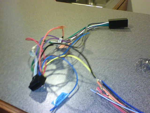

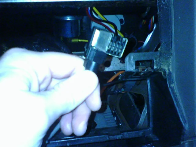

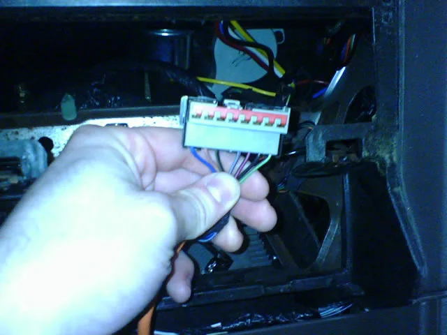

Allllright the radio is in and working, here are some pictures to help out. Below are pictures of the two main connections you will need to hook into. The first picture is the power plug for the headunit and the second contains all your speaker wires. I will have to post a couple pictures each post due to the limit on attachments. Here is a step by step plan on installation of a deck on a 2000 Mustang GT

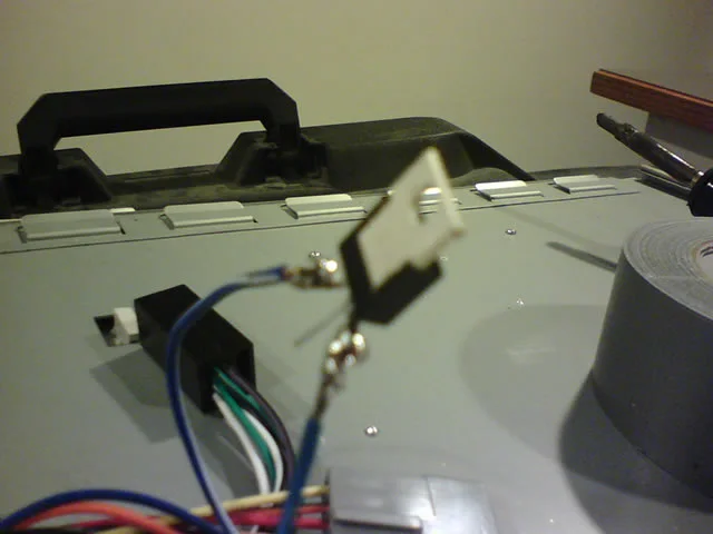

You will also need a 5 Volt Fixed Voltage Regulator (Radio Shack #276-1770) to eliminate amplifier pop when you turn the system on(Thanks Tim over at USAMustangs.com). This will be soldered in between the radio harness and and metra adapter on the amp turn on wire(it says it on the wire which wire this is and I believe it is blue with a white stripe on it). Simply solder the wire from the radio harness on the input prong and the wire from the Metra adapter on the output prong. The regulator will need to be grounded also, I spliced it into the ground on the power harness but I suppose it could be grounded on the frame of the car also, that would be the users call. There are pictures below showing the soldering(I am no expert solderer by any means, as long as it sticks and stays I am happy) This will stop the POP that happens when you turn your vehicle on, I tried it without the regulator and it absolutely is necessary.

Picture on left is power harness and picture on right is 8 pin speaker harness
Picture on Left is harness being wired and picture on right is regulator with input prong soldered( amp turn on wire from radio harness onto the prong shown

I didn't go into much detail about grounding the regulator so here is some better explanation..
There are two ways to ground the regulator from the center pin of the regulator of the hole in the back which can be used to fasten to a ground. I chose to run the ground on the radio harness through this hole, wrap it around the whole and solder the ground back together. This provided a secure connection and also stops me from having to find a screw to ground the regulator to. Check out this post on another forum if you are still confused, gotta register to see the pictures.
http://www.usamustangs.com/forum/showthread.php?t=165

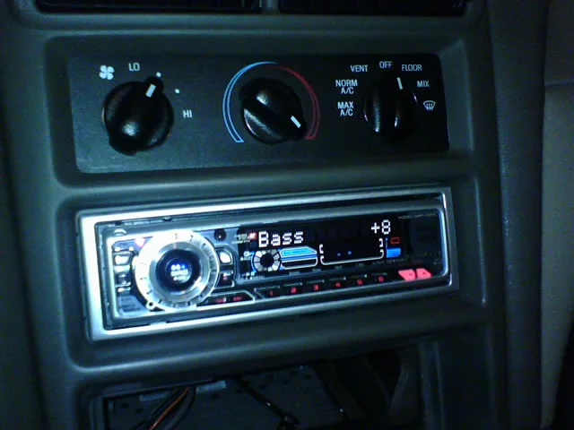

Thanks guys and good luck, this should help all of you 2000 owners stuck with that factory radio. Oh yea it sounds AWESOME with the new radio!
