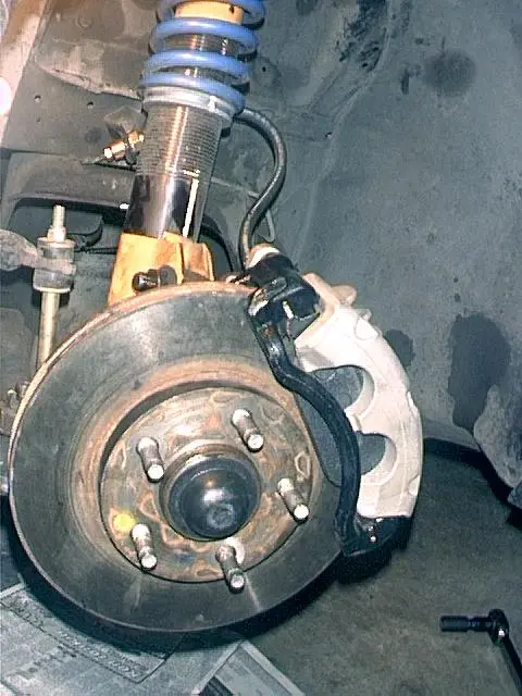

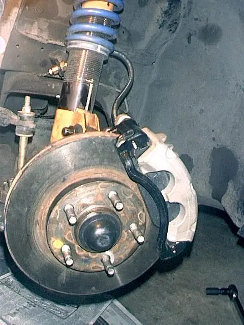

Here is a pic from Matt's website of the stock 99+ brakes. The couple of Roush cars I've seen just had the stock brakes.
