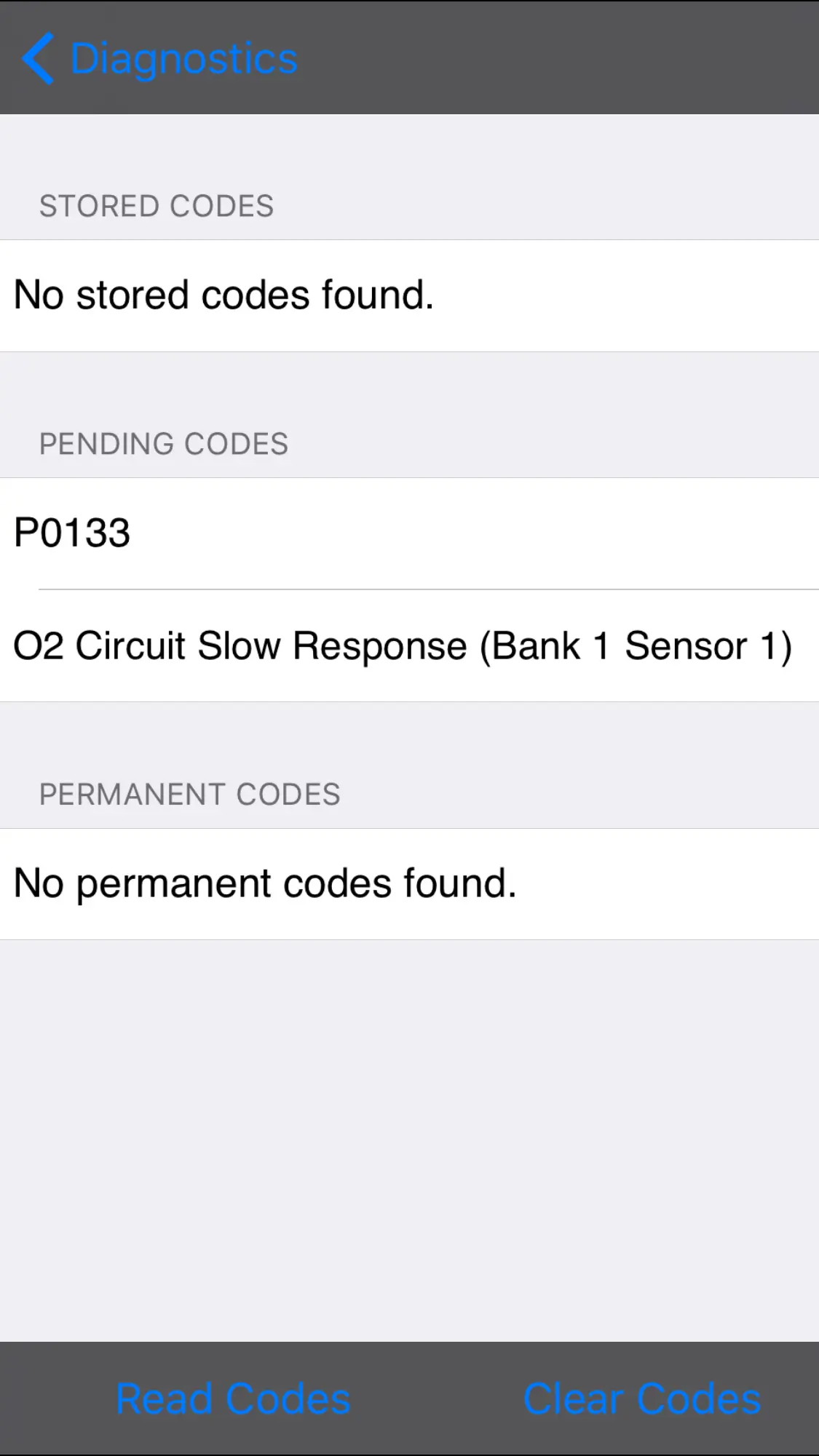

Think I found the issue.
My dashcommand found a pending code. P0133 02 circuit slow response. Never threw a check engine light. This code came on for a minute or two then went away then came back.

So I changed the o2 sensor and so far that seemed to fix most of the rough idle. The only rough idle I'm experiencing now is starting it up after it's already warm. And its only rough while I sit in the initial idle. Once I start going it's fine. And even that seems to be improved/not as rough.

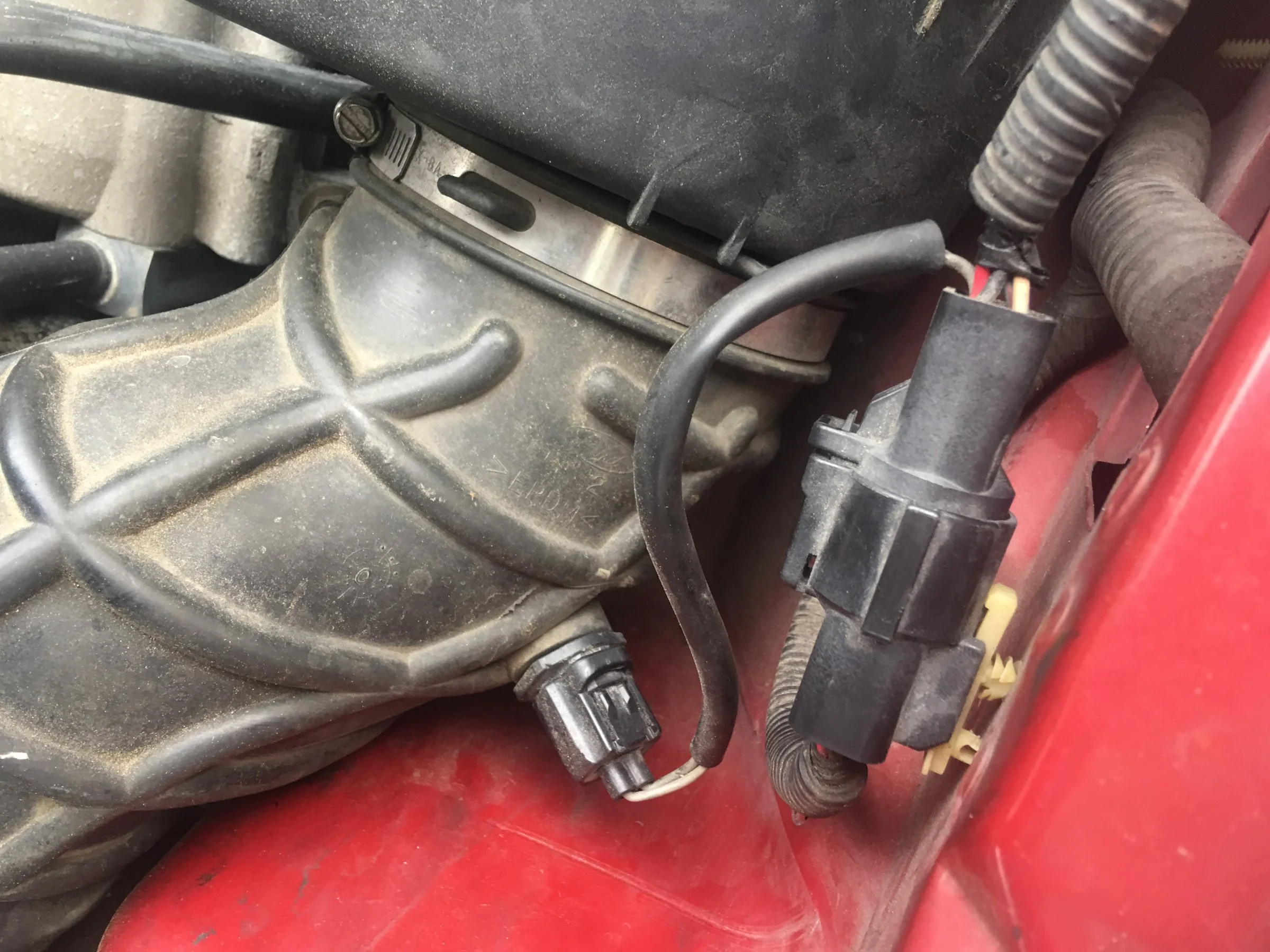

Having a rough cold start now. Cranks a few times and then turns over. Fuel pressure is good. Unplugged this harness and it started up great. Maybe my MAF?
