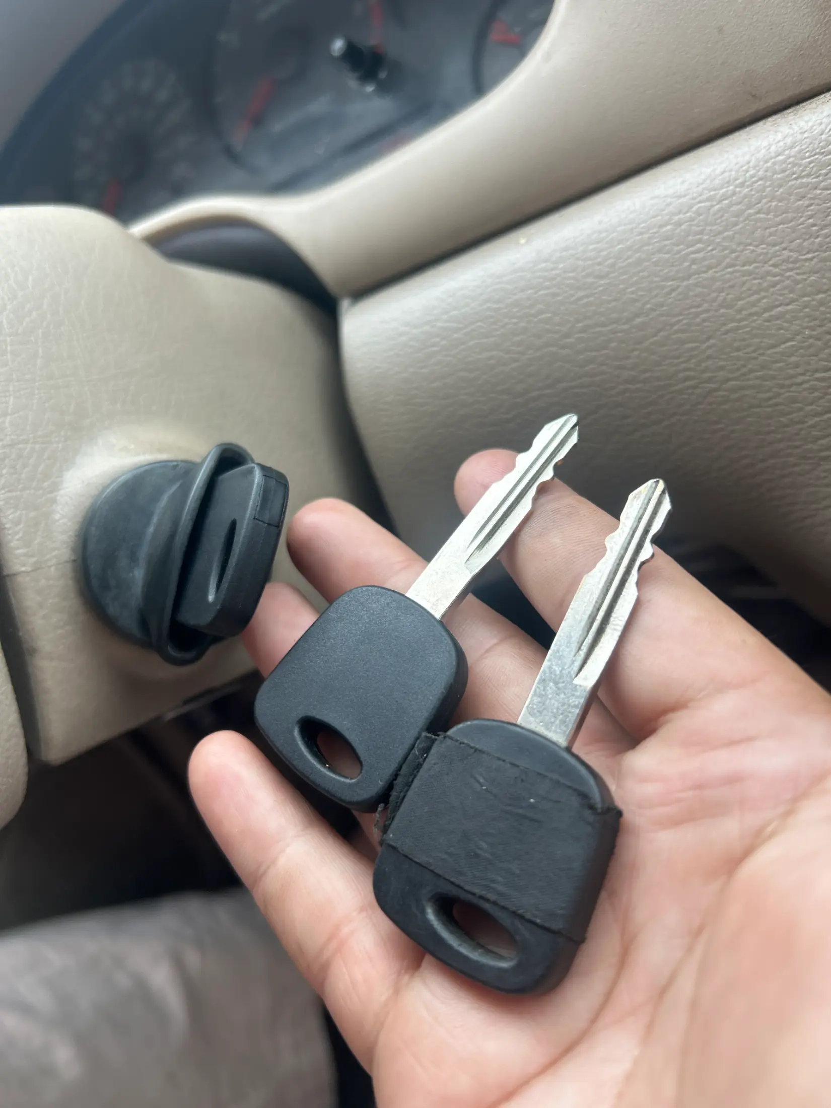

Amazon keys sometimes don't program right. Hit or miss on quality of the key. If you start the PATS key programming process, you need to program at least two keys for it to complete. If one Amazon key is junk, and you program only 1 other key, the process gets stuck and you won't be able to program any keys until you get get a 2nd key.
Strattec makes the official licensed keys for Ford. Part number 597602 and roughly $20 or so per key.
The receiver module under the ignition tumbler can sometimes take a dump as well on these cars. Unfortunately harder to find that part. Try the keys and see if a different key is read better by the receiver unit.

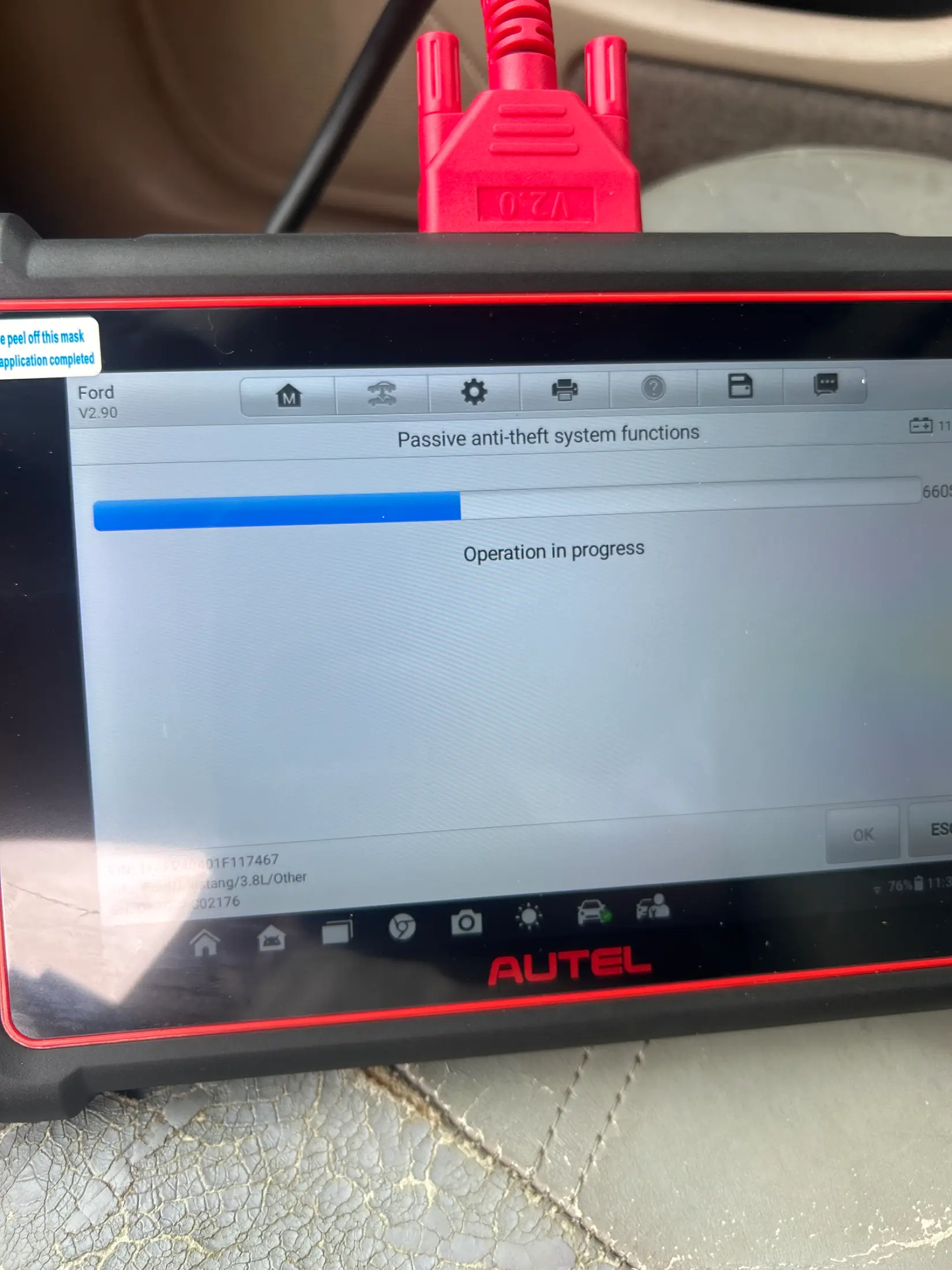

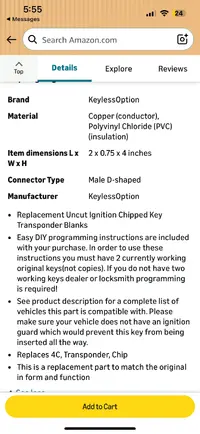

Vehicle was working smoothly with one key for the past couple days. After gaining security access and trying to program the keys it turned on hard stuck for all keys. I tried doing as much research as possible and from what I’ve seen I have to reset parameters before programming all keys new… it seems now my info for my main key ( taped one ) is no longer reading since my key was forgotten. So now I’m in a loop trying different methods of programming the key. If I can get the main one to work that would be beautiful since it is original. However I have three keys I want to program.

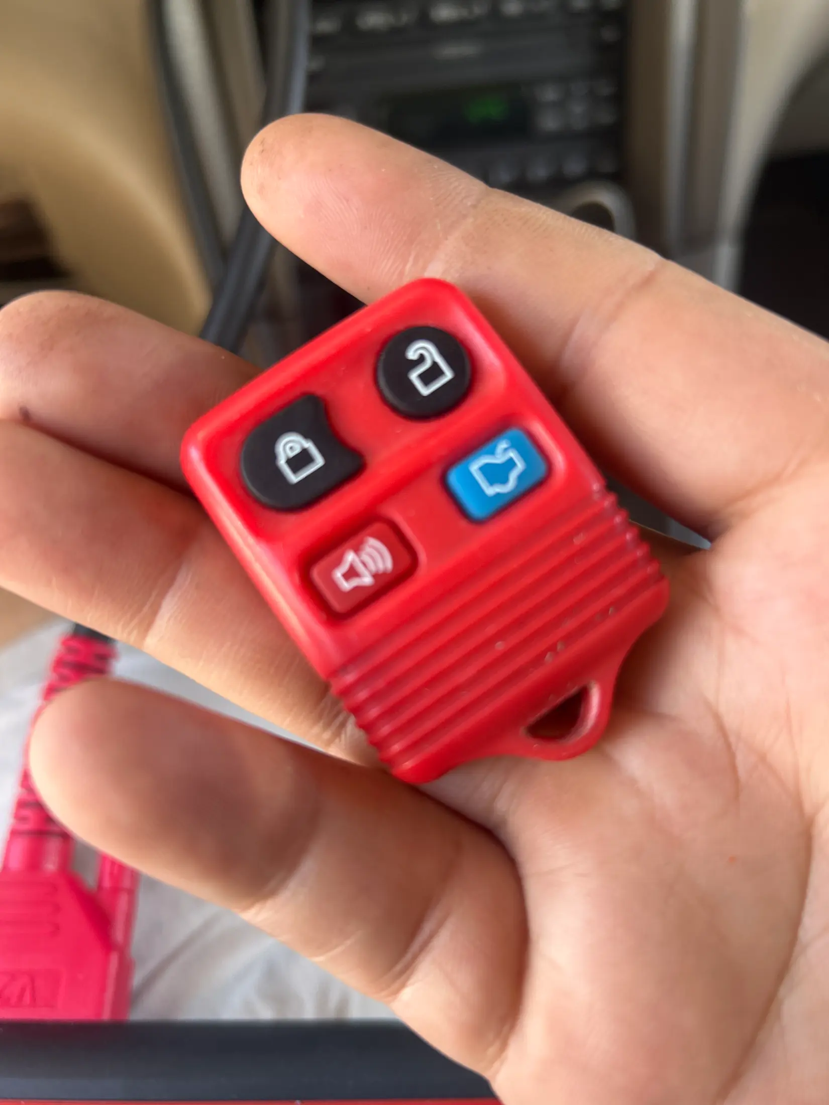

I’m going to try one Amazon and one original. Complete the process. Then attempt to program the third. I also have fobs I want to program.. but they are from Amazon as well. So if this doesn’t work out right I’ll try that link out. Thankfully the place I work at cuts my keys for free so I don’t have to deal with the scamming lock smiths or dealing with Home Depot/ace telling me no for liability reasons.

That's the problem I've had with aftermarket keys. If one isn't able to connect to the receiver, you won't be able to program any of the keys successful and the vehicle won't start. Granted, it could be an issue on the receiving end, or even an issue elsewhere. But PATS programming only completes properly if two keys program. If only one programs you won't have any functional keys. So that could be what is happening here.

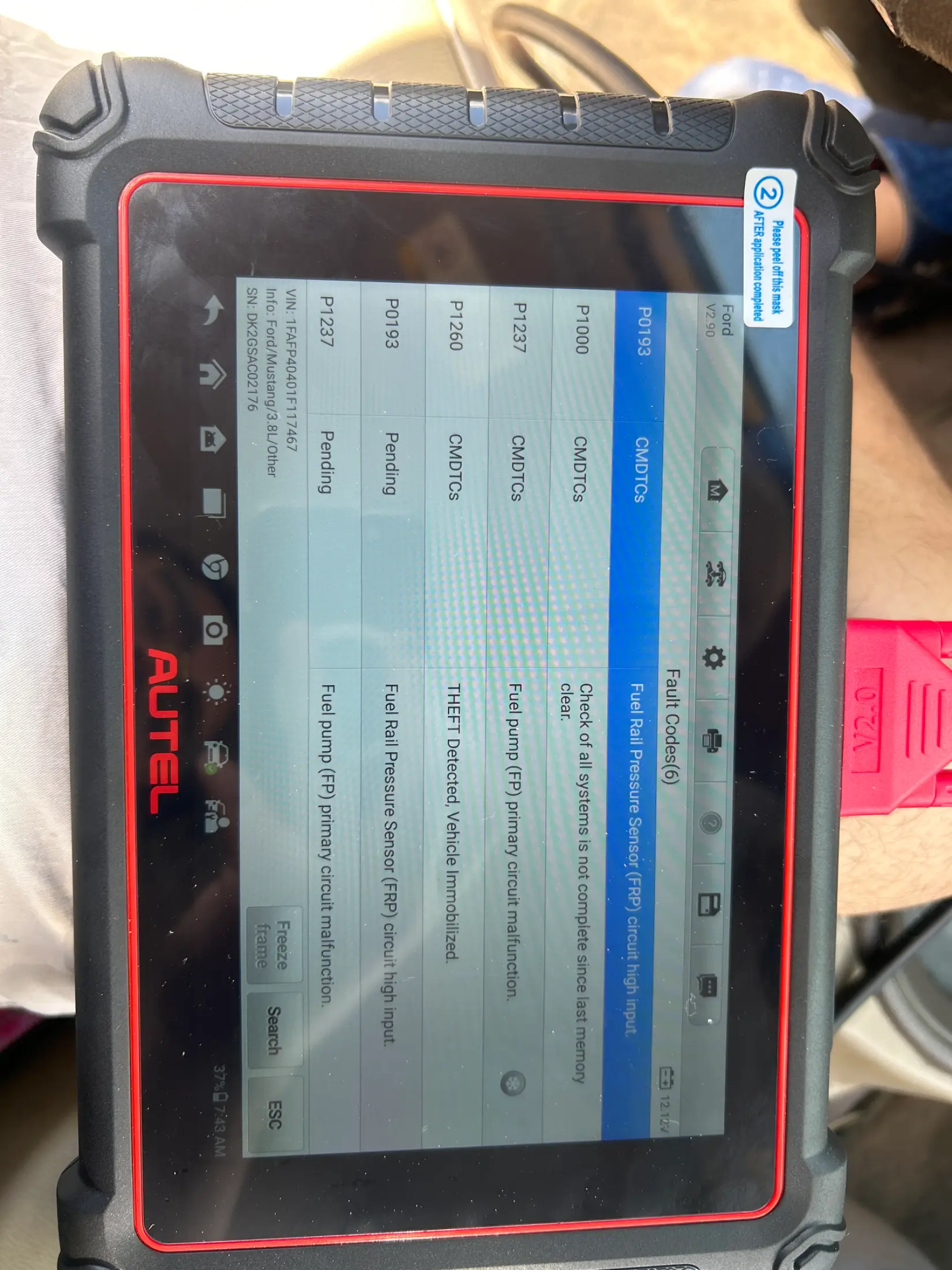

Can you scan the module dtcs? The IC module might show some DTC's that might be a clue here. If there are communication issues with the cluster, those usually show as module DTC's. These cars were the first Mustangs to have some modules, mostly the ABS system and the instrument cluster. Sometimes PATSs issues do show up as DTC's there and that can give a clue.

When I get off work today I’ll give it a scan to see if I’m having any trouble codes that are new. You’re saying the autel should be able to program it no problem then, the issue lies within the key itself. I’m going to give it a shot getting a better quality. I mean truthfully it looks the same on the outside. I can’t tell the difference.

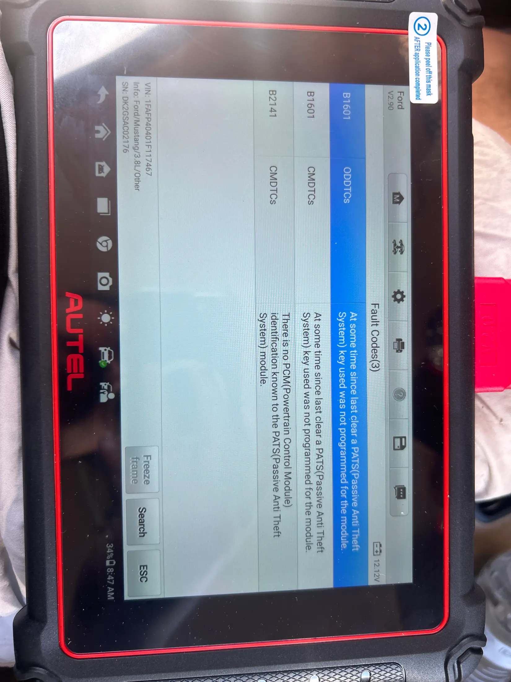

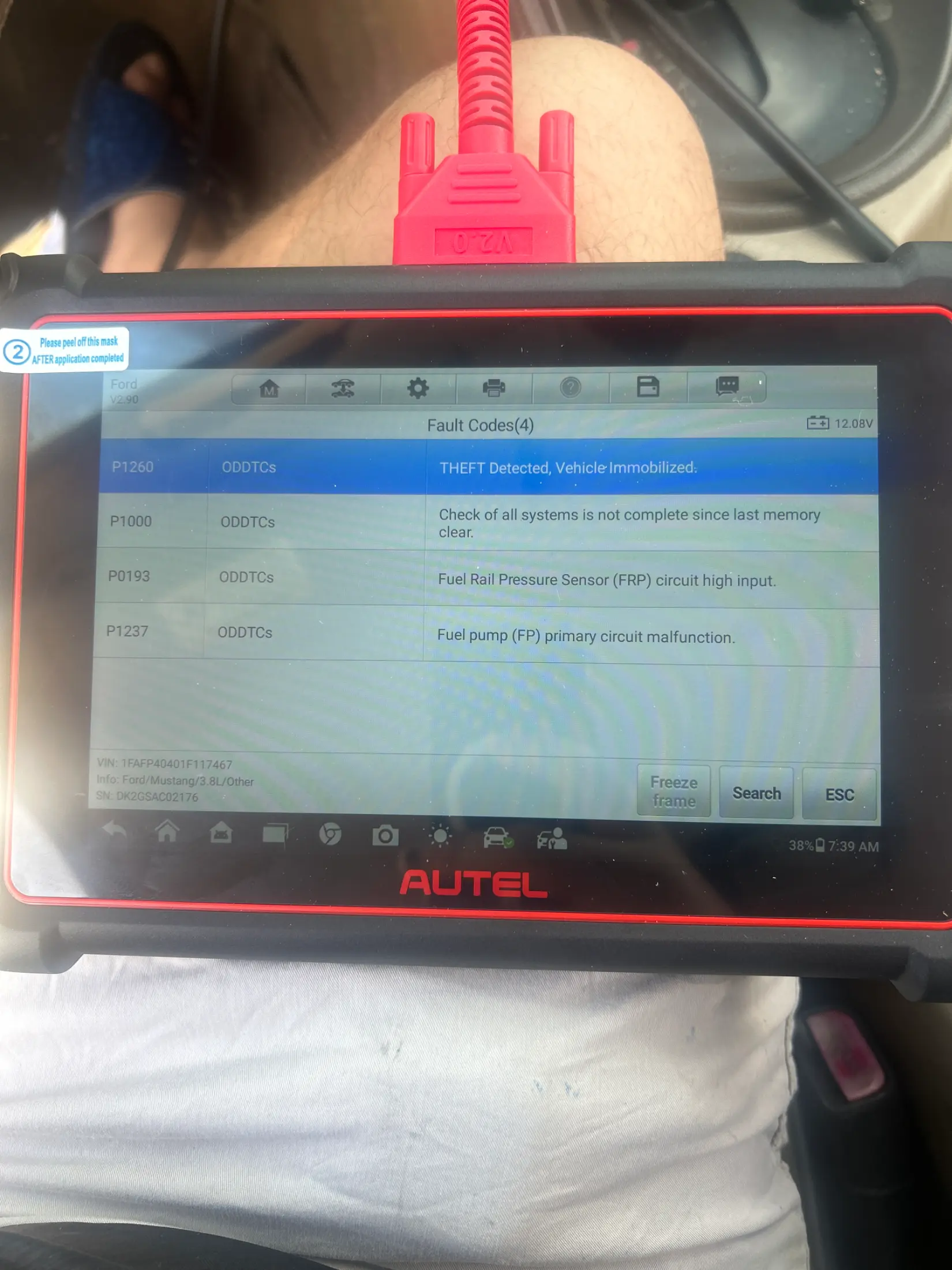

The only reason I can think of vehicle immobilized at the moment is because battery level is too low but I’m currently charging the battery, because I have other codes for voltage too low. I’ll charge it up clear dtc scan again and see what happens
I want to say I’ve seen that last code when the cluster is not initialized to the ECM. Not 100% sure as I didn’t log the code. That’s when I would do the cluster initialization in ForScan prior to programming the keys.
One of the other codes suggests the pats key isn’t programmed. That would trigger theft mode.
The vehicle is cranking and no start right? Is there any menu option to initialize the insteuctment cluster module? Essentially you are programming the cluster to the ecm.
This one is puzzling. I don’t fully understand what is going on here.

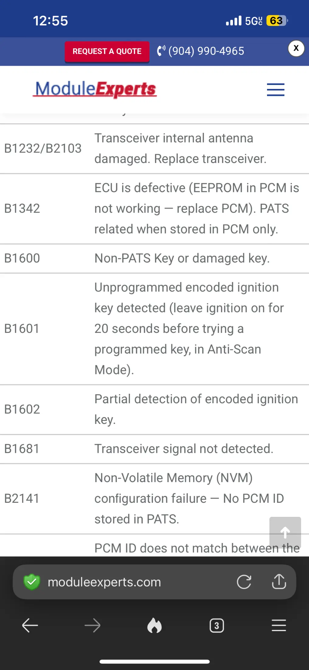

The pats module isn’t initialized with the pcm. Because the handshake isn’t present I’m assuming that’s where communication is lost. Apparently my no directional scanner does not have a relearning possibility. Forscan would be needed here to relearn the, pats to the pcm. This is correct I order some new legs from stratec as well as an OND link/adapter for for scan I’ve never downloaded it on computer before so I’ll see how it goes
02 V6 3.8l has stand alone pats so it’s type A securilock if I’m correct meaning it’s outside the instrument cluster. This seems like the simplest one I believe to have as if needed there is a transceiver amplifier if only one key is left.
