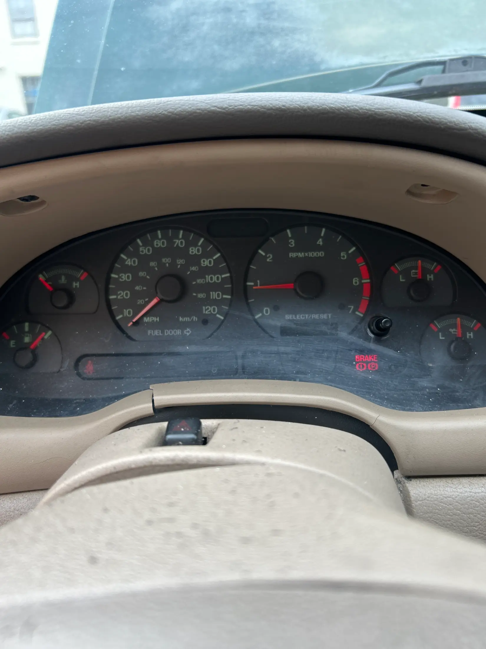

Hello, I recently bought a 2002 V6 3.8L, when I first bought the car there were major Electrical issues. my instrument cluster mileage would not show and sometimes it does. My daylight headlights are not working and high beam only the passenger side is operating. My internal room lamp driver side does not work as well. Engine and Transmission running like a charm.
Until recently the car took me to point A and B and it started having the theft light flashing issue. I have no spare key I was blessed with one key upon purchase. If I left my key in the ignition on ON for 10 minutes it would usually fix my problem sometimes it works sometimes it doesn’t. I checked all my fuses and everything had power, my battery was good and I have new terminals as well. My CHTS was not reading the sensor so I also had to create a second harness specifically for a bypass switch on my radiator fan. Ccrm is working. My only Fault Code is PCM high circuit. I’m not a master electrician and I don’t have many years of experience doing this. I do have a very good grasp on general understanding. Could a bypass made of house wire mess with the transceiver reading?

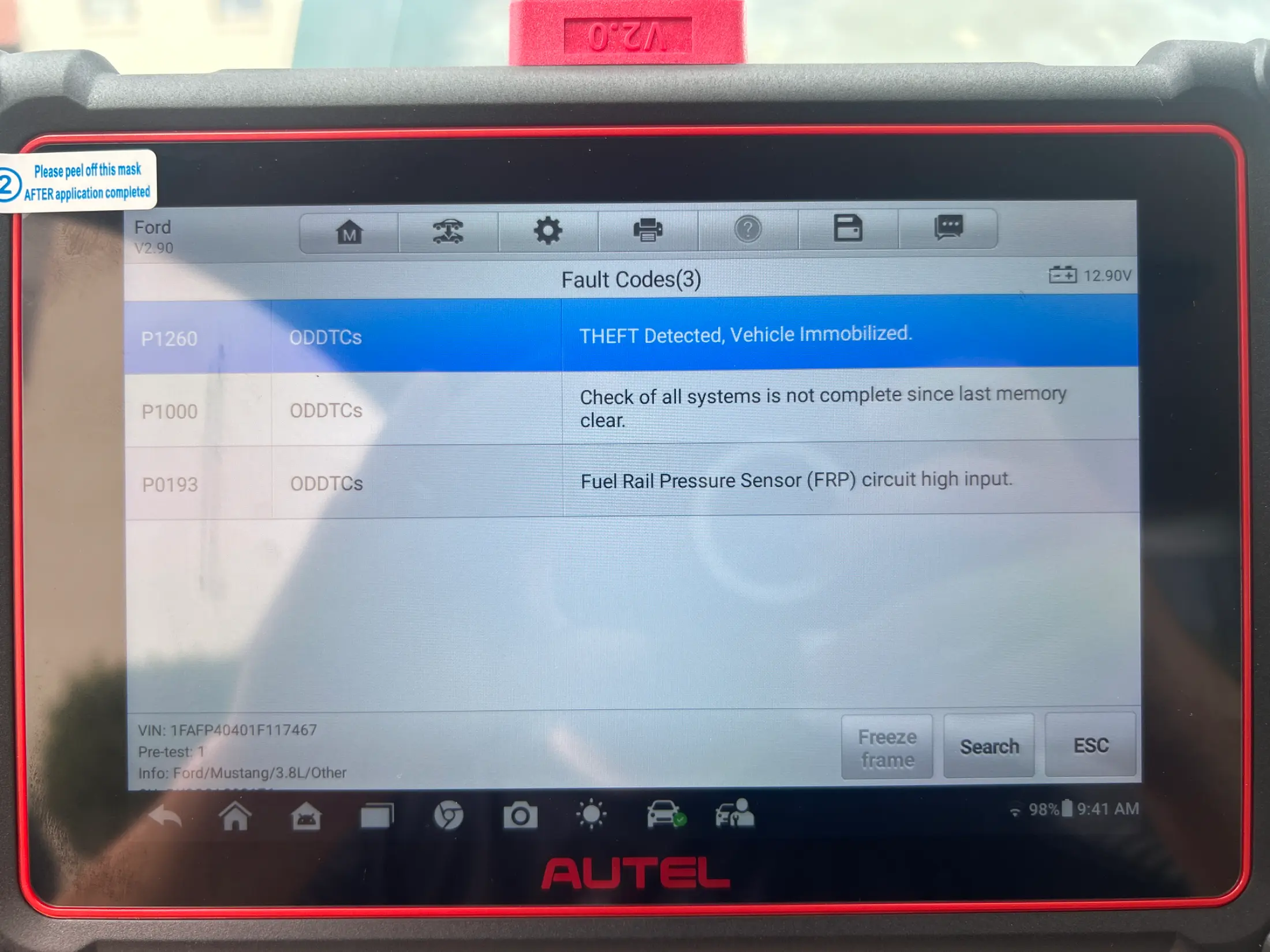

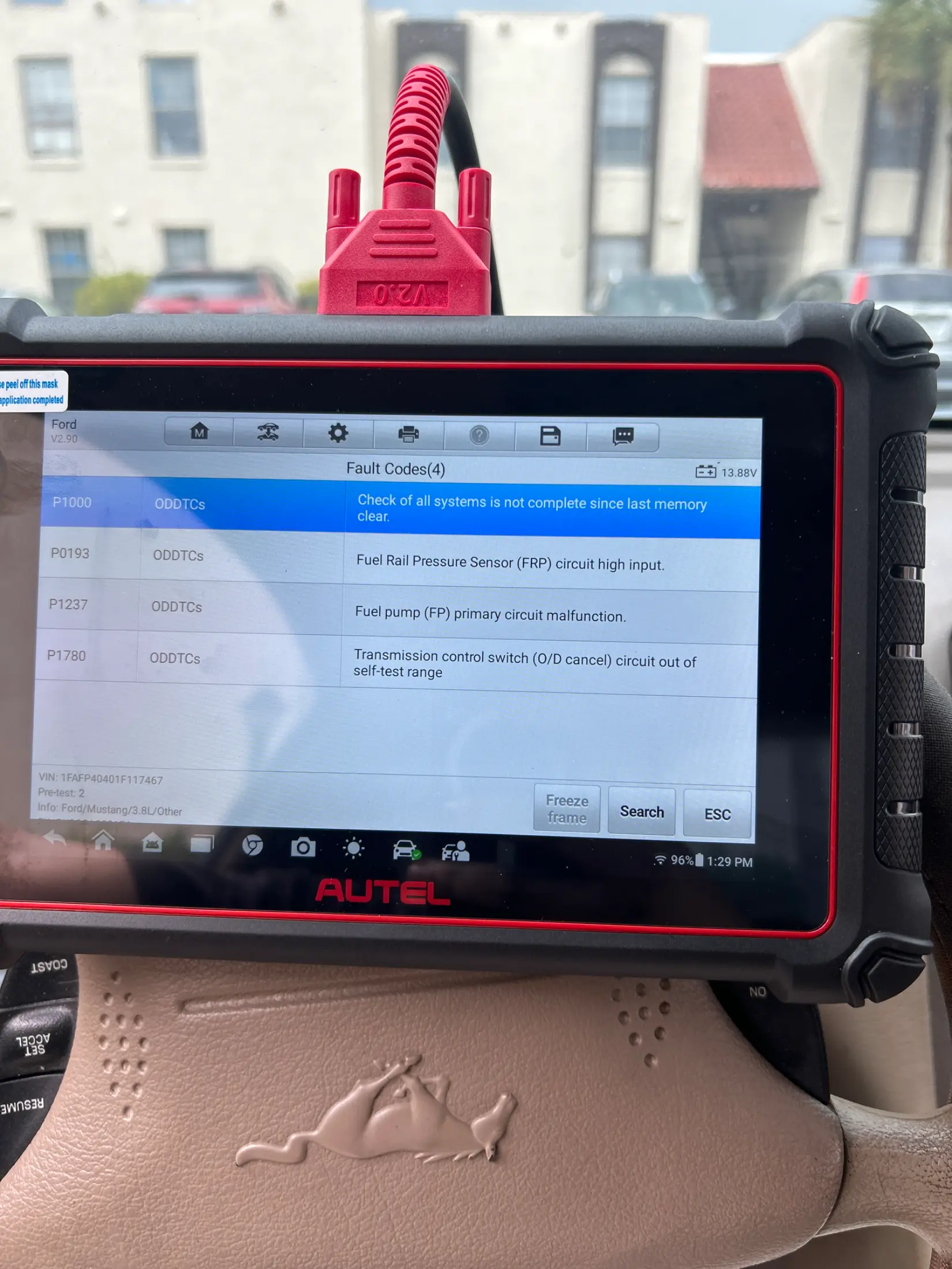

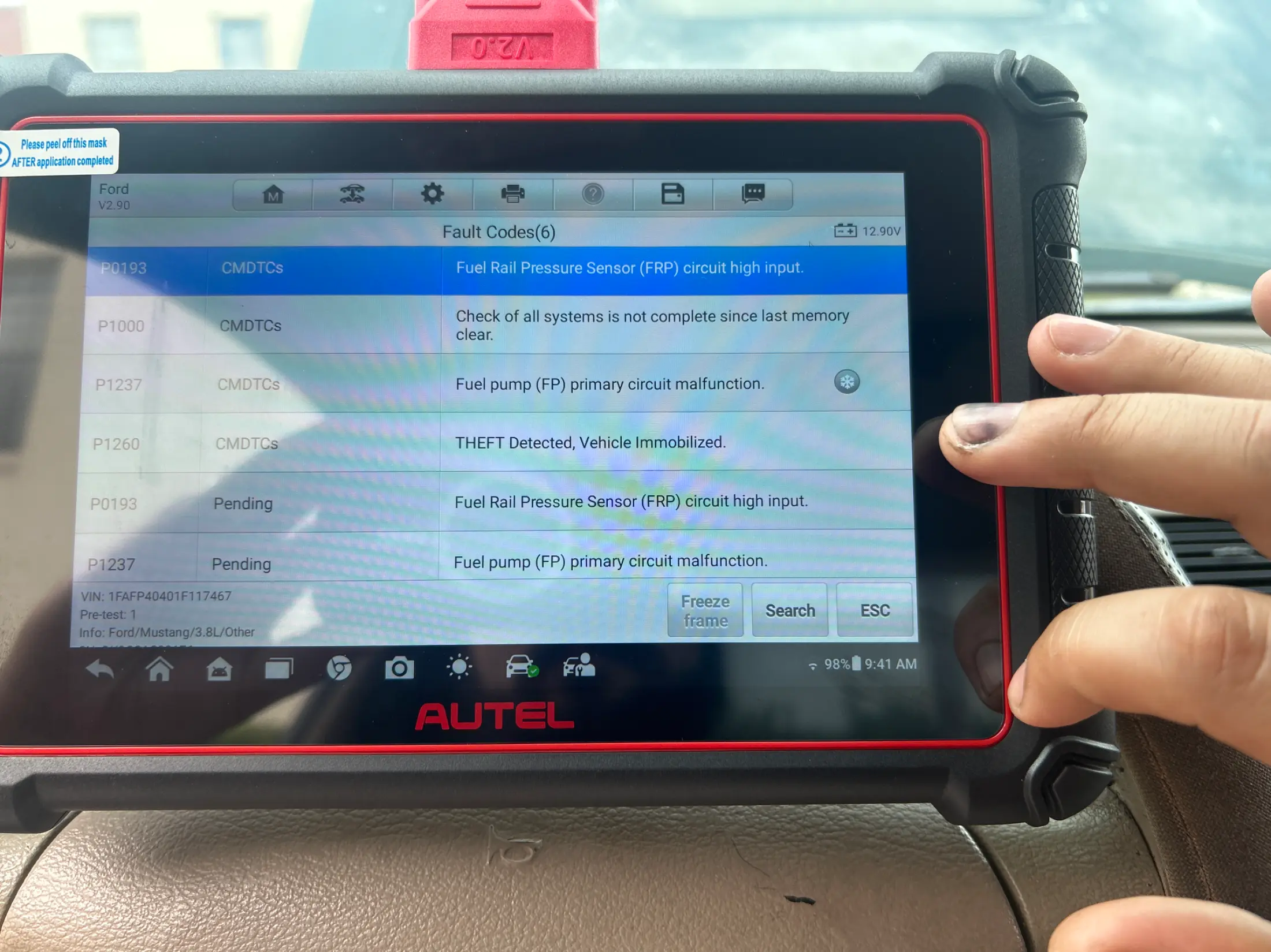

Thank you I’m going to check those out this week, when I have time to work more on my car. I’m going to share some of the trouble codes my scanner is showing me now.

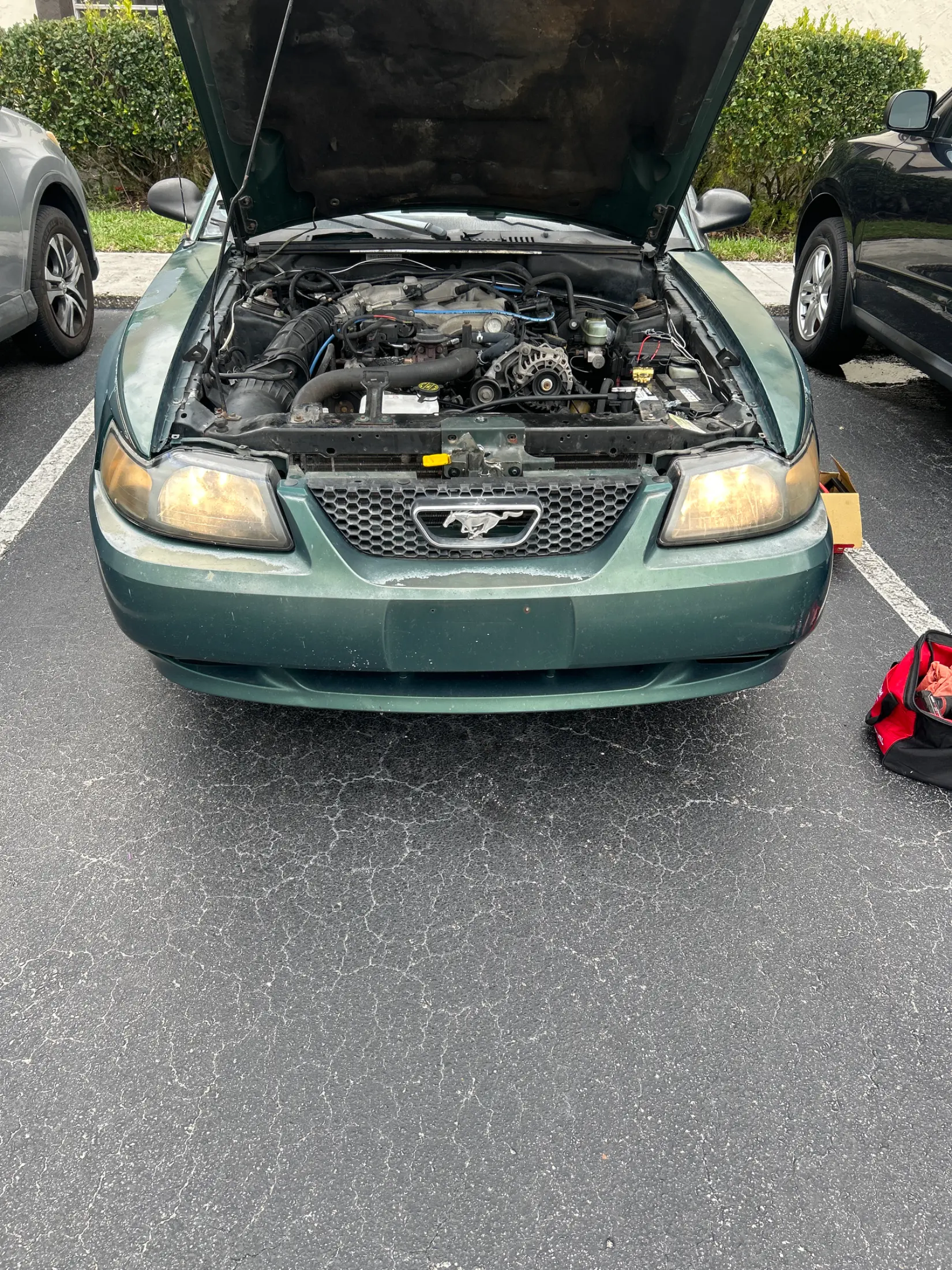

Yeah, the vehicle was a barn find, pulled it off a ranch, I can’t find many like these in my area that can even run. I have the V6 model for my kids. I have my other one all fixed up already over there, no nightmare at all, just a basic tune up and fluid/ filter flushes and runs like a charm. Just dealing with this electrical nightmare in this boy

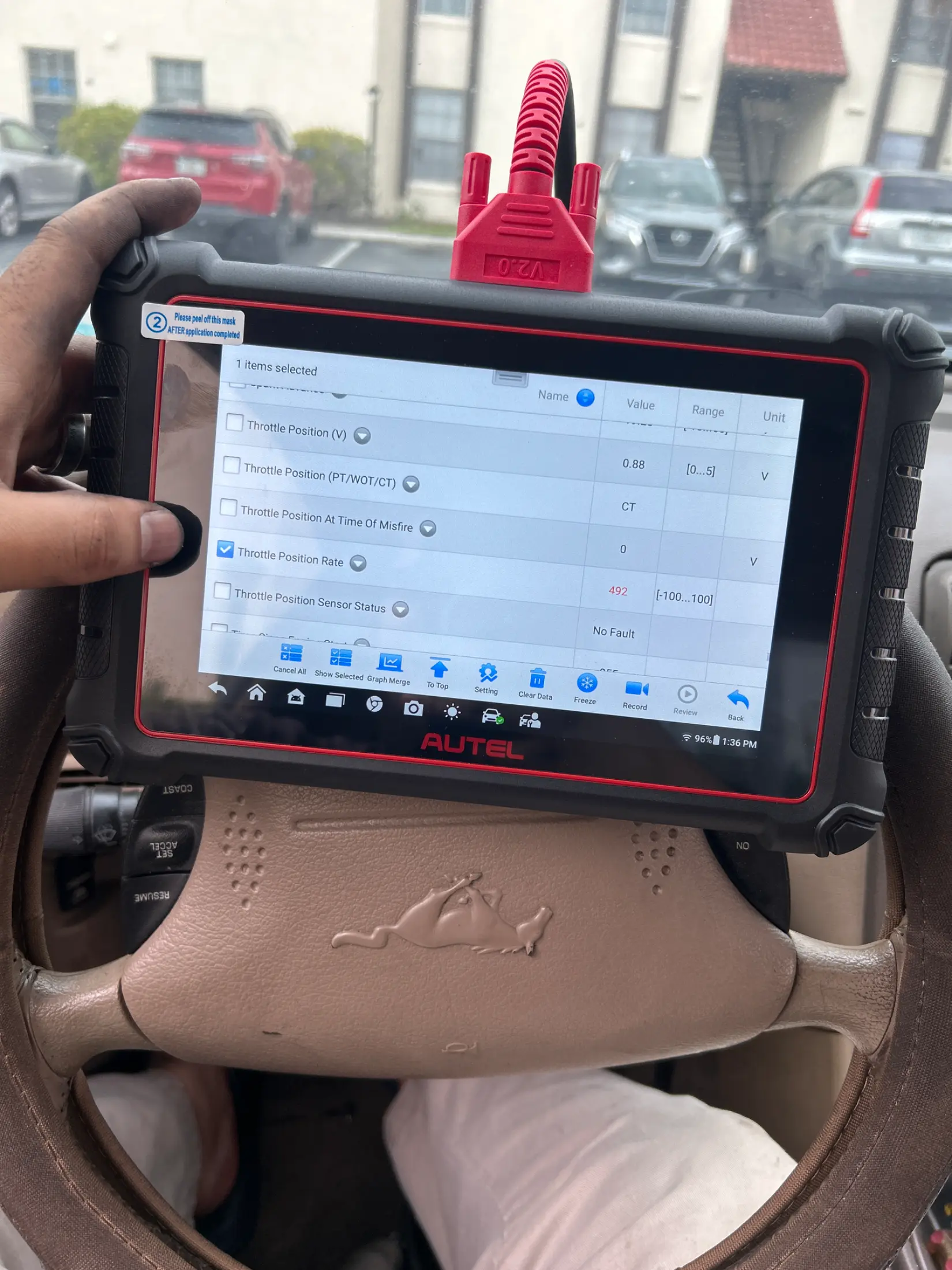

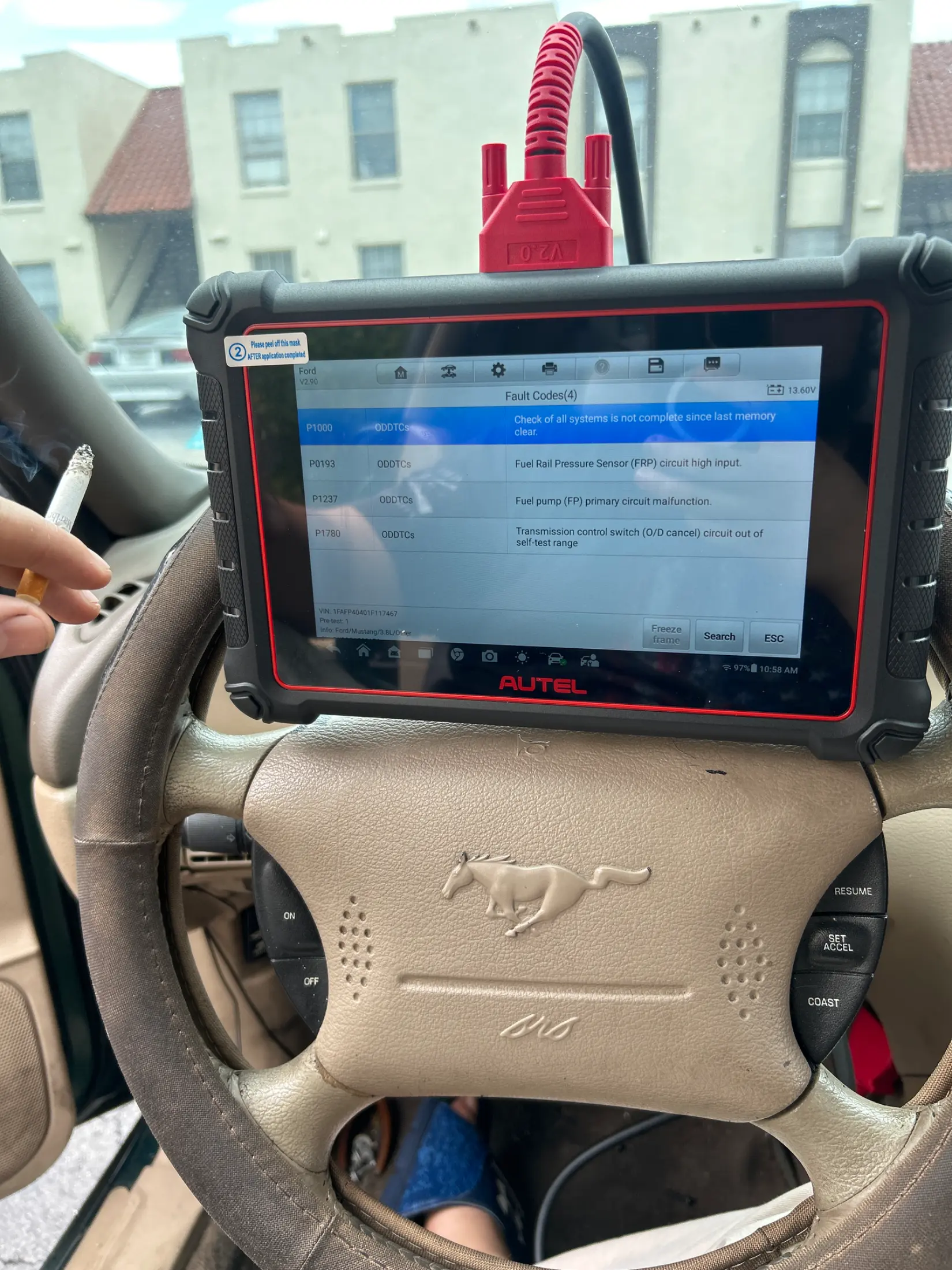

So here are some values that are abnormal maybe that can help scope down where this is all stemming from.
Throttle position rate: 492 [-100…100]
Fuel Pump monitor: 275/300 [0…120]
PCM live Data^
Alarm Event 1-8: Panic
GEM^
Everything else looks normal. Within range or OK.

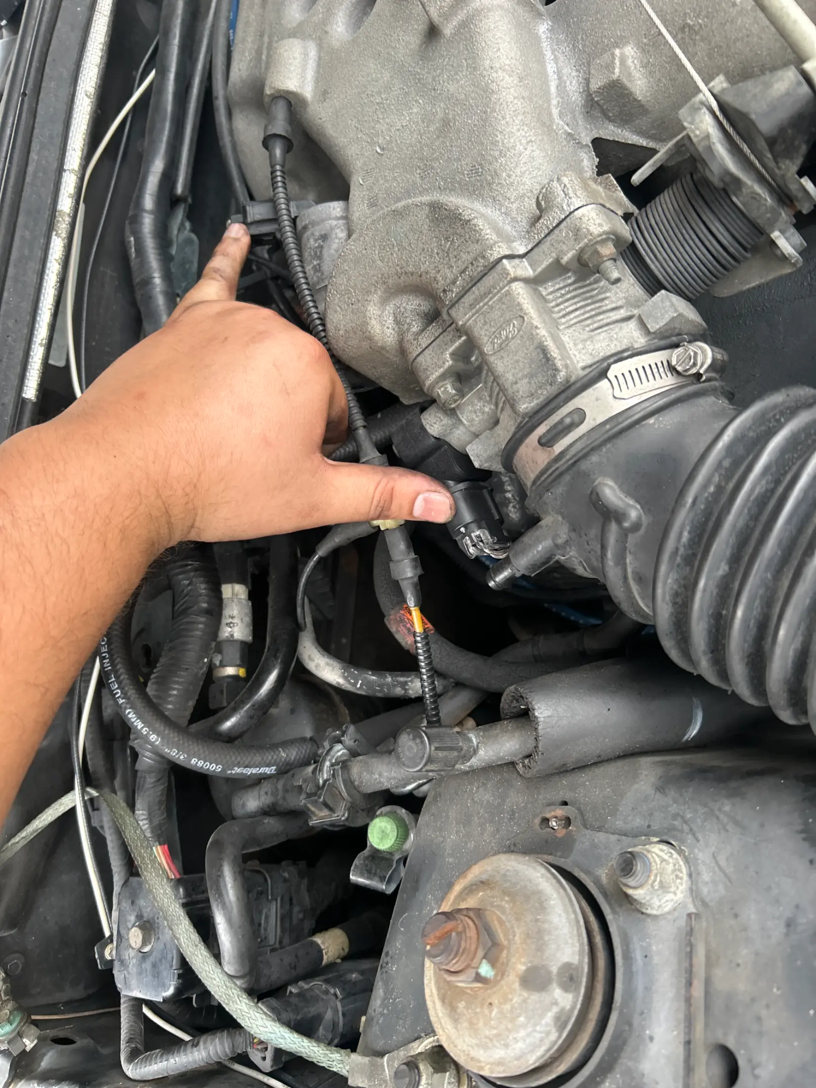

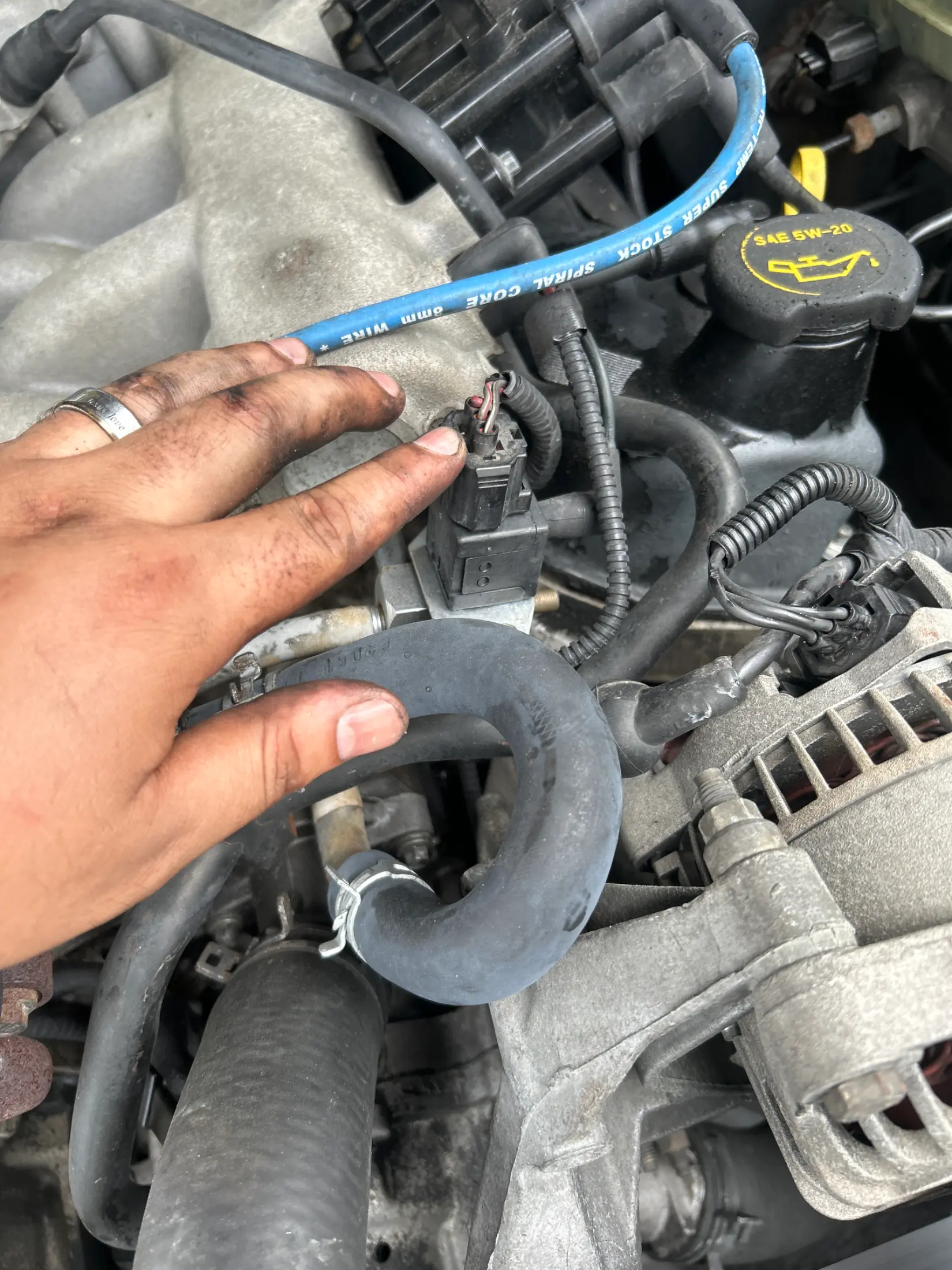

Update I’m going through every sensor and pigtail cleaning and applying dielectric grease and found this. Car runs without it. But I’m sure it’s needed.

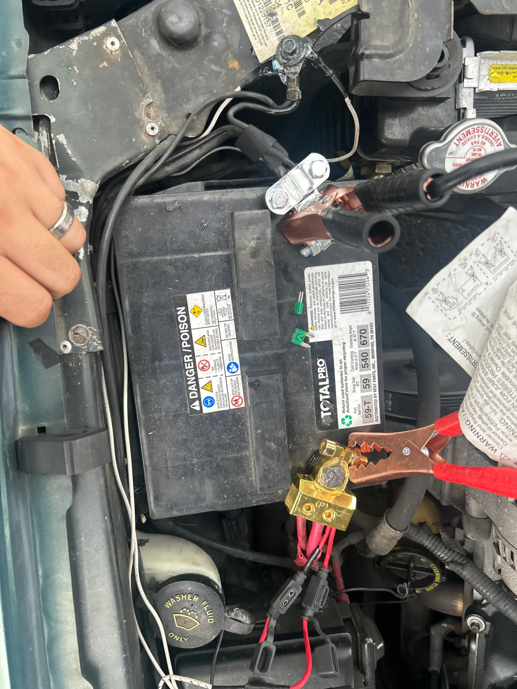

Quick update I removed every single sensor and connection in the engine bay secured all ground terminals and hand tighten using grease everywhere. All trouble codes cleared up. And vehicle looks like it’s running good with the bypass on as well. Vehicle is starting up no problems at this time. Key is stand alone no rings. I have to add new keys to program since I already ordered the spare.
Headlights are still not working and everything is secured and tight. Everything has power bulb is functioning and pig tail is reading dead. I trace it back to the fuse box but fuse has power, so maybe bad wires going to the bulb from the junction box??
