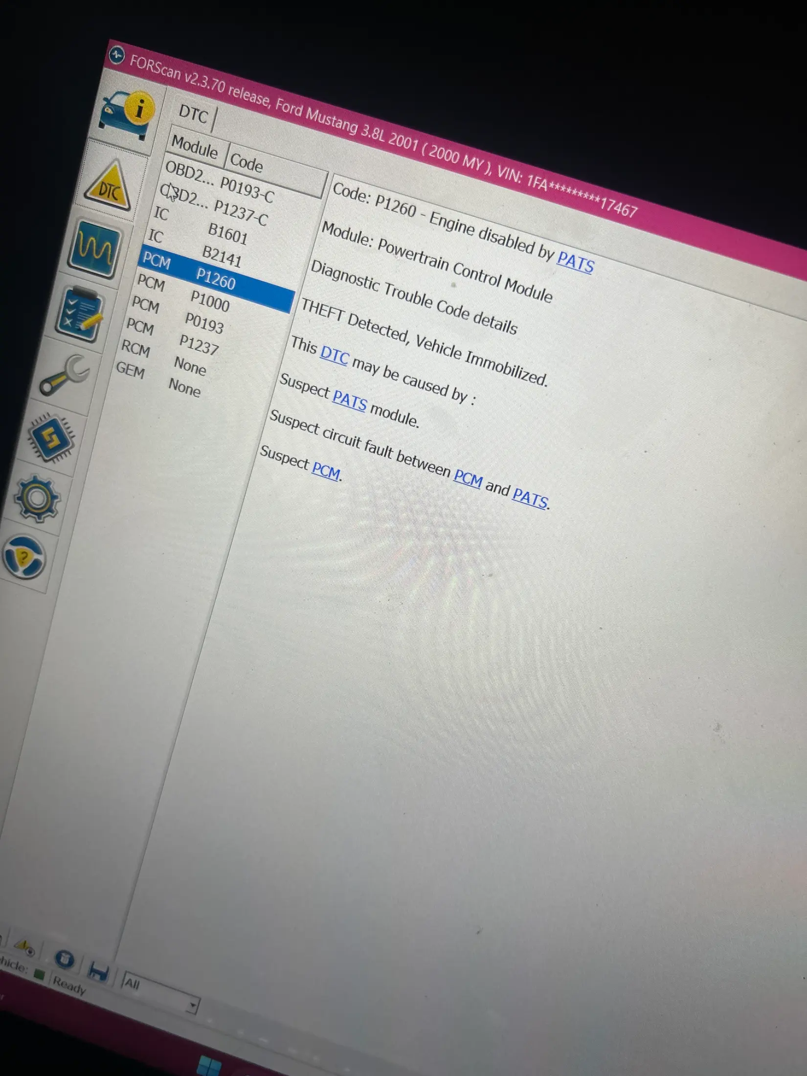

The pats module isn’t initialized with the pcm. Because the handshake isn’t present I’m assuming that’s where communication is lost. Apparently my no directional scanner does not have a relearning possibility. Forscan would be needed here to relearn the, pats to the pcm. This is correct I order some new legs from stratec as well as an OND link/adapter for for scan I’ve never downloaded it on computer before so I’ll see how it goes

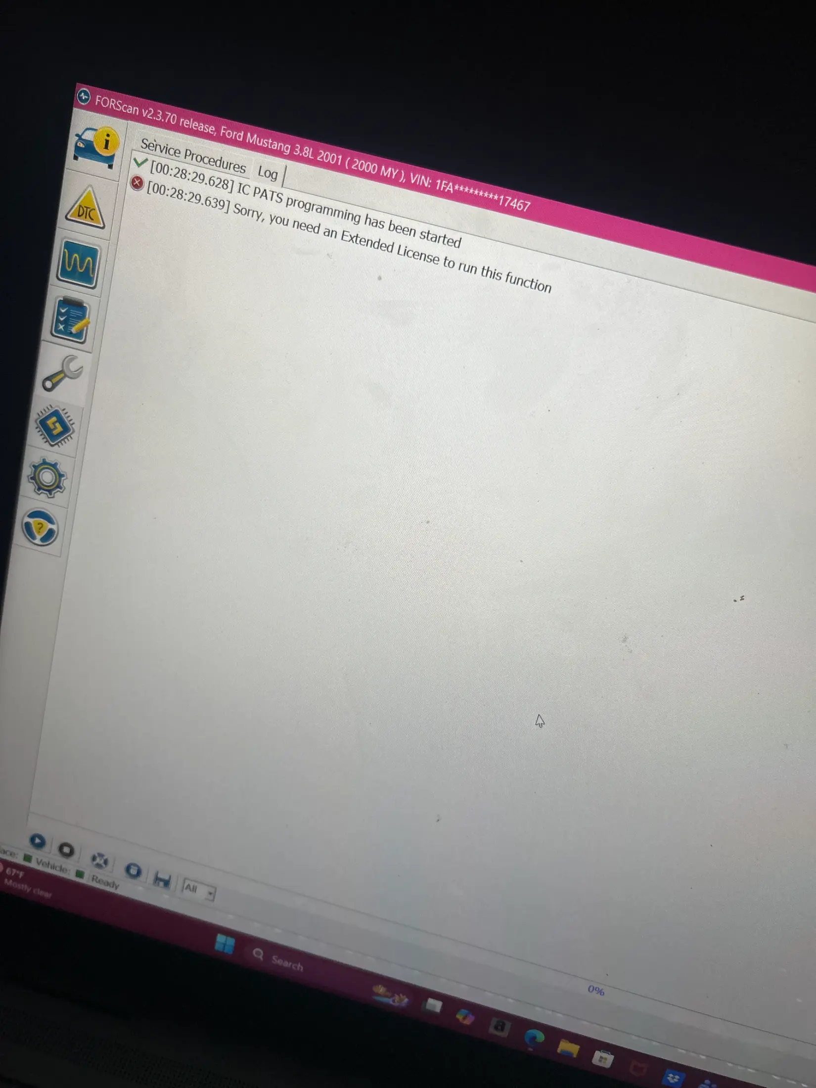

That's the way I've done it through ForScan. It's pretty straightforward in terms of downloading, and getting the free extended license. The initialization option will be in a drop-down menu once you start the PATS key program process.

At 6:30, there is a menu. One selection is “module initialization” and that’s what you’d do to pair the cluster with the ECU.

ForScan in general is easy to use. The pats programming is under service functions, but you can also scan the module DTCs first under the DTCs tab.
There are a lot of YouTube videos on general setup, getting the extended license (there’s a free one) and how to navigate. These mustangs are rather primitive so you can’t change vehicle programming like in later fords.

Thank you brother after quite the journey, my car is running again and I have everything working good key related, at least I can chalk this up as a win, knowing I learned so much more about ford programming because of both of your guys help. I’m sure I will need more help in the future on my voltage spike from my tps and fuel pump. But hey at least I can get to work and back in this bad boy. Until I buy another mustang for my third son, I’m sure I’ll be back for your guidance! God bless whoever made this website.
