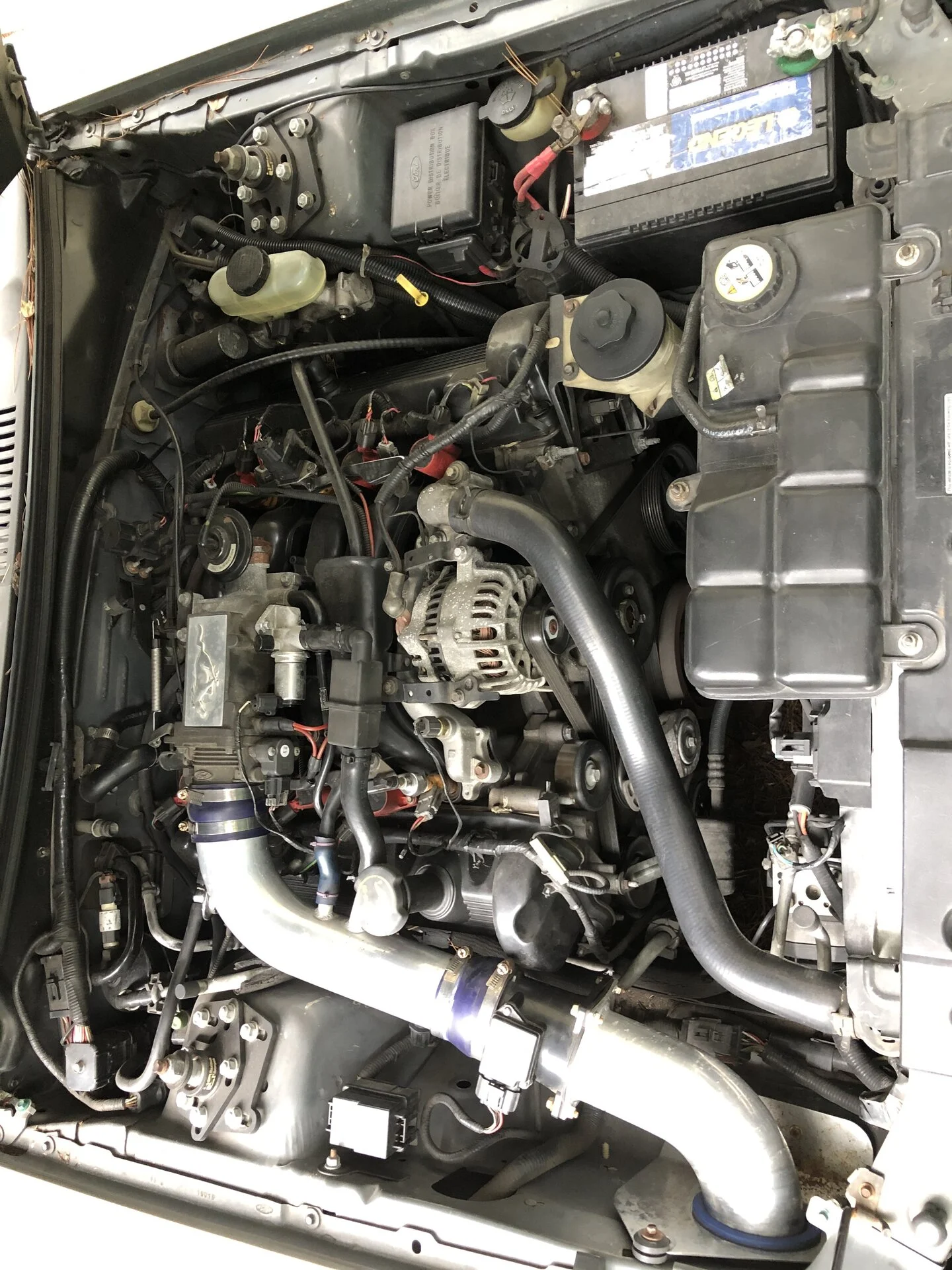

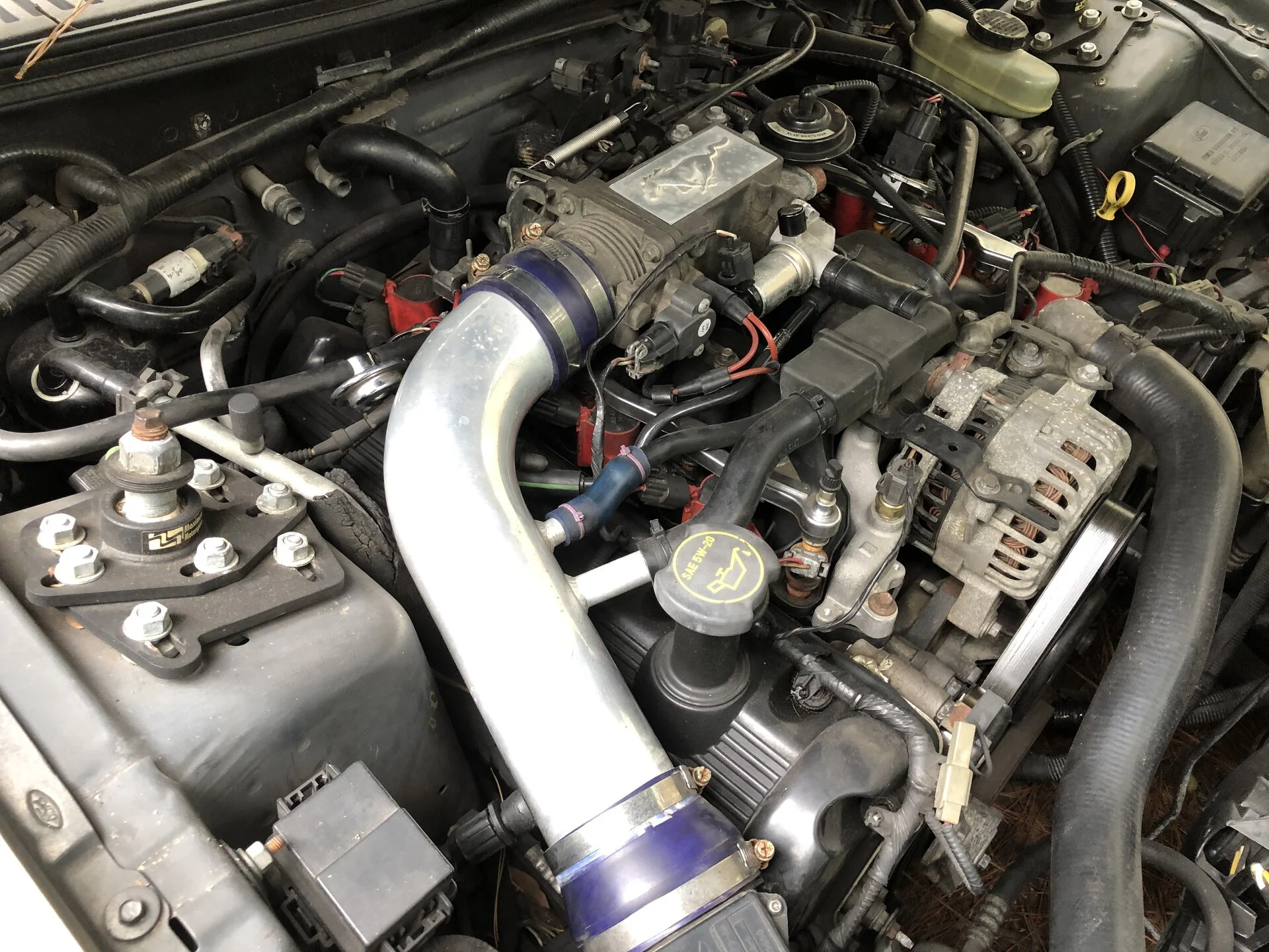

Just posted some engine pictures. Used full image so you guys can see if you see anything wrong. I drive it enough to where it has fresh gas in it. Have always used 93 octane in it also. The guy I bought it from I think bought it to flip. He did not know a whole lot about it. He did say he thought it had a tune but I received no hand held with the car. It has been lowered he said which was obvious. I found someone installed bump steer on it also. Will get it up in the air this weekend and take a picture of the o2 sensors setup on the H pipe and the whole exhaust.Will look for a exhaust leak while I am under there. I do paint and body work and business has been booming lately so have not had time. Again, Thanks to all for your help.

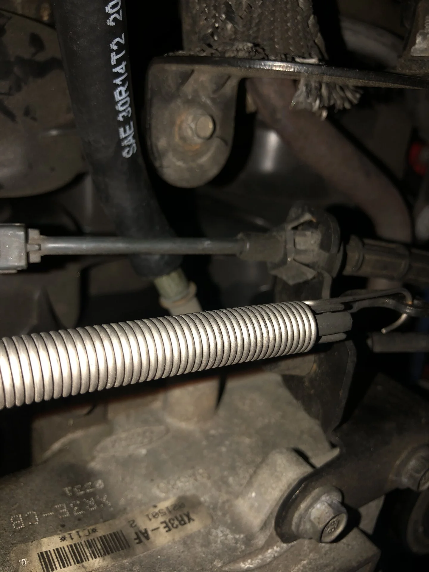

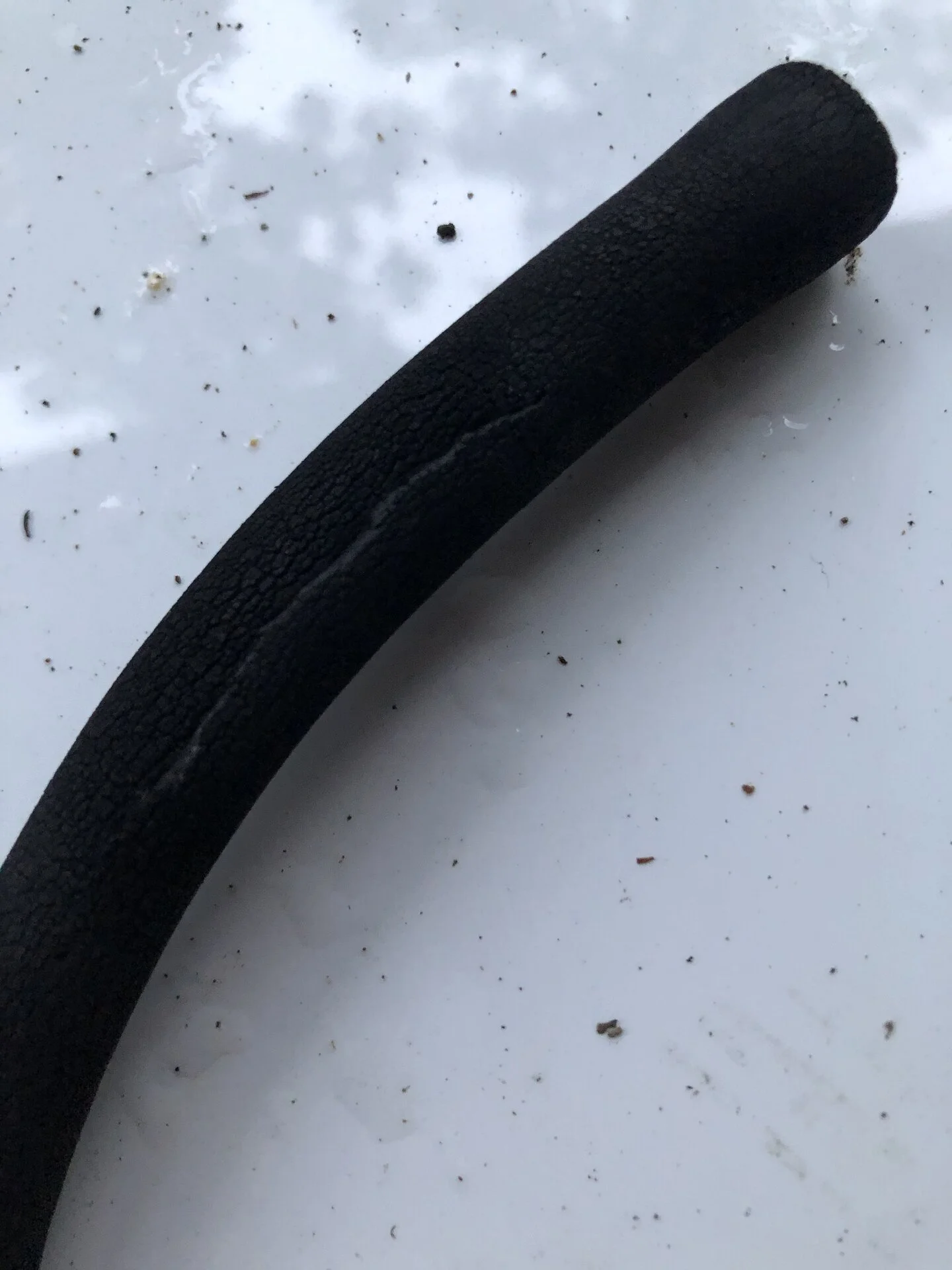

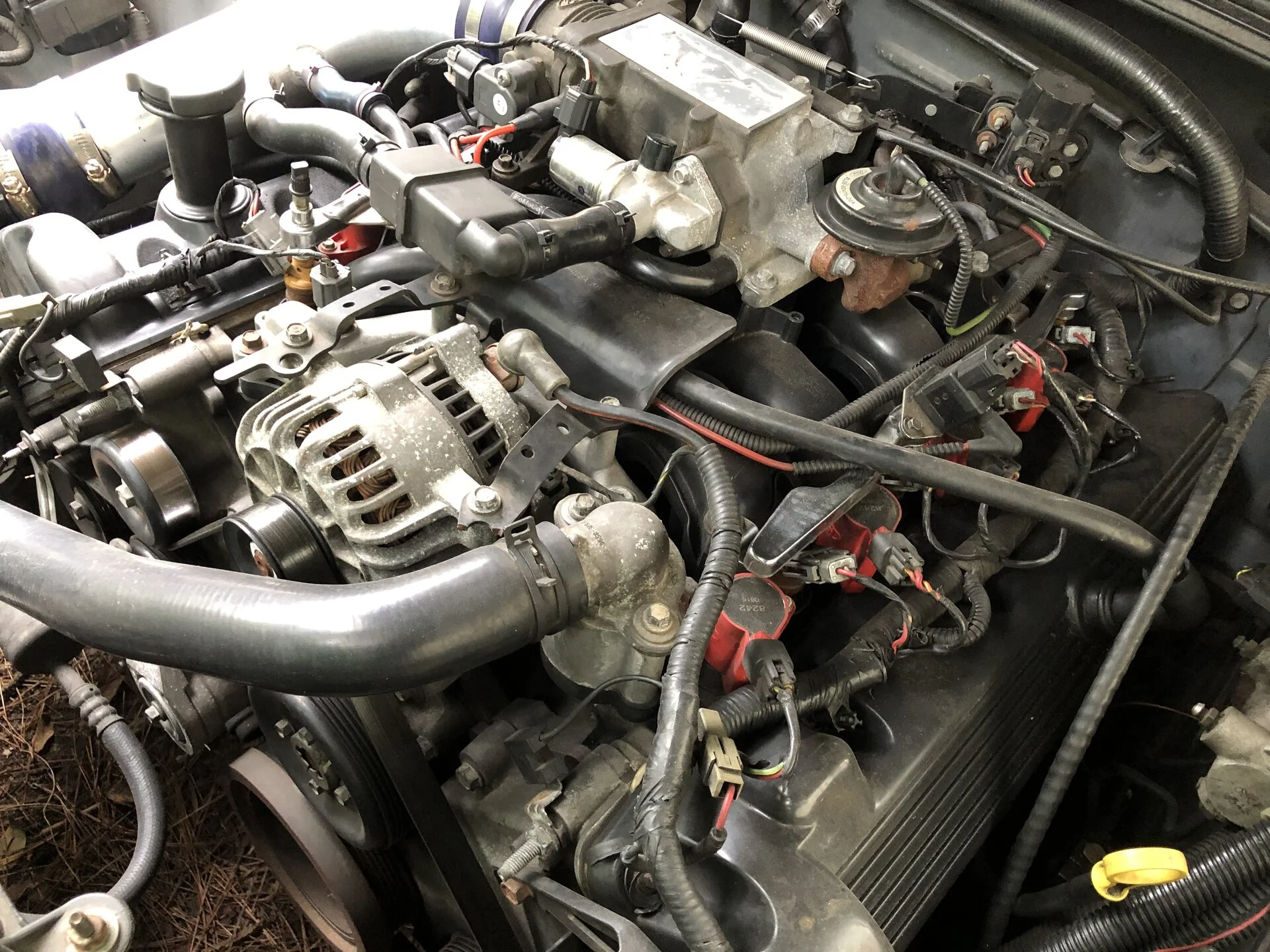

Finally had a chance to try and get the mustang up on jack stands. After trying every way I know of have come to the conclusion the car is to low to get the jack IMG_1854.webp under it. I am not sure I could even get it on a lift. I wish the previous owner had not lowered it.
Guess what, I just found my problem. There is a large vacuum port coming off something on the intake below the back of the throttle body. The hose that attaches to it had about a 2" rip in it. I put a piece of 5/16 fuel line on it (which is to small) started the car and it idled perfect. Going tomorrow to get the right size hose and taking her on a long Sunday ride. Feeling stoked right now. Thank to all for your help. IMG_1857.webp IMG_1858.webp IMG_1858.webp
Reactions: 08GT500
Actually now that I see it in the daylight it comes off the back of the throttle body.. I replaced the front section and just noticed the other half that disappears on the right side of the firewall is split also. I am just going to plug the section I replaced for now. Anyone know where the other end leads to? Thanks
I had a similar problem, look toward rear of the engine bay passenger side for a canister, off that canister there should be a hose that goes to a adapter, this hooks into the hose coming off the back of the TB. Assuming of course we are talking about the same hose but I'm pretty sure we are. I'll post up a pic when I get back home. Also I think this is what gives vacuum for our dampers in our a/c controls but I could be wrong.
