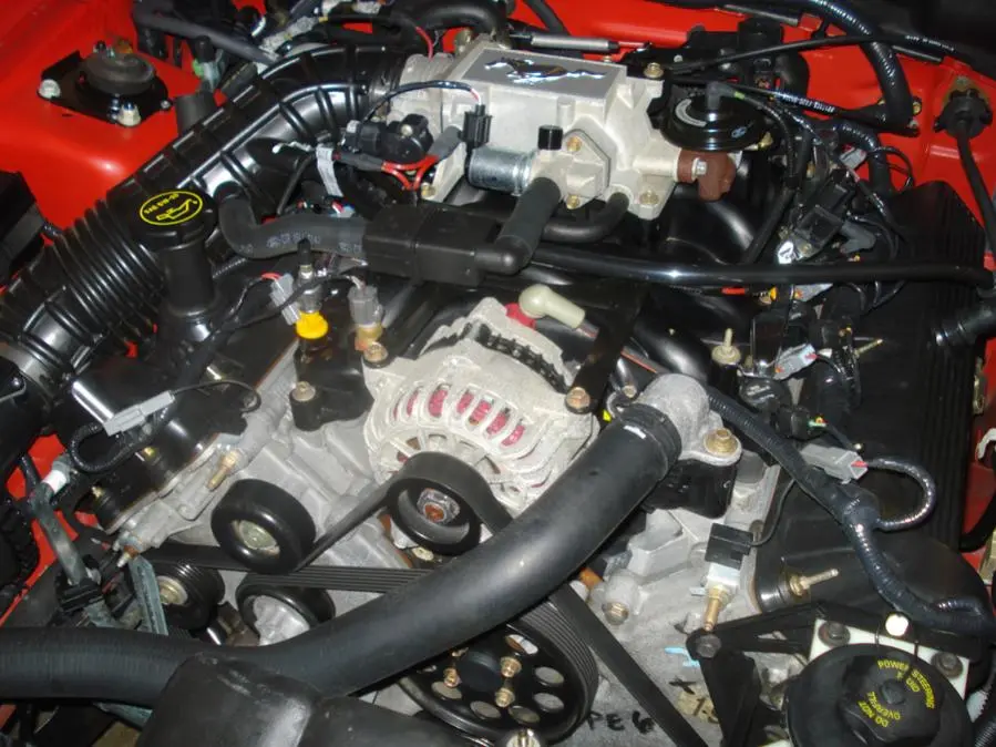

I was curious to know if my 2001 GT has the PI intake manifold with the aluminum coolant crossover instead of the plastic one.
I've tried searching but cant figure it out exactly. What does the non-plastic crossover look like. Does anyone have any pics of what I am looking for?
Thanks in advance!
Looks like I have the all plastic one. How important is it to replace the manifold? This car has almost 40K miles on it.
Thanks again!

My opinion would be to start looking for a replacement one with the aluminum crossover. When you find a good deal, buy it.
If you don't mind that one day you will be driving your car and you will suddenly get coolant all over the place and that you most likely be left stranded, then just hold on to the intake until the old one breaks, then replace it.
If that bugs you then you could just take a few hours on a Saturday and swap them out.
If you can't do the work yourself, I suggest learning how to do it :) You could get always pay someone to do it too, I guess.
My 96 GT had the plastic intake on it for over 95,000 miles and nothing ever happened. I replaced it with the aluminum one when I did my PI swap. I had a friend that had a 98 that cracked his when we went drag racing. Luckily the crack was small enough that he could drive home without any serious leakage or engine damage. Not all failures are that inconsequential though.
yep you definitely have the plastic one...very clean engine bay though :nice:
if i was you, id look into finding a replacement..eventually it will crack...sometimes it wont even be noticeable but the leak will be there
Check the coolant level for extra service life

definitely a plastic crossover like everyone before me has stated.
