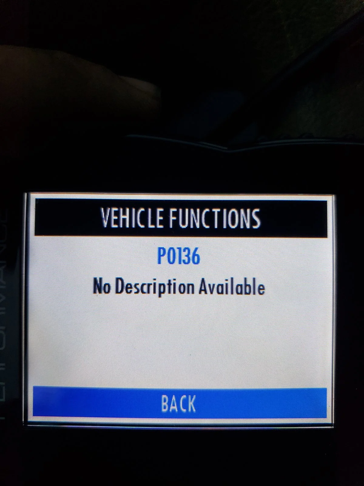

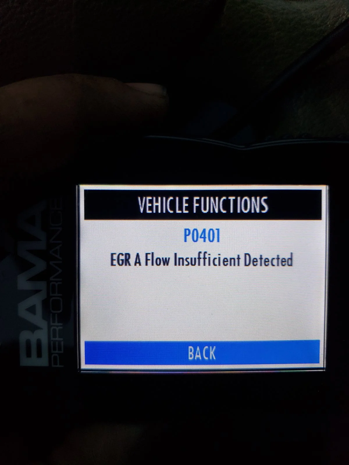

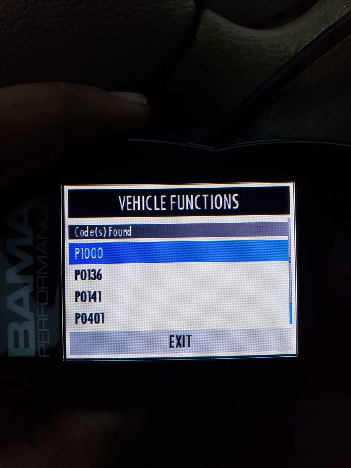

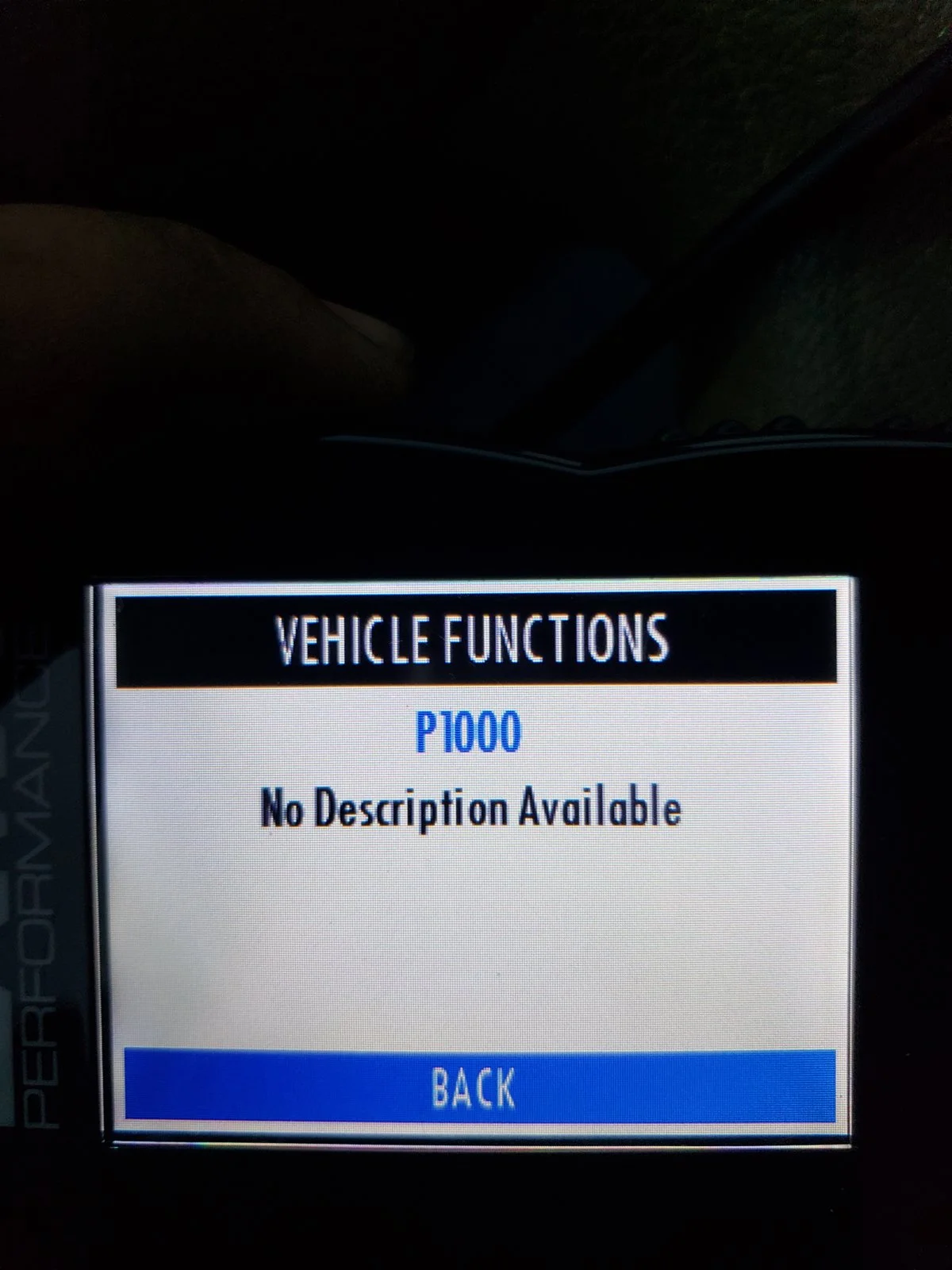

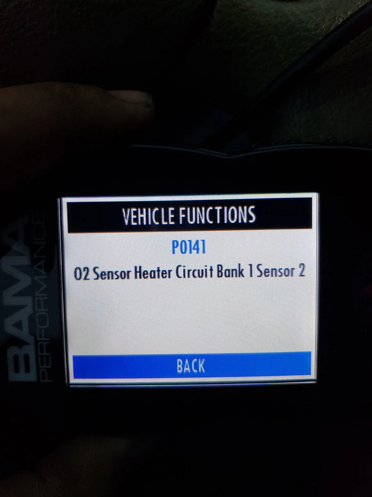

So these came up I figured I had an o2 sensor out but what is an o2 sensor heater? Also can you delete the egr on the 3.8 or will that effect fuel mileage and performance of the engine?

For the O2 heaters it's either the O2 sensor itself or the wiring to/from the O2 sensor.
>>from Ford manual
P0141 - HO2S Sensor Circuit Malfunction (HO2S-12)
During testing the HO2S Heaters are checked for opens/shorts and excessive current draw. The test fails when current draw exceeds a calibrated limit and/or an open or short is detected.
  • Short to VPWR in harness or HO2S.
  • Water in harness connector.
  • Open VPWR circuit.
  • Open GND circuit.
  • Low battery voltage.
  • Corrosion or poor mating terminals and wiring
  • Damaged HO2S heater.
  • Damaged PCM.
Things to check.
  • Wiring.
  • Damaged PCM
