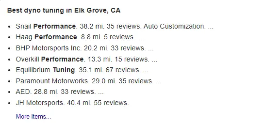

Take the car to a shop and have it properly tuned:
Reactions: a91what
any professional tuning shop can whip that out in a couple hours.
^^^ This guy right here can whip this out in a couple of hours provided that the necessary hardware is in place. He can also help to teach you how to do it yourself if that is something you wish to pursue.
Otherwise, I'd recommend finding someone local to tune exactly, your car with exactly your mods. They'll give you a cool dyno sheet to hang on the wall too! :D
