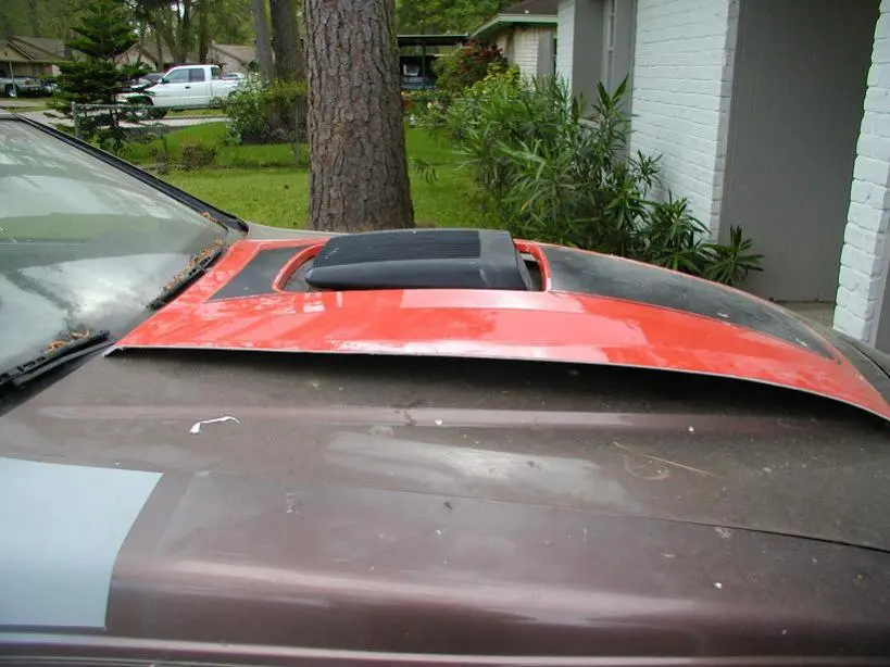

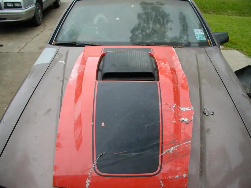

A friend bought a wrecked 03 Mach 1 and was planning to use the shaker setup on his T-Bird. Of course it would require a bit of fiberglass work:

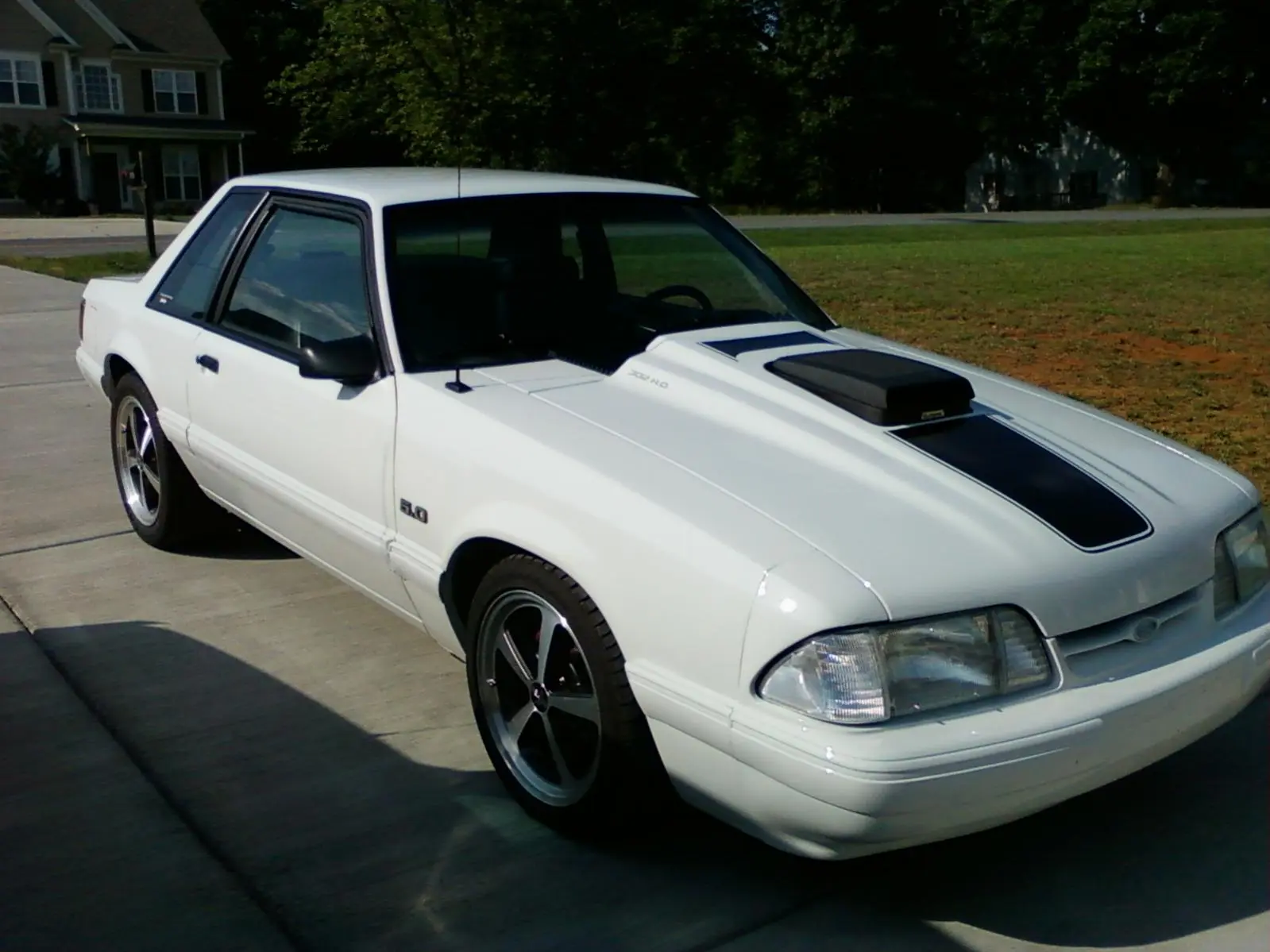

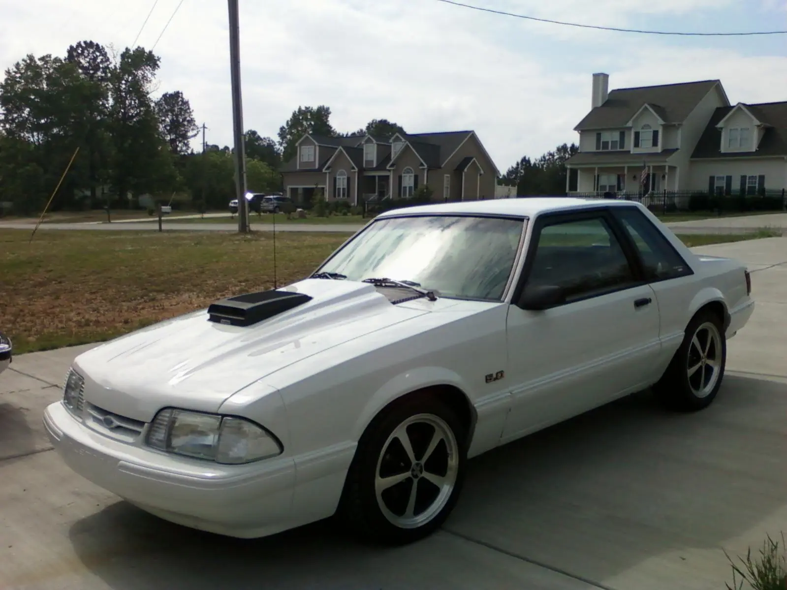

It can be done. I did it
It can be done, It's a fair bit of modifying but nothing a normal person can't do. I'll post a pic or two and if anyone is interested i can get back and list more details.
ssnanney-that doesn't look too bad, but the slope of the hood is really weird, i've never seen a fox-body hood slope quite like that

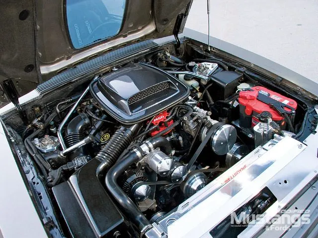

raceoholic330-the only problem with the Banshee (as referred to earlier) is that it's not quite agressive enough for the fox, it just looks to small (which you can't really tell from the photo's that the magazine took, and probably on-purpose too).
3" cobra R hood

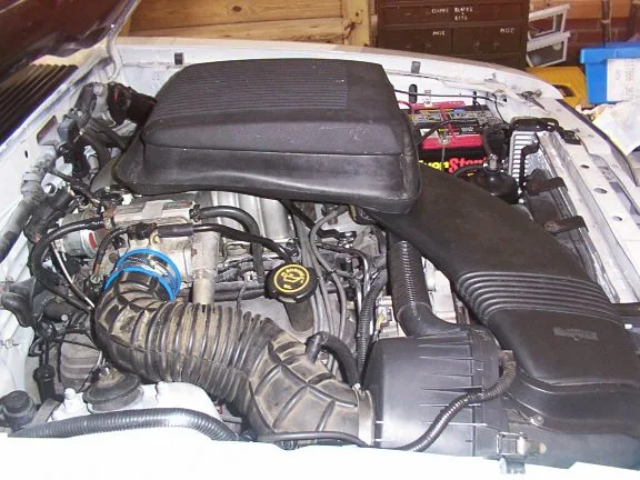

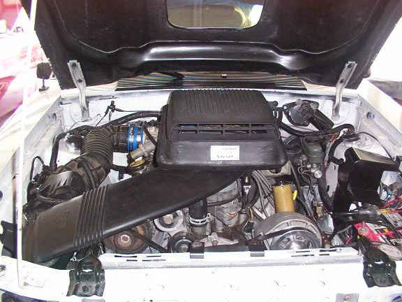

The slope of the hood comes from the fact that it is a 3" cobra R bolt on. Had to be at least this tall. I tried a 2.5" cowl and it wouldnt clear the air inlet tube that runs from the shaker to the air box/filter assy. The shaker is a aftermarket CDC setup for I believe a 98'ish 4.6L. I got it off ebay, contacted CDC and got the missing parts and dove in. It looks good in person, Stripes are a take it or leave it kind of thing. It is fully functional and definitely unique.
