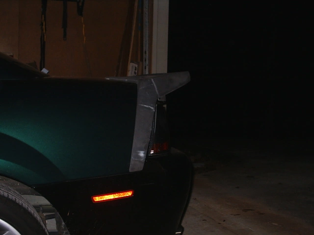

I have just fitted mine and it took me 2 tries on each of the sideburns and 2 additional rolls of 3m super double sided tape. its a bear getting the trunk line and front edge. helps to have 2 more hands. Saleen supplied mine with 2 nylok nuts and allen headed studs.
c-ya
try again

actually the install should be the same on all model deck lids. Saleen only used the 2 bolt holes closest to the deck line ...these pics are a little dull but i'll shoot some in the sun.

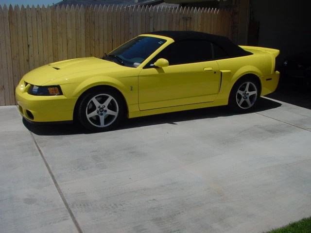

Joe I'm not sure if you still need the help, but I can help because I installed the S281 wing on my yellow "03 convertible. You do not need to do any additional drilling and you need to mount the side pieces with 3M tape.
