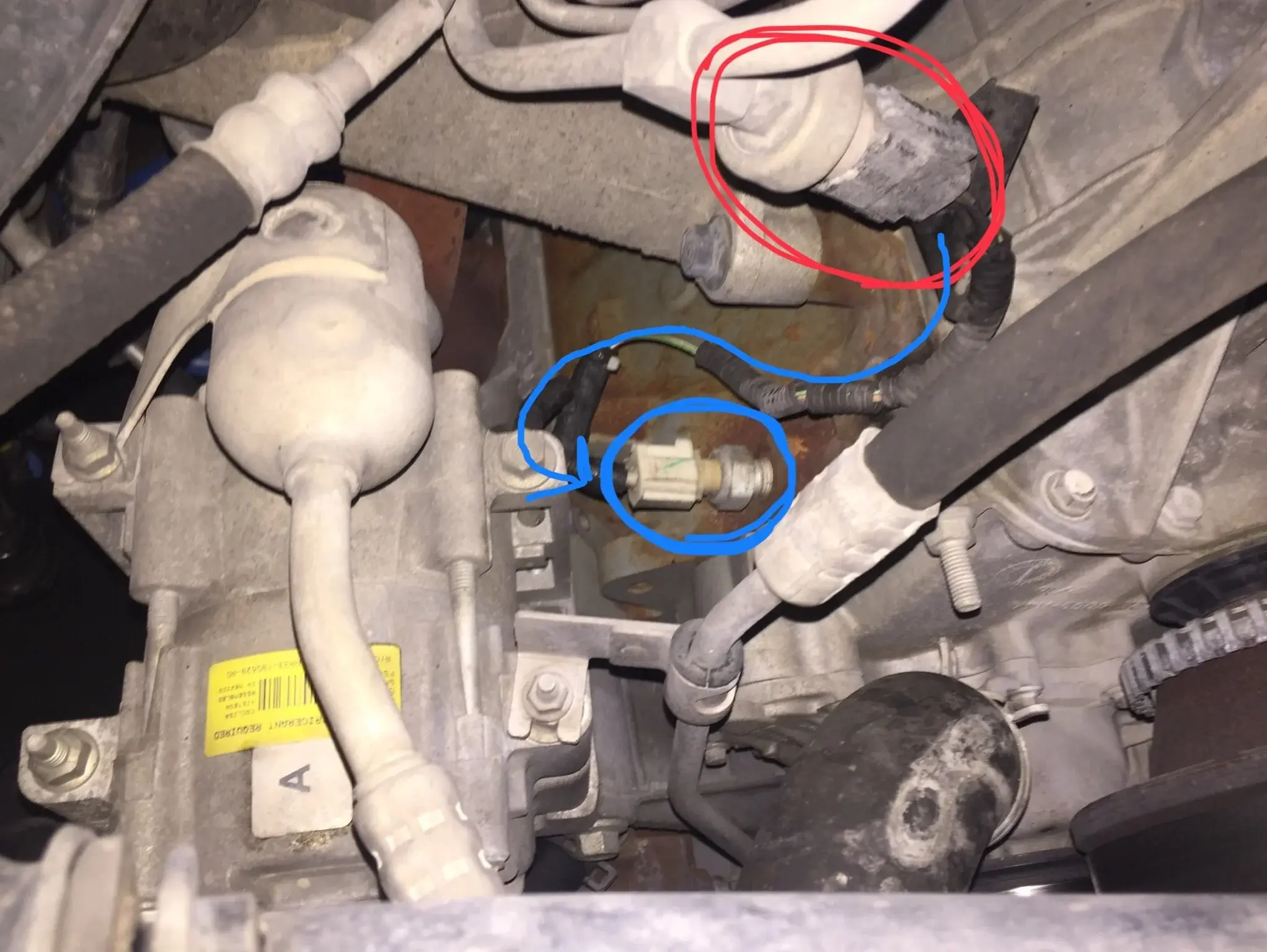

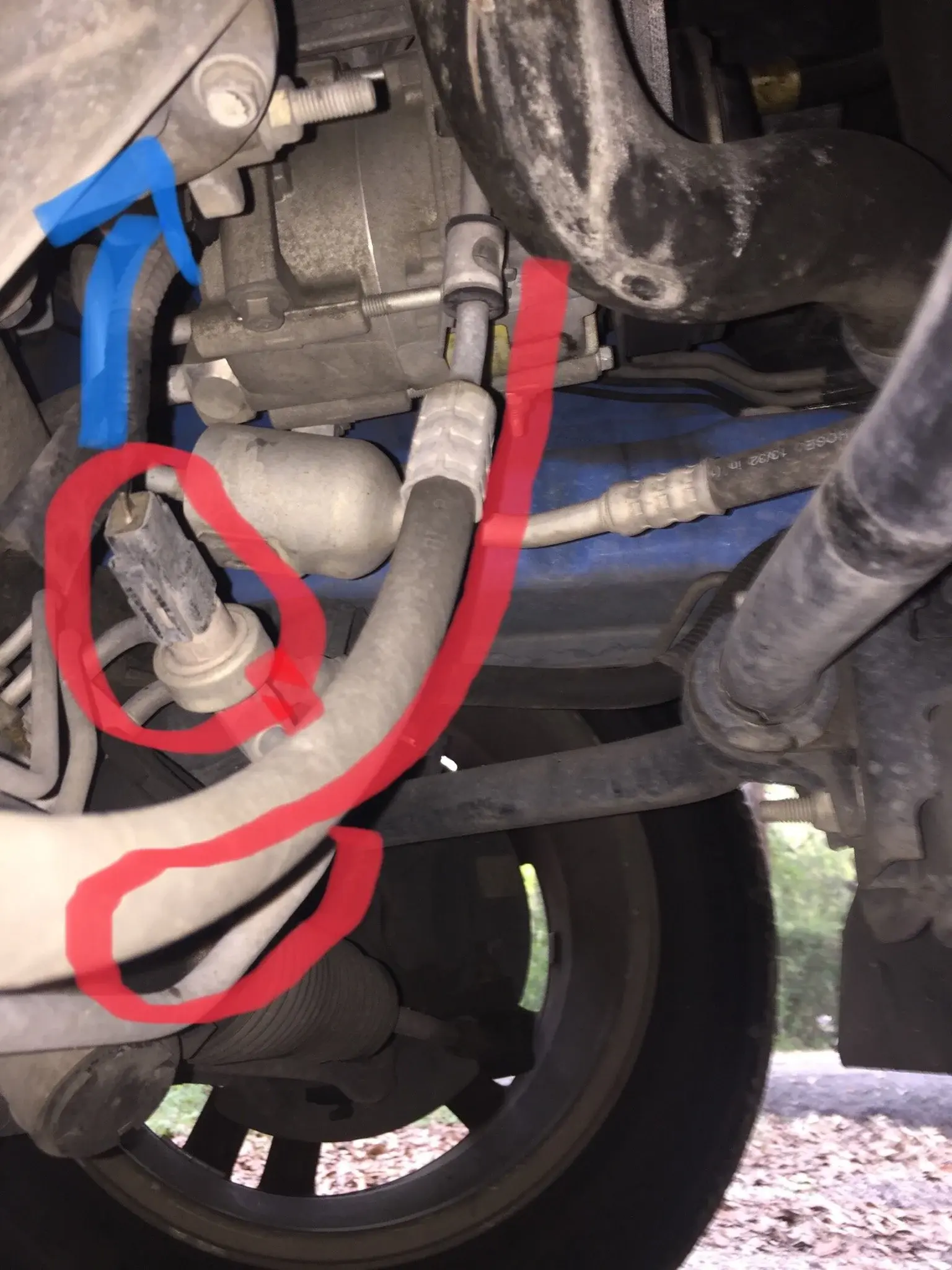

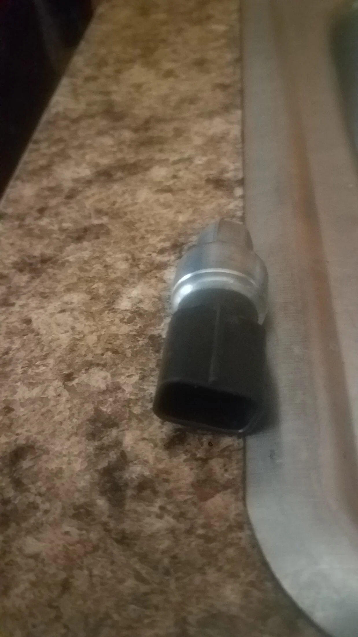

It appears that on the 2005-2010 that there are two switches:
One is between the accumulator and pump and it should be the low pressure switch.
There's another under the break booster and I understand that one is a [high pressure switch]?
I don't have one that can go outside and refer to anymore.
Maybe this will help?
I have one at the firewall just off the accumulator ,and i believe there is one under the top radiator hose . I am going to try to jump the relay to see if it will activate the clutch ,has to be electrical but it beats the hell out of me how both cars could do the same thing just a few days apart !
