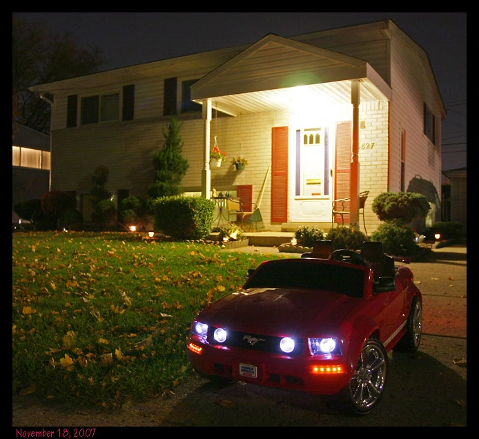

:D Check this out, LEDs rock! :D

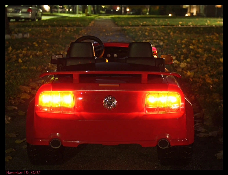

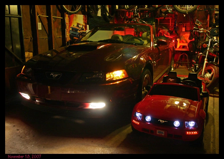

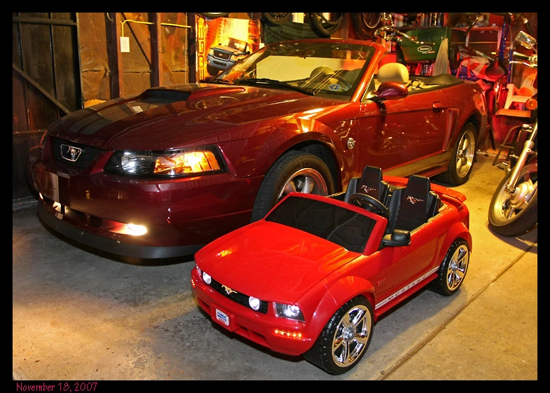

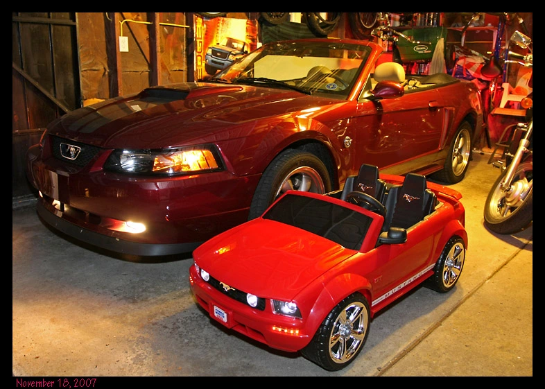

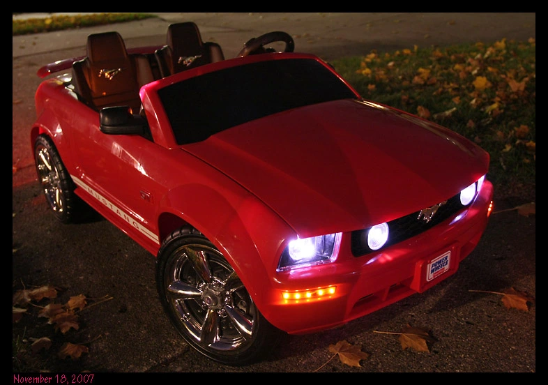

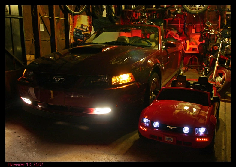

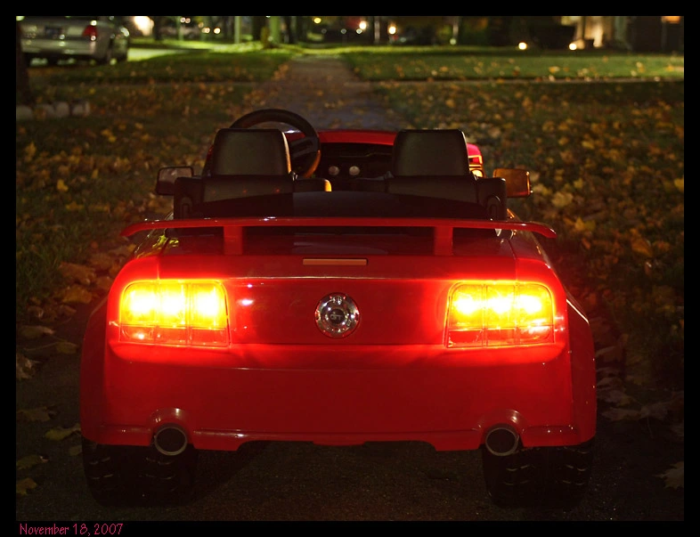

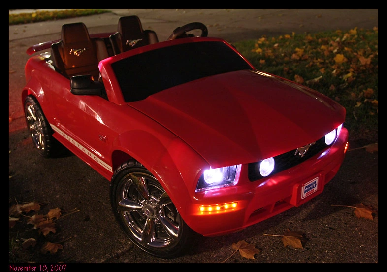

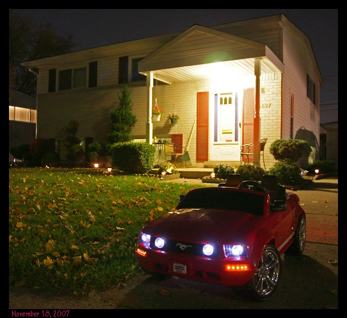

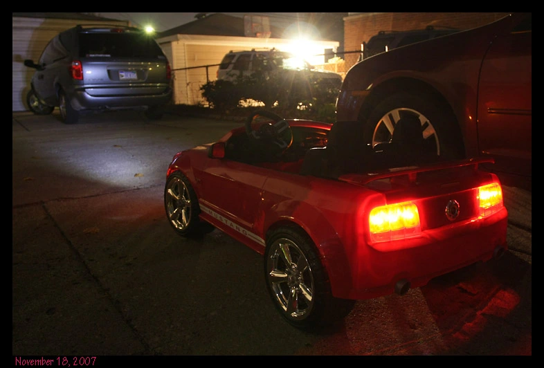

Christmas present for my two-year old daughter. 140mA total current draw. 10mm white LEDs in the head/fogs, 10mm red in each taillight bar, 5mm ambers in the front parking lights.

Damn, those things look bright for a toy car!
Those white LEDs run $3.50 a pop, 4000 mcd output at 3.6v. I have these toned down a bit at ~19.6mA.
One thing that helps - the camera exposure time was 3-6s in most of them at 17mm, f/4, ISO400.
I glued down a layer of Al foil for the taillights to make a reflector.
