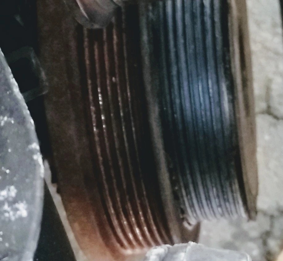

Update: Had a bad crank pulley. It split and the metal part of the pulley shifted backwards. Somehow, the belt was riding on the rubber center of the pulley that remained in place on the shaft. The metal part of the pulley was grinding against the crankshaft position sensor, and wore a hole in it. I didn't see it initially, because the belt cut grooves in the rubber that made it look like two stacked pulleys. It was obvious once I went to remove the crankshaft sensor. Thanks.

Update: Root cause was a damaged crank position sensor, caused by a bad crankshaft pulley. It split, and the metal portion of the pulley shifted backwards. Somehow, the belt was riding on the remaining rubberized center of the pulley which was still on the shaft. The belt cut grooves in the rubber, making it look like a double stacked pulley (see picture). The metal part of the pulley was grinding against the crankshaft position sensor, and wore a hole in it, which caused the intermittent shutoff and eventually prevented the car from starting at all. Had the pulley replaced yesterday. Thanks for the input.
